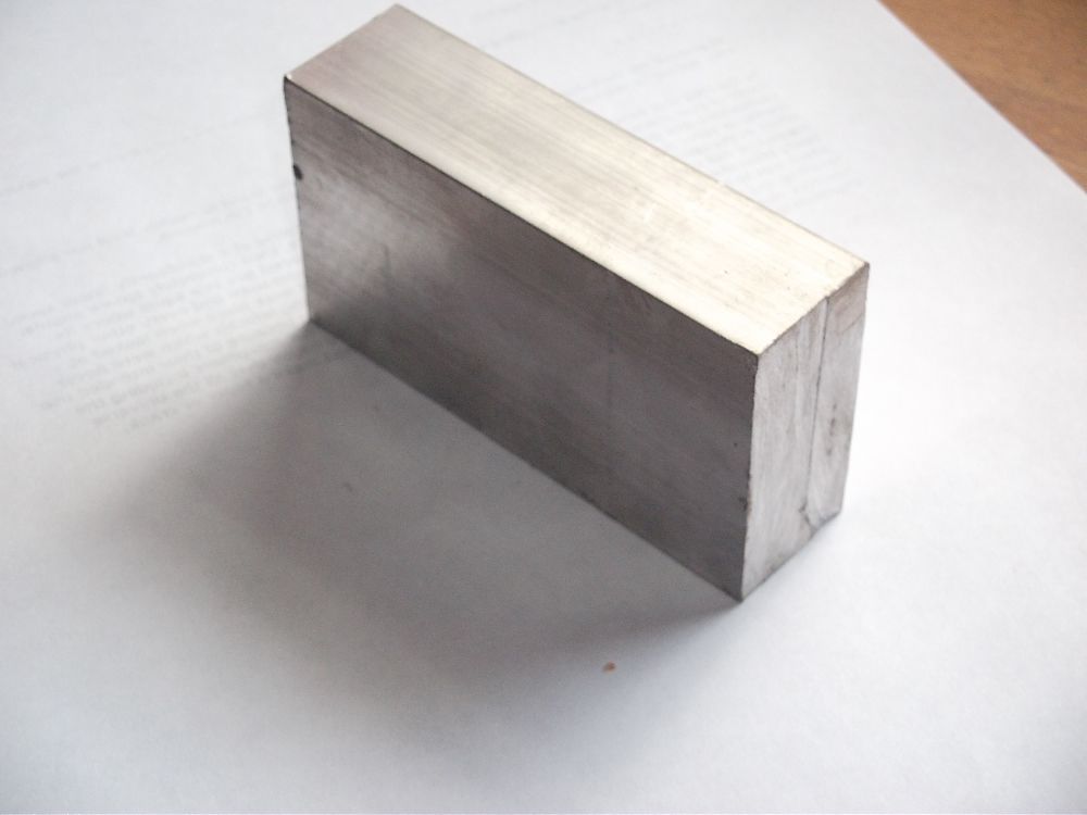

                                              Rufus Roughcut
                                                @rufusroughcut
                                                Hi Gents
                                                As a novice I was asked what this is?????
                                                With all guarded response and discriptions clear for a novice to understand what would you say ???
                                                Rufus
                                                #115790
                                                Sub Mandrel
                                                  @submandrel
                                                  A lump of metal.
