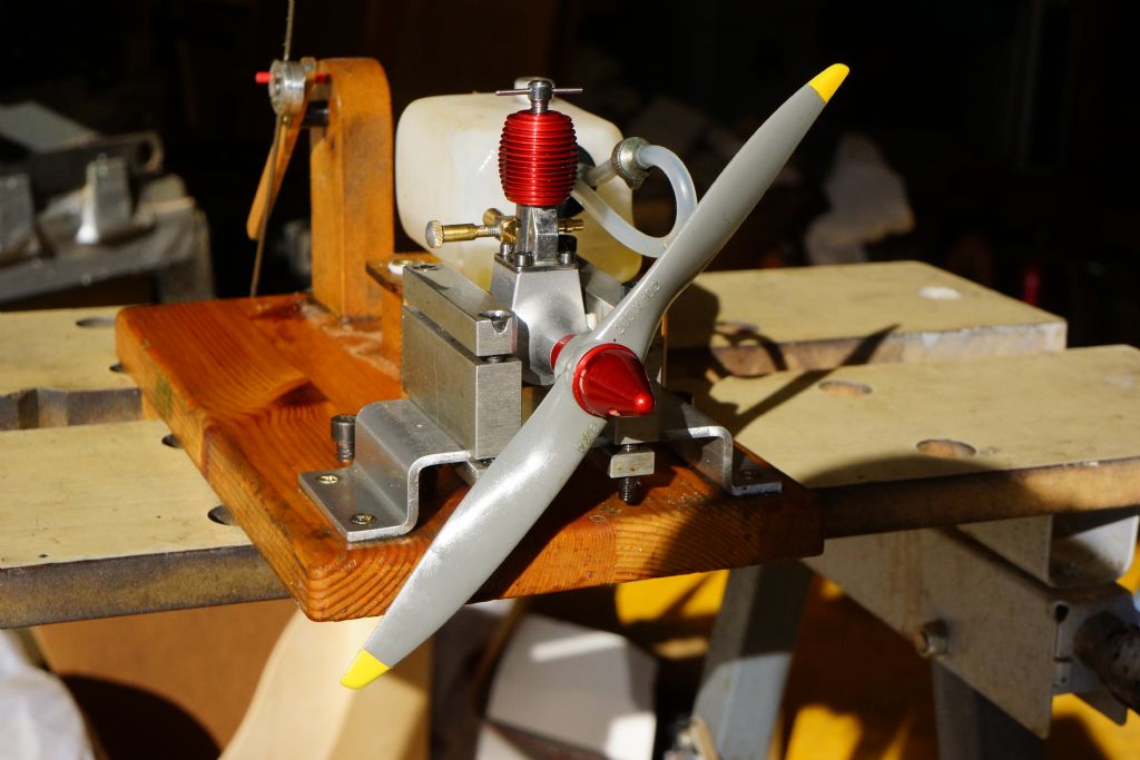

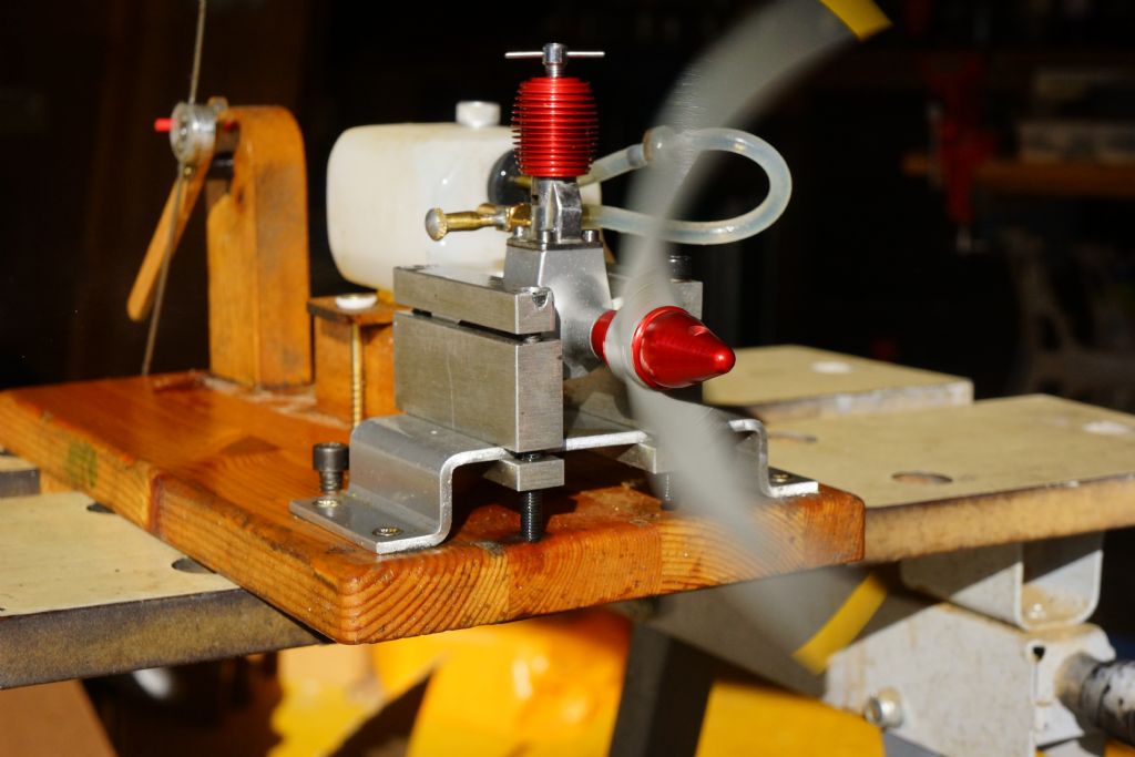

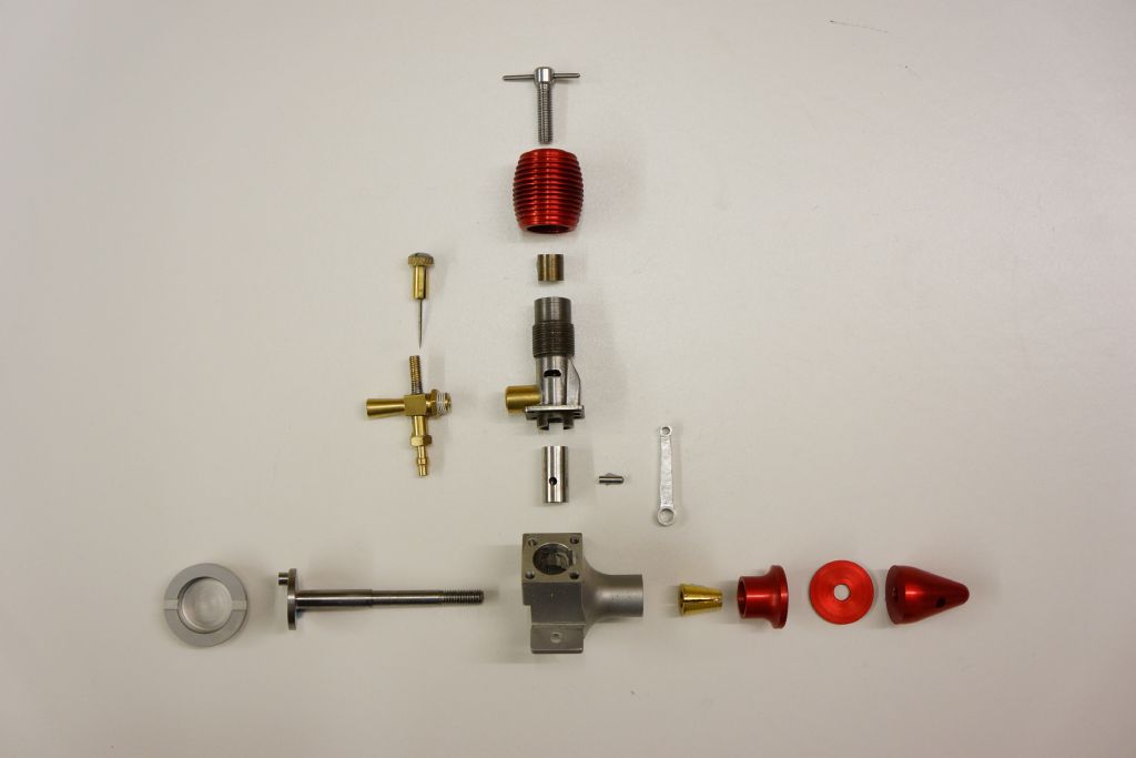

        dsc03865.jpgdsc03862.jpgHave just completed and run this engine. Casting and drawings from Hemingway Kits. It started easily ,once I had the settings correct and has had four runs of three minutes each, so far at 5600 RPM with an 8×6 inch nylon prop. I have differed from original design with the cooling fins and made a collet type prop driver. The original had a steel driver locating on an 0.020"step in the crankshaft. Crankcase has been bead blasted plus red anodising for the other external aluminium parts . Working this small has been quite interesting.

                  Is the piston the wrong way around in the picture, if not there's a lot above the pin.
                  Did you leave the back of the crankcase out, I see a retaining ring.
                  Emgee

                    The piston is the correct way up. This is typical Sparey.
                    The matt surface of the backplate makes it look like a ring in the photo.
