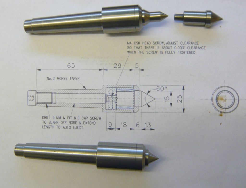

                              If you look at my photos you will see a simple design I made years ago and its still working very well.p1040869.jpg
                              Alan
