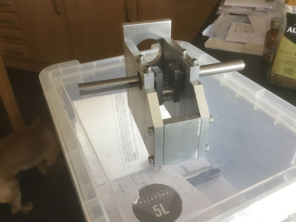

                            #612165
                            Anthony Knights
                              @anthonyknights16741
                              Keyway tool. Here's one I made earlier.

                                        I would favour locking the saddle (carriage) and use a lever operated tool, it would also have much better feel.
                                        #612625
