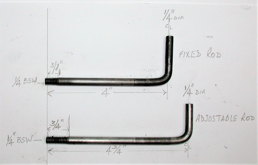

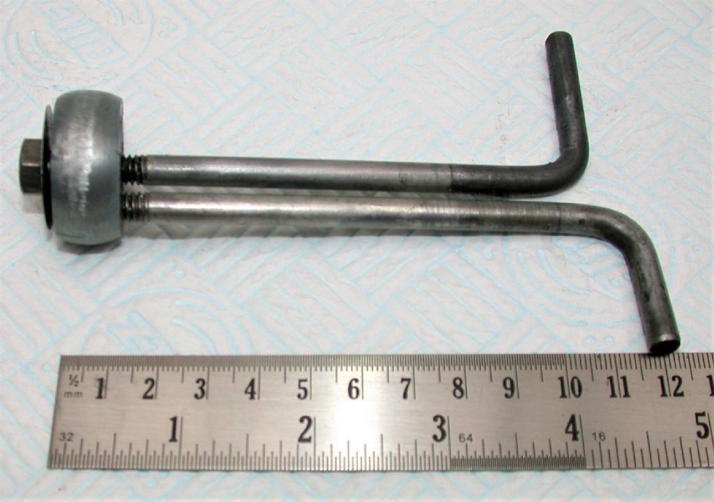

        I am now in the process of building the dash pot “bellows” from scratch. I think the Kennedy 60 is smaller than the Kennedy 90 which is my model. Does any one have any specifications for the Dash Pot plunger for the larger model? I think the internal diameter of the pot is 38mm.
        I also wondered why the plunger has 2 rods? I can see one is the linkage to the saw assembly – I think that is the central rod. What does the second do and do I need to make it? Thanks very much in advance.

        #550977
        vic newey
          @vicnewey60017
          The second rod works to push against the disk underneath the plunger, it's supposed to adjust the resistance the oil makes against the pull of the spring. The disk is slightly loose on the bolt, it is to allow the oil to flow easily through when you lift the saw arm up, otherwise most of it will pull up into the gaiter.
          When the arm is coming down against the oil the disk pushes against & blocks the holes unless the adjuster thread protrudes a fraction to speed it up. I probably have the wrong grade oil in mine as the adjuster does very little.

          #550982
          Jamie Wood
            @jamiewood67138
            Hi Jez,
            Someone sent me these pics when I was doing up my Kennedy, as I was missing the adjuster rod. Also for the gaiter I struggled to find something to fit the pot, but found a bit of an old bike inner tube worked fine to stop anything getting into the oil. Hope that helps,
            Jamie
            Kennedy Plunger Rods
            Kennedy Plunger
            Kennedy Hacksaw Damper Pot

                          #552840
                          Jez Hunter
                            @jezhunter81798
                            Update on my Kennedy resurrection – from a very unskilled operator.
                            Here is what I have achieved and learned so far with all the generous advice from you all….
                            The lever to keep the boom elevated was simple and quick to make with 6mm and 8mm mild steel rod, articulated with a small bolt, an 8mm compression spring and a handle. Works perfectly.
                            The machine switches itself off now using a flat piece of alloy which presses against the switch when the boom is fully lowered. This was a simple design but quite tricky to get right. It’s not perfect and I would not leave the saw completely unattended.
                            The saw did not cut straight – I tried a 1” and 1.5” width blade which did the trick but could not source one with any more teeth than 14tpi and this kept getting stuck as it was too aggressive. 18tpi is definitely the sweet spot for my machine even with pulley belt dressing to make it stickier. I changed the belt from lathes.co.uk which did not solve the slippage problem and cost £28. The off centre cuts stopped when I rebuilt the dash pot and put a 96mm x 8mm tension spring between the dashpot arm and a 6mm bolt whose tapped hole I found on the main casing. I bought the spring from eBay for £3.96.
                            The dash pot bellows was equally simple but took me a few goes as I do not have a metal lathe. I butt welded 2 sections of 25mm flat mild steel and then cut out a 20mm depth disc using a 40mm diameter HSS hole cutter. This made the diameter 37mm which was just right to slide up and down the pot cylinder. It was easy to drill out 3 x 8mm and 3 x 6mm holes which provides the route for the oil to flow. I found that all 8mm holes and there was too little resistance. I found any bigger disc and the plunger caught. There is much scope to improve this if I aligned the rods better but it works. I made the bottom washer from 0.8mm alloy in a similar way. The two rods were made from 8mm mild steel with a length before bend of 4 and 4.5 inches respectively. I used SAE 90 gear box oil and found, thanks to a mate of mine, that the a Clio steering rack boot acts as a perfectly sized rubber cover. I had to fill the pot pretty full for the dampner to work from top to bottom of the cut.
