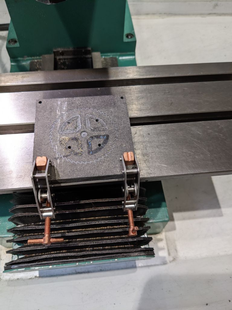

                        Well I just indulged myself with a couple of the smallest ones…
                        My little Novamill has a cutaway "ledge" at the front of the table and I often want to clamp flat things down on it for profiling – generally glued or screwed down on a piece of composite as a spoil board. I have used toolmaker's clamps for this but these are brilliant, much easier to fit and no adjustment between two screws for best clamping. I wasn't aware of these until seeing this thread. Usually there's also a couple of conventional clamps on the back as well using the tee slots.

                            #573062
                            John Haine
                              @johnhaine32865
                              Yes, MSC, cost ~34 including VAT and carriage. A bit pricy but nicely made and just the job. I could do with some larger ones but the price gets bigger quicker!
