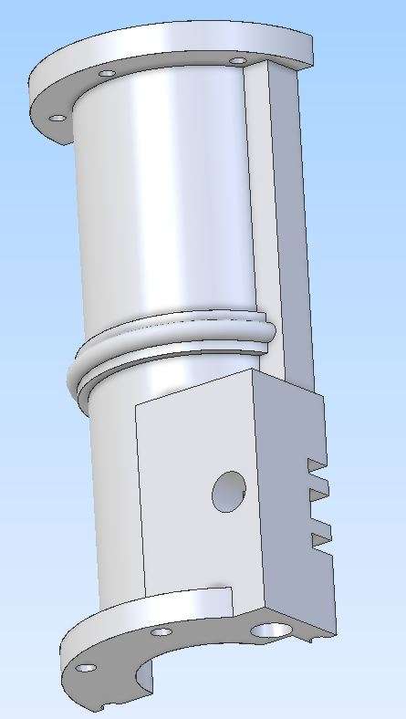

      Hello Jason,

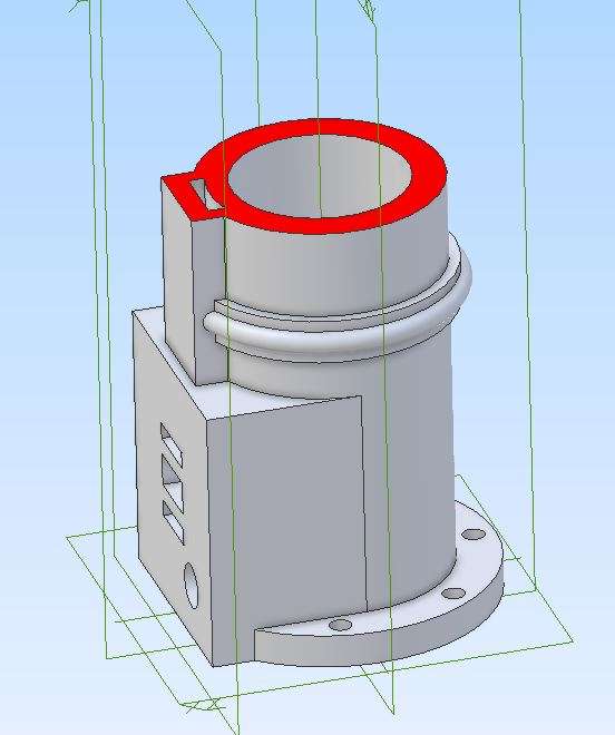

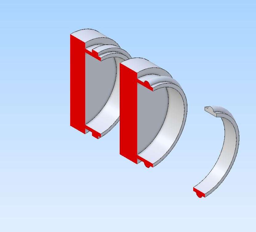

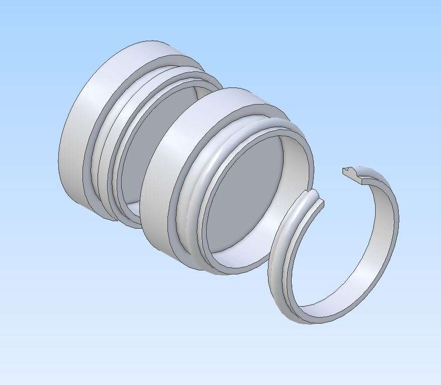

      I’m interested by the decorative ‘beading’ around the cylinder ‘middle’.
      How did you make that please?  Two brass sections p’raps; i.e. half beading silver-soldered centrally to a length of strip & then curved round & cut to fit?  Or …. ???
      (I suspect that there are more cunning ways to achieve that effect!)
      Thanks in anticipation.
      Phil
      #759085
        I tend to do them by turning. Face the end of a bar, bore to suit the cylinder’s OD and then with a parting tool form a squared off version of the profile as per the left image.
        Then either with form tools or simply rounding over with a file against the revolving work take the corners off to form in this case the half round as per middle image
        Finally part off. In this case I also milled an 8mm wide slot to clear the rectangular block that contains the steam passage to the top of the cylinder, Right image
        ring
        rings2
        Looks a bit like this when all soldered and machined
        ring3
        ring4
        ring 5
        If you are adding them to existing cast cylinders or ones turned from solid with integral flanges then you need to cut them in two so they can be fitted, stick in place with JBWeld.

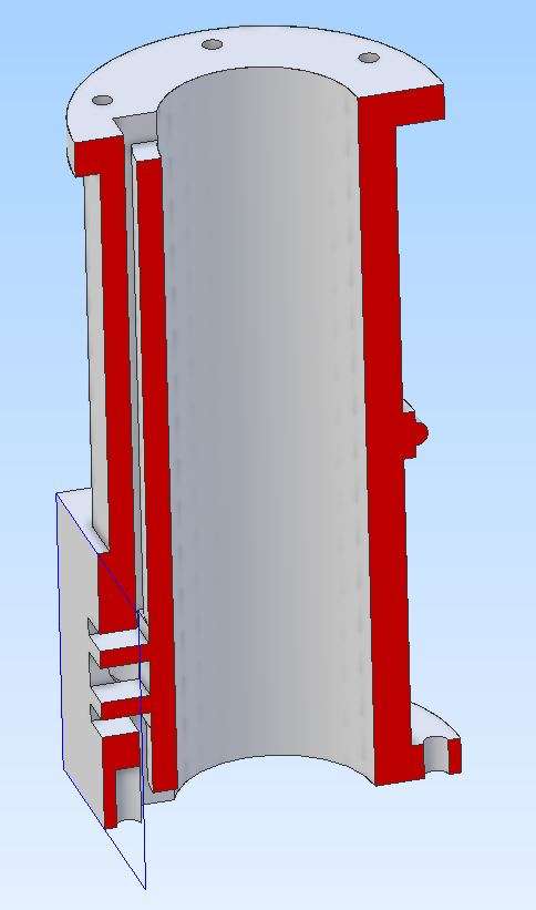

          The original model had a valve chest with an integral cover and a separate gland and surround, you could also see were the passages had been drilled and plugged on the trunion below the chest. I went for the more traditional rectangular “box” and separate cover and also included a lower lip to cover the passages into the edge of the trunion.
          After milling a lump of cast iron down to overall size it was set up in the 4-jaw to turn the neck of the gland followed by drilling for the valve rod and tapping for the gland.
          Then back to the mill to machine out the cavity, drill the stud holes and lastly mill the lip for which I used a 6mm x 1R cutter to leave a small fillet.

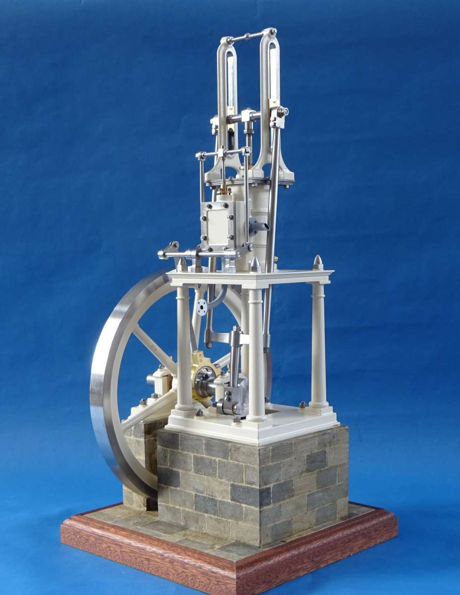

                        The finished engine on it’s wooden base – old salvaged mahogony for the top piece and some laburnum heartwood for the two darker pieces
                        https://hosting.photobucket.com/69b345ca-df36-4122-8a08-70a324faa956/97d667b4-bf9a-4f98-9eb2-88aac73d5bba.jpg
                        https://hosting.photobucket.com/69b345ca-df36-4122-8a08-70a324faa956/3f222f6b-ad73-4da7-962a-e99ca7811296.jpg
                        Quite happy with how it turned out and it runs nice and slowly as I wanted though is still quite smooth when the airflow in opened up.

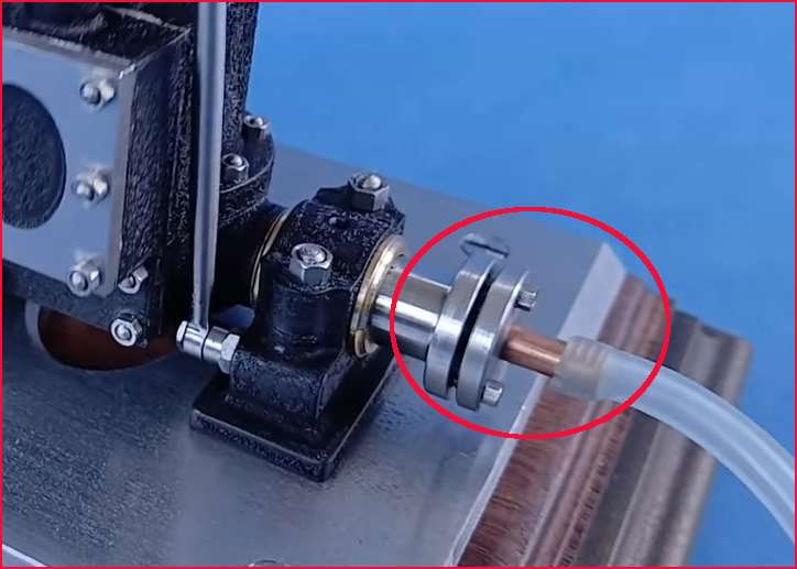

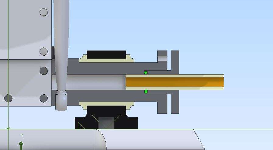

                            A question if I may.  I noticed the steam input, ringed in red below, seems to rock with the cylinder, and if so, would twist the pipe:
                            rockinginput
                            Never thought of it before, but connecting high-pressure steam to an oscillating cylinder must have been difficult on a full-size engine.   Hard to make a flexible steam pipe back in the day I feel.   And just as hard to make a leak-proof steam connector to link a moving input pipe to a fixed steam supply pipe.   Any idea how they did it?

                              Stuffing box?

                                  Dave, As Duncan says a stuffing box is the answer. In much the same way that they allow piston and valve rods to slide up and down they also allow one part to rotate around another. I real life the pipework would be fixed, often with a bend just after it comes in/out of the trunion as can be seen on say the mcOnie but as I’m only using a short stub for looks then the small amount of friction from the gland packing is making the copper pipe move with the engine.
                                  Green is where the gland packing goes
                                  gland

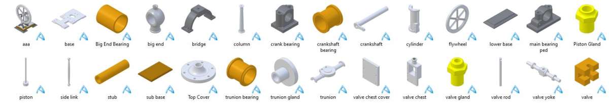

                                        There are not so many published designs around for Table engines, you often have to just go by a photo or old engraving and then work it out for yourself. It is not so bad if broken down into each part and you can use the mechanics from known working models and adjust to suit. For example the valve and posrt sizes could be base on a Stuart or other engine as they are hidden away inside the steam chest. Even the Stuarts can be enhanced by adding your own details. This is basically a James Coombes that I only used their cylinder for and made the rest from scratch at a fraction of the cost too.
                                        DSC04635
                                        There are a few drawings available, Anthony Mount has a couple of table engines and drawings can be found in old ME of EiM as well as bought with or without castings from Polly Engineering. Their new web site done not have the full descriptions at the moment but there are quite a nice looking engine. Let me know if you want more details of any of them and I’ll post it here.
                                        Further a field Steam of Steel sell separate drawings or complete with castings though not that cheap.
                                        If you have the ability to open .STP files or use an upto date version of Alibre then I could send my 3D model. Unfortunately I usually don’t produce any 2D drawings for the engines I’m working from, I just take what I need from the 3D model. Also things like those column supports or the cylinder are drawn “as finished” not the individual parts as I know in my head how I will make them so more drawings would be needed if someone else wanted to make the engine.
                                        Looking at the parts modeled it does not look a lot (some small parts not detailed) but the real work is in the fabrications, the cylinder for example is made up of 6 parts, each bridge 6 parts and the flywheel 9 parts.
                                        JK parts
