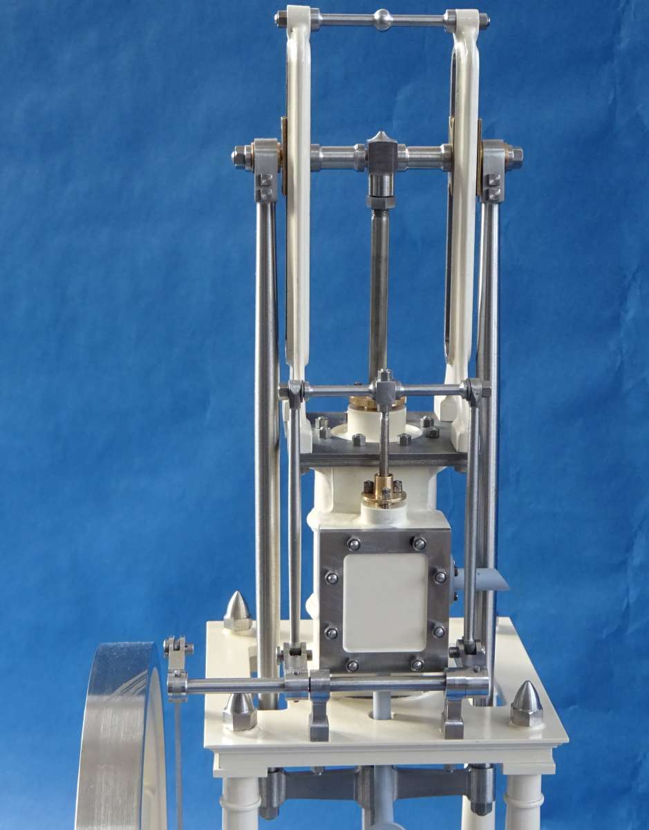

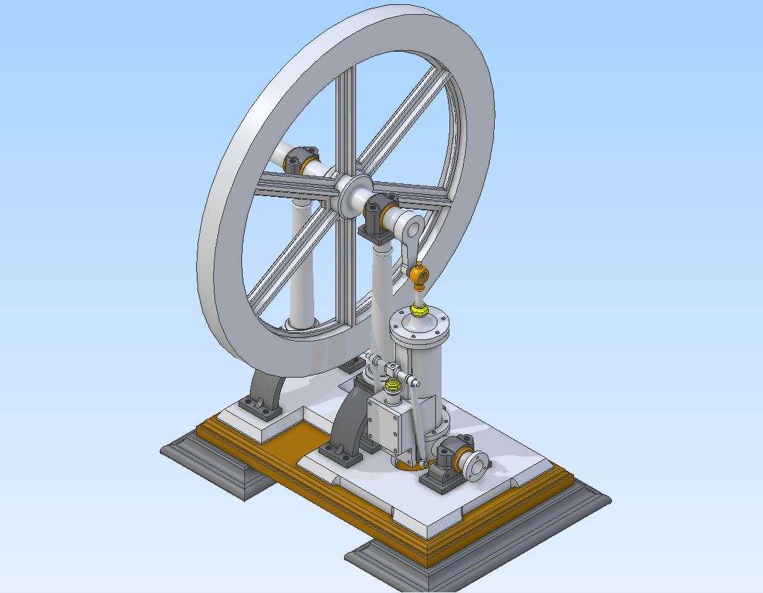

      I first became aware of this engine about six years ago when it appeared along with some others in a Bonham’s Auction and filled the image and description away in my “Future Projects” folder on the PC. It seems quite a few others like it as the image crops up quite often on sites like Pinterest but I have not seen anyone else have a go at making one.
      b3
      The original was a fairly large model and I settled on a scale of about 4/10ths based on using a piece of 203mm thick wall tube to make the flywheel rim from which gave me a bore of 16mm and stroke of 48mm. Armed with these numbers I set to and drew it out in Alibre. It took a while to arrive at the right pivot point and length of the valve links to get the slide valve to move correctly on the 3D simulation hopefully it will do the same on the physical model. There are a few areas that I have done a bit differently such as the valve chest but the finished model should be reasonably close to Jekyll’s original.
      jekyll 3D
      I have not taken photos of all the work but will show the main fabrications and more interesting bits.
      I decided to make a start on the two arched column supports. The actual arch part was made by turning down some more thick walled steel tube to the correct inner and outer diameters and then milling away what was not needed before parting the 4 pieces off.
      The remaining parts were cut from flat and square bar, I left the feet as one long piece of bar which allowed a bolt to go through the middle with a suitable spacer to hold the square part central and at the correct height for silver soldering.
      The two “castings” after a dip in the pickle
      The waste material was then sawn out and the cuts edges milled to final size. The counterbored hole will take a cap head screw to attach the column. The tops will be skimmed to final height once the base plate is made and they can be screwed to it in exact position.

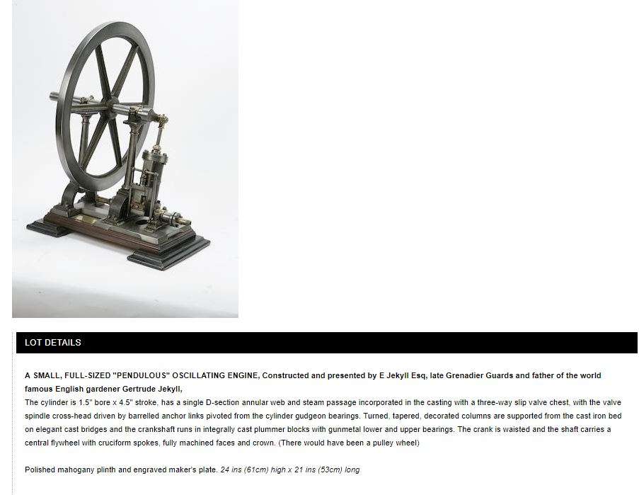

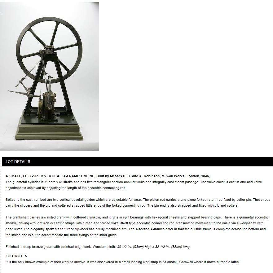

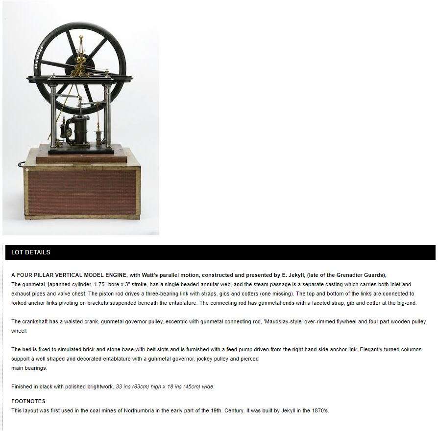

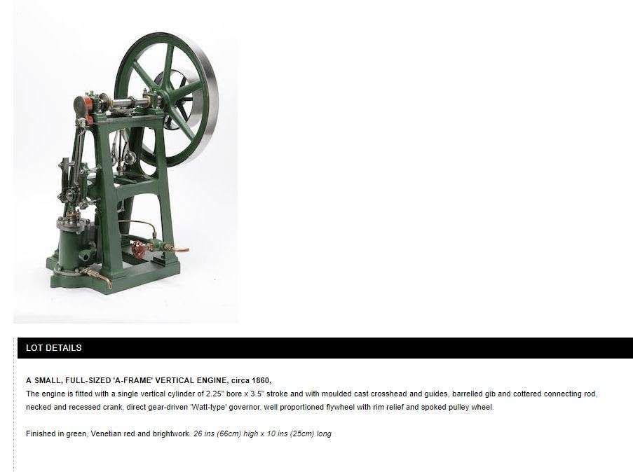

            Although the description says “A small full size” I’m not convinced it was ever really intended to do work. There is no pulley to drive anything though that could have been lost over time. The bigger give away is that the decorative wooden base has no sign of any holes that would have allowed the engine to be fixed down so any load from a pully would just pull it over long before any twisting could take place.
            There were a few other engines in the auction including this one also by Jekyll, a similar size but I don’t think it was intended to do real work. Interesting way the valve chest and passages are a separate casting.
            b10
            b11
            There were some other engines in the same auction which were from one person’s collection, all would be nice subjects for a model
            b6
            b9
            Not seen the dovetail guides down the side of the cylinder used on anythng else
            b14
            b17

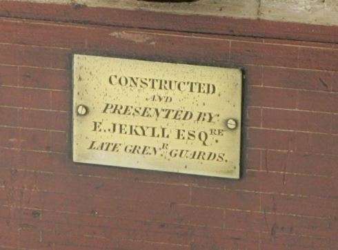

                  That strange phrasing:  “constructed and presented” intrigues me.
                  It reads like something from the minutes of a scientific meeting of some sort.
                  Whatever … it led me to find:
                  https://www.bonhams.com/auction/23024/lot/78/a-small-full-sized-pendulous-oscillating-engine-constructed-and-presented-by-e-jekyll-esq-late-grenadier-guards-and-father-of-the-world-famous-english-gardener-gertrude-jekyll/#!

                      The image of the other Christies oscillator is not showing from your link but I can get this from the link I posted earler to the Bonhams Auction
                      jk
                      I suppose it could be taken two ways, either Jekyll is showing (presenting) it as his work or he has made it and is giving (presenting) it to someone. If the latter you would expect to see the name of who it was presented to and possibly a reason why.
                      Edit just twigged the RE on the name plate so he was retired.
                      I don’t know how long his millitary service was but if we assume he retired from service then that would suggest he makes them as a hobby and not to do real work unlike some of the other engines in the auction that were small workshop engines by known manufactureres or in the case of the Maudsley ones probably apprentice pieces.

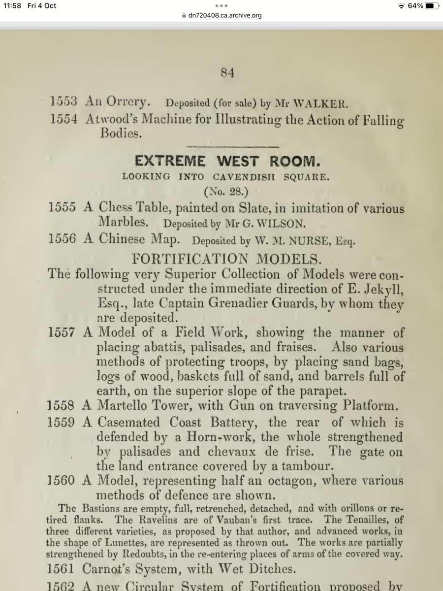

                      #757360
                        < EUREKA >
                        Jekyll gets a reference here:
                        https://archive.org/stream/royalpolytechnic00roya/royalpolytechnic00roya_djvu.txt
                        IMG_0142
                        #757364
                          Unless that is a screen shot of his mention that has fallen foul of the forum software and may show up tomorrow you will have to give me a clue to whereabouts on the list he gets a mention. I must have missed him as I looked through it.
                          Do we assume that is who he presented the engines to as there are several others that say presented by $$$$$$$ though most say deposited by $$$$$$$ not sure of the difference perhaps they wanted them back?
                          Would have been an interesting place to look around.
                          #757373
                            A list of Fortification Models, starting on p84
                            … I downloaded the PDF and grabbed a screenshot.
                            What we need now is more editions of that catalogue
                            … I will have a look this evening.

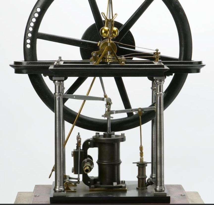

                                I agree it is an Interesting way the valve chest and passages are a separate casting, I notice there is what appears to be a handle on the end of the governor arm? odd? why the extra 2 holes in the parallel motion arms? and there is something interesting happening with the lower valve gear. If anyone could enlighten me I would be grateful.
                                Paul
                                #757572
                                  The handle is actually on the end of the eccentric rod, you see this fairly often on early engines, it allows the valve to be uncoupled which can help if turning the engine over by hand or starting/stopping. Known as a Gab
                                  I can’t see that the governor actually does anything.
                                  Not sure of the two extra holes
                                  Valve gear is fairly straightforward, there is an angled lever there the eccentric rod connects to that is fitted to one end of a horizontal rod, two horizontal levers also on the rod transfer the movement of the eccentric rod to a vertical movement in the rode seither sid eof teh valve chest then a yoke joins the two outer rods to the central valve rod. rods into the. Similar sort of thing to this except eccentric rod is coming from above not below

                                                      The trunion is probably the most critical part to get right on the engine as you need it to rotate truely so that the big end stays at the same distance from the crank as the piston goes in and out. I started but milling the profile on the CNC leaving 0.5mm on the port face so that could be finish machined after soldering.
                                                      After sawing off from the bar the other side was faced but again left oversize, I then bored two holes in from the sides and silver soldered in some partially turned steel that would form the pivots. There were oversize externally but finished internally for the steam passages and glands. After soldering and a dip in the pickle the trunion was mouted between centres and the diameters turned down to a running fit in the 10mm dia bearings, doing it between ctrs ensured the two turned diameters were inline and concentric.
                                                      I then set the fabrication onto two Vee blocks on the rotary table so that the face and spigot that locate with the bottom of the cylinder could be finished true to the pivots. Lastly stud and passage holes were drilled.
                                                      The bearing blocks for the trunion are quite similar to those for the crankshaft with the exception of a boss that gets tapped to allow an anchor point for the valve links to screw into.
                                                      The cylinder is quite similar to several others I have made consisting of a roughed out “tube” with spigots on either end, two “washers” to form the end flanges and a couple of blocks with concave surfaces that are all soldered together with a decorative bead for good measure. The blocks that form the valve face and steam passage have slots cut into the concave surface which act as the steam passages. Here the valve block is having the concave surfaces machined for cylinder and flange with a boring head. Just missed the chuck jaws!
                                                      The completed fabricated cylinder “casting”
                                                      This can now be machined much like you would a casting by boring, facing the end and cleaning up the OD of the flange, then turn around and do the face and OD of the other flange.
                                                      The port face can then be milled flat, ports cut and the various holes added. The large one towards the bottom is the steam inlet which intersects with a similar diameter hole drilled up from the bottom. That hole corresponds with one in the top face of the trunion that is then connected to the hole that comes in through the trunion bearing. Similar setup for the exhaust.
                                                      It is quite a tight space to get everything in, the ports are 1.5 x 6 for inlet and 3×6 for exhaust, studs M2 and the steam passage 3.5mm.
