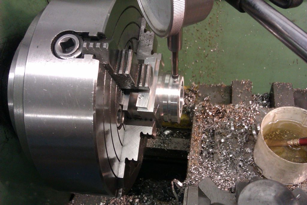

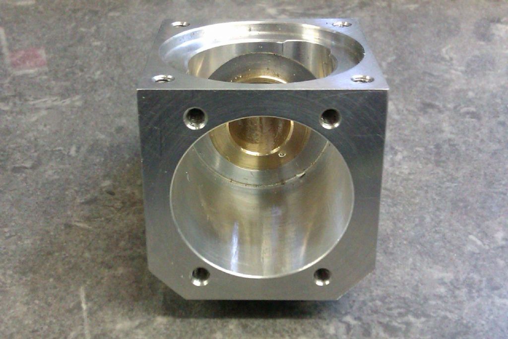

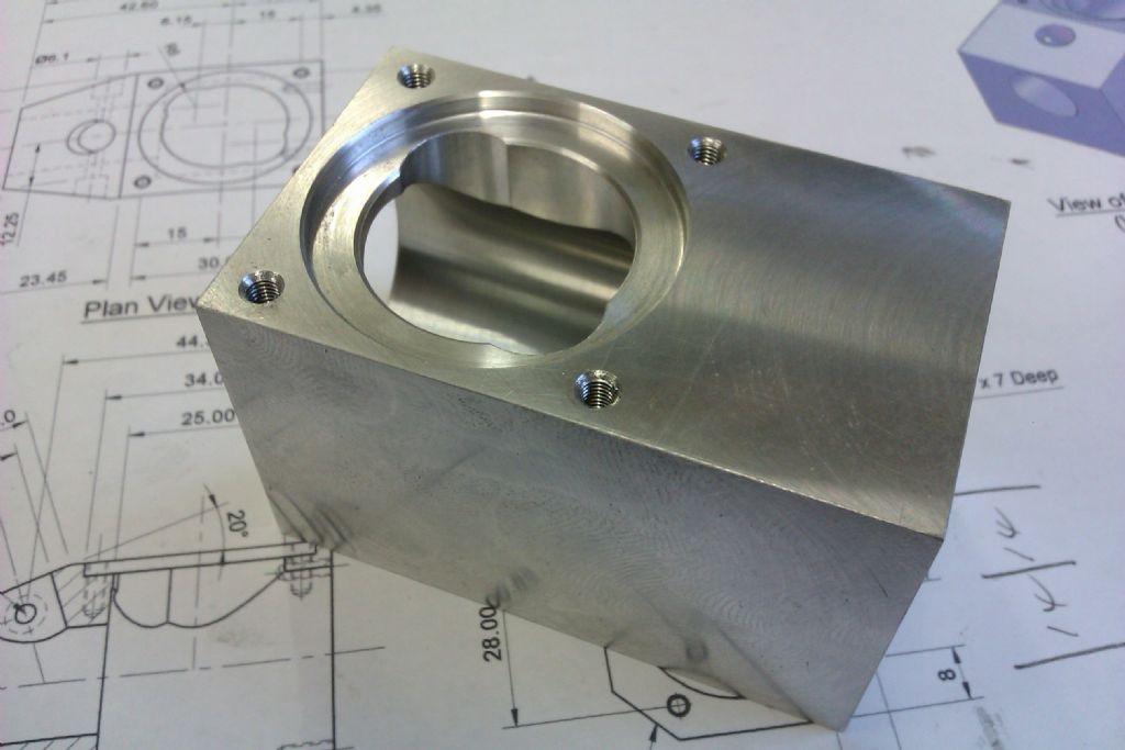

        Crankcase

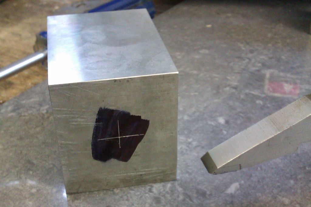

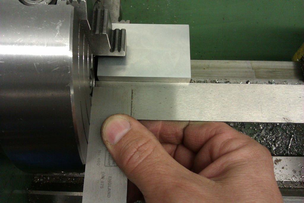

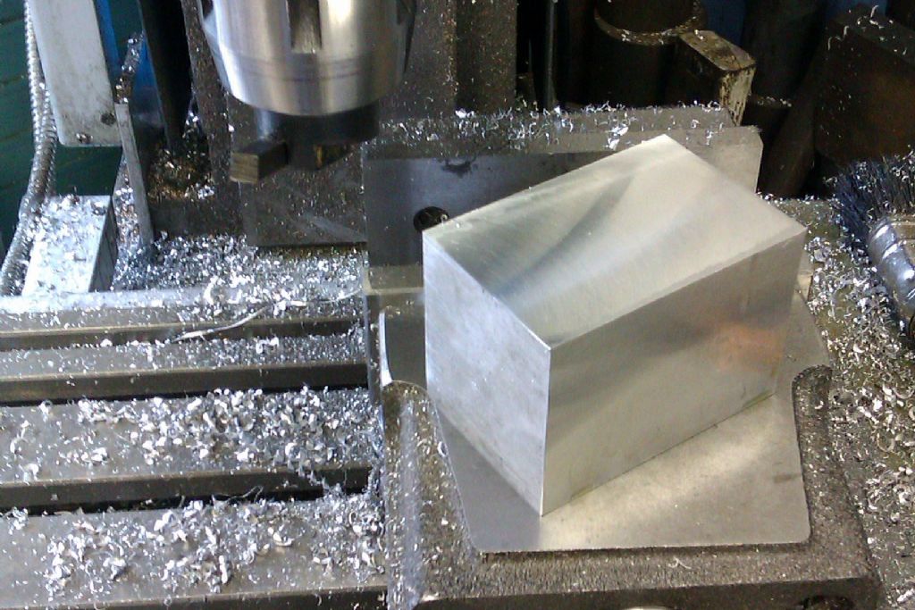

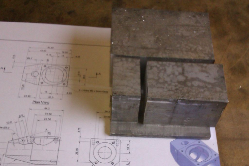

        I had a lump of 2"x4" HE30 that was not used on another project so decided to use this, it was marked out somewhat oversize and one of my woodworking bandsaws made quick work of reducing to size.
        Firefly1

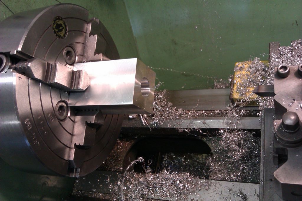

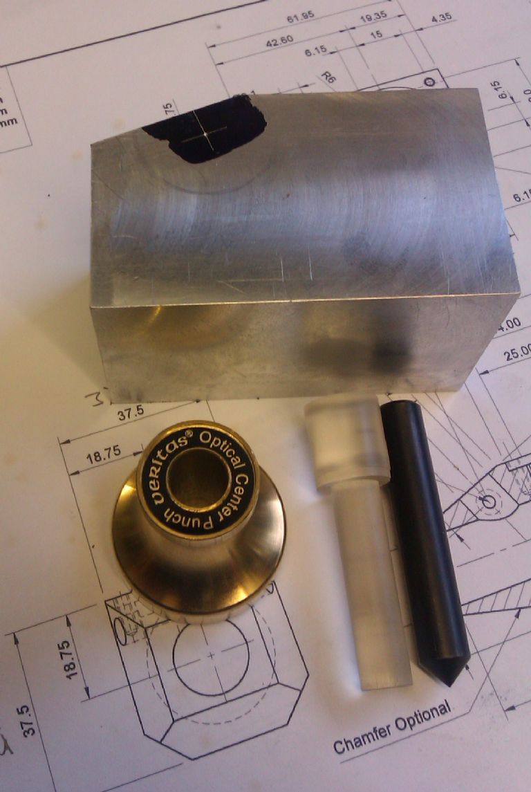

        The rough sawn block was then held in the milling vice and a flycutter used to cut the four edges to 0.5mm oversize.
        Firefly2
        The centre was then marked and punched on the end of the embrio crankcase and then clocked true in the 4-jaw using a sprung centre and dti
        Firefly3

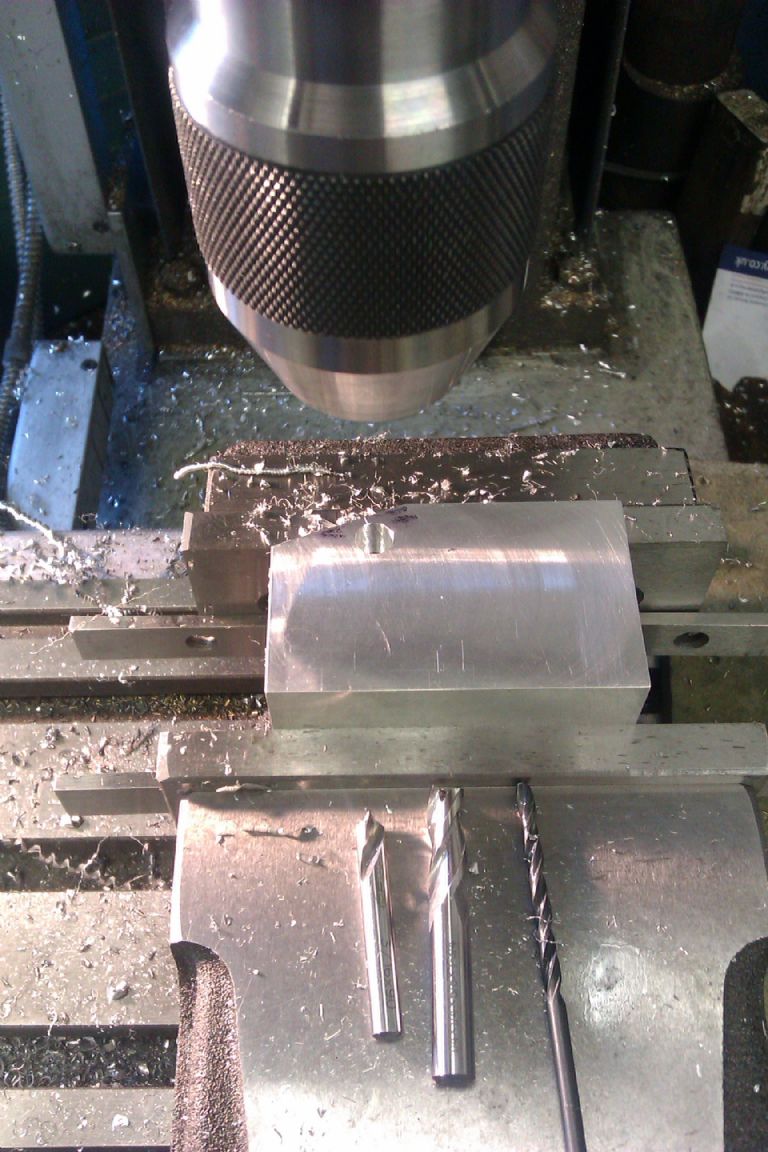

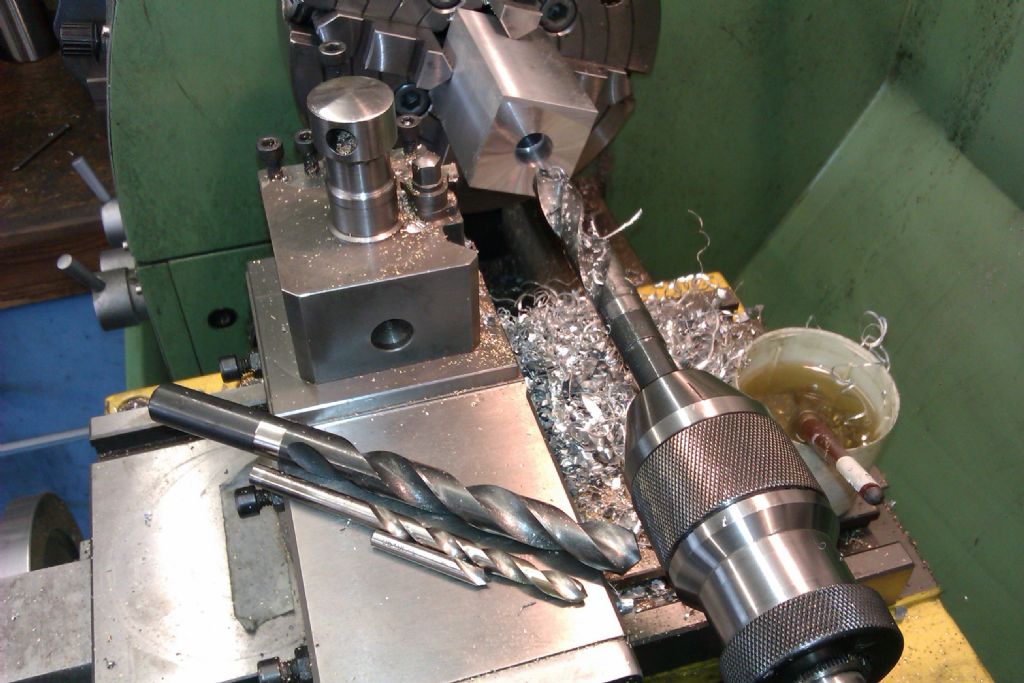

        The majority of the waste was drilled out right through starting with a spot drill then 1/4", 1/2" and 9/16". In hindsight I would suggest drilling 3/4 of the way through only – see later.
        Firefly4

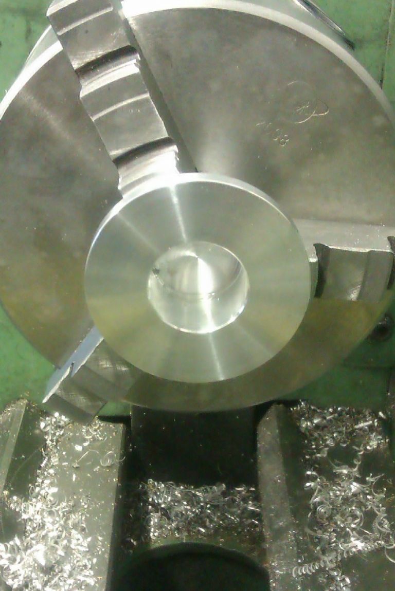

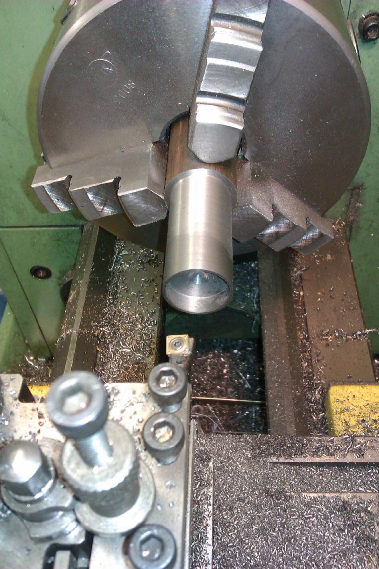

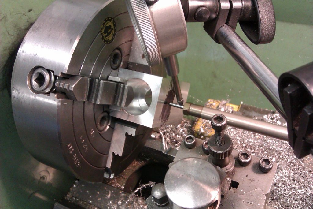

        A boring bar was then used to open the end out to 28.2mm dia and a little longer than needed.
        Firefly5

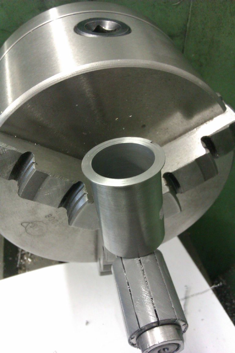

        A depth gauge was then used to check the depth of the 28.2mm hole and the end faced back until finished size was reached. The edge of the hole was then given a slight chamfer to break the edge.
        Firefly6

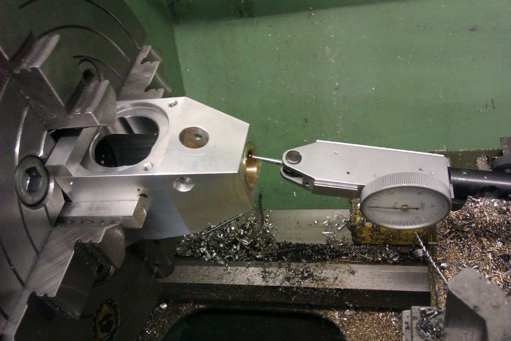

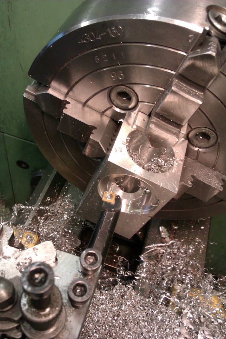

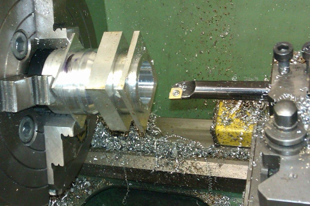

        I then set about boring the 16.6mm hole, as you can see this needs quite an overhang on the bar and even at 1/2" dia I was not getting the type of finish that I wanted so opted to flip the work end for end and use a shorter bar from the other end. If doing it again I would clock the work in and drill 9/16 from the front end before boring to 16.6mm as the 28.2 and 16.6 holes do not have to be perfectly concentric this is not an issue.
        Firefly7
        Here the end has been faced back to get the correct overall length and again the edge of the hole tidied with a small chamferFirefly8
        Cont'd
        Edited By JasonB on 22/01/2021 16:15:02
        #93024

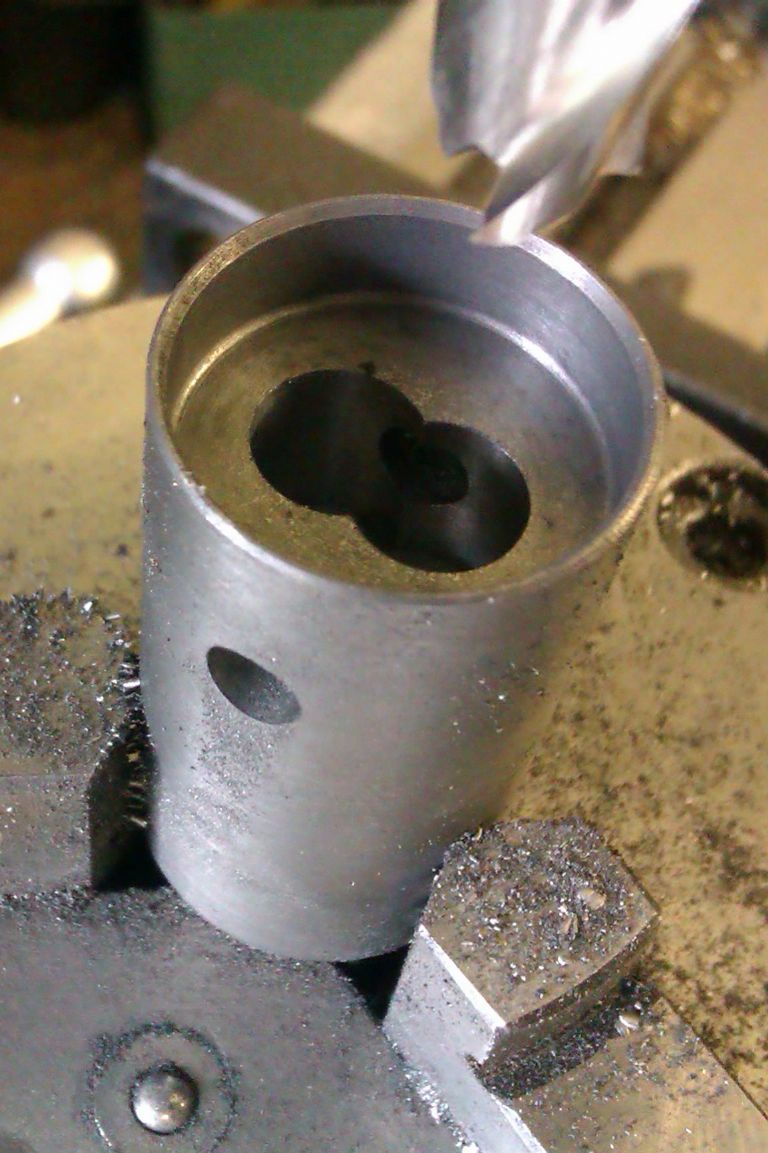

          The position for the cylinder was marked on the top of the crankcase, punched and then again clocked true in the 4-jaw, not packing under the two jaws bearing on the finished ends.
          Firefly9
          The hole was opened out to 5/8" by drilling and then I swapped to a boring bar to cut the 25mm hole and 34mm counterbore, as usual edges broken with a chamfer.
          Firefly10

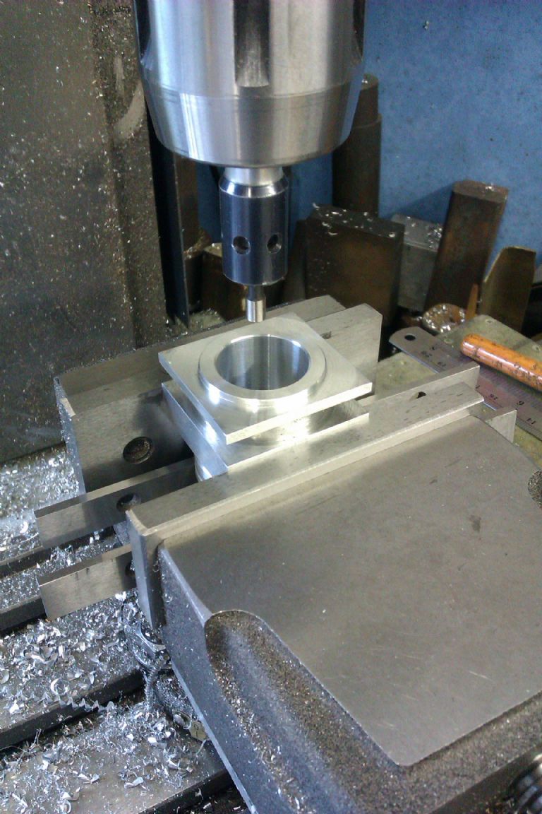

          With the turning done it wa sback to the mill to macine the faces down to finished size. The micrometer was zeroed on a steel ball, then opened up until it read 4.65mm and zeroed again, this made it easy to measure how much needed to come off with the flycutter. A blob of grease stops teh ball going AWOL
          Firefly11

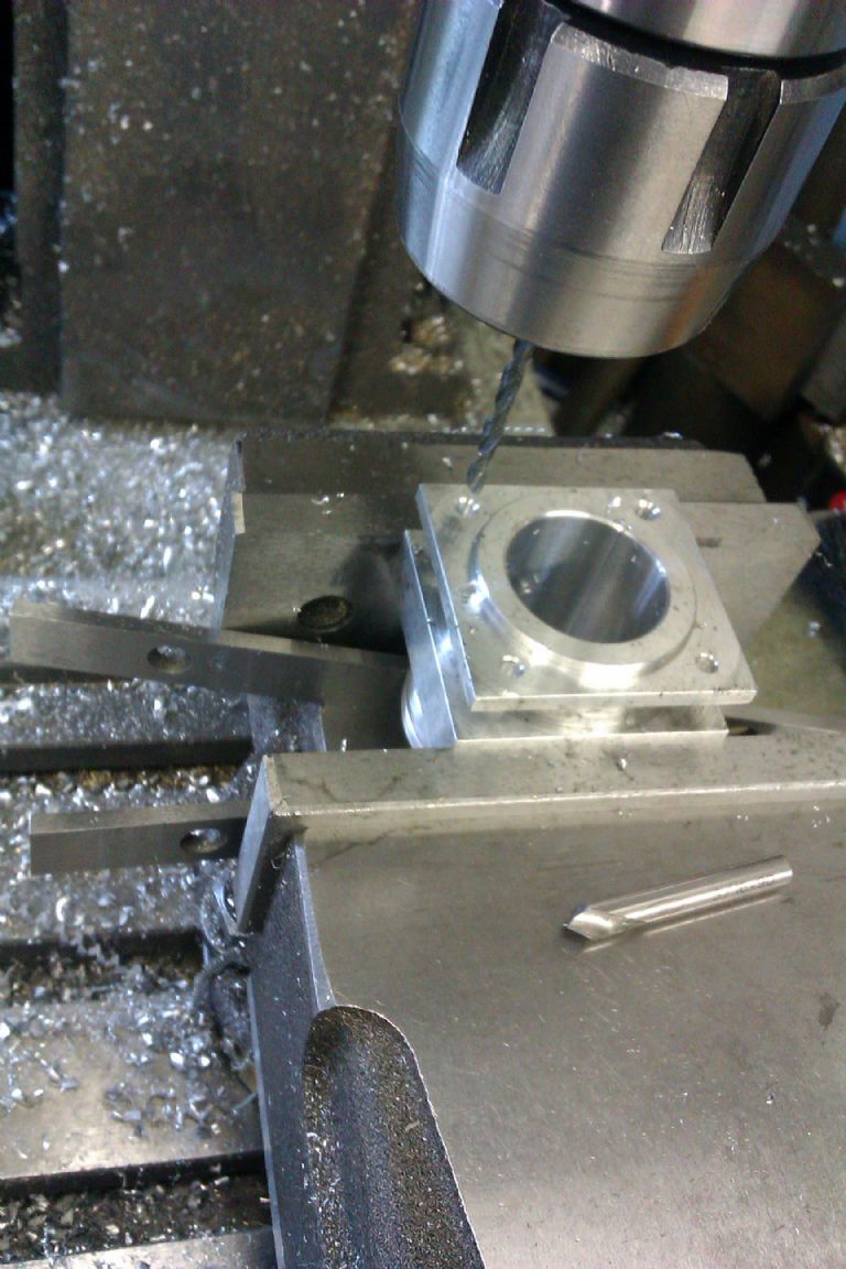

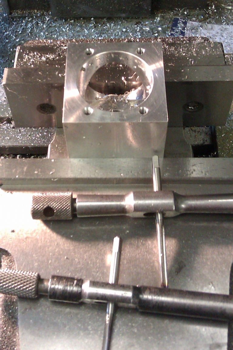

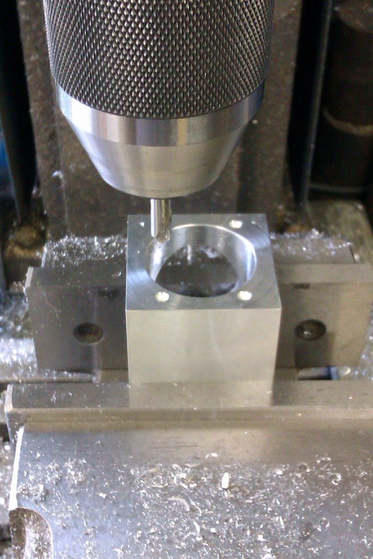

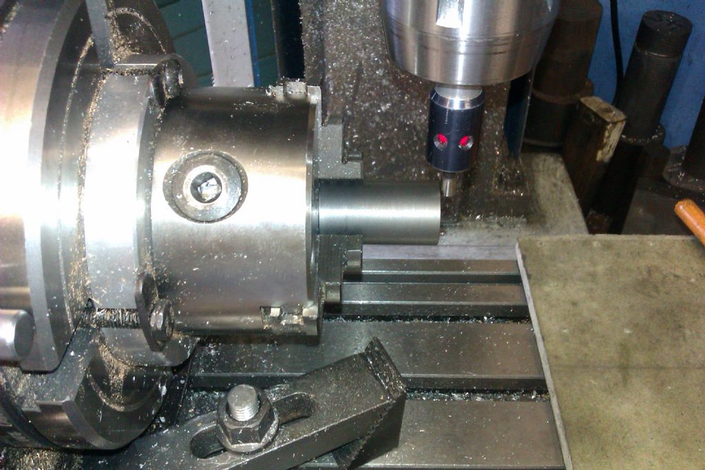

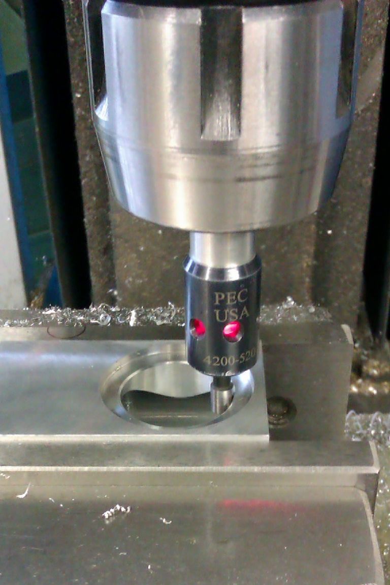

          The crankcase was then held back end up and the centre of the 28.2mm bore located with the aid of an electronic edge finder.
          Firefly12
          The four bolt holes were then heavily started with a spot drill, this has the advantage of giving a clean CSk edge and a start for the drill all at the same time and the CSK is easier to start that trying to do it into a threaded hole after tapping.
          firefly13
          Holes were then drilled 2.5mm and tapped M3 using a light grip in the chuck to keep the tap vertical.
          Firefly15
          Job done
          Firefly15

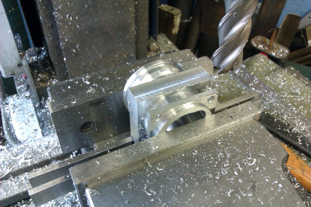

          The same procedure was then used to complete the four barrel mounting holes
          Firefly16
          Firefly17
          As I mostly work in imperial I did not have a sharp enough 12mm milling cutter so used a boring head to cut the two transfer ports.
          Firefly18
          And there we have the crankcase ready to recieve the bearing.
          Firefly19
          Cont'd

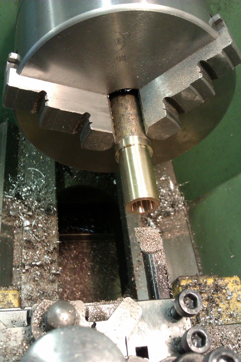

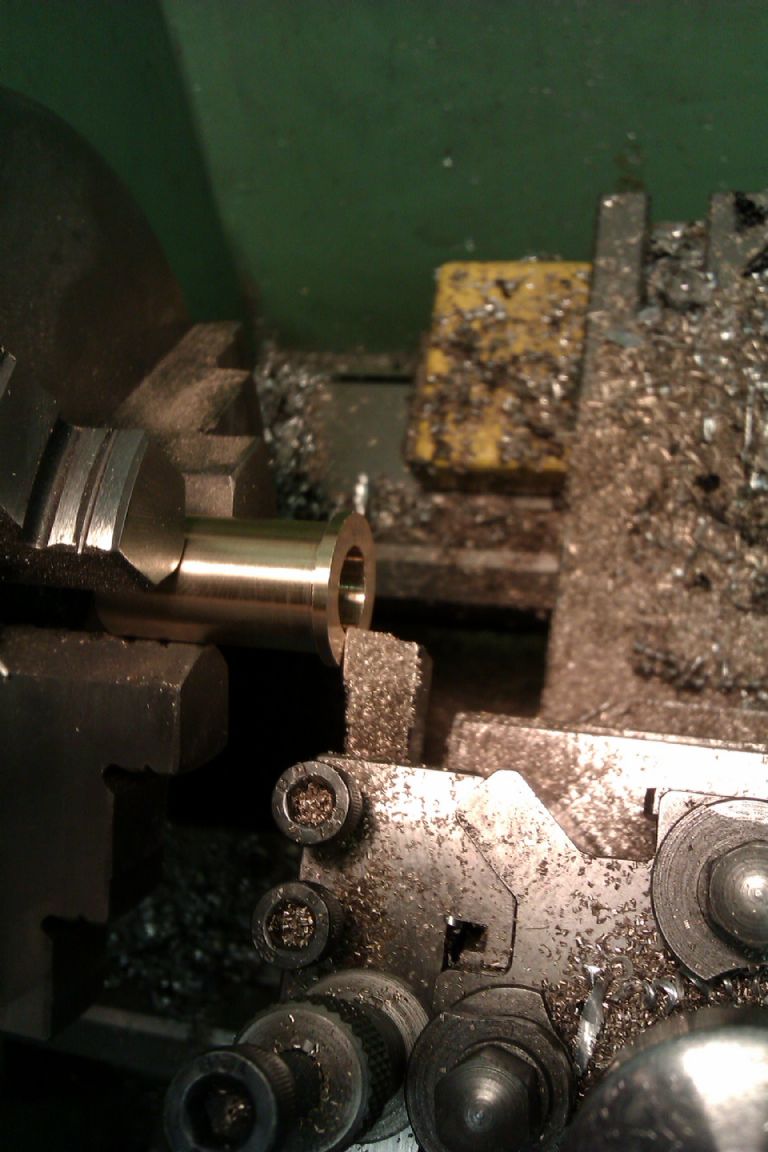

            Bearing

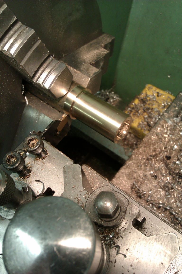

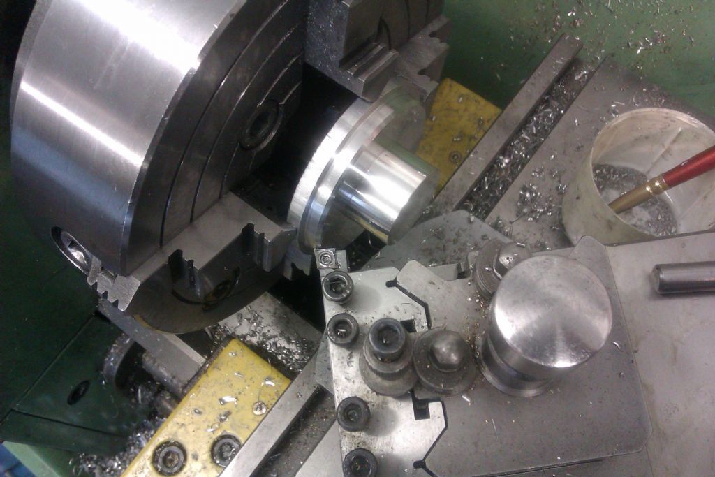

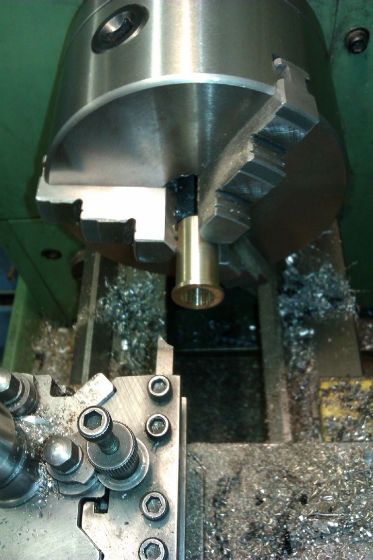

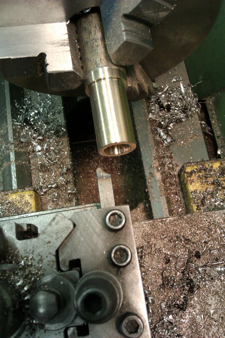

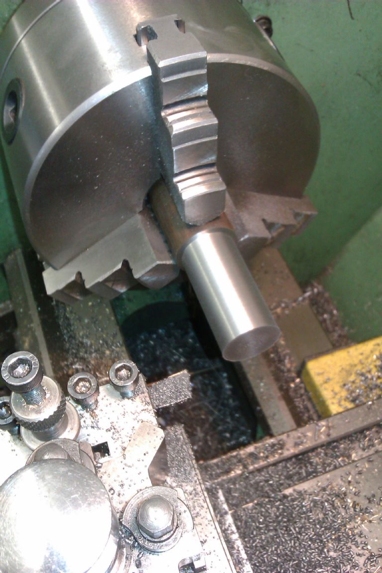

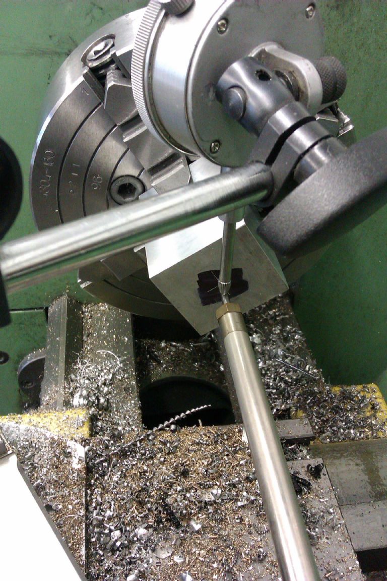

            Talking of Bearings I started out with a stick of 3/4" nominal bar and took a light skim along it which gave a dia of 19.6mm, this will be close enough to the required 20mm. The end sawn end was then faced.
            Firefly20
            The outside was then reduced to to give a good press fit into the crankcase, measure from job. Inside was drilled then bored out to 12mm, check the outside dia again after boring as the bearing may have grown.
            Firefly21
            The length was then faced back to finished size
            Firefly22
            And as usual edges broken with the chamfering tool.
            Firefly23

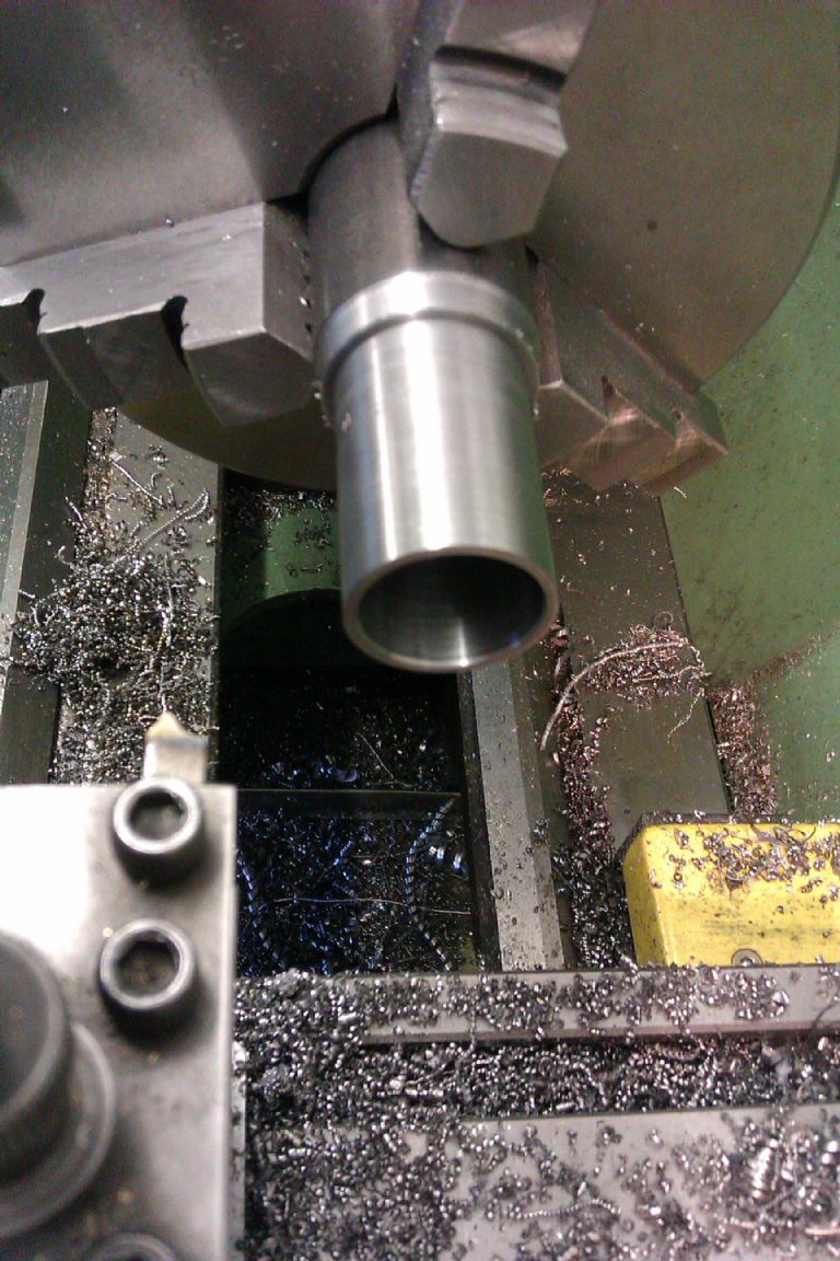

            Part off a little overlength
            Firefly24

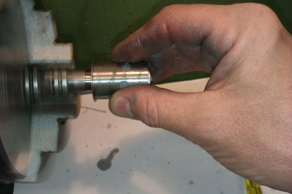

            Reverse in the chuck and lightly grip while the flange if faced to size and finish with more chamfers.
            Firefly25
            Firefly26
            Cont'd

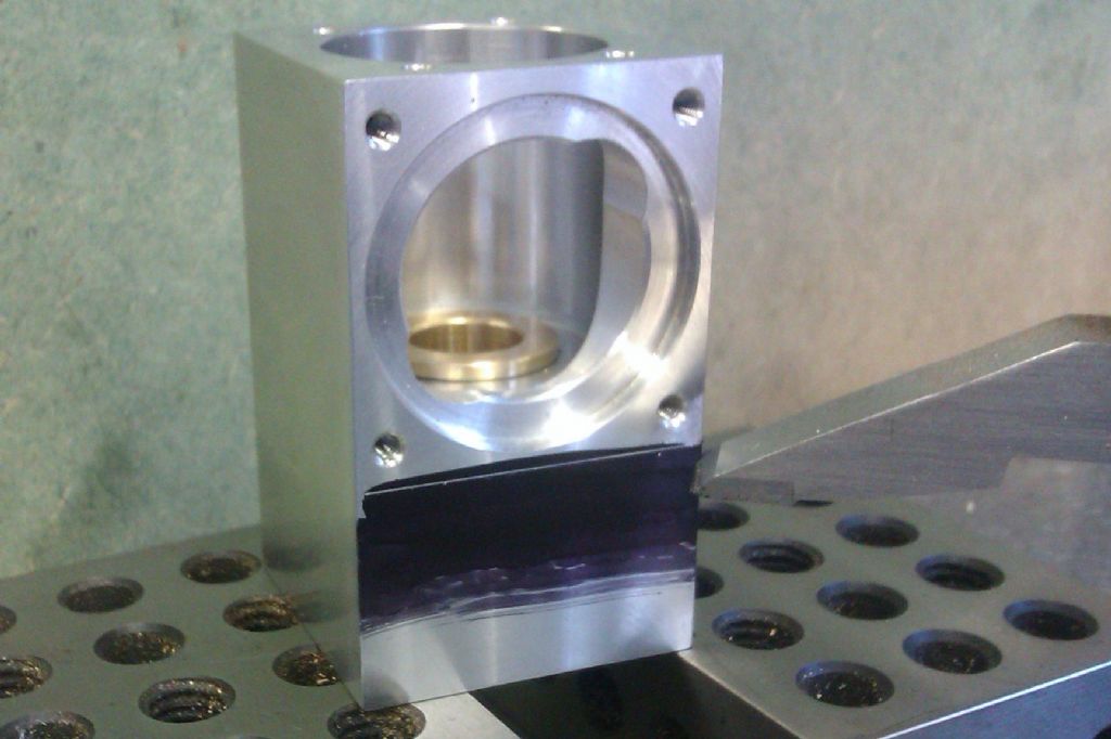

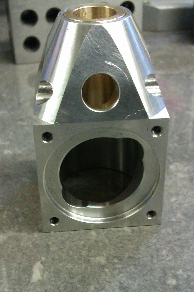

                The completed bearing was then pressed into the crankcase using a vice, put a washer or similar on the end as the bearing needs to protrude slightly beyong the end of the case, I used part of a ballrace.
                Firefly28

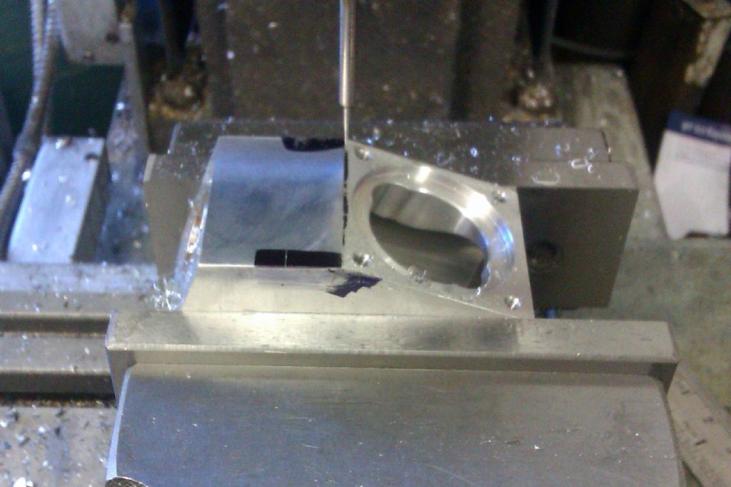

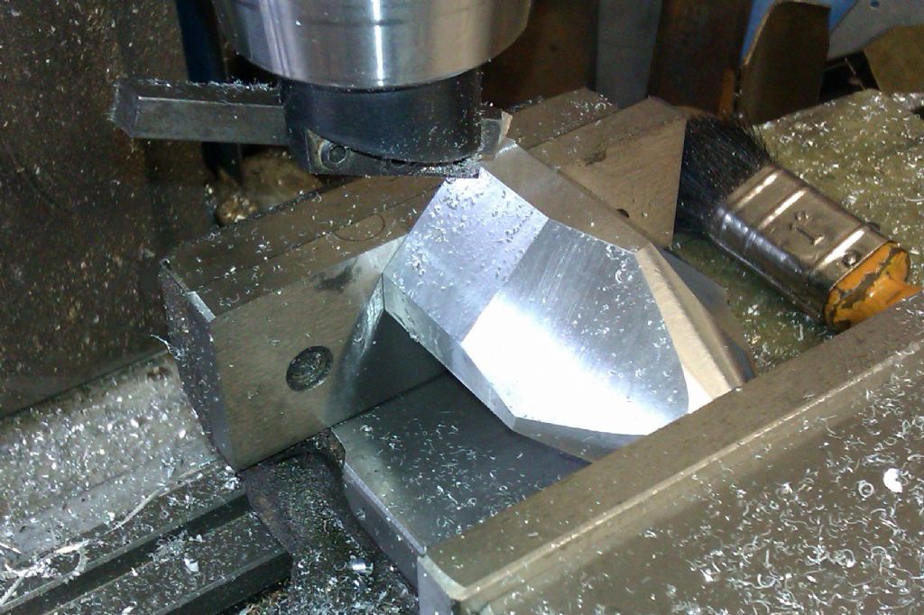

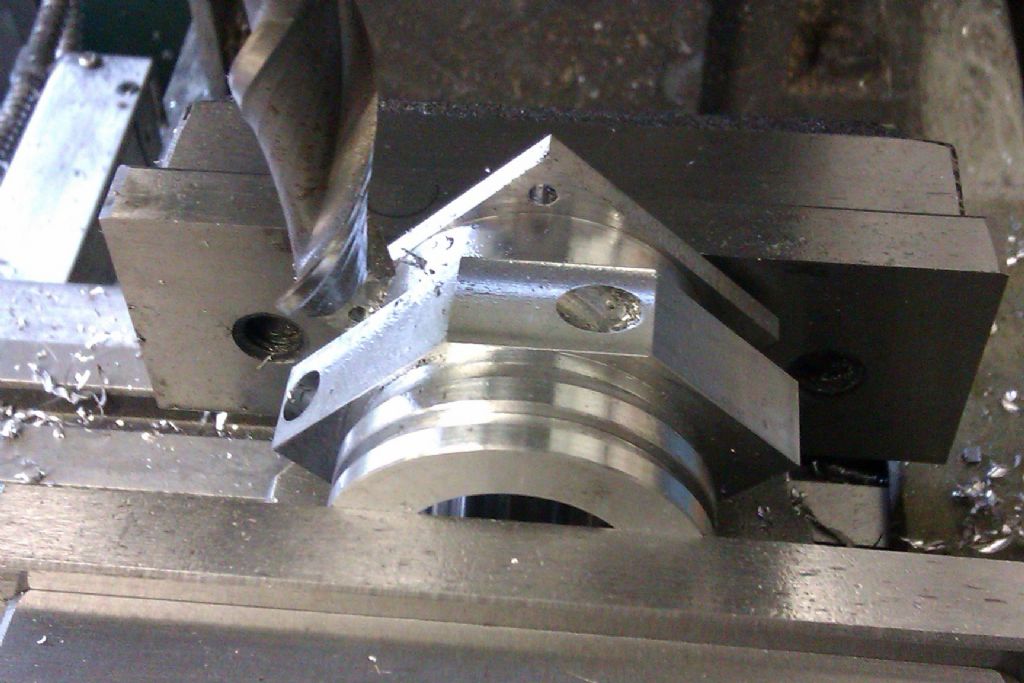

                The next job was machining the chamfer on the top of the crankcase, start by marking a line 23.45mm from the front face.
                Firefly 29
                Then mount the work in the milling vice at 20deg not the 20.1 that the photo shows, the right one wa sout of focus. The bit of steel flat gives the magnet of teh angle box something to stick to.
                Firefly30

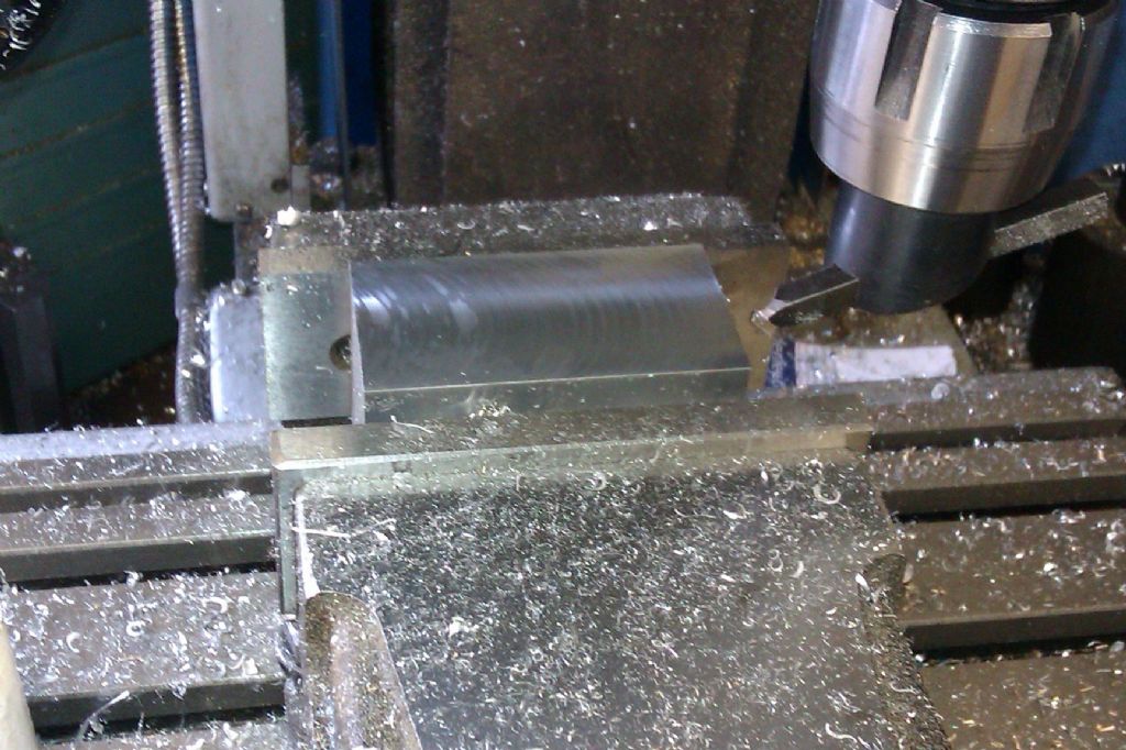

                Flycut away the waste until the new face meets the previously marked line.
                Firefly31

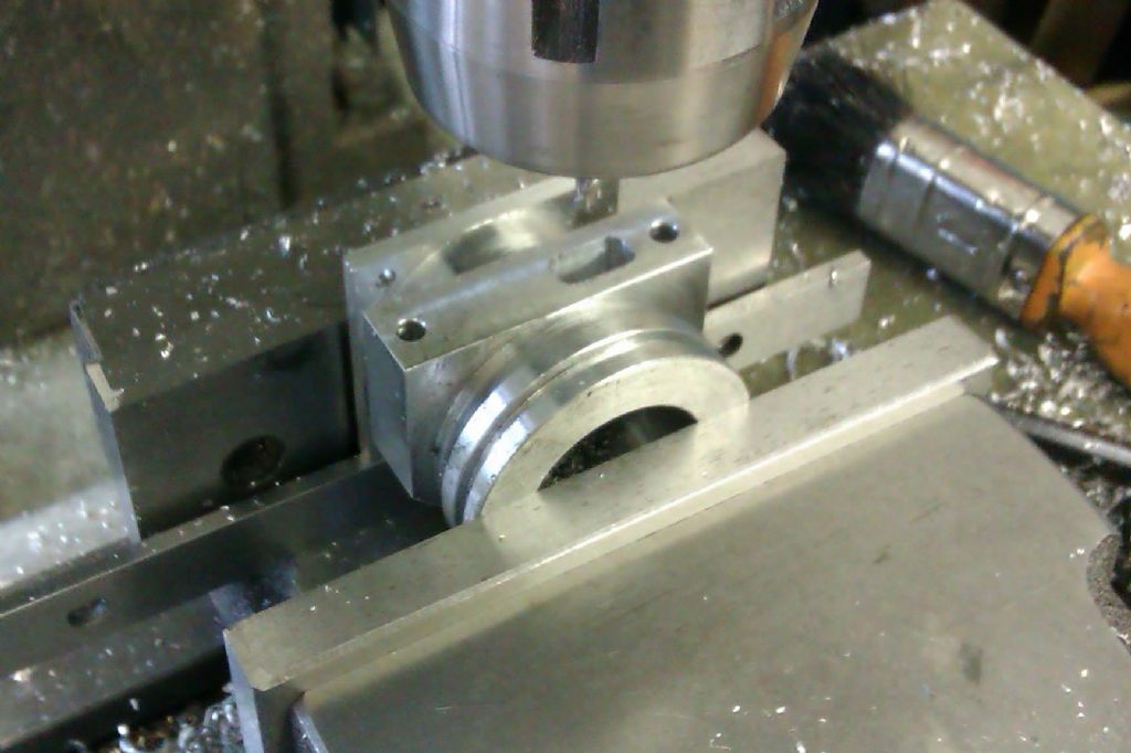

                Pick up the junction of the two faces with a centre finder and then crank back 8mm to locate the carb hole.
                Firefly32

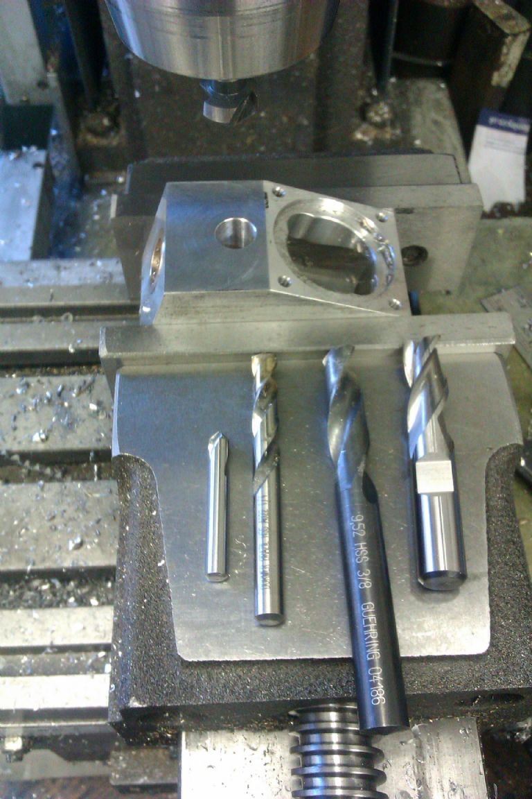

                Form carb hole, I went spotdrill, 1/4" & 3/8" drills followed by 10mm FC-3 cutter. Lock the quill and feed down the head or up with the knee so the tools won't snatch as they break through the bronze at an angle. Then use a CSk to just tidy the edge.
                Firefly33
                Mark out the two carb retaining screw holes and lightly punch
                Firefly34
                Back in the mill locate the dot punch mark with a center finder, spot drill, drill 3mm and counterbore with FC-3 cutter, I used 1/4" . Repeate for other side
                Firefly35
                Con't
                #93093

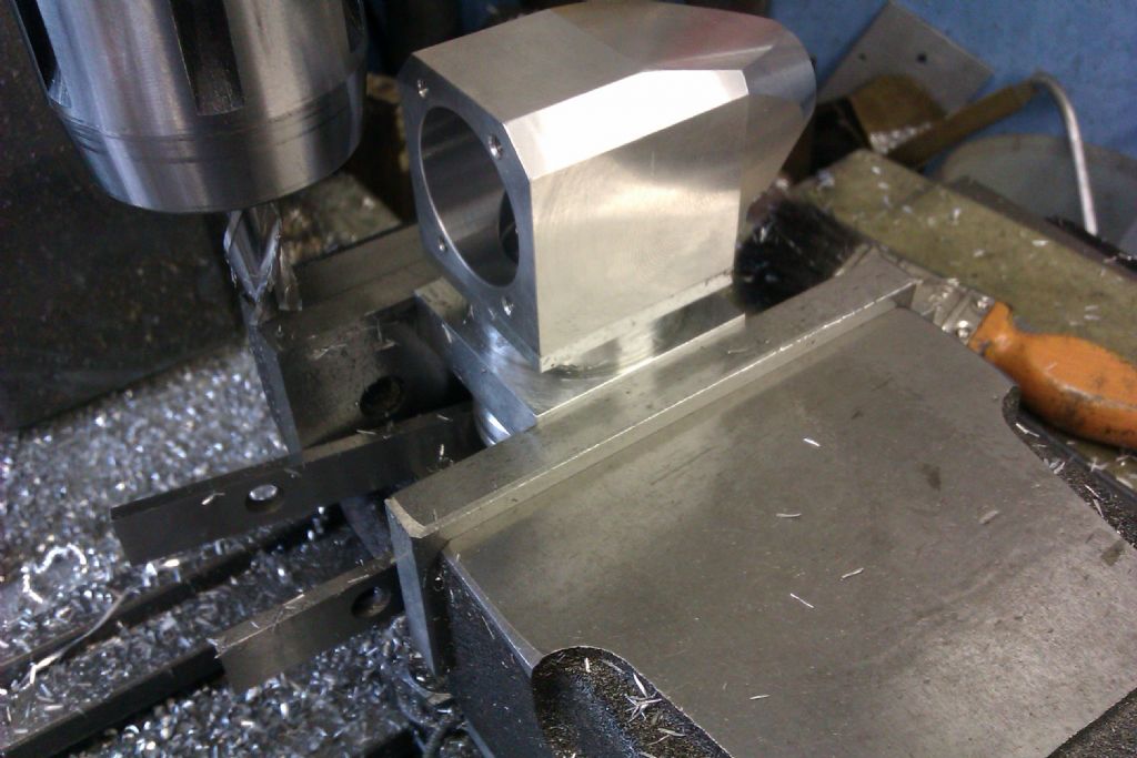

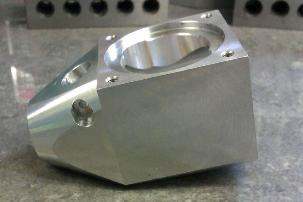

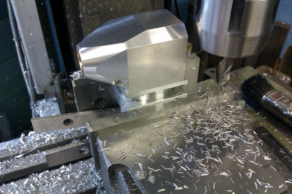

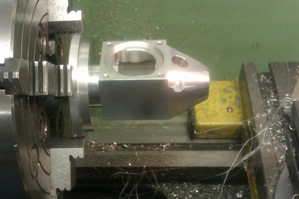

                  Flycut the remaining three chamfers, I went for a slightly different length on teh sides to that shown on the drawing. The angle is not shown on the drawing but should be 17deg and the length of the slope stops 22mm back from the front of the crankcase.
                  Firefly36

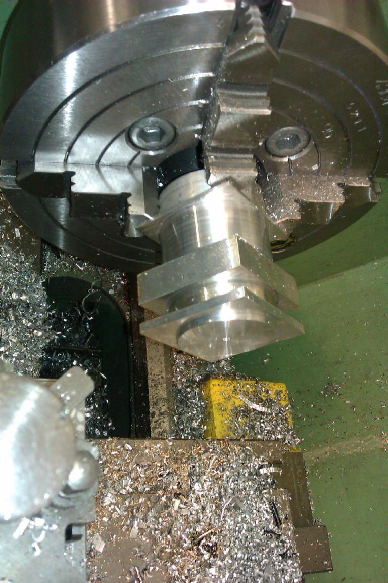

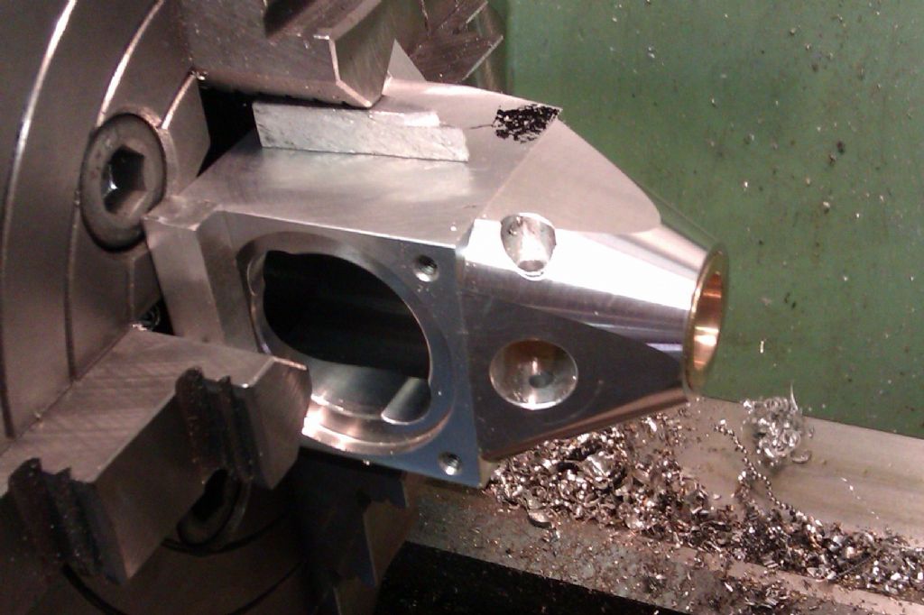

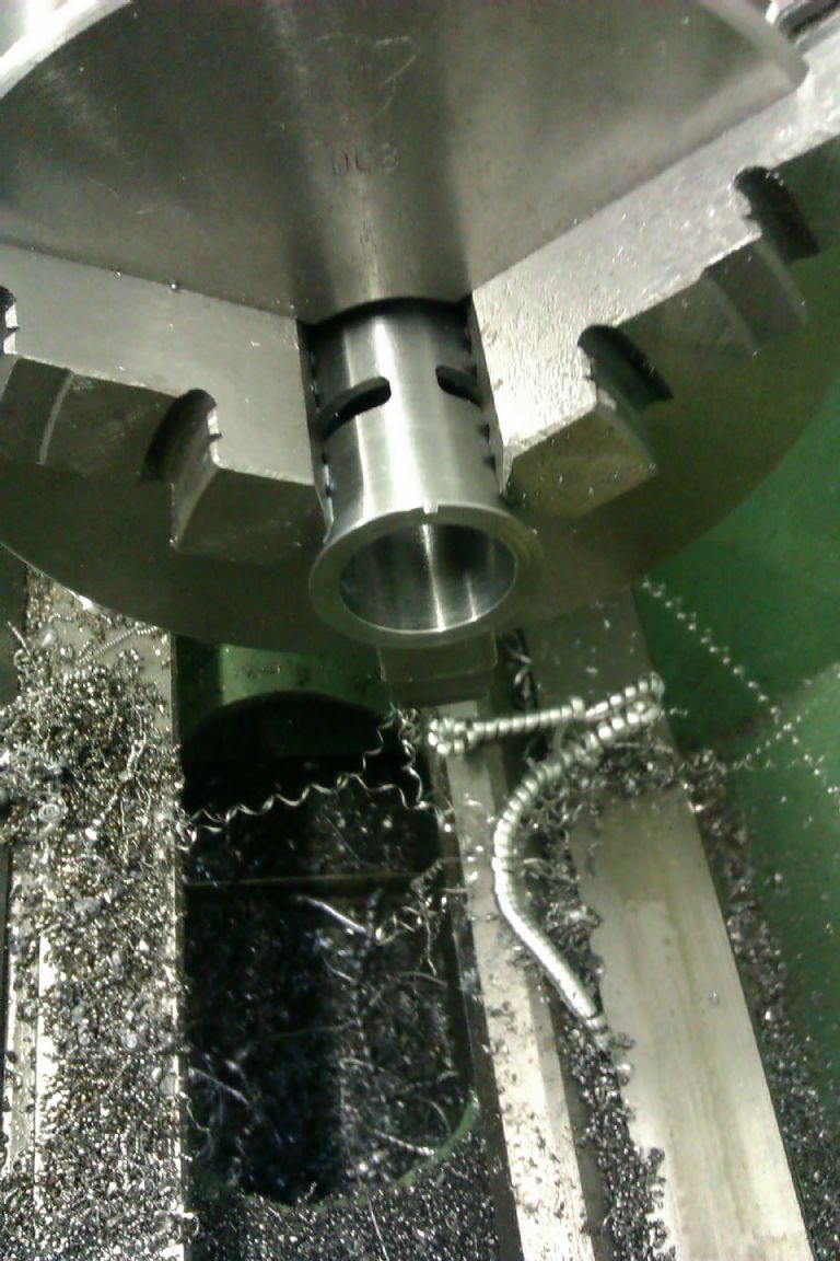

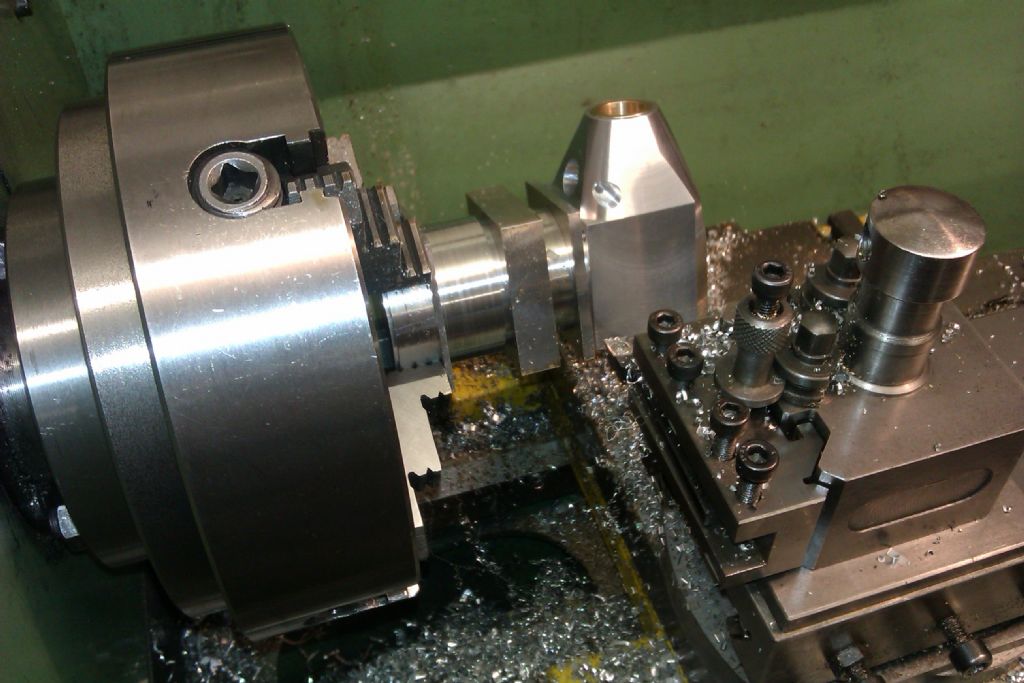

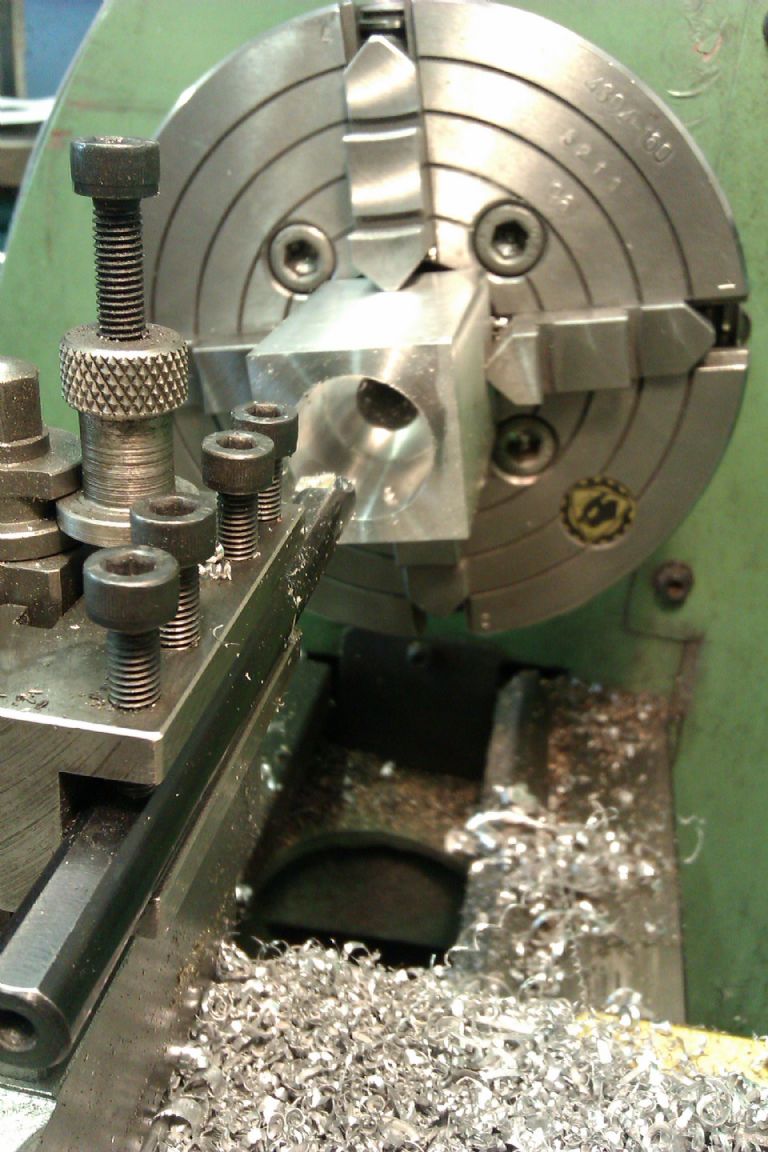

                  I decided on a turned nose so mounted the part back in the 4-jaw, use some packing to save marking the finished faces and clock the bore to run true.
                  Firefly37
                  Set the topslide and turn a taper thats pleasing to the eye, mine was about 27deg by the time I had adjusted it a couple of times to get the turned section to run out where I wanted.
                  Firefly 38
                  Finally back to the mill for the two 45deg chamfers along the bottom edges, mine are a bit smaller than the drawing as I wanted the edge to meet one of the facets on the front cone.
                  Firefly39
                  And thats the crankcase complete. I may do a bit of blending of the faces later and once all is complete a final clean up of all surfaces will be done.
                  Firely40
                  Firefly41
                  Firefly42
                  Firefly43
                  Cont'd

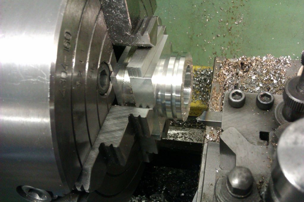

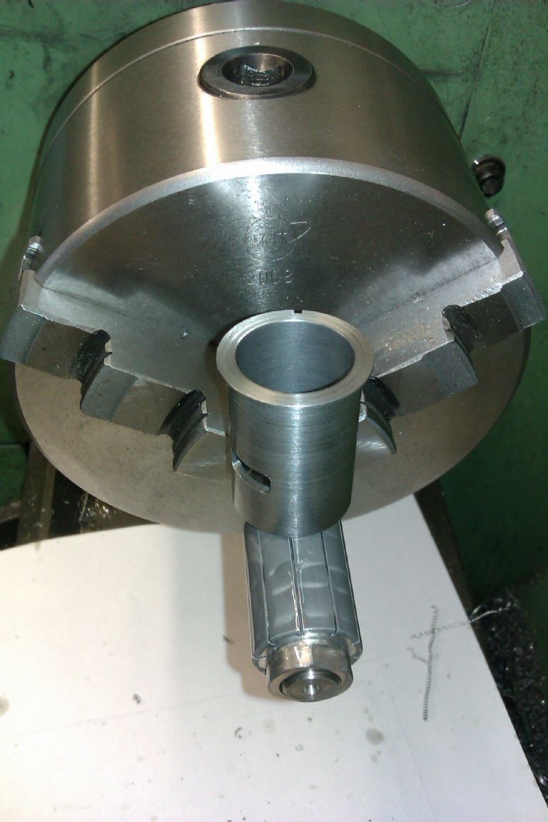

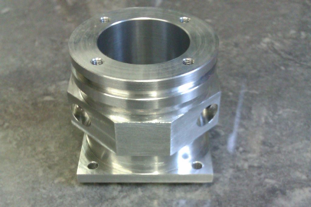

                        Barrel

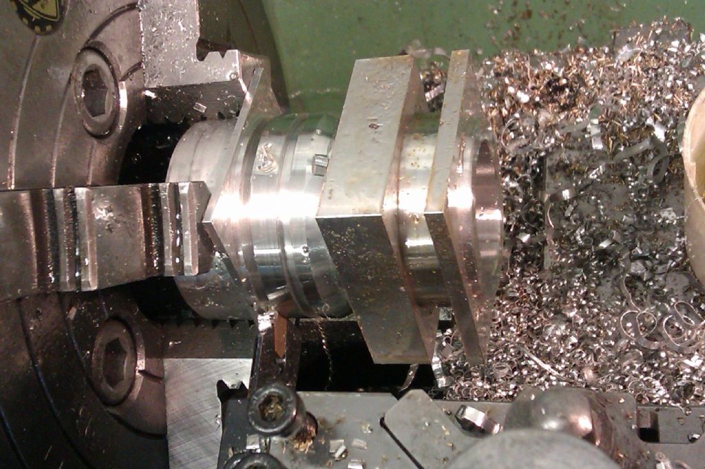

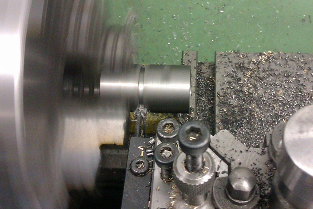

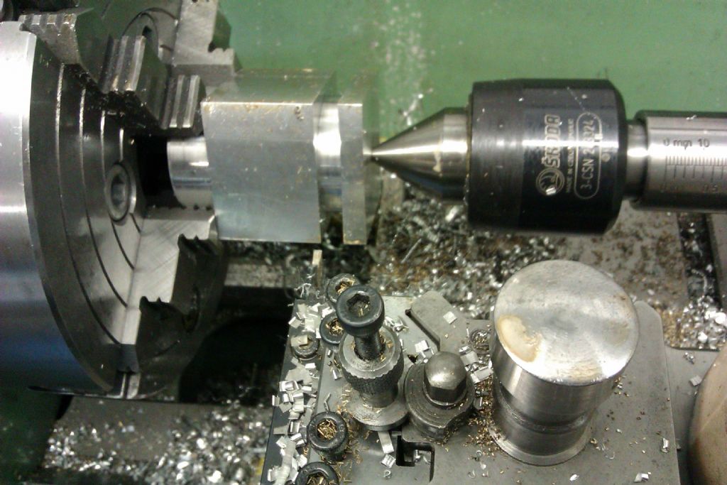

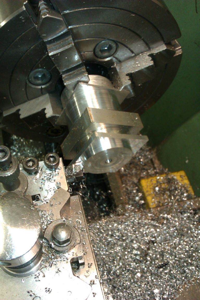

                        I cut another piece of the lump that I used for teh crankcase and machined it up on 4 sides to 44×41 to give 0.5mm each face to play with and plenty of length to go in the chuck.
                        Firefly44
                        The centre was marked on one end and then dot punched

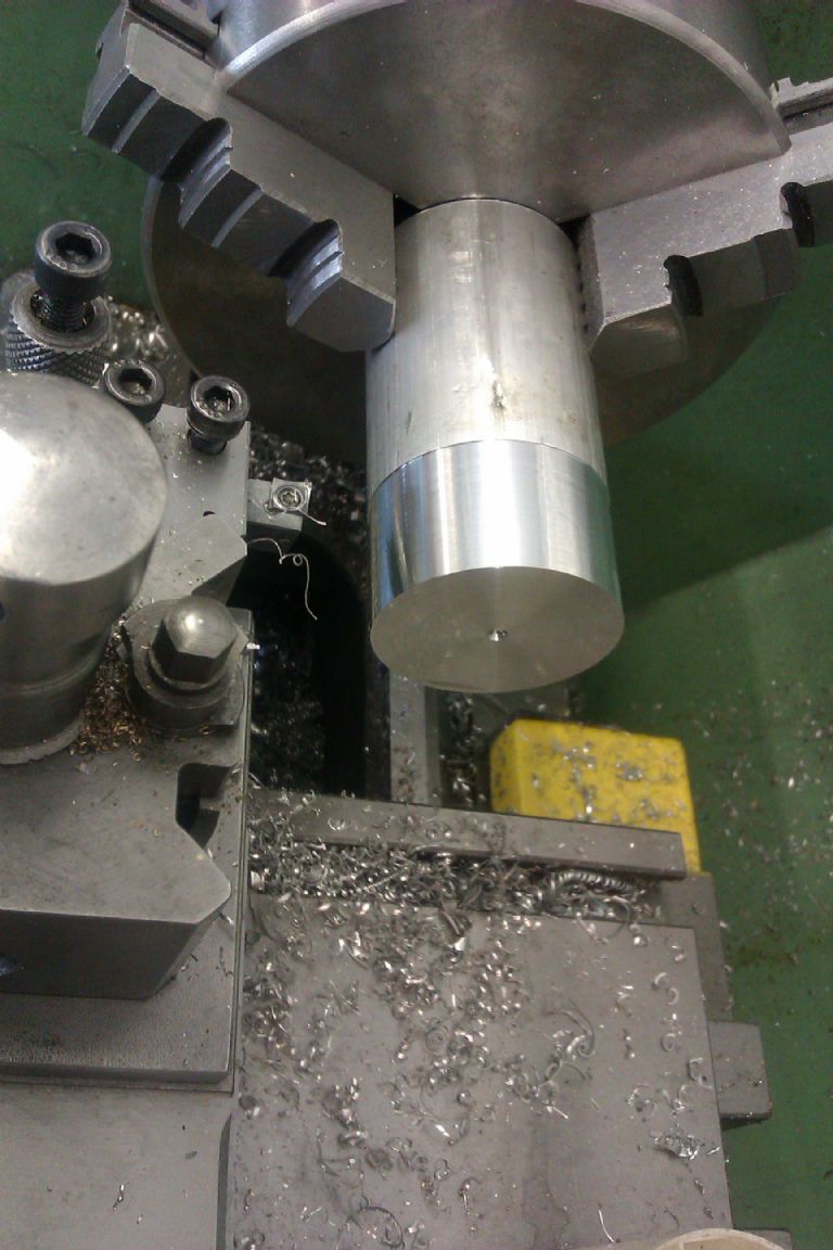

                        Firefly45

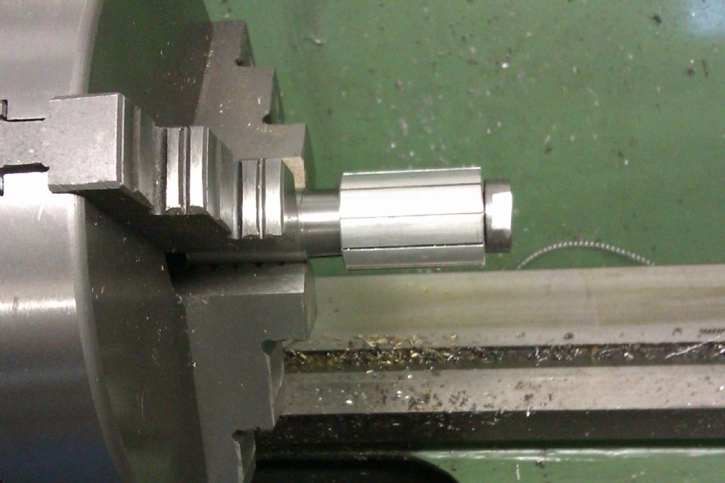

                        The piece was then set up in the 4 jaw using a dti to get the centre to run true while also making sure it was square to teh lathe axis
                        Firefly46
                        Firefly47

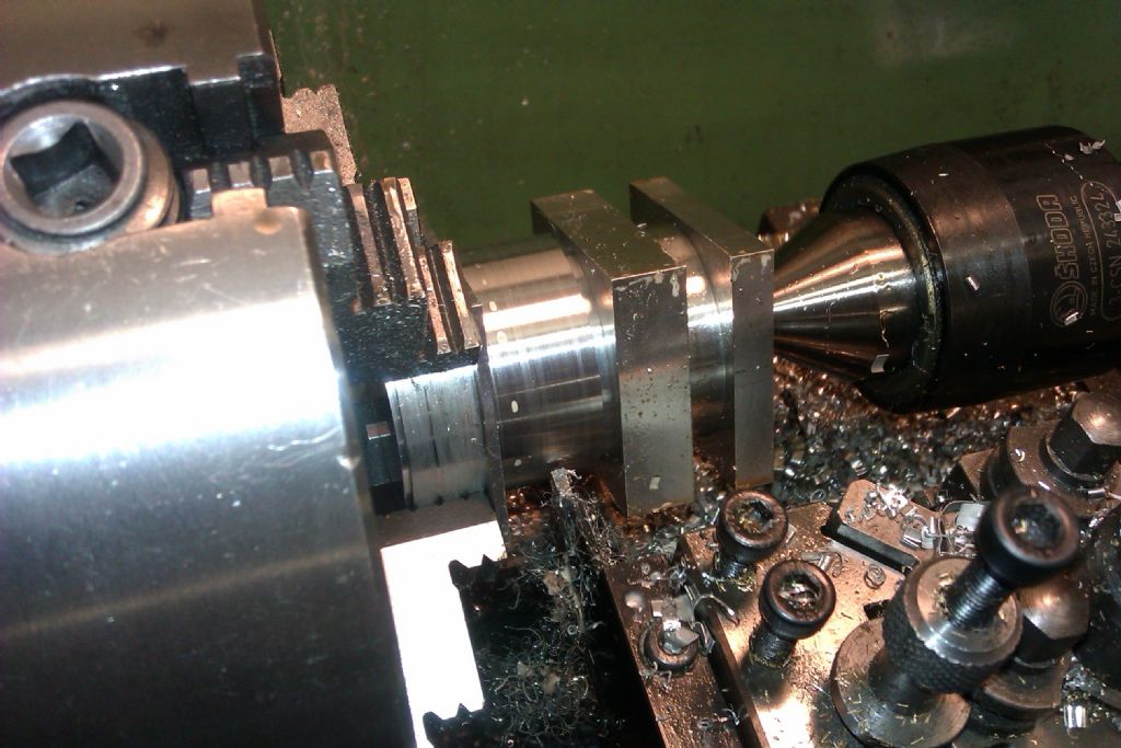

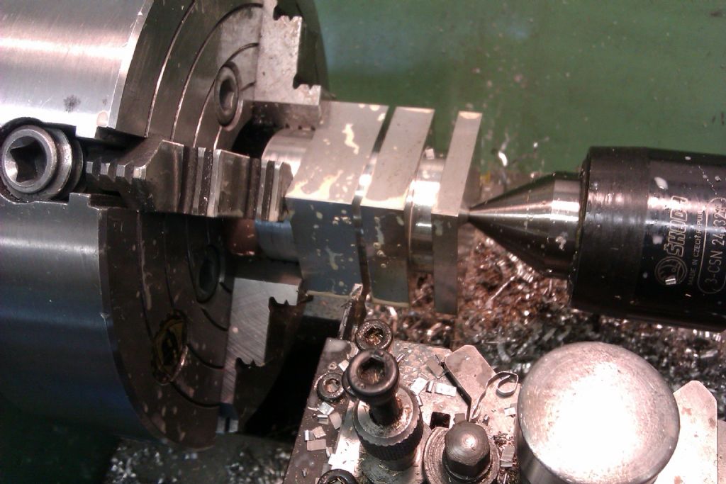

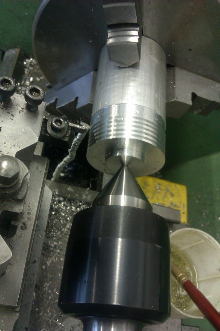

                        The end was then faced and deeply centre drilled and the tailstock centre brought up for support. A parting tool was then used to establish the top of the mounting flange and underside of the exhause block.
                        Firefly48
                        Then the same tool used to cut the top face of the exhaust block
                        Firefly49
                        And then most of the material between this cut and the chuck removes, I used a series of plunge cuts and then traversed with the parting tool to remove the last 0.2mm
                        Firefly50
                        The tailstock centre was then withdrawn and the flange machined to thickness and , the spigot was machined to fit the cranckcase testing to get the right fit.
                        Firefly51
                        Firefly52
                        And with the dia correct the spigot was trimmed back to 2mm long
                        Firefly53

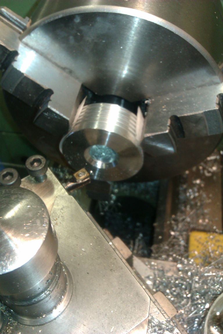

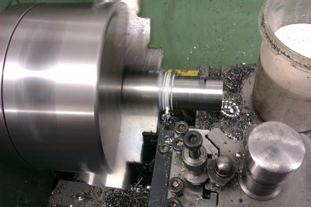

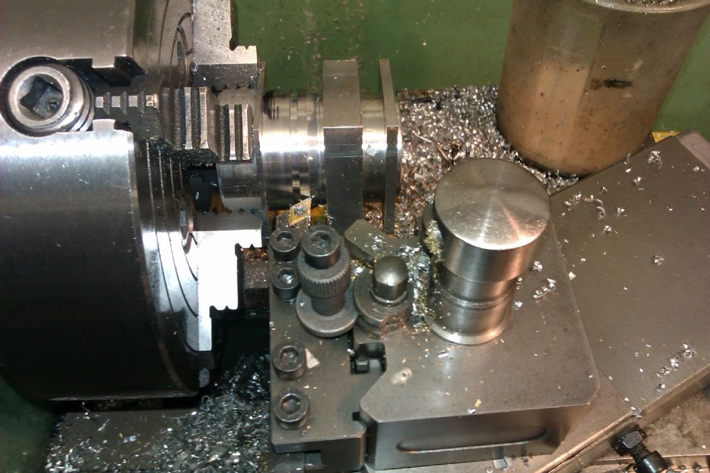

                        With the tailstock back in place the grove and chamfer around the top of teh barrel were machined
                        Firefly54
                        Cont'd

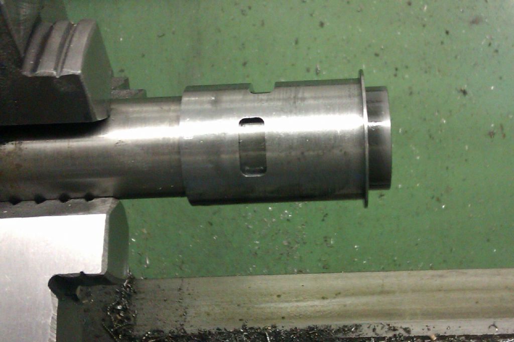

                        #93258

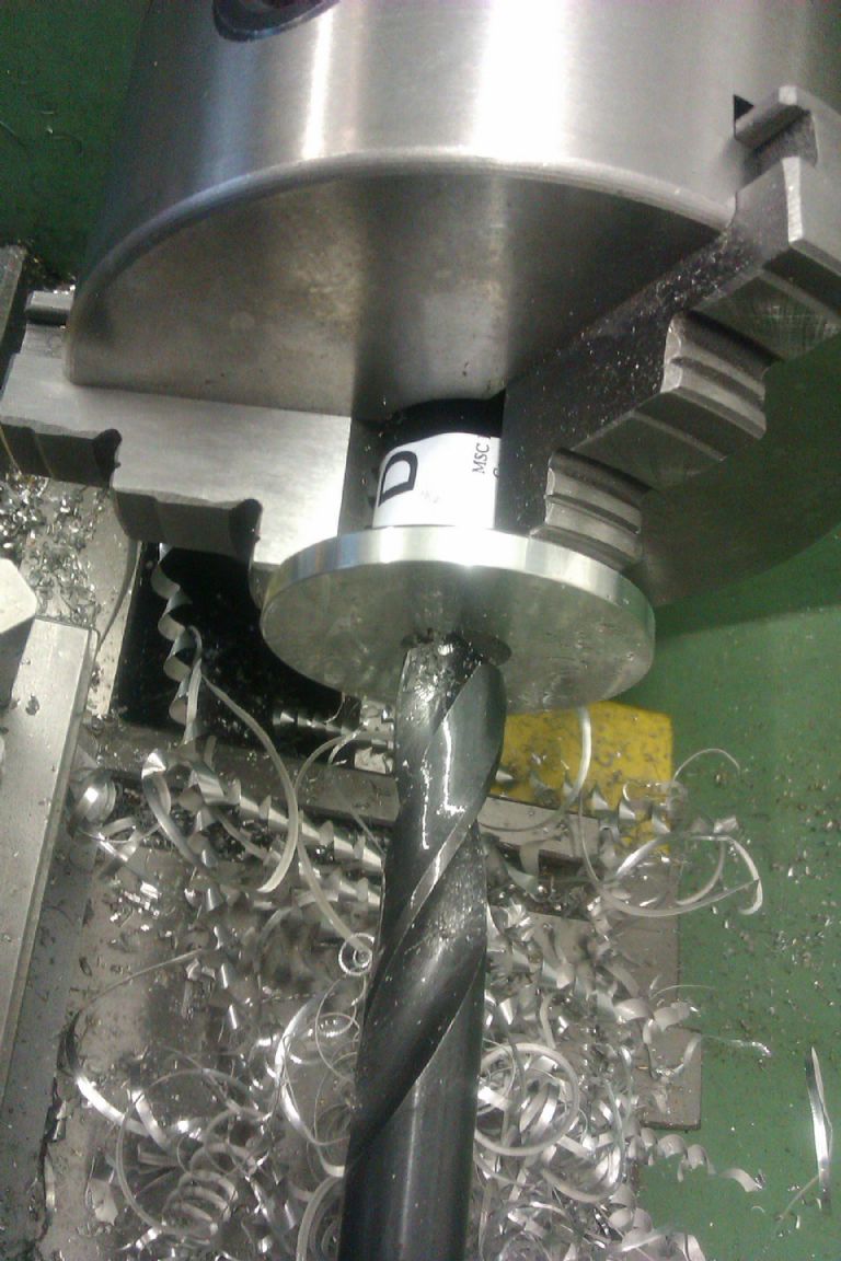

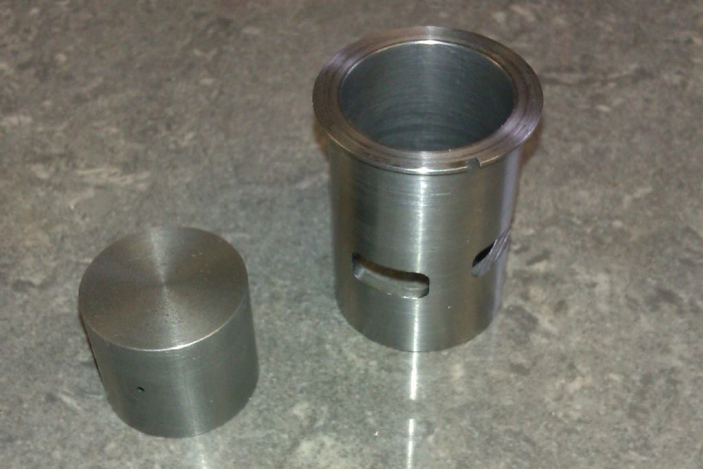

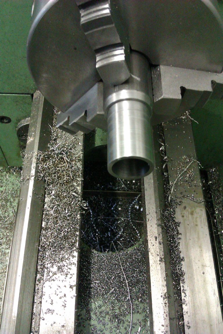

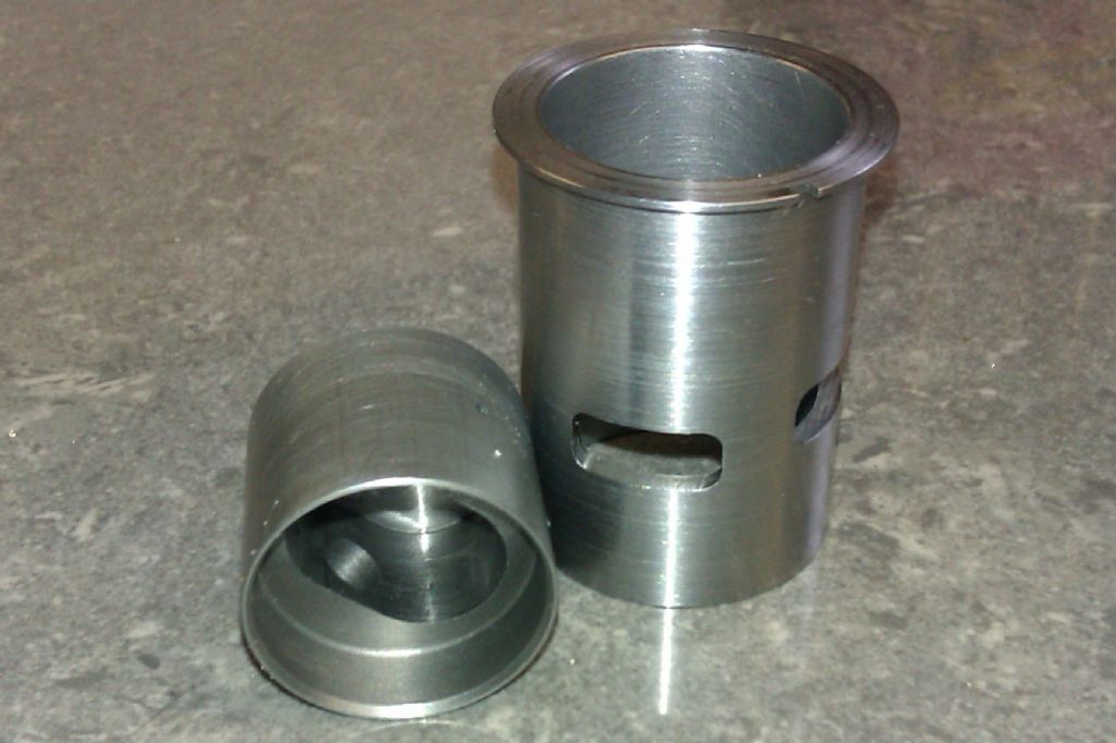

                          With all the external turning done the inside was drilled out in steps to 5/8" and then bored to 25mm.
                          Firefly55
                          The edge of teh hole & spigot were chamfered and then the whole thing parted off a bit overlength, I parted most of the way through then completed with a saw rather than have the finished part drop.
                          Firefly56

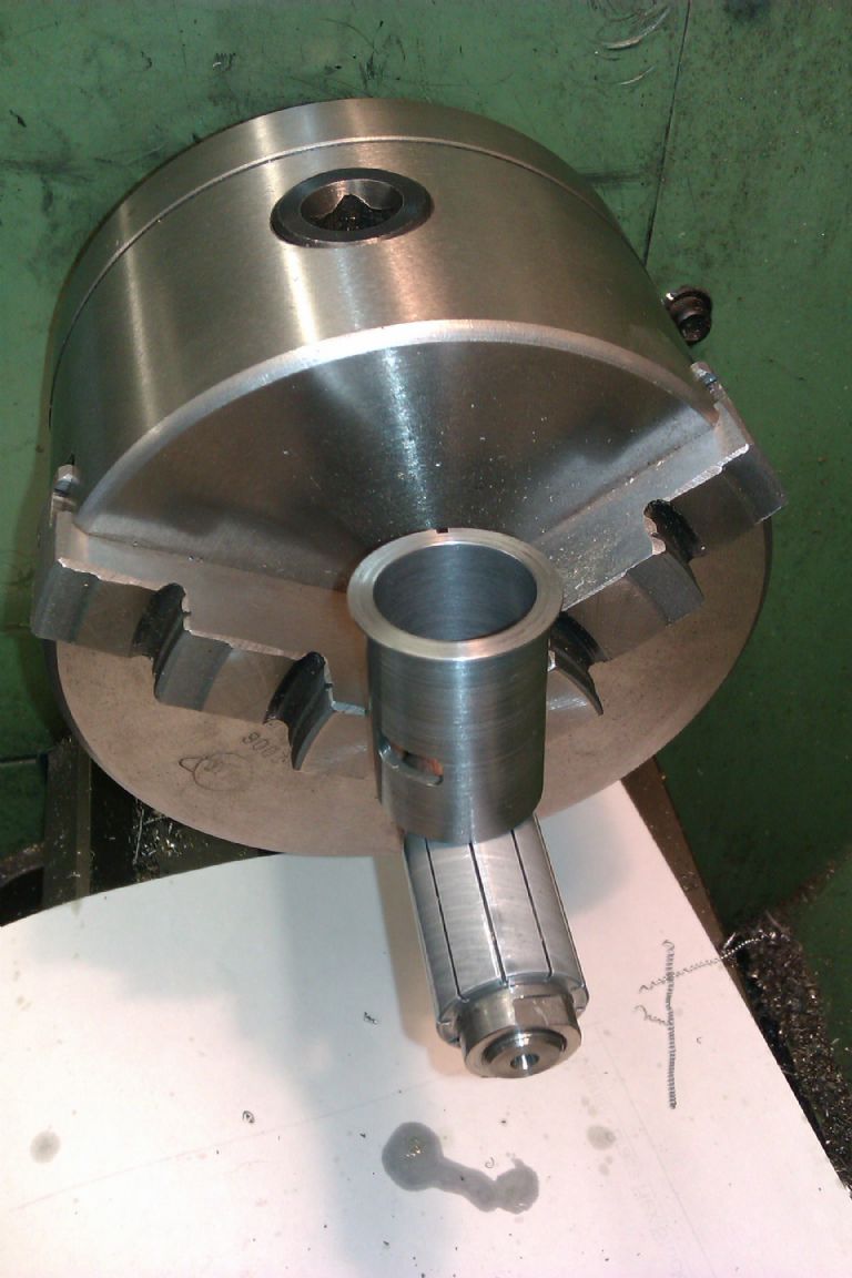

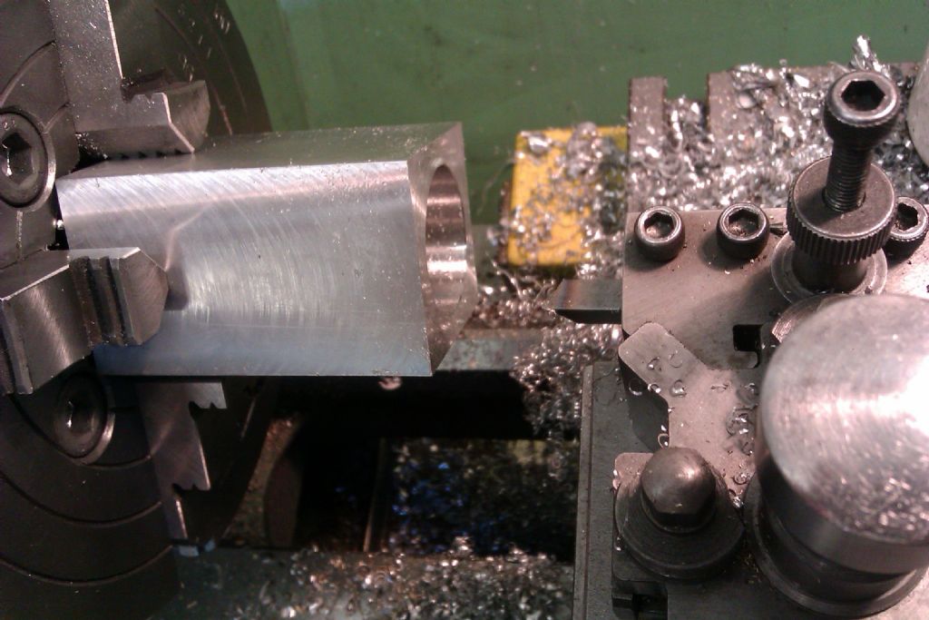

                          With the top facing out the barrel was clocked true in the chuck
                          Firefly57
                          Then faced back to finished length and the edges chamfered
                          Firefly58

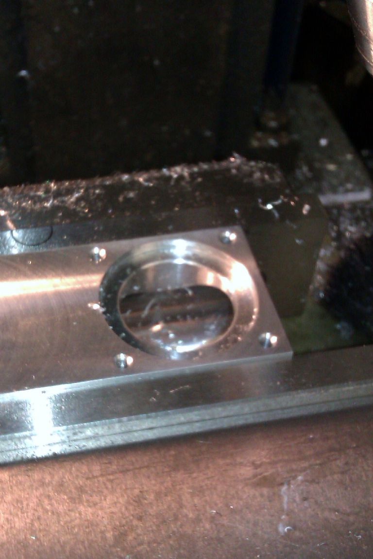

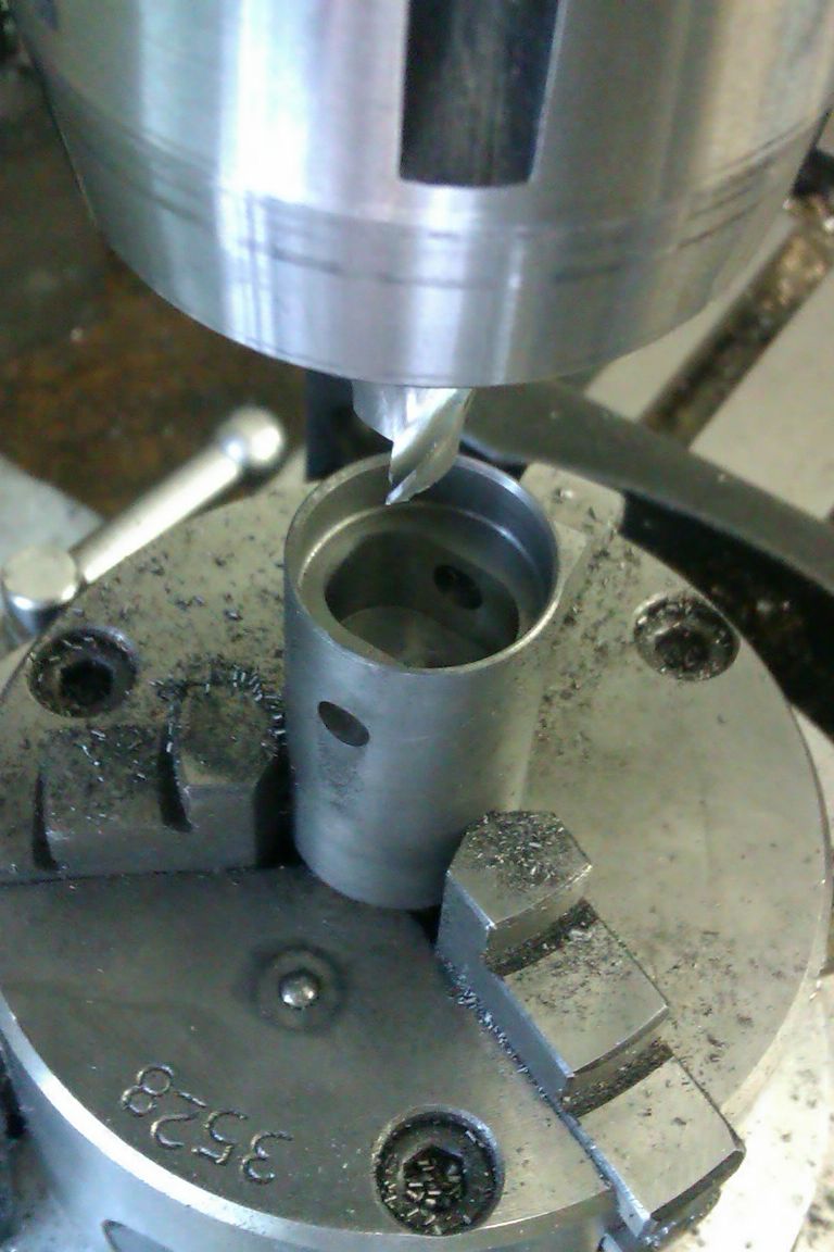

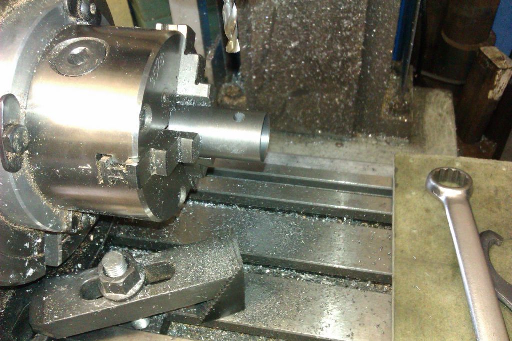

                          Its was then over to the mill and the centre of the bottom of the bore clocked in
                          Firefly59
                          The 4 mounting holes were then spotted and drilled
                          Firefly60

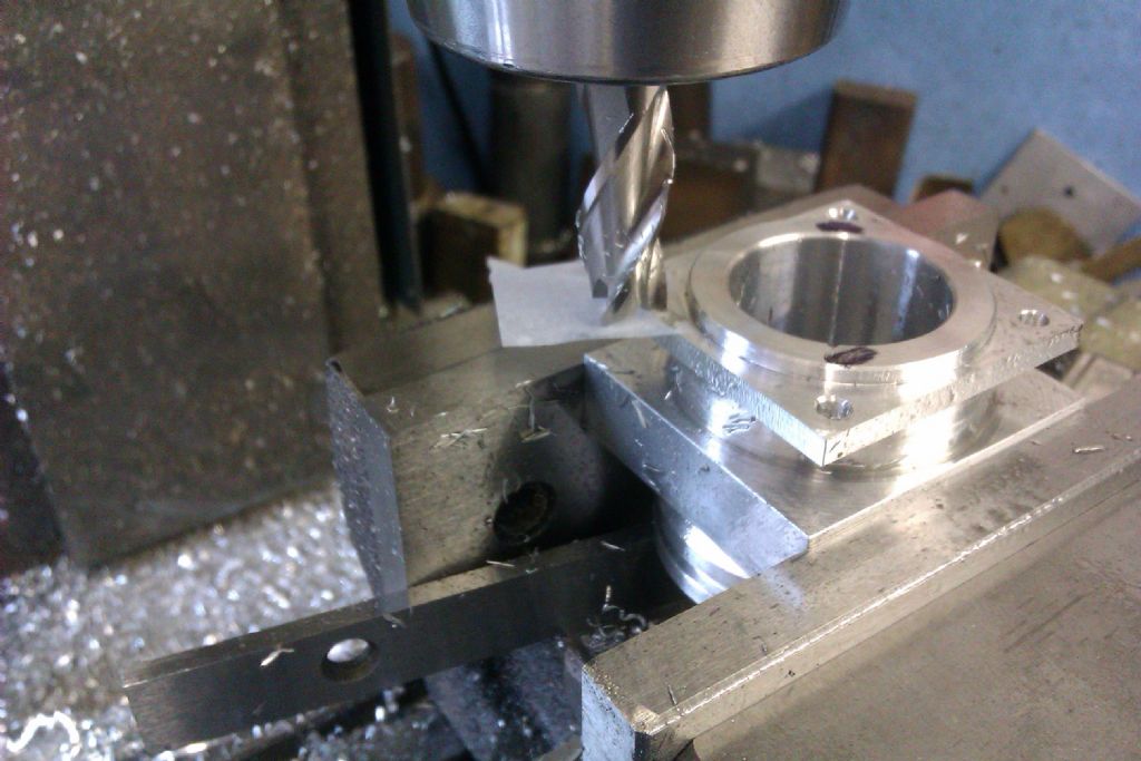

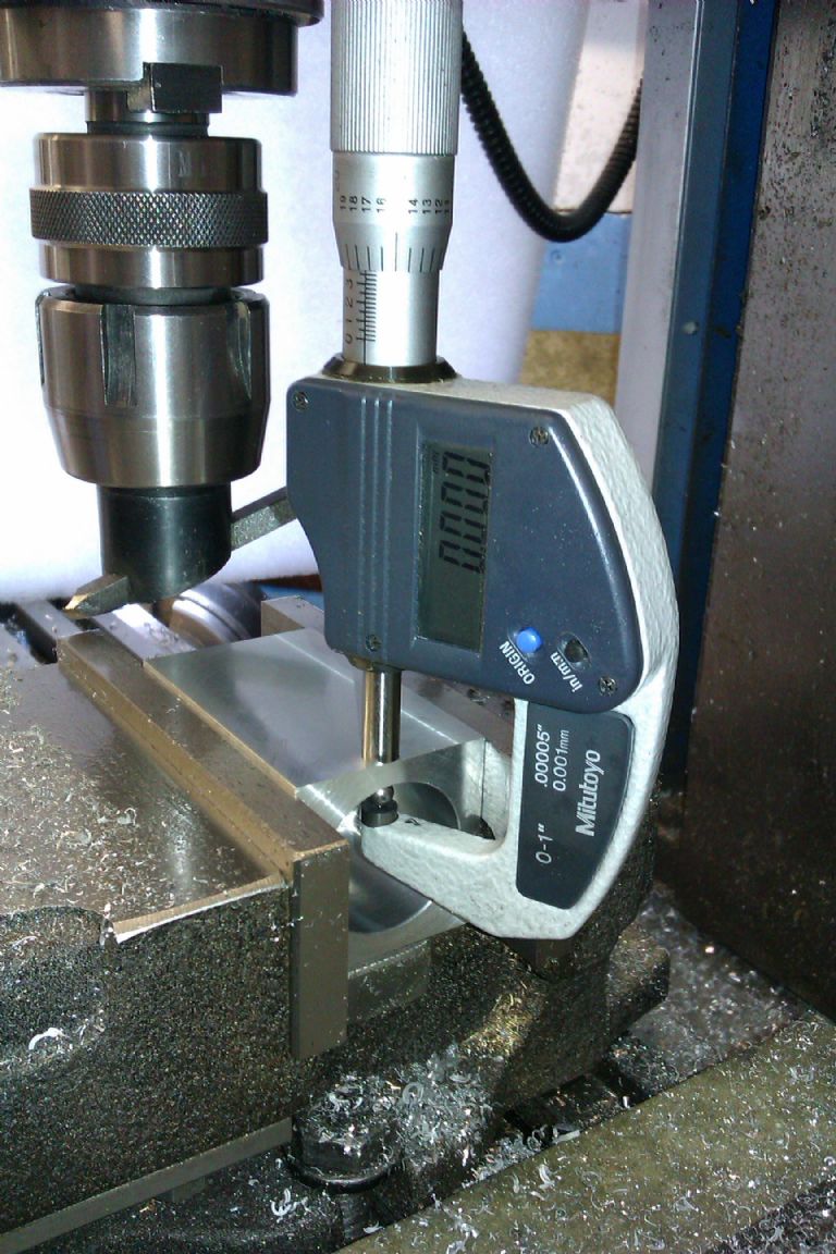

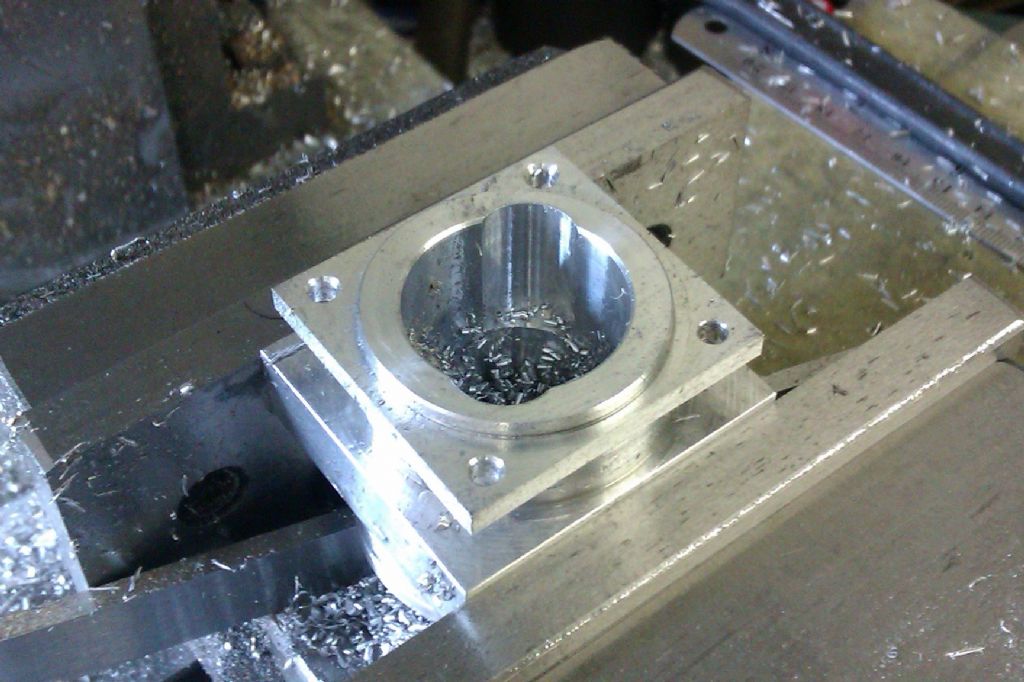

                          Next the two sides of teh mounting flange were machined back to size checking against the crankcase
                          Firefly61
                          Followed by the front & back
                          Firefly62

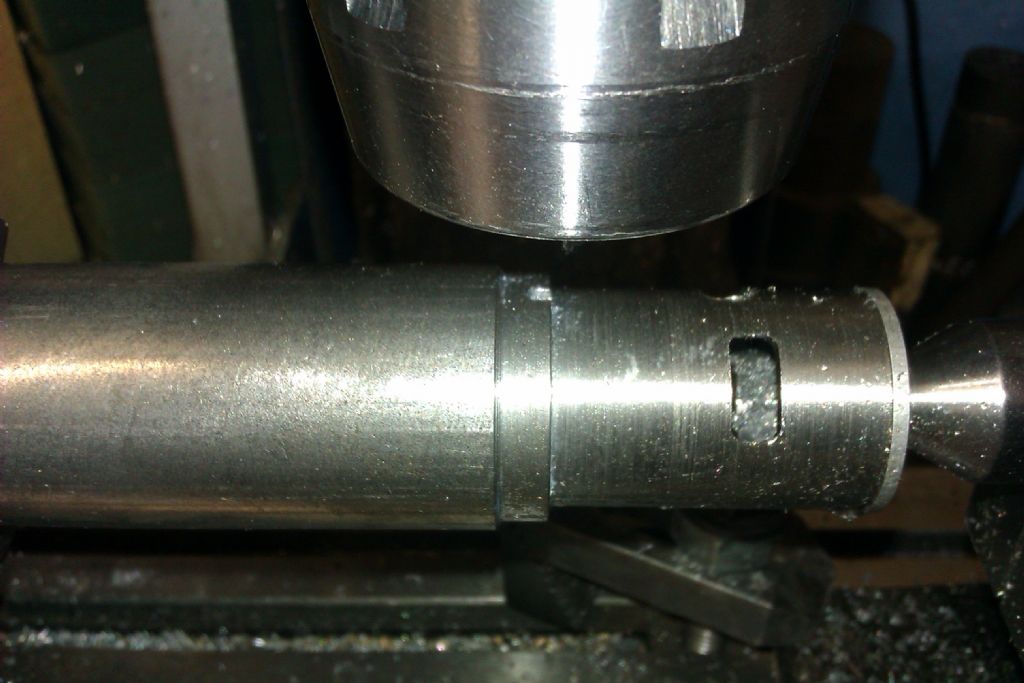

                          A 12mm cutter was zeroed in on the flange using "fag paper" to gauge th eposition
                          Firefly63

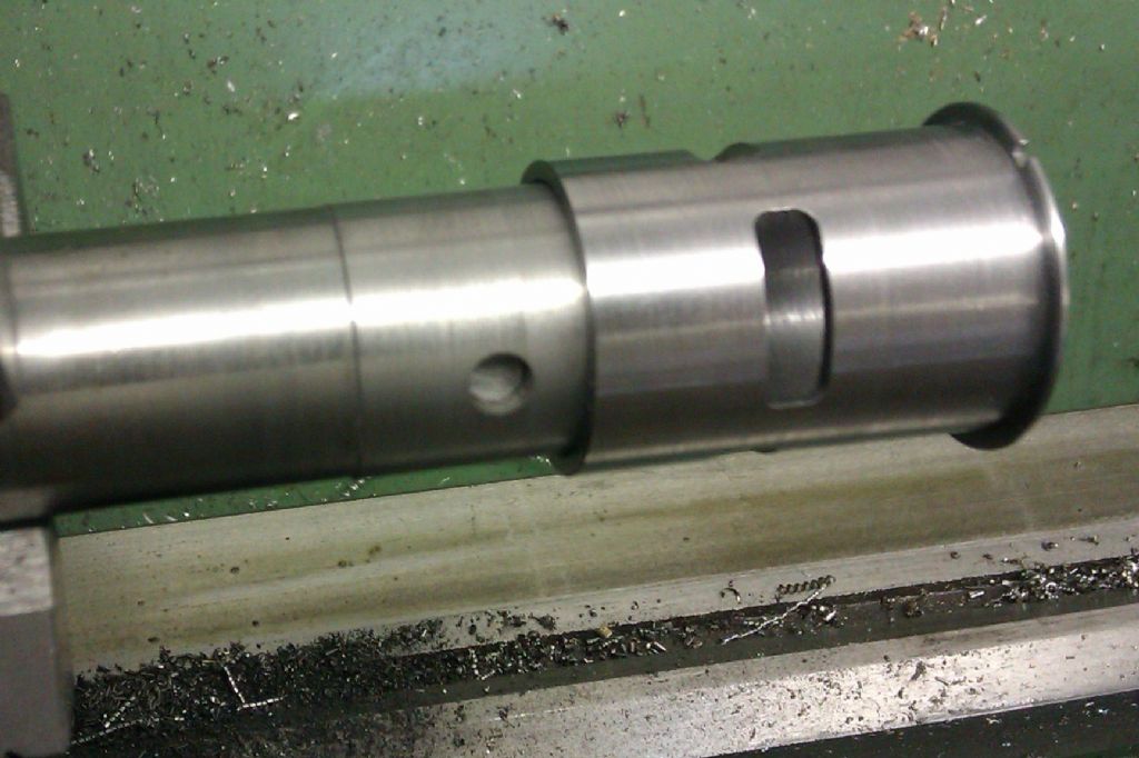

                          The two transfer ports were then formed by plunge cutting with the 12mm cutter, note the two blobs of marker to make sure the transfer ports go where they are meant to.
                          Firefly64

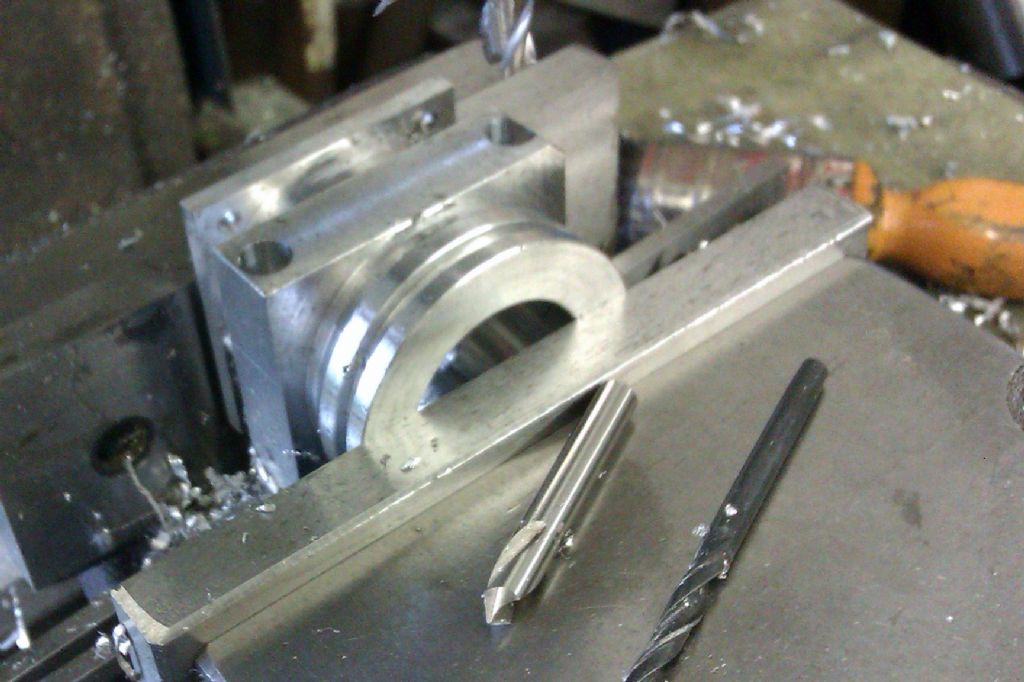

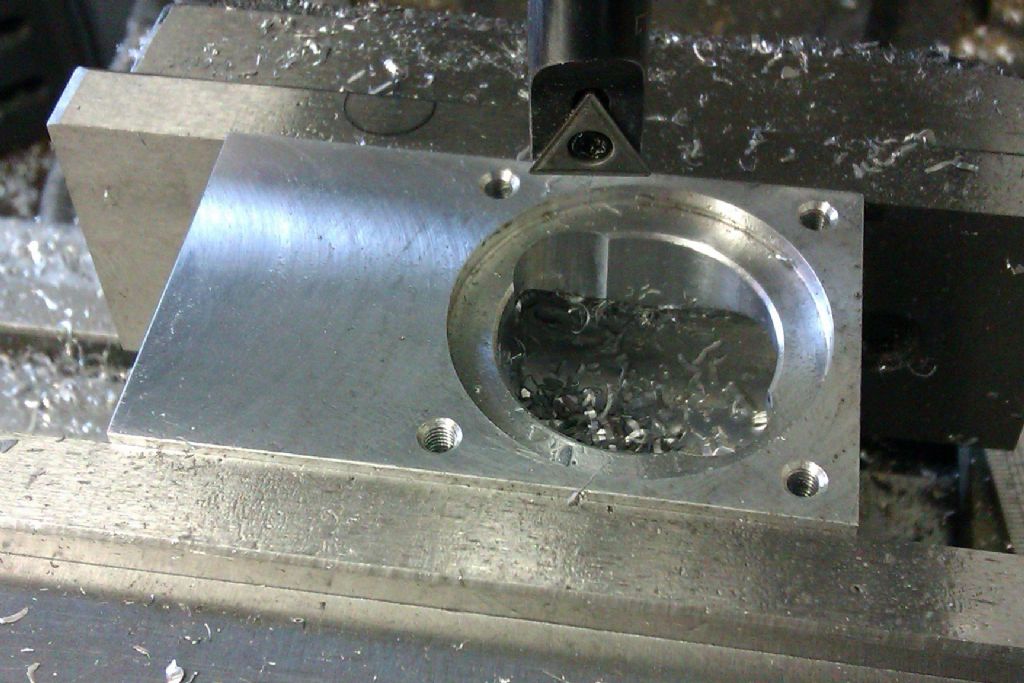

                          The two side faces of teh exhaust block were then machined to finish size, note the slight burrs from the blunt cutter.
                          Firefly65
                          Cont'd
                          #93261

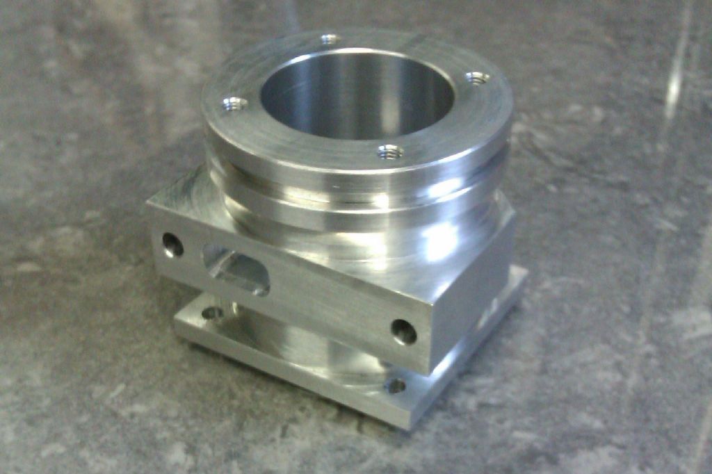

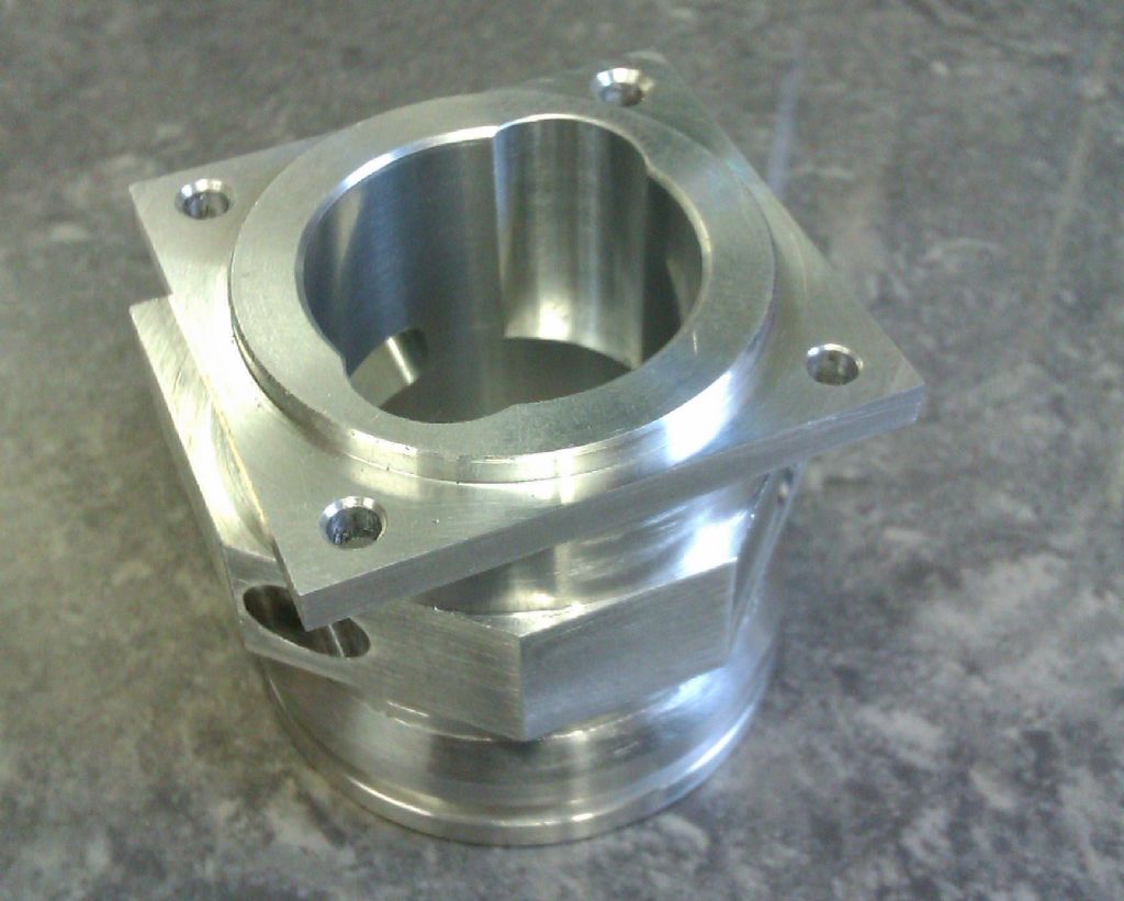

                            With the burrs removed the centre of the surface was located and then the two silencer mounting holes spotted, drilled and counterbored with a 1/4" FC-3 cutter. As they are quite deep holes I drilled half way from this side and then the rest from the silencer mounting face.
                            Firefly66
                            The barrel was then set to 45deg using the angle box and with a sharp cutter this time the chamfer machined to a premarked line just like the carb face was done, repeat for the other chamfer
                            Firefly67
                            Flip teh part over, machine back to finished width, complete drilling and then mill out the exhaust port. I went as far as I could with a standard length cutter and then changed to a long series one to complete the passage.
                            Firefly68

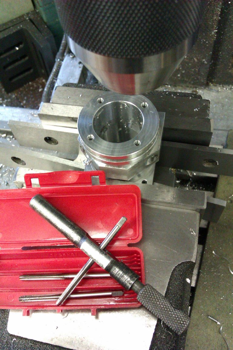

                            The final job was to drill and tap the four head fixing holes, just like the crankcase was done.
                            Firefly69
                            And to finish off tonight here are a few quick snapps of teh finished part, save for a bit of final cleaning up.
                            Firefly70
                            Firefly71
                            Firefly72
                            J

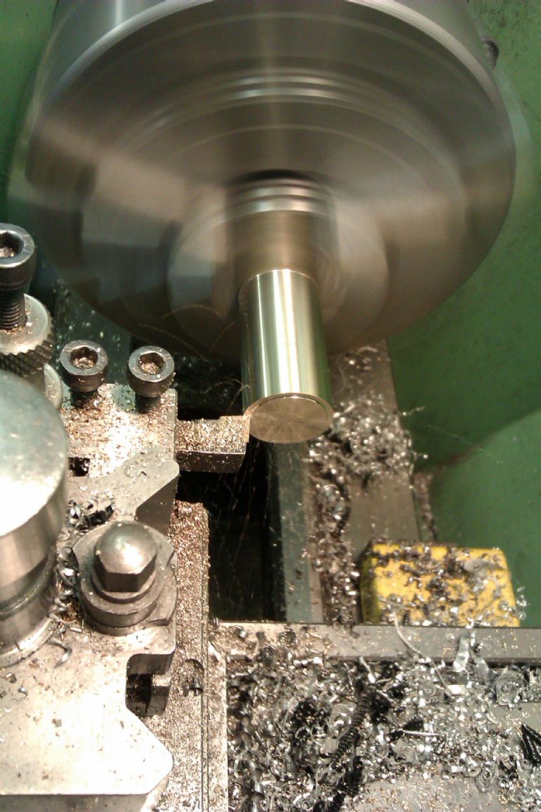

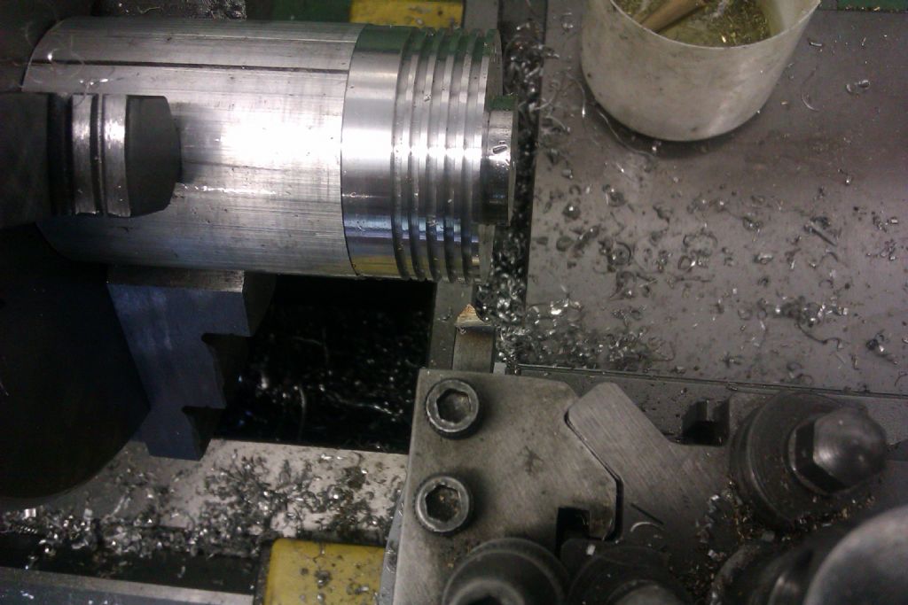

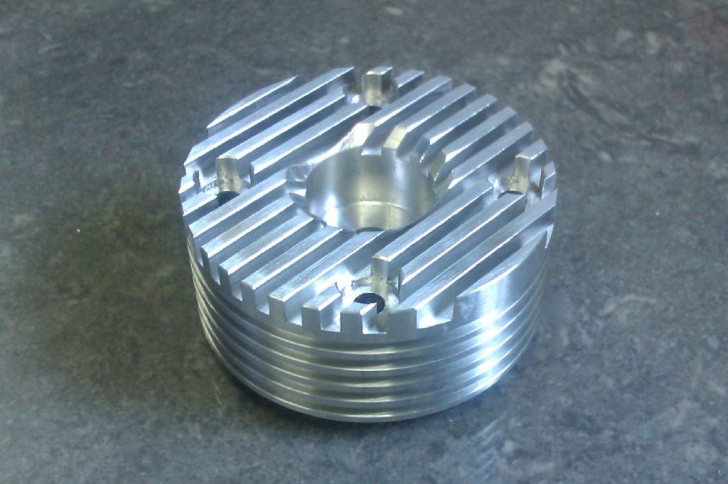

                              Cylinder Head
                              Before starting I should point out that I have deviated from the drawings slightly, nothing major only cosmetic changes.
                              A length of 1 5/8" bar was chucked, faced, center drilled and then the outside skimmed to just remove enough metal to get a clean surface, this became my finished OD – 41.1mm slightly up on the drawings 40mm.
                              Firefly89
                              The spigot was machined to size and then the tailstock centre brought up to give support while the cooling fins/grooves were cut. I went for a different pattern of 0.050" fin, 0.050" groove, etc as this suited my 50thou parting tool and gave me room to get an extra groove. Due to the larger diameter I also increased groove depth from 1.8mm to 2.5mm
                              Firefly90
                              The edges of the fins were tidied up with a small cut from the usual chamfer tool.
                              Firefly91

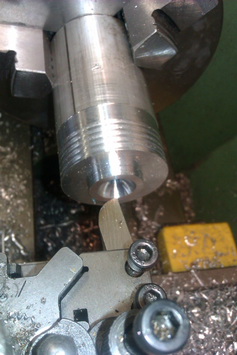

                              A form tool for the "hemi" head was ground up from a 3/8" HSS blank with plenty of clearance to stop it rubbing on the bottom of the cut, did not bother with any top rake and it gave a good chatter free cut over its whole width at about 250rpm.
                              Firefly92
                              The head was then parted off over length, reversed in the chuck, faced, bored and the chamfer around the plug hole added with a small boring bar. I made the head 1mm taller than drawing.
                              Firefly93
                              I picked up the centre of the plug recess in the mill and then set the four holes from there, drilled 3.1 (3.5mm on the drawings seemed a bit excessive clearance for M3) and counterbored with a FC-3 cutter followed by a quick touch with the CSK.
                              Firefly94
                              The reason for making the head that extra 1mm long was so I could have a bit of fun with a slitting saw. The head was set square in the rotary table chuck by using a tri-square against two drill bits pushed into the bolt holes and then the saw set to centre of the head. I worked out a suitable spacing and then took a series of 1/8" deep cuts across the head. Note the M5 nut in the plug hole, this is screwed to a rod that passes through the rotary table with a nut and washer on the other end to hold the head into the chuck, I was worried the saw may pull it out of the chuck as the spigot is quite short to grip.
                              Firefly95
                              After a bit of de-burring with a needle file this is what the finished head looks like
                              Firefly96
                              Cont'd

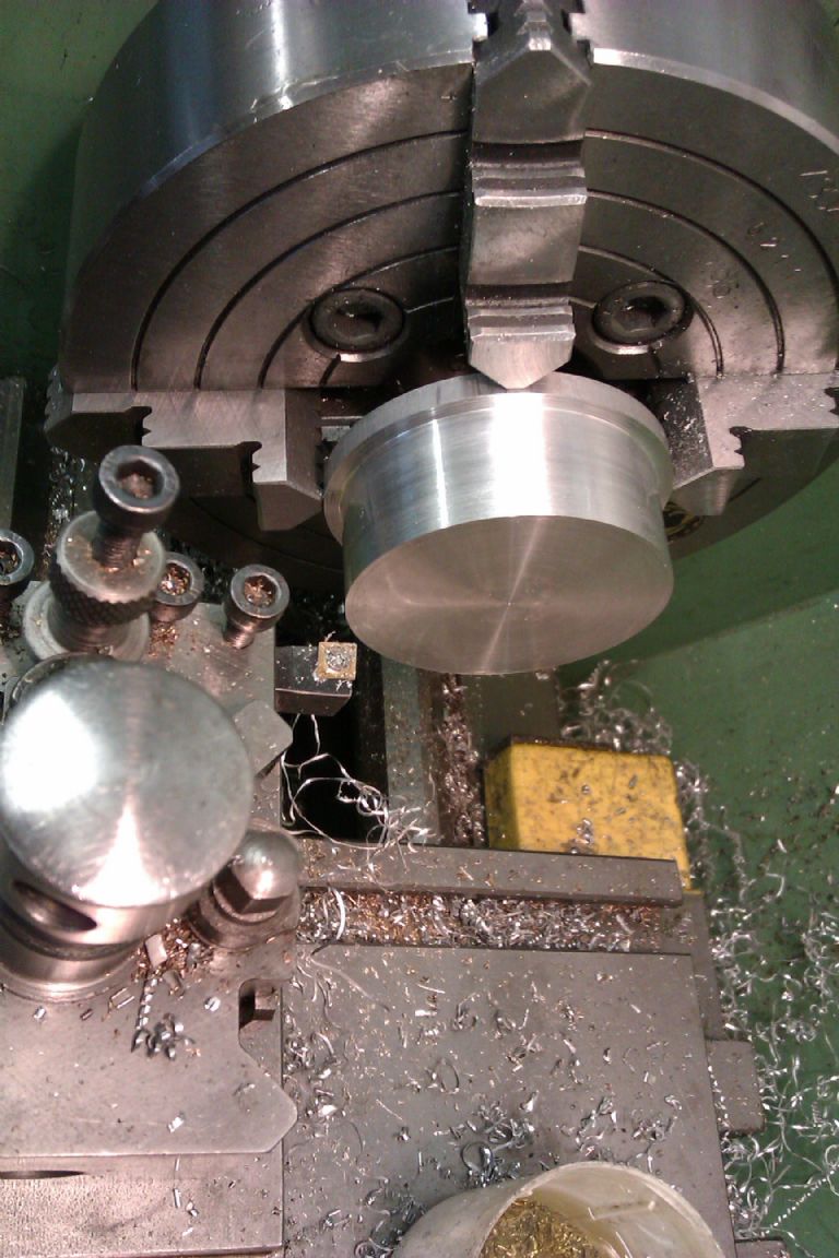

                                Just before starting the next bit I should have said that the UNEF tap required for the glow plug can be obtained from Model Fixings who will also have the socket head screws needed for the engine if you don't have any to hand. Usual disclaimer.

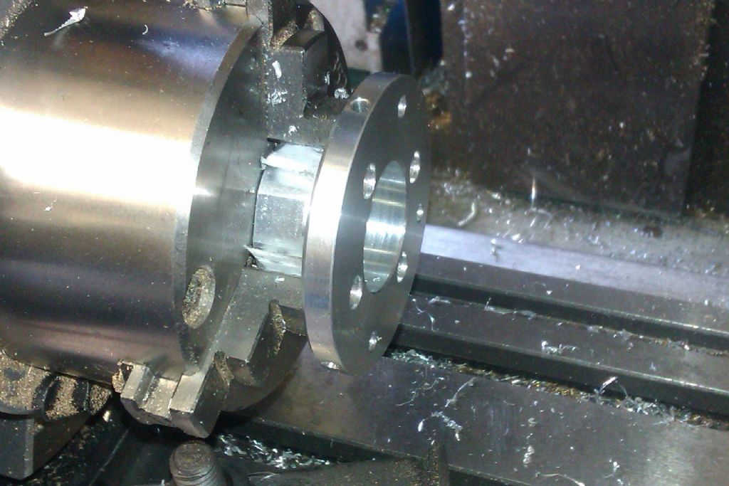

                                Backplate

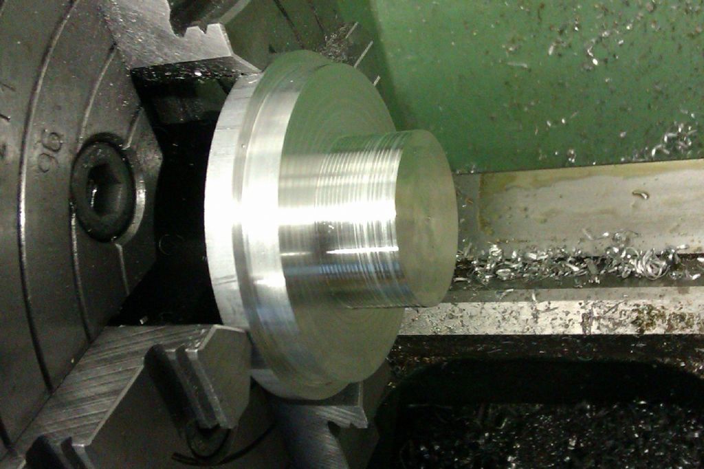

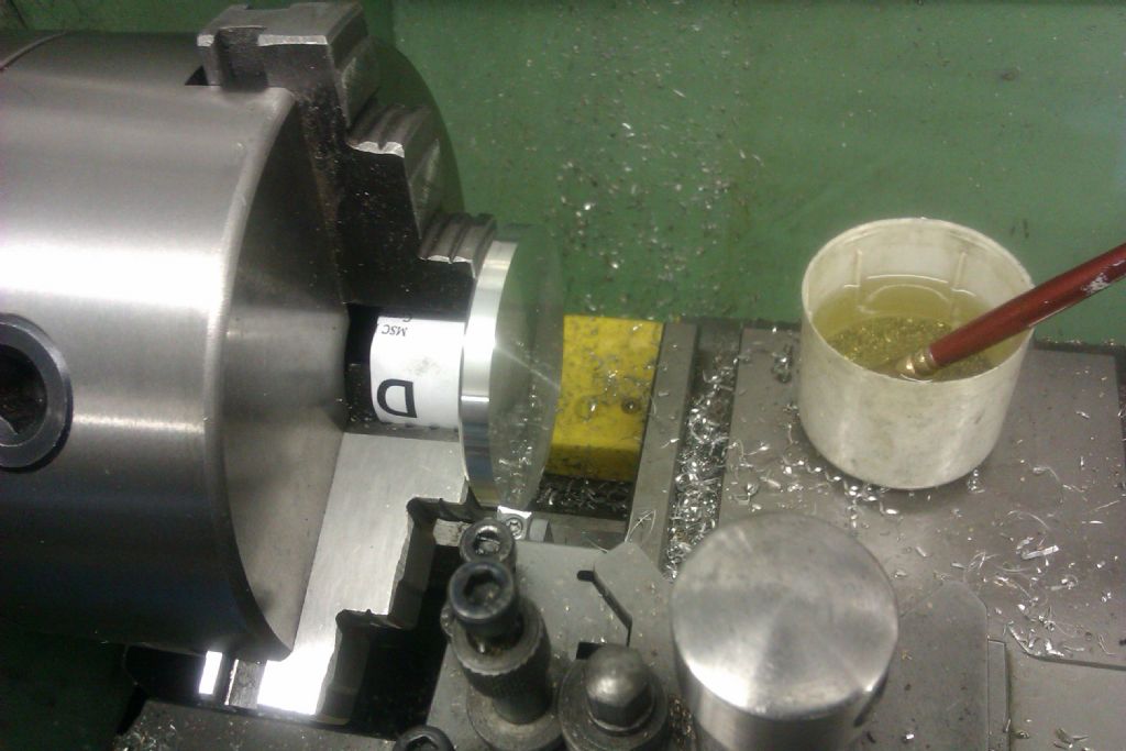

                                A 1" slice of 2 1/2" HE30 was mounted in the 4 jaw as that was on the lathe at the time and faced & turned to the 57mm dia.
                                Firefly73
                                The majority of the waste was roughed off and then the part left to cool.
                                Firefly74

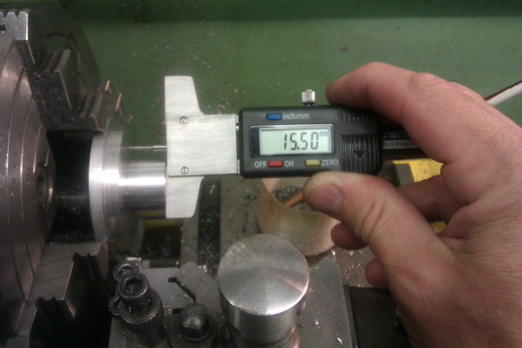

                                Once cool there was no risk of the spigot contracting so it wa smachined to a push fit in the 28.2mm crankshaft, test the fit in the hole rather than measuring. Notice the fine whispy swarf, how said you can't take half a thou off with carbide tooling.
                                Firefly75

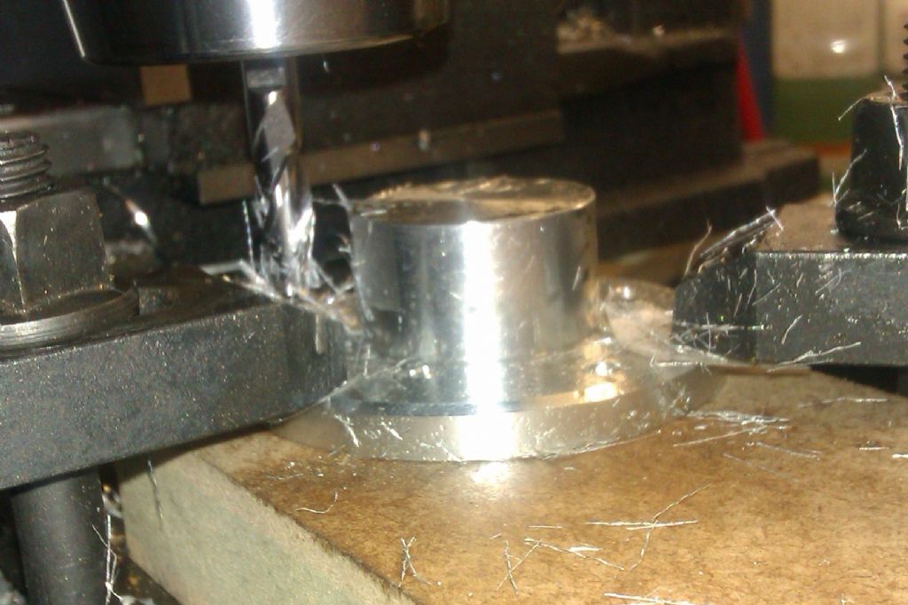

                                The spigot can then be faced back to the finished 15.5mm and the edge lightly chamfered.
                                Firefly76
                                The larger camfer on the backplate can now be done by swinging teh topslide over to 45deg
                                Firefly77
                                With the finished surface protected by paper the flange can be faced back to 5.7mm finished thickness.
                                Firefly78
                                Work up through the drill sizes as before to take out some of teh waste from the recess and to allow a decent thickness boring bar to enter.
                                Firefly79
                                Bore out to dia and depth and finish with a chamfer to all edges
                                Firefly80

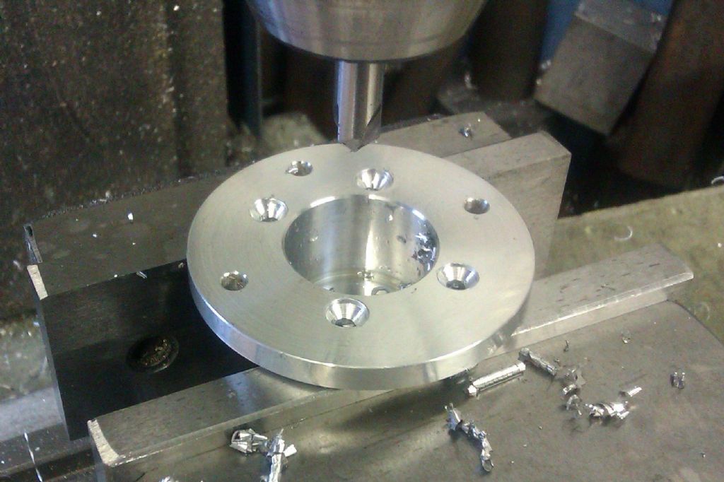

                                Hold the work, locate centre and then spot the seven hole positions
                                Firefly82
                                Open out to M3 clearance and 4mm as required on the drawings and clean the edges with a CSk if you did not deep spotdrill.
                                Firefly82
                                While the holes are all aligned with the mill axis cut the shallow flat on the top of the spigot
                                Firefly83
                                Turn the backplate over and CSk tehe four holes, clean the other 3.
                                Firefly84

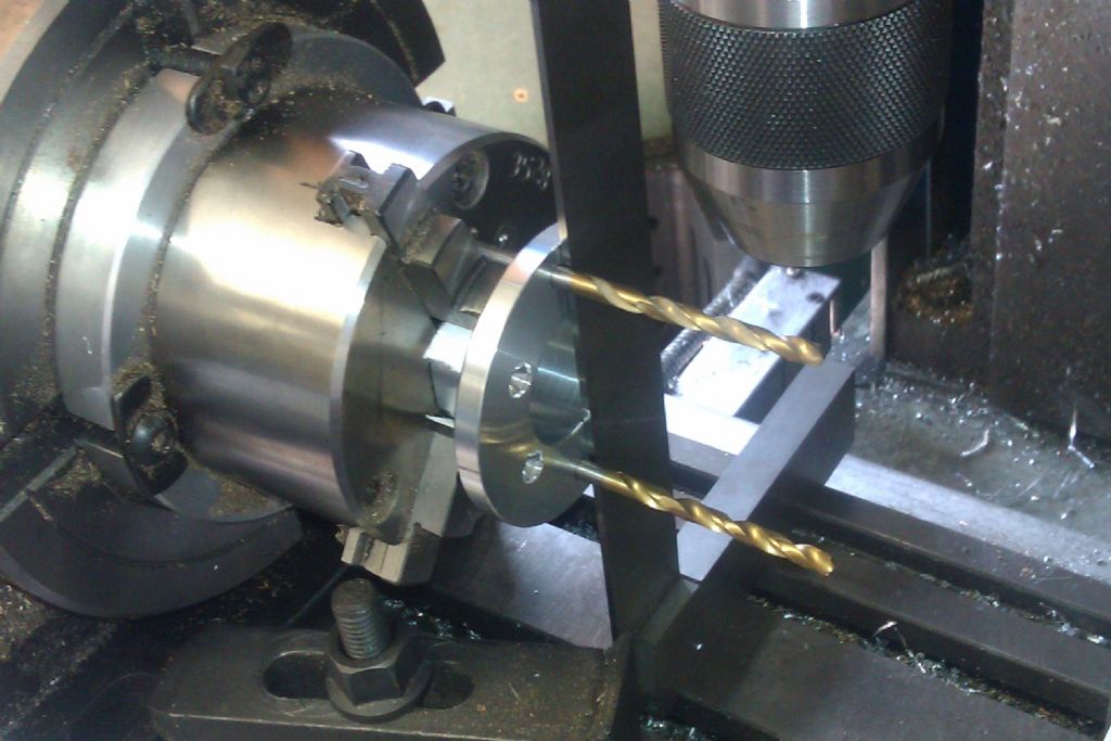

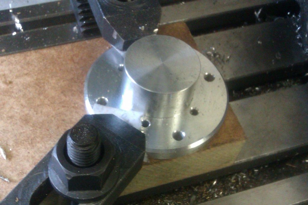

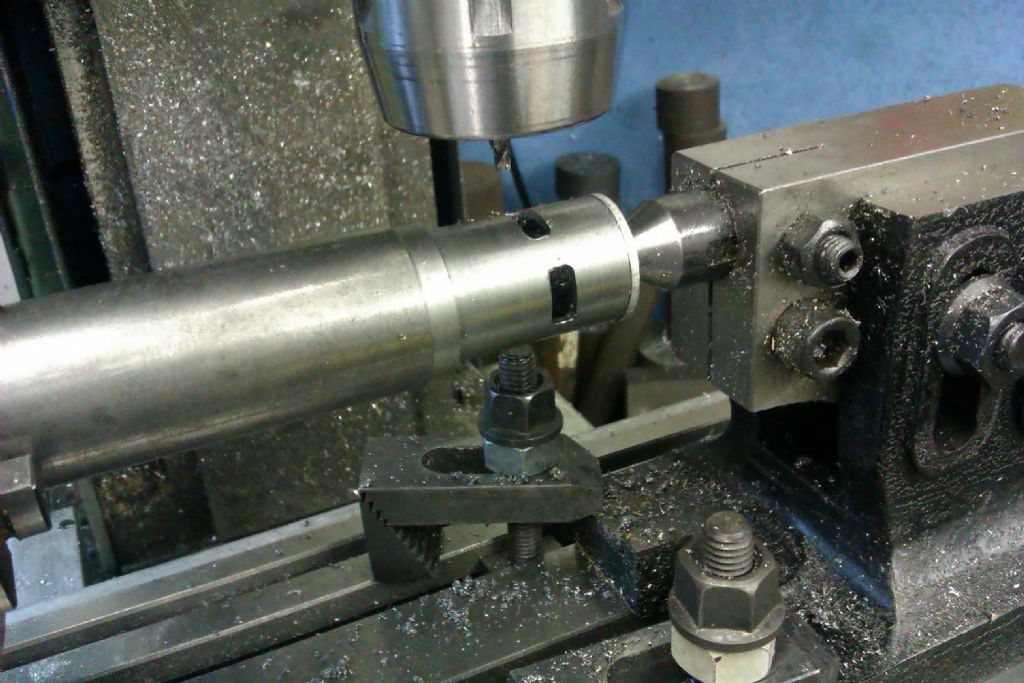

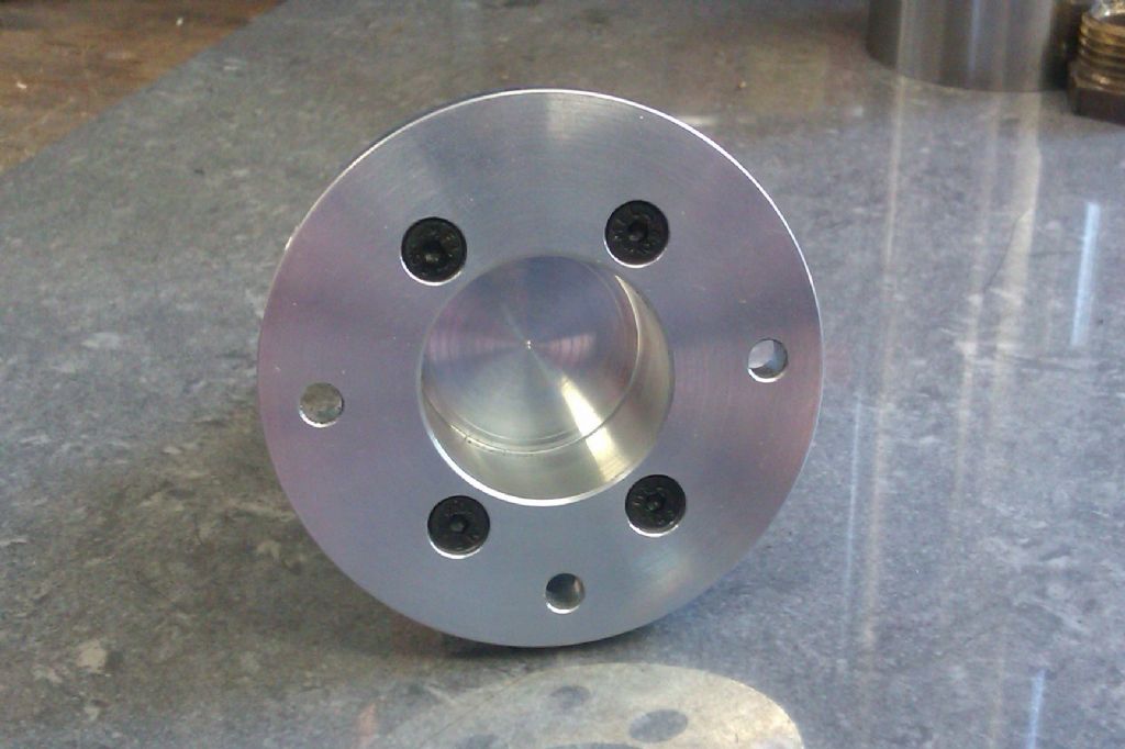

                                  Set the backplate square in the rotary table chuck using the two drills and tri-square method.
                                  Firefly85
                                  Then wind it 35deg each way, spot and drill though 1/8" to suit your pipes. There is no front to back dimension given for these two holes but I set mine 2.5mm in from the back of the plate.
                                  Firefly86
                                  And this is the finished backplate
                                  Firefly87
                                  Firefly87
                                  Add a couple of screws and this is where we are upto at the moment. I'm going to do a bit on my Domestic Hit & miss engine so may not add anymore for a week or so.

                                          Well I could not stay away from the engine for long! I have deviated from the drawing number sequence as I wanted to make the piston to fit the liner rather than the other way round.

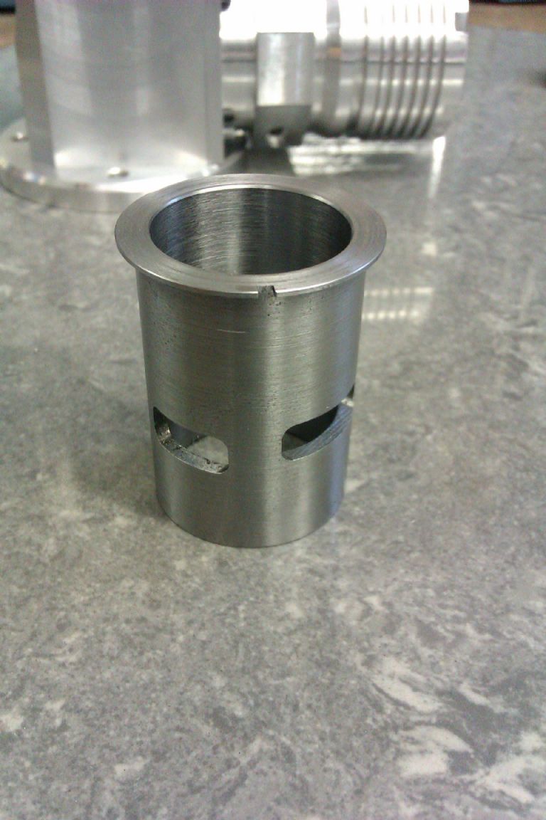

                                          Cylinder Liner
                                          A length of 30mm EN8 – cheaper than 1 1/8" –  was roughed out with about 0.020" to come off all faces.
                                          Firefly105
                                          The outside was then turned to a firm push fit into the barrel and the inside bored to 21mm
                                          Firfly106

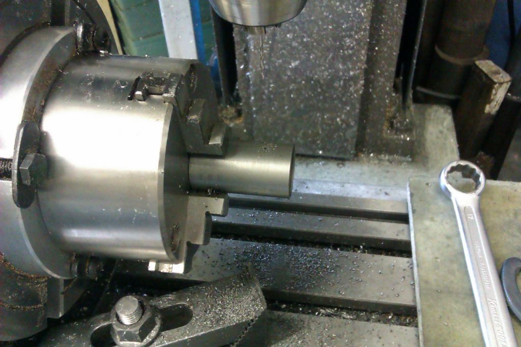

                                          I made up a plug to go into the end of the liner so the rotary table tailstock could be used, this let me support the work away from the R/T chuck without the collet holder hitting the jaws and proceded to mill out the ports with a 3mm FC-3 cutter.
                                          Firefly107
                                          While in the R/t chuck I also used a 1/16" endmill to put a locating slot into the flange rather than a vee.
                                          Firefly108
                                          Back to the lathe and the liner was parted off a little over length, reversed, lightly held and the flange faced back to 0.75mm and all edges chamfered.
                                          Firefly109
                                          Firefly110
                                          And this is the finished liner ready to have the inside lapped.
                                          Firefly111
                                          Edited By JasonB on 08/07/2012 18:02:13

                                              With the machining complete on teh cylinder liner it was now time to lap the bore for a good finish. I can't take any credit for the lap design, its based on one Ramon used for his ETA & Supertiger builds, basically a tapered rod with a nut on the end to drive the taper bored lup up the taper to expand it.
                                              Firefly118
                                              The lap was charged with a mix of 320g powder and oil and then the cylinder worked up and down while the lathe ran quite slowly. You can see the matt fionish produced.
                                              Firefly119
                                              After a thorough clean the process was repeated with 600gmix
                                              Firefly120
                                              Cleaned again and finally done with 1000g mix with a lot of oil.

                                              With the lapping done the liner could be used to gauge the finished size of the piston.

                                                Piston
                                                A lump of 25mm CI bar was put in the lathe, faced off and turned 0.010" overdia and about twice the length needed.
                                                Firefly123
                                                The end was then drilled then followed by boring to finished depth and diameter
                                                Firefly124
                                                The turned length was then sawn off and transfered to the rotary table, centred and the end located.
                                                Firefly125
                                                The wrist pin hole was then done making sure not to break through and allowing for the dia being larger than finish size.
                                                Firefly126
                                                The table was rotated 180deg and the 1.0mm hole put in.
                                                Firefly127
                                                Without removing the work from the chuck the table was mounted horizontally and clocked true to the mill axis, this ensured that the conrod slot is exactly at right angles to the wrist pin hole. I drilled two holes on 5mm ctrs 3/16" then plunged with 5/16" and 7/16" slot drills to remove most of the waste.
                                                Firefly128
                                                It was then just a simple matter of milling to the 12mm finished size
                                                Firefly129
                                                With the milling complete the embrio piston can be parted off a little over length
                                                Firefly130
                                                A simple mandrel was made to hold the piston, the OD is a little less than piston finish size and the short spigot a good fit into the underside of the piston. The piston is place on the end, the pin slipped into the hole and then as the piston is turned the screw pulls it tight to the mandrel.
                                                Firefly131
                                                The piston can then be faced back to length
                                                Firefly132
                                                Then turned and honed until it just starts to enter the liner
                                                Firefly133
                                                I used the same mandrel to lap the piston to the liner but just turned the liner back and forth by hand Not under power. A tiny amount of 1000g is placed onto the piston and the liner slowly fitted to it adding plenty of oil, no more grit until a good fit is achieved.
                                                Firefly134
                                                And here we have the finished liner & piston
                                                Firefly135
                                                Firefly136
