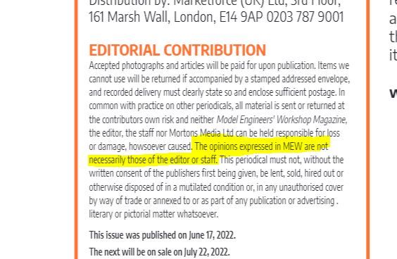

                    Wonder if the new owners of the mag. will be prepared, for anyone following this example, to pay compensation in the event of an injury to any of its customers by following this example? An explanation in the text doesn't hold water cos let's face it, in many cases, 'If all else fails, RTFM'. In recent history, the same mag was criticized for showing the conversion of a battery powered drill from an internal battery to an external power pack, connection between the two by means of a 13A plug and socket. '240V into 18V causes a rapid release of the magic smoke if plugged into the wrong socket'.
                    I left an American forum years ago for exactly the same reason of an "Experienced" poster showing exactly the same thing in one of his posts. His excuse being "I've done this for thirty years" and yes, I've got one or two scars after fifty years in industry AND home shop stupidity but if one or two harsh comments stops a 'newbie' having to attend A&E – – – –
                    Regards Ian.
                    #617676
                      I expect there is a get out clause somewhere more legally binding than this. I'll wait until I have seen the digital mag.
