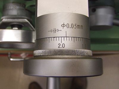

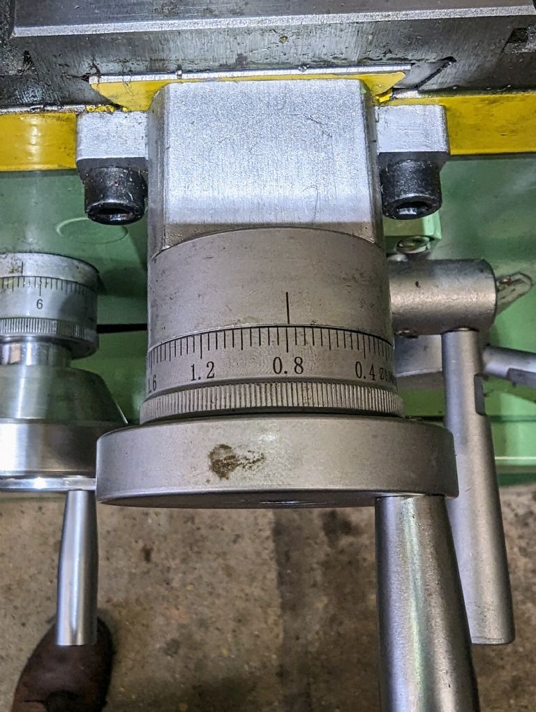

      Finally got to do some serious turning on my new WM250V…but have been scratching my head why I can't seem to take the right size cut. Never had this problem during the 40 years of using my old imperial Sheldon….
      At first I thought it was my unfamiliarity with metric units and me constantly looking up imperial equivalents in my Zeuss book. Finally dug out my imperial dial gauge and took some measurements as I wound the cross feed table in and out.
      So when did the cross feed dial indicator change to show total reduction of diameter rather than amount of movement of the table??? On my old lathe, if I wound the table in by 20 units on the dial, it would move in by 20 thou of an inch and take 40 thou off a diameter.
      With my Warco, if I wind the cross feed in by 0.8mm on the dial, it actually takes 0.8mm off the diameter. i.e table only moves in by 0.4mm (or 16 thou inch on my imperial dial gauge in the photo)
      I appreciate the latter set-up is more useful. But when did this convention change? Of maybe there is no standard at all…
      Cross Feed Dial #1
      Cross Feed Dial #2

          Some do, some don't…
          As I understand it, the Americans tend to use the "total reduction in diameter" whereas here in the UK we use "tool distance". Other countries just seem to have picked whichever they prefer.
          I may be wrong.

                Posted by Paul Wirdnam on 18/04/2023 15:16:53:
                So when did the cross feed dial indicator change to show total reduction of diameter rather than amount of movement of the table??? …
                Been like that forever. Diameter more likely in the US and rest-of-the-world lathes than the UK, but both ways of graduating the dial have co-existed since Maudsley.
                Of the two I prefer diameter because it saves having to do mental arithmetic which I usually manage to cock-up. Most of the time I turn to a diameter, not to a radius, so the calculation is unnecessary.
                The UK preference may be related to when much turning was done to fractional dimensions, a system that often mades dividing and multiplying by two easy. Sadly, the need for higher accuracy broke fractional dials during the 19th century, when engineering switched to thou. As decimal numbers aren't quite so easy to multiply by two in your head, having the dial do it helps. I suspect the radius method was retained because old-school machinists found it too difficult to accept a new-fangled improvement.
                Does cutting in slices of radius have an advantage? If so, I've missed it!

                    What I am struggling with though, is the 0.04mm graduations.
                    Absolutely! It's crazy, isn't it? I'm ok with 0.4 and 0.8 which are marked and I can just about find 0.6, but 0.65 would challenge me. sad

                      Interesting, my somewhat elderly WM250 has a similar arrangement which I am now used to but the graduations are in 0.05mm which is slightly more useful. The dial also lets you know it is referring to diameter by the ⌀ symbol.

                              I would prefer it to be a radius dial because that's what I'm used to but I can live with it as-is. If I was using a milling attachment, then it would be awful….
                              Thanks for all your comments.

                                      It freaked me a bit at first on my Warco, but you can get used to anything. If I'm milling or co-ordinate drilling using the crossslide I double the metric offset I dial in. What complicates it more is that my vertical slide's a Myford Imperial.
                                      I know I could buy a DRO set, but (a) I'm a cheapskate, (b) too lazy to want to go through the learning curve to fit and calibrate the things, and (c) believe in maintaining the mental calculation exercise.
                                      I've had it 8 years and so far I've coped.

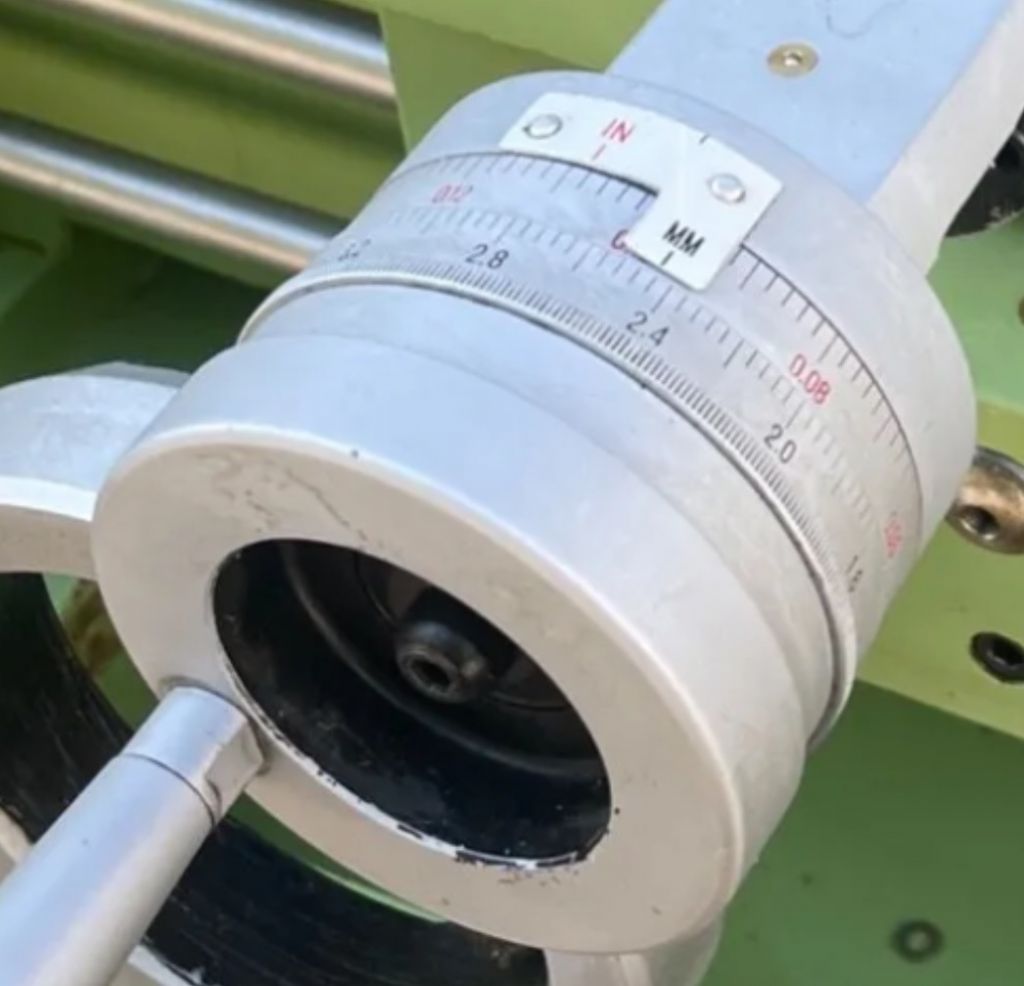

                                            Posted by Ballistol on 18/04/2023 20:17:40:
                                            Posted by Paul Wirdnam on 18/04/2023 19:32:49:
                                            Posted by Ballistol on 18/04/2023 19:28:35:
                                            As if my brains weren’t scrambled already, my Warco is set up for metric and imperial. frown
                                            Very interesting! Which Warco lathe is that? Is that something you did or does it come as standard on the bigger models?
                                            It’s the GH1322, the imperial lead screw version, as far as I know, it was manufactured that way.
                                            Having used a Metric GH1330 (same lathe different bed length) I can confirm it came new with that double system dial.
                                            The metric leadscrew imperial dial reads out to an impractical number of thou per revolution, I presume your imperial leadscrew metric dial does the same but for twentieths of a mm.

                                              Odd graduations on the habdwheel dials drove me nuts when I first got my Chinese lathe – so much so that one of the first jobs was to make some new ones!
