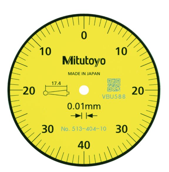

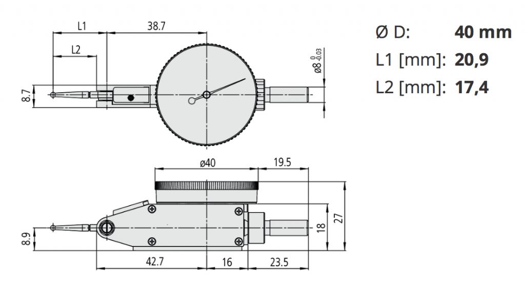

                                        Austin O’Hara
                                          @austinohara24453
                                          Would this Mitutoyo 513-404-10T Dial Test Indicator be suitable?
                                          It sells for £106 on Amazon and is supplied by Mitutoyo.
                                          Cheers,
                                          Austin

                                          #442997
                                            Posted by Austin O'Hara on 23/12/2019 14:08:23:
                                            Cheers,
                                            Austin
                                            More than suitable, but the word I'd use is 'extravagant'!
                                            What's your reason for wanting a pricey instrument? I own a lever type and a piston type DTI: they're both useful in different circumstances. Neither of mine are expected to be accurate. Instead they are used to compare distances or detect tiny relative movements. For example when centring work in a 4-jaw chuck, the DTI only needs to show there is next to no movement when the work is rotated. For that purpose in my workshop (0.01mm is plenty good enough) the dial doesn't need to be anything special.
                                            My instruments are the inexpensive kind, a piston gauge as sold by ArcEuro for £17, and a lever DTI costing about £30. It's possible to find cheaper, but too cheap is best avoided! The difference between my dials and expensive gauges might include: better accuracy over a wider range (rarely needed in my experience), longer working life (provided you don't drop them), and smoother operation. In my opinion the last is the most useful feature. Inexpensive dials tend to be a little sticky in my experience, so using them needs extra care. In a professional workshop slick reliable instruments are worth having because time is money. Not so obvious what benefit a high-end dial gauge delivers in a home workshop.
                                            My biggest regret buying down to a price wasn't the dials, it was the stand! I bought the simplest magnet base available. It works but sure doesn't make manoeuvring the dial into position easy. Unless money is no object, spend that £107 on a couple of cheaper dials and a stand with more joints in it!
                                            PS. My views on tools are utilitarian. Ignore all of the above if enjoying 'nice' tools is to be part of your hobby and plenty of cash is available. My only objection to buying expensive tools is the money might well be spent more intelligently elsewhere.
