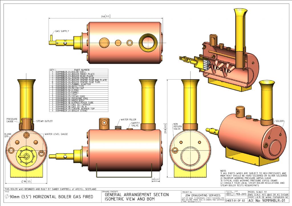

      Hello.
      I've been researching Cornish boilers after my recent visit to Beamish museum. I really want to build my first coal fired boiler and want it to be a Cornish type.. I currently have a 3inch copper tube but should I use this for the fire flue or the outer boiler? I don't want a huge boiler but also not a under powered one.
      Also does anyone have or recommend a plan for a coal Cornish boiler?
      Thanks chris

                                  Paul Lousick
                                    @paullousick59116
                                    Have a look on this site for a set of drawings to make a 90mm dia horizontal boiler. (may give you some ideas)
                                    **LINK**
                                    **LINK**

                                            Back to the drawing board… Coal in my current design is a no go… Whats everyone's smallest coal fire box?
                                            #599285
                                            Nick Clarke 3
                                              @nickclarke3
                                              The cornish boiler design with the very limited air space under the grate would probably need to be larger to burn coal successfully than a locomotive boiler or a Babcock boiler where the whole area of the grate can have draught through.
                                              #599309
                                              duncan webster 1
                                                @duncanwebster1
                                                Posted by Christopher Jones 9 on 25/05/2022 20:42:34:
                                                Tich firebox is 2.125"*2.375" (I think)
