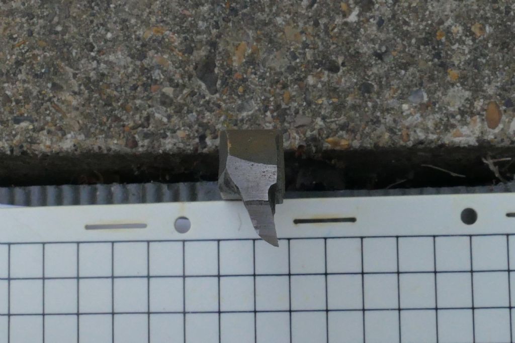

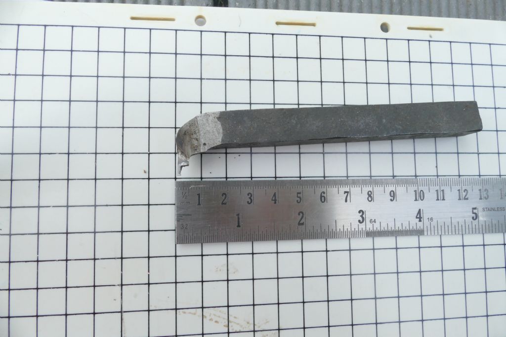

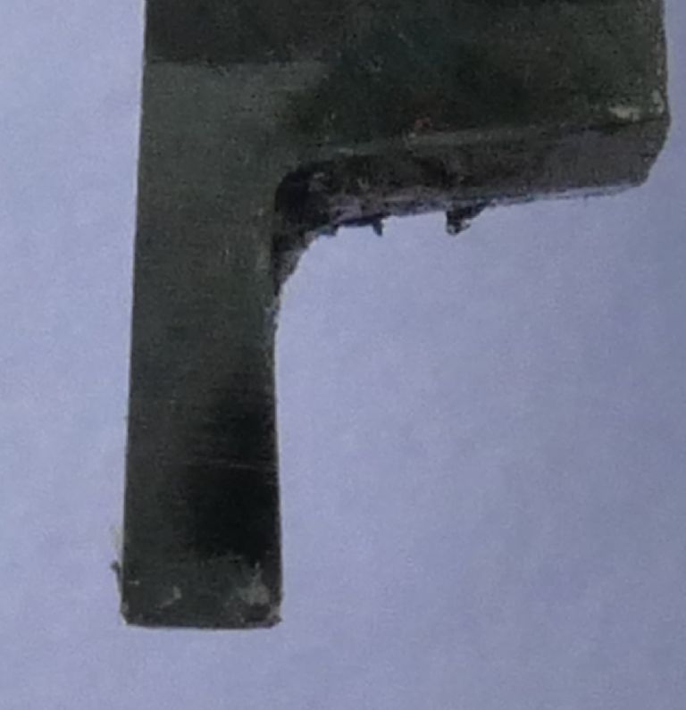

                                                    Hi Larry, Guys,
                                                    Making an internal boring bar and grooving cutter is not rocket science !
                                                    This is a piece of 3 mm square HSS, ground to cut a 2 mm wide by 1.5 mm deep groove inside a 12.5 mm diameter hole.
                                                    This picture shows the parts used to make the tool. As you can see it was made from and off cut of 8 mm all thread. Threaded bar for those that don't know what it is. The grub screw is M5 X 6 mm.
                                                    This last picture shows the grind on the tip. Its a bit difficult to see here but the top has about 5 degrees of rake.
                                                    This tool is intended to cut grooves for Teflon "O" rings with a 12.1 mm bore, so they are only 2 mm square cross section.
