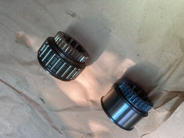

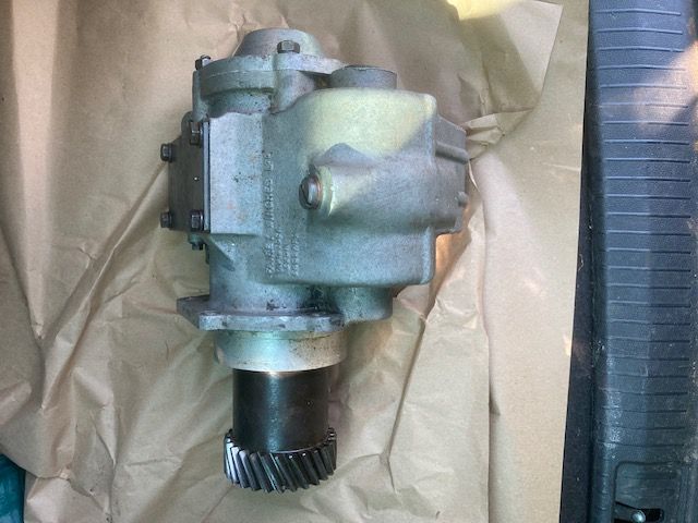

                                            Well chaps, firstly thanks to all of you who have given this brain space, and replied as above. I guess I need to provide some additional information to eleaborate on my initial intentionally succinct query.
                                            The application is part of a Fairey Overdrive for a series 2a diesel Land Rover. I have several of these – the o'd that is – and I'm optimistic of making at least one complete one out of the box of bits.
                                            I bought this one recently – it's a good place to start.
                                            In explanation, this unit is a completely mechanical gearbox which bolts into the back of the main gearbox. The helical gear is the output shaft, the input is concentric and runs on a needle roller bearing inside that lumpy looking gear.
                                            The input spline looks like this:
                                            These are two identical input sleeves, the upper one has damaged splines and the external roller bearing is worn. The lower sleeve is new but does not have the roller bearing fitted yet. That roller bearing runs on the inner of the overdrive output gear – the big helical gear in the first picture.

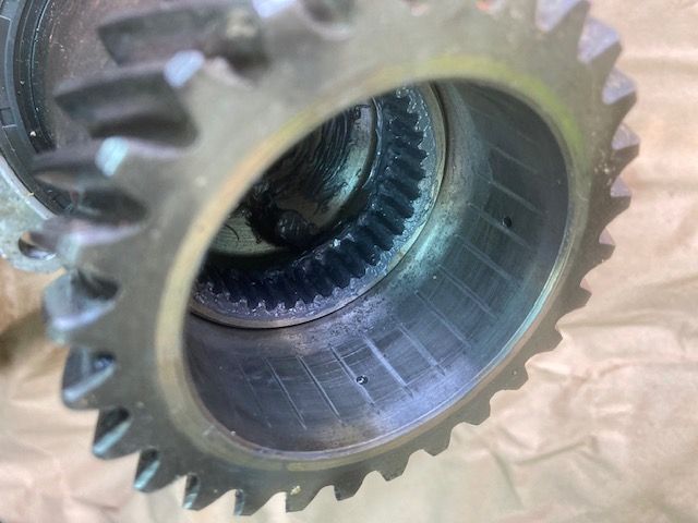

                                            Or it would if the inner surface didn't look like this:
                                            I don't know if this is technically brinelling, those marks are indents in the hardened surface of the internal bore.
                                            There are several ways of getting out of jail here. The shaft is not available as a new spare part, so one is going to choose between remedial work or finding a serviceable secondhand replacement. Suffice it to say I have two of these units with the same problem.
                                            One way of tackling this is the "grind it bigger, chrome plate it and grind back to original spec" approach. I'm prepared to follow this if I can find someone who is prepared to take it on. It's outside my comfort zone by some way.
                                            Given that the differential speed between the two shafts is either zero or a maximum of about 1300 rpm,, and the bearing bore is amply lubricated, I'm interested to make a bronze plain bearing and try it. It's a very quick cheap fix, and while I'm prepared to agree it isn't in the same class of exoticness as the original needle roller bearing I can accept that risk for the potential advantage of it being within my capabilities to make.
                                            Enough for one post, I'll continue in a second shortly.

                                              My bronze bearing sleeve will occupy the space where properly the rollers and cage on the sleeve would be. I want to make it fast on the inner sleeve, and slide on the (brinelled?) surface of the inside bore of the helical gear which is lubricated via holes in the base of the gear teeth such that gear oil is squeezed into the bearing space by the meshing action of the gears.
                                              Yes, I agree that if Mr Fairey didn't need to go to the trouble and expense of providing a needle roller bearing running in close tolerance and hardened surfaces he'd have fitted a bronze bush and called it good, but these things are intended for long periods of heavy service in arduous conditions with poor maintenance. The poor maintenance might be a good fit, but my application is light duty by comparison.
                                              I'm happy with the logic that has come forward to say "don't make it a press fit, the sleeve will stretch and burst" Fair point. I'm equally happy to accept that the whole idea is barmy and won't last five minutes/5 miles/next service interval. Such is experimentation.
                                              I like the idea of freezing the splined sleeve and heating the bronze bush to assemble them together, except I don't see why the resulting hoop stress in the bronze is any different to that left by a press fit, So the gospel according to Loctite has it at the moment.
                                              I'd be grateful for your thoughts.
