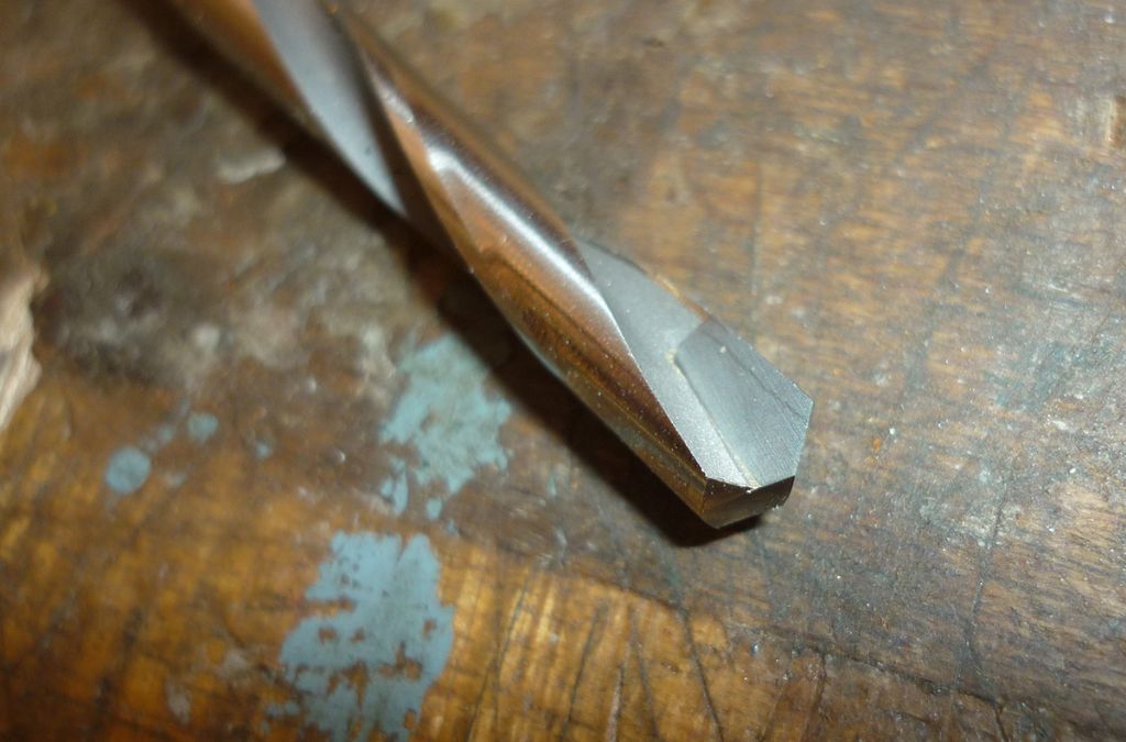

                        I got an MSC flyer today. A few bargains (although allow for the VAT on top!) and some prices that would make my hair stand on end if it didn't already!
                        One thing that is interesting is TCT tipped HSS drill bits (the very end is carbide, normal shape not like a masonry bit). They are supposed to be more flexible and I imagine are less likely to break when used ion a hand-operated machine. A few in small sizes might be a useful 'get out of jail free' card for dealing with hard items or snapped tooling.

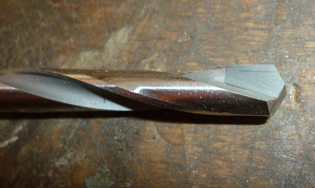

                                          Posted by Neil Wyatt on 04/01/2017 16:30:38:
                                          I tried one last week and it worked quite well to remove a broken carbon steel tap , though took quite a while .
                                          I was given them for free and the brand was durapoint made by CJT Koolcarb,inc in the States. I think MSC and Drill services sell them over here.
                                          Heres what the tip looked like.

                                            Ah yes, they look a lot more discreet than the masonry bits we all think of.
