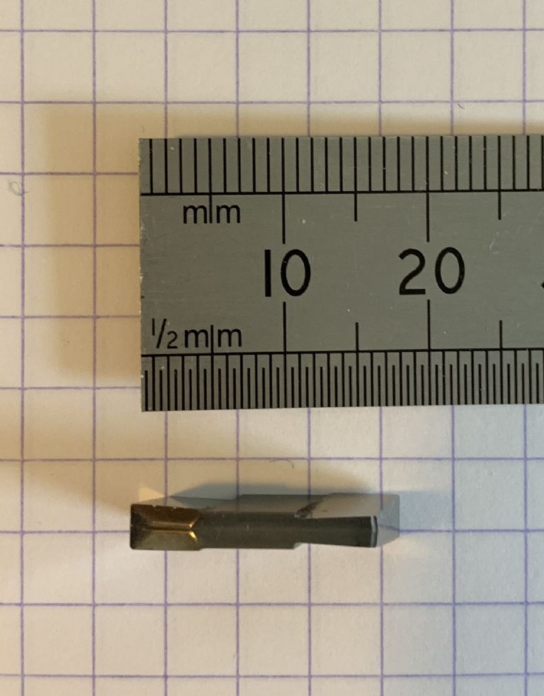

        These inserts were sold by ebay chap as Iscar. I am looking for a holder. They are 3mm wide and have absolutely no markings.
        They are double ended and one end is upside down wrt the other.
        I have spent a lot of time with Google to no avail. Can anyone identify them?

          They are GIP inserts.
          Did they come in a box? The bottom picture looks to show a damaged insert?
          Jim

            No box. No they are brand new and it's just my rubbish photography. Many thanks, yes they look very like the ISCAR catalogue. Related tool comes up with a range of tools but none for 3mm. Will keep searching.

              Have you tried cromwell for a CGHN-DG3

                iscar try here
