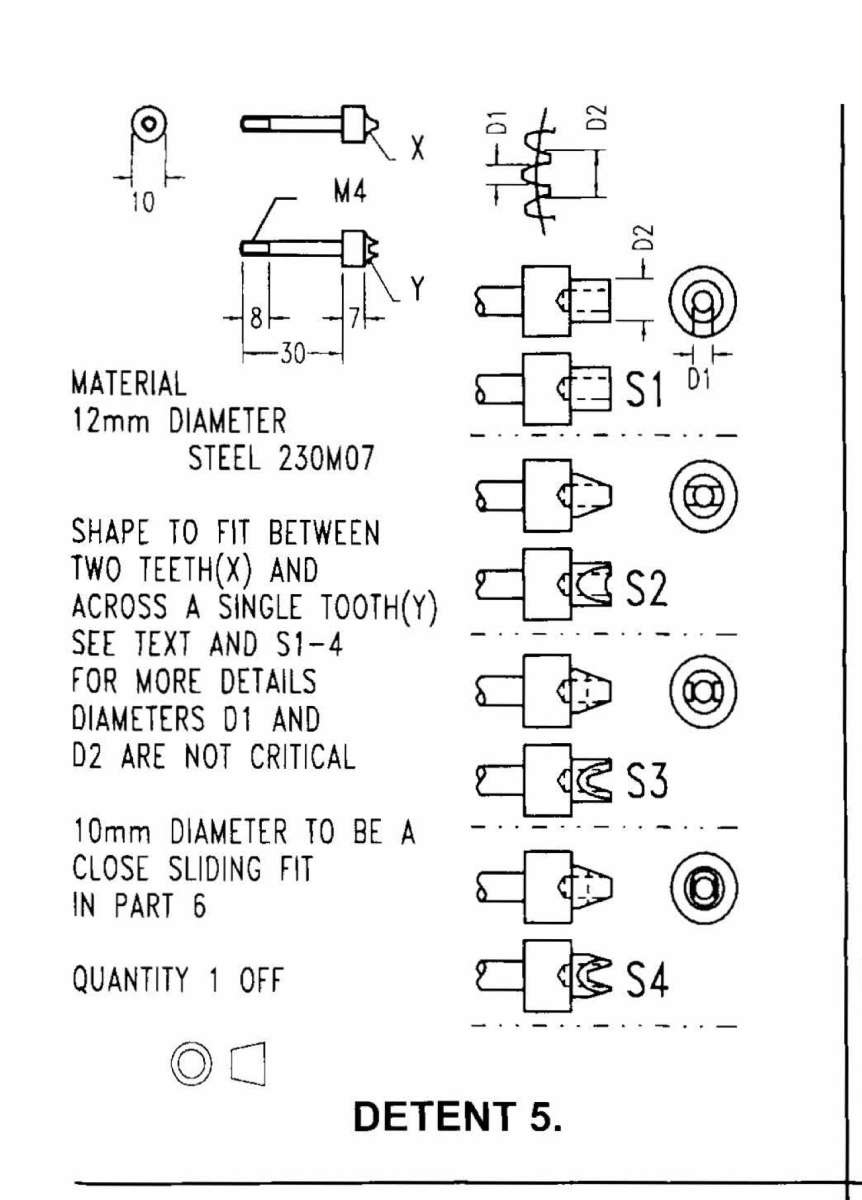

        Great idea with the index/bolt. Looks like you could make/modify that further to incorporate a spring (and possibly make more than 1) to save all that winding in.

          I like the ideas of using male and female detents to give a half tooth advance. (3 degrees with a 60T)

            Yeh I do too (re. male and female detents). Im a little concerned about how much steel will need to be removed to miss the next teeth (as the gears are so small), but let’s see if possible.

              Workshop Practice #37 ‘Dividing’ illustrates the concept quite well

                The normal method of getting the male/female detent is just to stark with a wedge or ‘screwdriver blade’ that fits into the gap between teeth and then file a V notch across it that fits over a tooth. Make a spring loaded detent that rotates and it is child’s play to double the number of locations.

                  I think that is what I was expecting to have to do, my concern was as shown in S4 above. Not much meat left on that.

                  approx 5.4mm then the female removed.

                      Don’t worry there is a special tool specifically designed for this job – called a triangular file. The job requires almost no precision.
                      Also unless you were thinking of making it out of chocolate it will be plenty strong enough. Edit : and brass or aluminium will be easier to work than the steel mentioned on the drawing.
                      Don’t overthink it.
