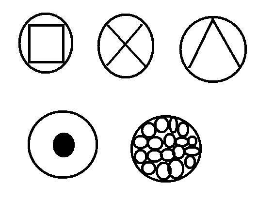

    Ady1
      @ady1
      More a thinking aloud query, crowd thinking
      I have some reasonable seamless steel tubing which could be used for say, making a light drilling press and would do a very reasonable job but it would be nice to "make it as strong as posslble" and fill the void with something which would spread the bending moment across the tube wall if you tried to do something more stressful like light milling
      A very good Concrete mix is the obvious answer but there are also various epoxy mixes out there
      Anyone got any suggestions/knowledge?

        #192458
        Ady1
          @ady1
          Or putting a fabricated stiffener in with the mix, a piece of steel box section for example
          Or packing it with steel rods

            BobH
            #192475
              Depends on your tube, I suppose.
              I just played with an online calculator. For a 500mm long steel tube with a 50kg load (a typical drill press needs about 35kg to push a decent sized drill into steel, but I won't calculate exaclty what force this translates to at the column!)
              For different wall thicknesses these were the deflections:
              Wall Deflection
              0.5mm 4.1mm
              1mm 2.1mm
              1.5mm 1.5mm
              2mm 1.1mm
              3mm 0.8mm
              4mm 0.6mm
              5mm 0.5mm
              6mm 0.5mm
              25mm 0.3mm (solid bar)
              Interesting how a 4mm wall only deflects twice as much as a solid bar.

                                  If you are going to be using the machine for manual milling, so separate X and Y movements rather than a combination of the two then you could increase the stiffness in just the X and Y plane by somehow welding a 'cross' cross section piece down the middle. (like your second example but rotated 45degrees to align with the axis of the machine). A round section gives the most efficient use of material as it has the same stiffness in all directions.
                                  To make life easier and achieve a good compromise I would probably fill the tube with an epoxy loaded with a filler, metal particles or fibres?? I think this practise is used for modern machine tools to absorb vibration when cast iron is not used….

                                        Hi Ady1
                                        Some back of the envelope thoughts and musings re your drill press or machine……
                                        I ran A computer program to test for deflection with a load of 35kg applied laterally at the unsupported end of a 500mm hollow steel tube, over a few different sizes and got:
                                        1.28mm with a 35mm 5mm wall tube.
                                        .97mm with a 35mm 12.5mm wall tube. (Note wall thickness 10mm hole in centre)
                                        .39mm deflection with a 50mm x 5mm wall tube
                                        .11mm deflection with a 75mm x 5mm wall tube
                                        .04mm deflection with a 100mm x 5mm wall tube
                                        To completely "fix" a tube (beam) to an unyielding support structure is difficult, there will most likely be some flexure at the fixed end connection, this would increase the deflections mentioned.
                                        As the numbers show, Increasing the diameter has a much greater effect on the stiffness then making the walls thicker. When a beam is subjected to a load the stresses on the load side of the beam are in tension while the opposite side is in compression. The centre of a beam is sometimes called the neutral axis, the closer to the centre you get the less tension or compression forces are applied to the material, in the centre there is equilibrium = no stress. this partly explains why making a beam solid has less effect on stiffness than making it larger, thus moving the tension compression faces further away from each other. Adding material to the centre where the stresses are low is not an efficient use of material.
                                        Filling with Concrete or Epoxy composite materials will increase the vibration damping but not materially increase the stiffness compared to steel they are both less stiff. Using them requires greatly increasing the thickness of the beam or structure as done by the big CNC machine builders.
                                        You also have to consider the strength of a material as opposed to its deflection. Will the beam resist permanent bending damage or creep? will it resist fracture caused by a fluctuating load? (Just like when you bend a piece of wire back and forth to break it). When working with machinery that requires low deflection for accuracy strength normally looks after itself. It should however always be checked and considered.
                                        Regards
