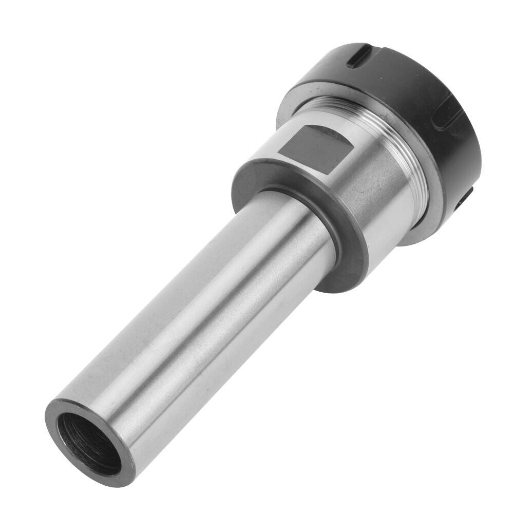

                                        Instead of having to turning the hex sides on the ER holder get one that is already round.
