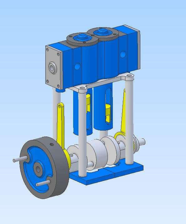

                              I did have a quick play with my 3D part files last night and it would not be hard to use most of the parts to make an inline twin, just a few alterations to some. I have shown a bit of shape to things like the single block cylinder and entablature but they could just as easily be left as rectangular blocks if it is more of a runner than a looker you are after. It could also be done in a Vee configuration is that is more appealing, that also simplifies the crankshaft which is probably the hardest part of an inline twin
                              BL Twin
                              Others that would suitable candidates for making into twins are the Stuart Simplex and Gamages NDC again barstock engines. These were all marine engines back in the 1920s when Pond Boats were a popular passtime basically seeing who could get to the far side of the pond first.

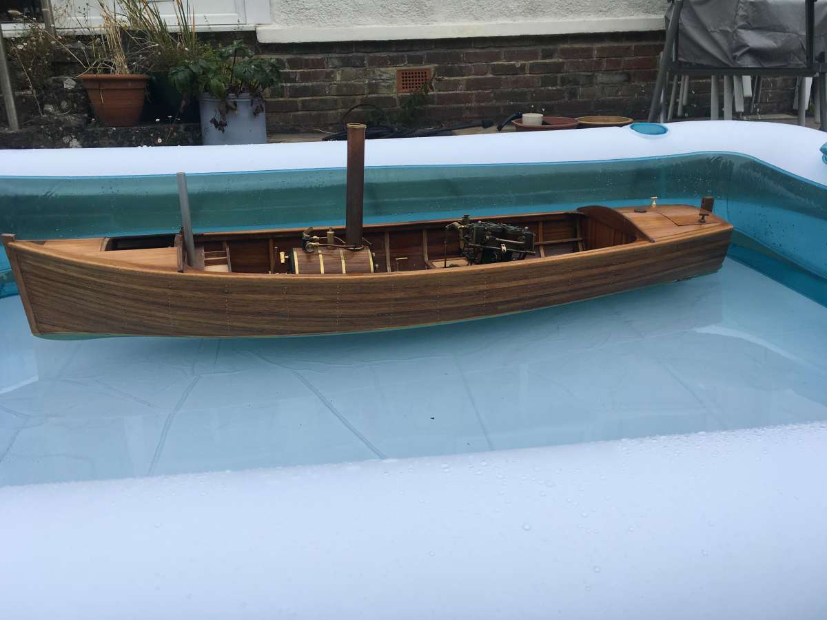

                                Just to help get things into perspective, when I first went to sea my Dad dabbled in buying and selling antiques at fairs etc.  One day I arrived home from a trip and he showed me a steam powered model boat.  I didn’t have a clue what it was but I now know it was probably something like a Basset Lowke.  I fancied it so asked him if I could buy it.  He said sure, for 20 quid. We are talking late 70s here and I was still an apprentice.  I asked what he paid for it and he told me 50p.  I returned to the ship determined to prove to myself and him that I could make my own engine.  All I had to go on was what I had seen of this boat, I didn’t even know what ‘oscillator’ meant then.  When I got back to the ship I made a sketch on a piece of paper and took it down the workshop.  I made the engine below.  The main body is obviously a couple of brass pipe fittings and the cylinder and piston are both made from a scrap brass fuel tank sounding tape weight.  The only point being I would suggest that any newcomer starts with something very simple and achievable.
                                30-11-06-10SteamEngineHomeMade1

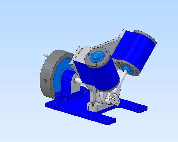

                                  Basic layout of what a 90deg Vee Twin version of the Bassett Lowke as an oscillator may look like.
                                  bl v 2

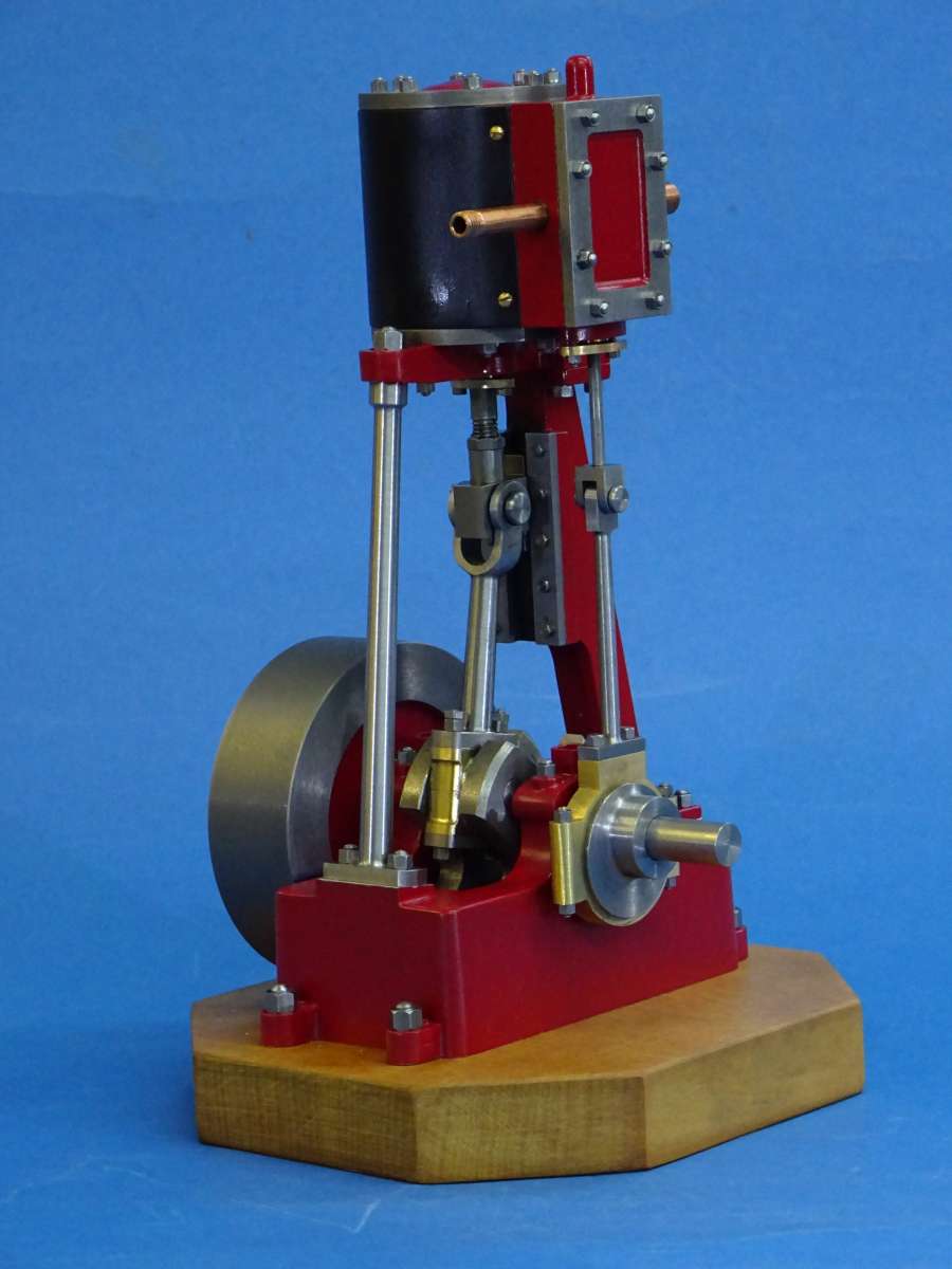

                                        The cost comment is interesting. On numerous occasions when building my “barstock” versions of an engine I have done the sums and compared them to what the same or a comperable casting set would cost. In all cases I have come out at 1-3rd to a half the cost of the castings.
                                        I cost everything so no scrap box diving. Smaller section I cost at a full 300mm length and larger section by the 25mm length so as I said earlier the builder will often end up with material to spare which can either be put towards the next engine or should a part not turn out right you have material to hand for another go. The added bonus is you have a decent length to get hold of rather than short sawn lengths that come with kits.
                                        An example is this vertical the same size as the original Stuart No 7 before it became the A framed 7A. Current cost of a kit is £446.00. Materials including some packs of nuts just under £150. Muck up a 7A cylinder and you are looking at  £77.00 compared to £31.00 for the fabricated. Infact nearer £21 as I included a 300mm length of material for the end flanges in the total price so you would have had that to spare.
                                        All materials could be got with one orfer from M-machine and one other order for fixings.

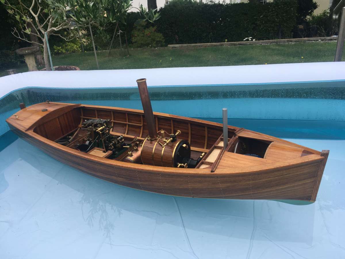

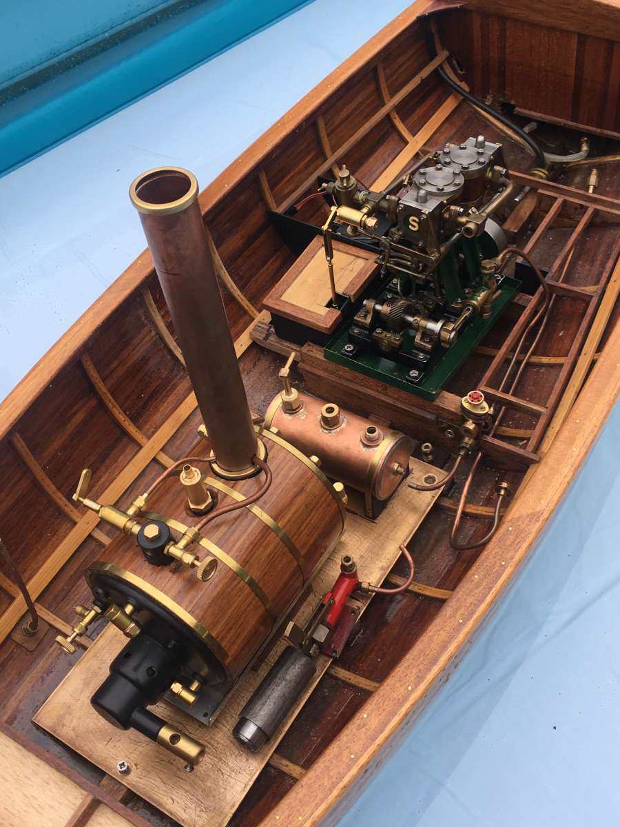

                                          Seems like you have found a good business opportunity especially as so few metric design drawings are available!
                                          CIMG_1457IMG_1462IMG_1463ouple of pics of my steam boat project – been ongoing for many years and recently restarted with a new boiler and radio installation.

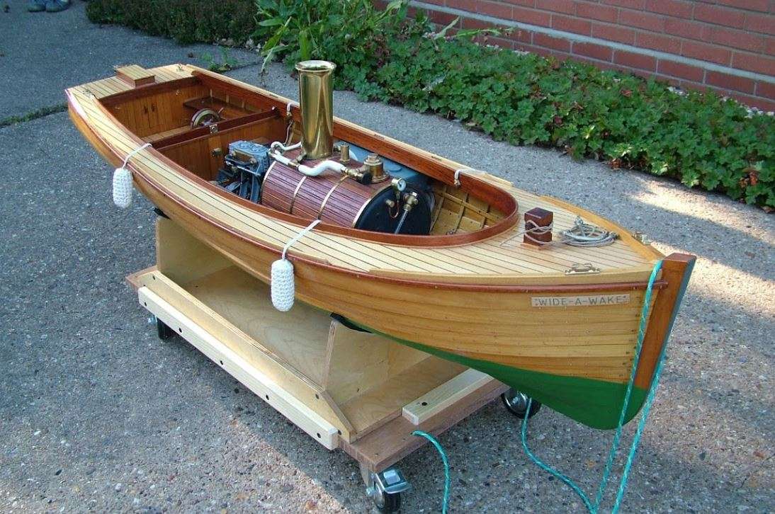

                                                  Out of interest the original Basset Lowke “Eclipse” was intended to be used with their “Streamlinea” boiler and they also had a hull by the same name which was 1.0m long so a twin of that sort of size could work in a slow moving Titanic though my gut feeling is that going up a bit in bore and running the engine at a slower revs could well be the better option, Richard S shoud be able to advise.
                                                  As for the installation it could be quite simple with just a boiler that will allow running until the water runs out ( as below) or you could go for something more complete like RichardB shows where you have tanks of additional water and a boiler feed pump run off the engine which means you can steam for a lot longer.

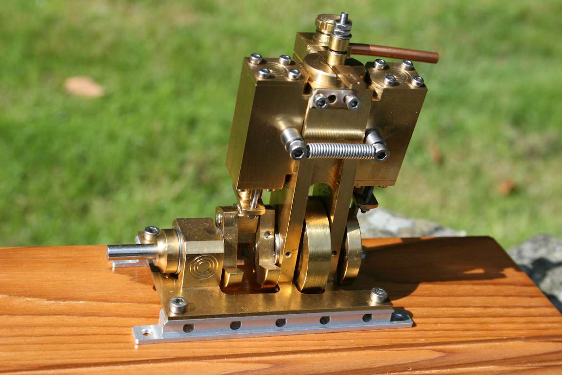

                                                    One of the more active members there in the sites heyday was a very good friend of mine who used the ID Bogstandard and who built this engine, sadly now passed away:
                                                    27-08-10-19BogstandardTwin2
                                                    The engine is a bar-stock engine so possibly one of the simpler engines to consider building as a first attempt.  Having said that a small oscillator such as that is more than capable of powering a model boat of the 3 to 4 foot size with complete control through a single channel.

                                                      The engine by John “Bogsteandard is basically one of JP Duval’s designs which is on the web if you don’t want to register for Paddleducks
