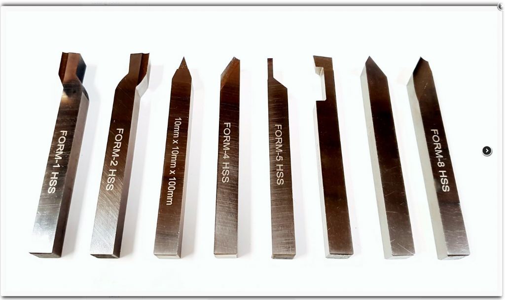

      Please can someone tell me the specific purpose of the third tool from the left and the difference in purpose/application of the form 4 and form 8 tools.
      Thanks.

        Mick B1
          @mickb1
          Haven't really got a scooby. The point angle looks too small for screwcutting – except maybe BA?
          That's why I generally buy square-section HSS blanks and grind 'em to whatever form I like.
          laugh
          #651087
            Most seem to list it as "straight finishing 60/55deg" so I would say it's just a knife tool for detail work as the same sets have separate threading tools.
            Why not phone Amadeal and ask Hugh what it is.
            No4 is Chamfer
            No8 a threading tool
            Edited By JasonB on 05/07/2023 19:03:06

            Bill Phinn
              @billphinn90025
              Thanks for the answers.
              This link calls form 8 "a corner tool" suggesting, to me at any rate, that it's intended as another chamfer tool, like form 4. Both form 4 and form 8 in my set have 90 degree tips. What the essential difference is I don't know.
              The 60 degree external threading tool is the second from the right [form 7]. There isn't a 55 degree tool in the set, or an internal threading tool. Am happy to have a go at making these when/if needed.
              I'm not sure what a finishing tool is [for taking very light cuts and producing a good surface finish?]. In my set, the third from the left has an included angle of 40 degrees, so I don't see how it can be used for threading. But it looks like it would be very good for chamfering in very tight spots.
              Amadeal are closed for business until 12th July.
              Edited By Bill Phinn on 05/07/2023 20:41:10

                Bizibilder
                  @bizibilder
                  The 40 deg pointed tool (number 3) is just right for making the grooves in pulleys to take poly "v" belts. Otherwise it is a tool for getting into tight places that other tools cannot reach.

                      Chris Mate
                        @chrismate31303
                        Maybe you can swing tool 3 Left-Right a bit in the toolpost or the whole toolpost to get more use for it like a wide groove Left-Centre-Right, or near a live centre where space can be a problem.

                        Bazyle
                          @bazyle
                          As Chris says don't feel restricted to mounting the tools at right angles to the axis of the lathe.
                          A 'finishing tool' is to differentiate it from a 'roughing tool'.
                          A roughing tool is often shown as looking a bit like No4 and with a rounded tip. This is to avoid a fragile sharp point that can break or overheat and so that the forces are diagonal pushing out on all the lathe top, cross, and feed screws to avoid chatter. This tool is used by the gorilla in the workshop but may leave a rough finish and no sharp inside corners because of that canted over leading side.
                          Then the finishing tool has the necessary sharp point to get into the corners, a small radius to avoid a stress raiser and provide enough strength if used carefully, and maybe a small flat on the tip parallel to direction of travel to prevent the finishing pass looking like a very fine thread.

                            RDG are just using generic images for a range of tools. the one in the link is showing an SCLCR holder where the last "R" signifies it is for right hand use. ARC have it engraved onto the tool

                            Peter G. Shaw
                              @peterg-shaw75338
                              I must admit to also having come across all these names/ideas etc, and like Mick B1 above, I long since stopped buying pre-ground tools as I invariable ended up either not using, or regrinding myself. For most of my turning, I have tended to use the tool which cuts when moving towards the headstock and thus has it's cutting edge on the left hand side of the tool, and which I know as a Right Hand Turning tool. What's in a name though?
                              It's worth pointing out that the RH Turning tool can be used, if canted over somewhat, as a facing tool as well. (Shock, horror, gasp etc). Hence, I can get away with a lot of my external turning with just the one tool.
                              I may as well point out that some years ago, I started using carbon steel tools as well, old files actually, softened, cut up, reground, and then re-hardened. Ok, they don't last long before requiring re-sharpening, but hey, the material is free, ie worn out files.
                              I do have a set of HSS tools hidden on a shelf somewhere, but never used. Why? Because I never seemed to need to use them given what I already have. But, I did make one mistake with this set – I bought 1/2" or 12mm square shank tools as the lathe was able to take them. A further and much bigger "but", is the amount of regrinding tools of this size take! So, don't buy the biggest tools your lathe can take: for our purposes, 1/4" or 6mm square tools are perfectly adequate – yes you will need packing to get the cutting tip at the correct height, but sharpening/re-grinding is so much easier, there being less material to remove.
                              I haven't really bothered about the distinction between roughing and finishing. I think it was Tubal Cain, (T.D. Walshaw) or maybe L.C. Mason who said that the average ME never uses the equipment at rates requiring a roughing tool, so I always sharpen mine as a finishing tool. I did once do some experimenting to see what the lathe could handle. Never again. The lathe was happy, but I wasn't given the amount of smoke generated by the cutting oil. So another reason for lightweight cutting.
