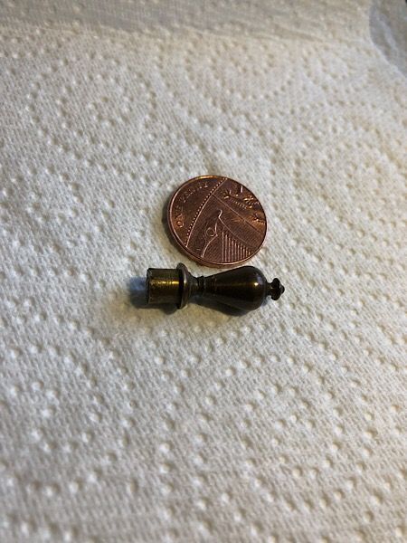

      How would you go about making 2 matching versions of this finial?badafb56-f26c-4137-8e4a-5e019ee6e4dd.jpeg
      I have turned pieces threaded the base so i can hold it in a fixture but how on earth do i turn the small features?…hand held gravers perhaps like woodturning

                        Ian Parkin
                          @ianparkin39383
                          I’ve just done some testing on the sample of brass that i’m Using
                          I remembered that i have a 20 degree pointy tool so i measured the original to a set of co-ordinates from base and diameters and using the dro just plunged in to get the diameters and then a quick smooth with emery and a scotbrite pad and job looks good
                          The originals were brass just heavily tarnished

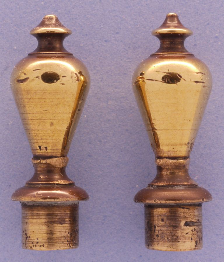

                                      Ian,
                                      You will presumably recognise this pair:
                                      Looking at the machining marks, rather than the polish and wear: I would say that 'beyond all reasonable doubt' they were turned by plunge cutting with a form-tool.

                                      Mick B1
                                        @mickb1
                                        Posted by Michael Gilligan on 08/12/2017 18:21:16:
                                        Ian,
                                        …but that doesn't necessarily mean it'd be practical for a home machinist to make 'em that way. They look like maybe stair-rod ends, turned in thousands with circular form tools, possibly with rear support, on Swiss-, cam- or multispindle autos.

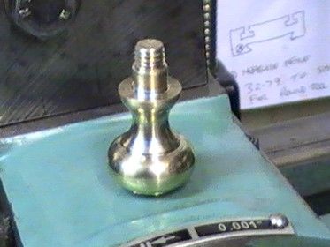

                                        Emgee
                                          @emgee
                                          Major diameter 19mm, M6 thread.
                                          Emgee
                                          #331107
                                            Posted by Mick B1 on 08/12/2017 18:37:15:
                                            I never suggested it would be, Mick
                                            … It was merely a point of reference.
                                            [and a more detailed image of the item in question]
                                            Major diameter approx. 8.6mm
                                            Edited By Michael Gilligan on 08/12/2017 19:17:45
