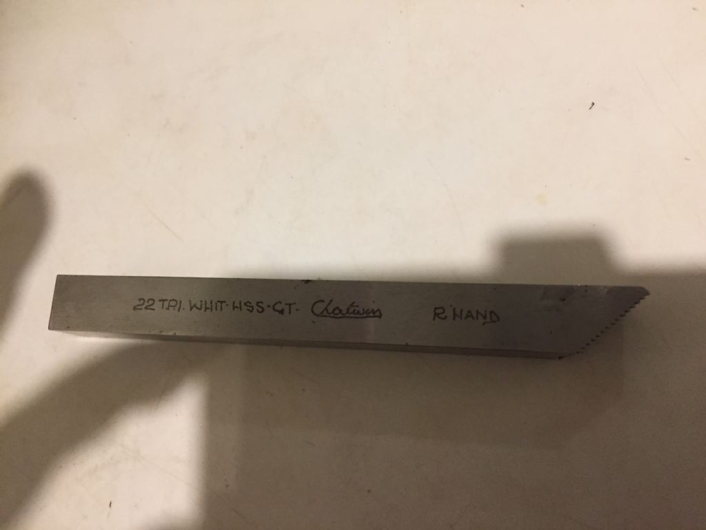

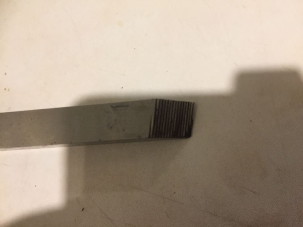

        Found this in a box of miscellaneous tools given to me:
        Obviously a threading tool, but how and in what circumstances might it it be used I wonder?

          Tapered thread chaser ? my Zeus book states 22 tpi as 5/16 BSF, must be a home made special.

              Not home made,…it's a product of Thomas Chatwin makers of fine threading equipement mainly for industry, and it's for 'chasing' or repairing/polishing threads. Its used in the top slide which is set to the right angle for the particular thread and then can be fed into the thread until the required finish is atained.

                    Yup, a thread chaser. Useful for cleaning up a single pointed thread. Particularly when full profile threading tools were called dies.

                                  I've seen straight chasers with a tapered tang that looked as if they were made for a file handle, but not one with that angle before.
                                  I'd guess it was designed to work in an angled toolpost close to a chuck or other workholder, avoiding collisions with projections.

                                          The tool looks just like a hand chaser as would be used by a woodturner. Very commonly done in some forms of wood and exotic material turning. I once watched the now deceased Bill Jones make up a chess king out of about 6 pieces of ivory (or more likely imitation ivory), all individually turned and hand threaded to fit together to form the finished piece in order to maximise the use of the material. Hand threading lidded boxes is pretty commonly done nowadays, usually in boxwood, African blackwood and other very dense timbers to take and hold a fine thread. There is definitely a knack to doing it but if you are shown the technique by someone who knows, you will have a fair chance of making a functional male and a female thread within an hour. Lots of stuff on Youtube as usual eg **LINK**. Hand chaser sets are available for wood turning. I know nothing about hand chasing metal, you may not be surprised to hear ….
