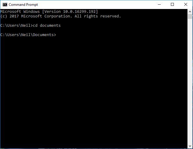

      Open Command prompt or type in CMD into the search toolbar and it will find it for you
      First you have to change your folder destination to where CamCalc is downloaded, so for me it was in Documents. Type in (without the colons) 'cd documents'.

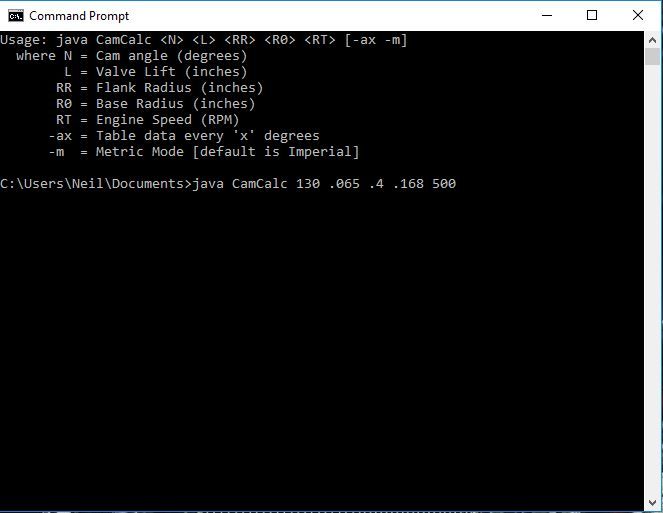

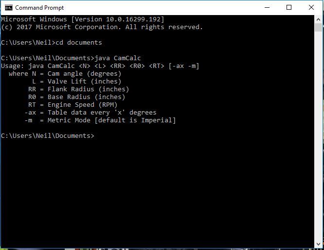

      Then to run the programme type in the following (I'm using the hoglet cam profile as an example) 'java CamCalc'

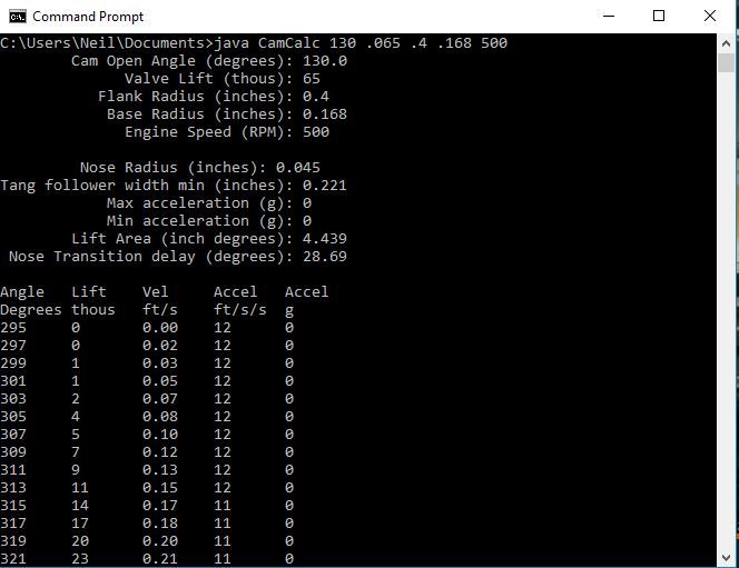

      Here you can see what order the details need to be entered. Take note that the engine rpm doesn't have any effect on the profile of the camshaft but it won't run unless you enter a figure so just put a guess if you don't know. So for me i had to type in 'java CamCalc 130 .065 .4 .168 500'
      Then it will display a table of results

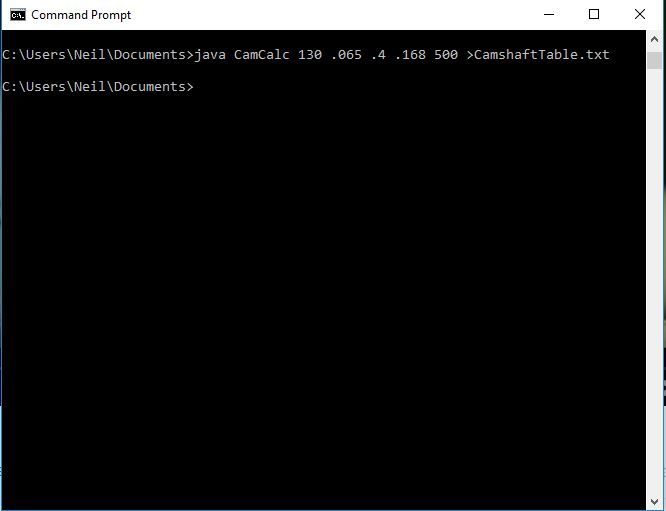

      If you wish to export the results into a text file then you will need to type in 'java CamCalc 130 .065 .4 .165 500 >CamShaftTable.txt'
