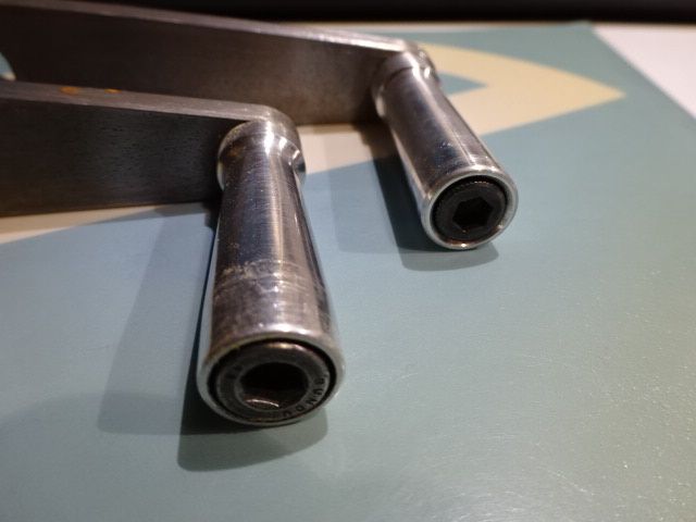

          I usually make starting handles for the hit and miss engines using a cap head bolt as the spindle. handle is drilled a nice running fit on the plain shank of the bolt and counter bored to take the head. No need for a shoulder bolt if you make the length of the through hole just less that the distance between end of thread and under the head. Screw bolt in until it runs out of thread and there is still a little lengthways play so the handle does not get locked up tight.

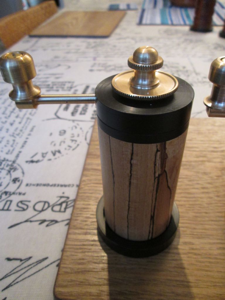

                  I make a shoulder screw with a plain diameter a few thou longer than the distance from the bottom of the handle counterbore to its undersurface. Not difficult, and works fine on salt grinders.

                          I made a couple for lathe feedscrew modification. Drilled thru' handle to suit cap head bolt, c/bored for the head, screw into the arm with a drop of thread lock. Just tighten enough, a bit crude maybe but works well.
