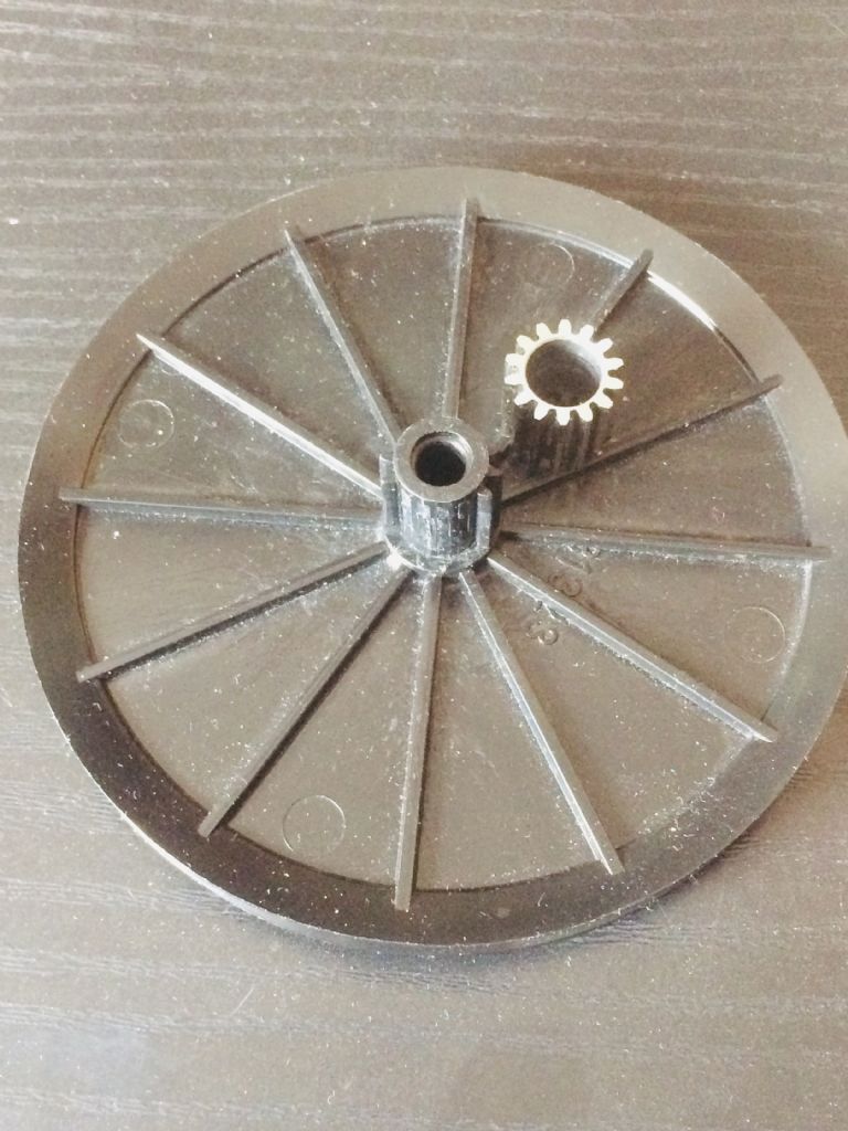

      I am asking for help please? How to glue polyethylene to stainless steel. I have i think a polyethylene injection moulded pulley wheel shalt with a damaged gear shaft I want to bond a new gear cog over the boss what glue can is best to do this. The loads are not heavy. I have a photo if I can attach it to the link!

                    I have managed to load a photo of the parts
                    Nigel

                      1. Looking at your pic I am assuming that there are two remnants of teeth on the pulley wheel boss 180* apart ?
                      2. Is the ID of the replacement gear larger than the OD of the remaining teeth;
                      In which case you could place the new gear over the boss & epoxy resin / JB weld infill the space remaining. If not alternatively remove the remaining teeth fit the new gear cog & if there is sufficient gap between the two Loctite with Loctite 638 retainer.I would also mechanically lock the two together.. e.g.drill & tap through the root of one tooth for 3-4mm grub screw. Gorilla glue is surprising strong as well.. usual disclaimer applies.

                                          There is no point guessing what the plastic is you need to have a better idea. Looking at the photo I think Polyethylene is unlikely to be the material, it is too soft to make a ridid wheel lik the one shown. A couple of quick checks could be carried out on a sample (one of the remaining teeth would do). First is to try disolving it in an aggresive solvent like acetone (nail varnish remover if you don't have the pure kind). If it softens or dissolves it's unlikey to be PE, PVC or polypropylene and can for your application be glued with epoxy, just abrade the surfcae well.
                                          If it does not dissolve try the tests here:
                                          https://www.twi-global.com/technical-knowledge/faqs/faq-how-using-simple-manual-tests-can-i-identify-an-unknown-plastic-material
                                          If the wheel runs on a shaft, whatever plastic it is, if you cut LH and RH grooves in the surface an epoxy would probably make a adequate mechanical joint regardless of surface adhesion. There is big surface area and the joint is in shear both of which are good for a bonded joint.

                                            For ease of reference, I have copied Nigel’s photo to my Album and posted it here:
                                            The choice of background colour is perhaps unfortunate, but the ejector pin marks are quite evident and there is some identification numbering visible [which appears to have been in the tool before the spokes were created]
                                            It is impossible to tell from the photo, but: to me, this doesn’t look like a polyethylene moulding.
                                            … and the snapped-off gear teeth certainly suggest something much more brittle !
                                            My guess would be either polystyrene or ABS
