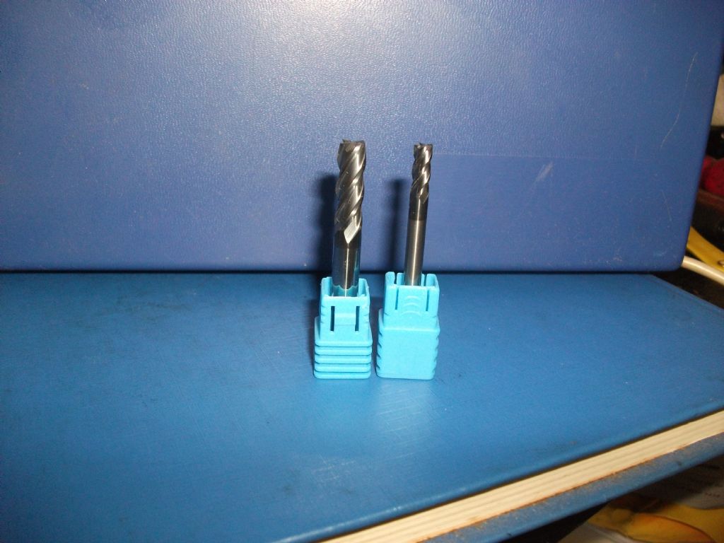

                                    I buy end mills now from Ali******s as seen here in the photo,
                                    the 4 mm are about £1 each and the 6 mm £2 each
                                    delivered ,they are most probably the best cutters i have ever
                                    bought .
                                    At least one of the suppliers mentioned on this thread
                                    had supplied me with cutters in the past that were blunt,
                                    after an exchange of words with the proprietor he actually
                                    admitted that he knew of the problem and came out with
                                    the old excuse lots have others have had them and not
                                    complained .I sent them back and was refunded i only wish
                                    that i had sent back the supposedly ball end mills as well
                                    as the were also rubbish.
                                    These Ali******s mills are carbide TiAIN coated and most
                                    on here would call them cheap cutters ,perhaps it would
                                    be as well to remember that all of the cutters that you
                                    buy over here are most probably also made in China.
