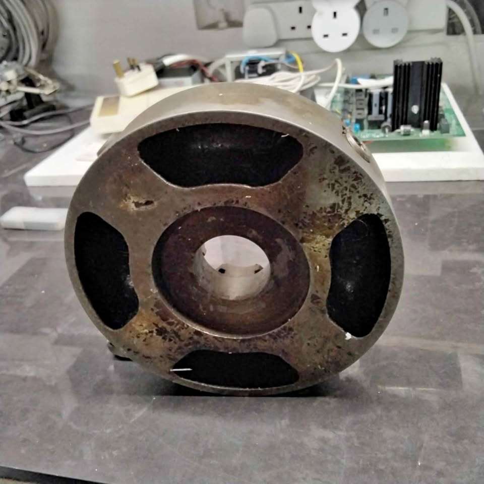

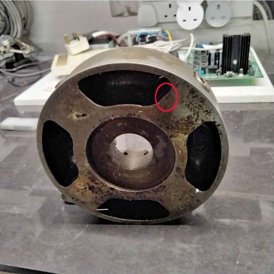

      Someone nearby has a chuck for sale that has no obvious (to me) means of fitting a backplate as there are no holes drilled. How would this be mounted? It looks similar to the internally threaded light duty chucks for Myfords, but has no thread.
      Chuck
      #770725
      Robert Atkinson 2
        @robertatkinson2
        Might never have been mounted on a lathe. Could have been used as a bench vice, on a surface grinder magnetic chuck or held in a larger chuck on a big lathe for a few examples.
        I think I can see faint circular marks that could be evidence of stick-on feet. This would support use as a bench vice.
        You will need a faceplate…

          Given that it is a four jaw chuck, the crop circles you see are the same as nearly every other four jaw chuck: they retain the screws that move the jaws.

            It may have been used in a larger 3 jaw chuck to give the 4 jaw utility without having to change a much larger chuck on and off a lathe.

              There is plenty of metal there to drill and/or tap should it need to go on a backplate. Check the thickness in the cavities, there may be enough wall thickness for front mounting. I fitted a very small flange diameter backplate to a 160mm four jaw using 8 small studs just outboard of the register similar to yours avoiding getting too close to the jaw screws. I don’t think the mystery of how the back has no mounts will ever be answered.

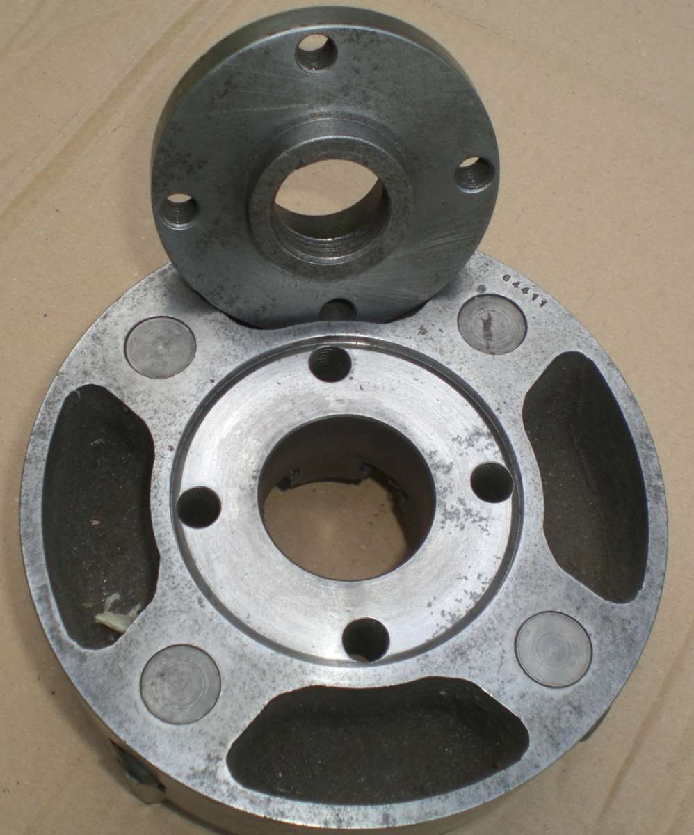

                Hi Mick Bailey, I have a similar or even the same chuck, and a backplate with a short register that fits into the bore of the chuck is fitted into the recess and held by four 3/8″ x 20 TPI cheese head bolts from the front, with the front of the holes counter bored, so the heads are slightly below the chuck face.
                CIMG2248b
                CIMG2251b
                As DC31k says, the circles are for pins that retain the jaw screws.
                Regards Nick.

                        ..there is another reason things don’t complete a manufacturing process.. ..is it cracked in the webs?

                          Hi, well I guess you could drill and tap blind holes in the back, if you so wished, to fit whatever spindle arrangement your lathe has, so it could have depended on the order as to why there are no holes in it. The backplate in my photo above is a Myford fit, but I trimmed up, drilled and tapped a Boxford backplate for it.

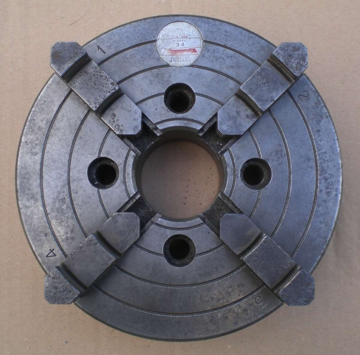

                            Hi, My chuck, No. 34, is on this catalogue page, it doesn’t say if it is pre-drilled though.

                              There’s no visible makers name in the photos so I’ll go over and take a look first-hand. The question over whether it’s cracked is a good one. There are some signs of use, which is puzzling, as there aren’t any signs of the chuck being gripped.
                              The specific requirements of industry are infinite, I suppose, and there are some very unusual tools that without specific reference to their intended purpose would be very difficult to identify how they were used.

                                The no.34 Burnerd chuck sees to have been very popular , especially on boxfords . I have one on my Southbend 9. Also one came with an elliott dividing head i restored.
                                Some of these dont have the no 34 sticker on them but just a serial no. on the edge of the front face.
                                    An industry specific need would explain all.  Pay them enough money and companies will make anything the customer wants. Organisations order specials galore, anything from productivity enhancing lathe accessories, to a new  nuclear submarine, better specified than all existing submarines.
                                    My guess is this chuck wasn’t intended to fit on a lathe. Something slow moving, such as a rotary table on a grinding machine.  Perhaps part of a jig or fixture.   We can only guess because the rest of the set-up is missing.
                                    Could the slots double as a bayonet fitting?
                                    chuckBack
                                    If a bayonet fitting, I’d expect the surface behind the edge I’ve highlighted in red above to be a machined ramp, maybe with a register.  Any sign of machining behind, or are the holes just the usual weight saving feature?

                                      Martin C got it in one.
                                      I bought the chuck, it’s a completely unused Pratt Burnerd covered in the original Cosmoline-type protective grease. It is intended for lathe use – they were ordered by the seller’s company for use on larger Harrison lathes. For small jobbing work that needed a 4-jaw the chuck was gripped in the larger chuck, as it was much quicker than changing a large and heavy chuck just for one job. The chucks were offered undrilled at a small reduction in price.
                                      What looked to be signs of use was swarf stuck to the grease from being stored underneath a lathe.
                                      Whilst I would have preferred an internally threaded version, I think it will work out with a backplate for my ML7.

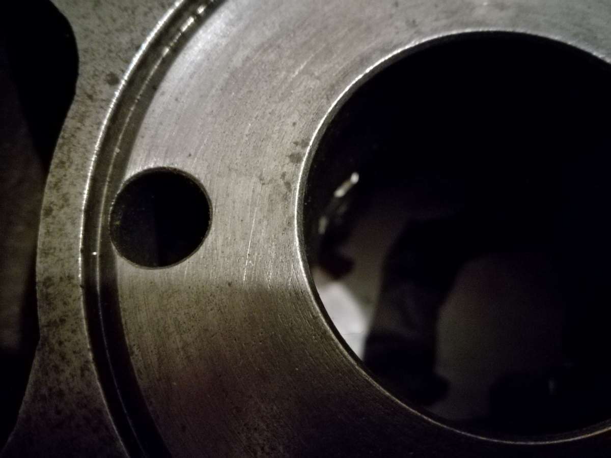

                                        Is it my imagination but has there been studs in this chuck there seems to be outlines as though the studs have been machined off as marked by the arrows

                                          They are the outlines of the jaw-screw retainers, typical of chucks of this design. Normally more prominent.

                                                    Nick, if its not inconvenient would you mind measuring the register diameter of your chuck and the PCD of the mounting holes and flange thickness ?
                                                    The register in my chuck is too small to fit bolts and I’d need to machine it out and possibly drill and counterbore the chuck body, or maybe drill and tap it from the rear and fit allen bolts.

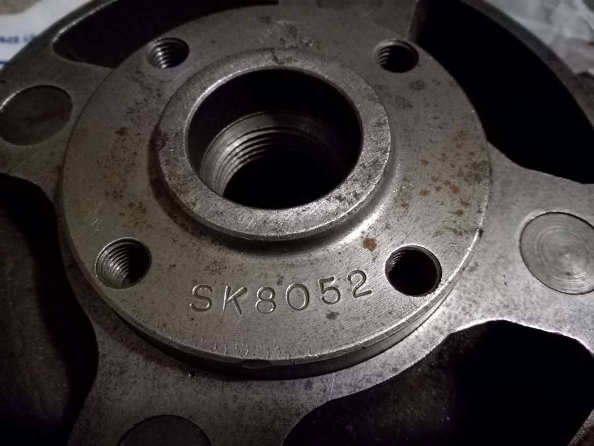

                                                      Hi Mick Bailey, the register on mine is 3.25″ x 3/32″ deep, and the hole PCD is 2.75″, with the holes being 25/64″. The bore of the cuck is 1.625″, and there is a good undercut in the corner of the register.
                                                      IMG_20241219_161356#b
                                                      The backplate has an overall length of 1.04″ that fits on the spindle, and projects into the chuck bore by 0.326″ and a diameter of 1.5″, the flange is 0.488″ x 3.25″, but is only a close fit in the register, the backend has a raised portion of 0.192″, and a diameter of 1-11/16″, and this has a 1/2″ long register for a Myford mount.
