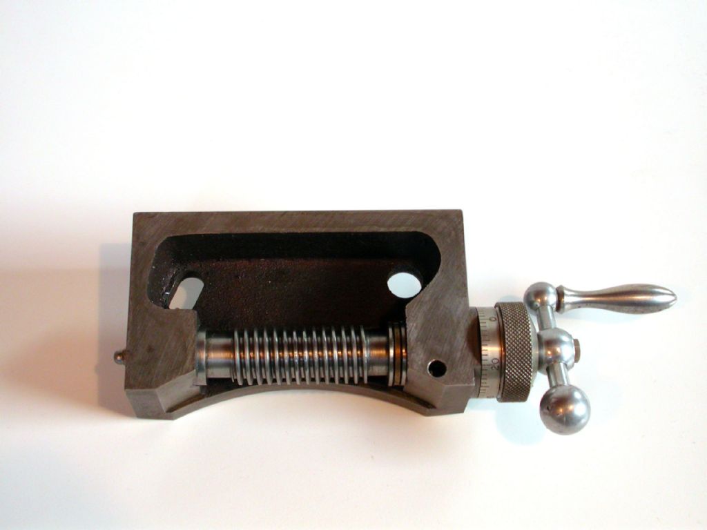

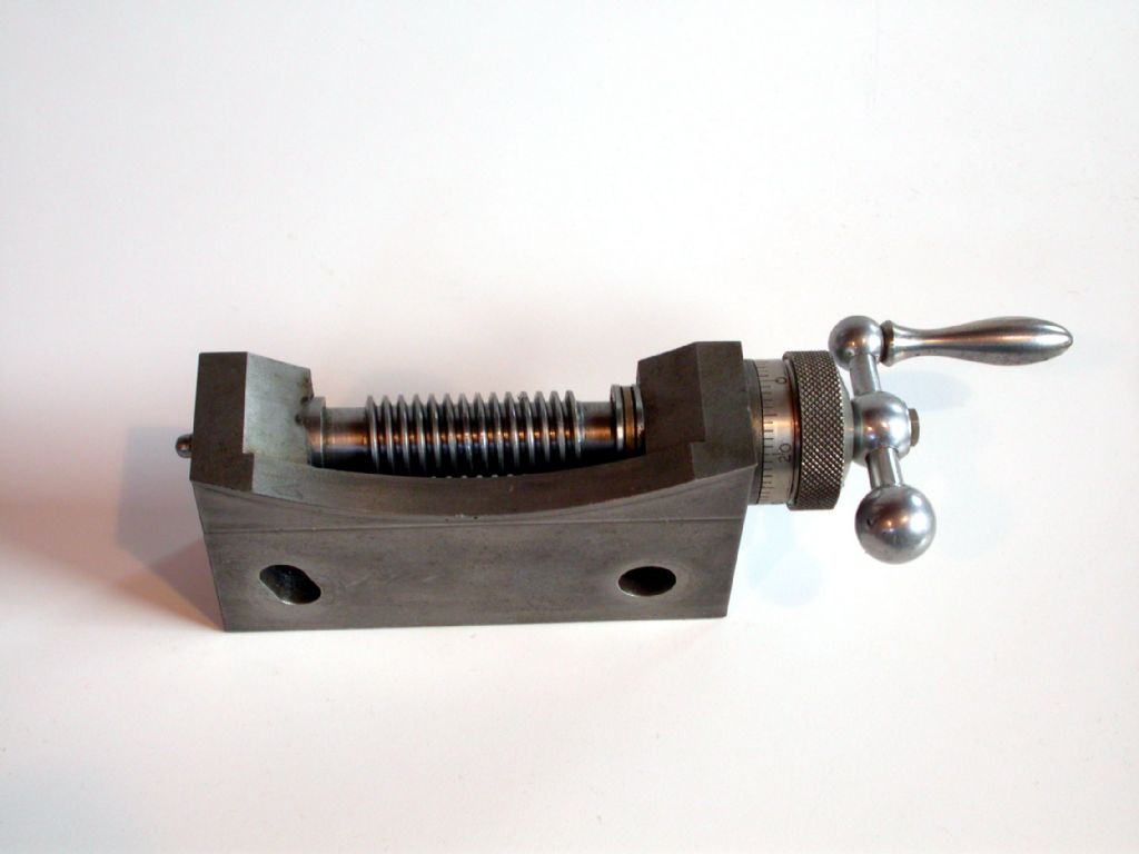

                                #482091

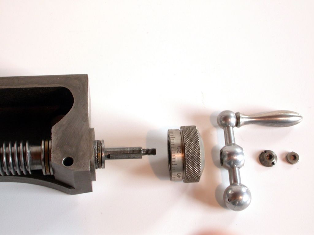

                                  Just found some photos of my worm housing, which might illustrate how nicely built the BCA was:
                                  The arrangement of the worm in its housing is a delight:
                                  Plain bearings are bored directly in the cast iron, and thrust bearings are fitted both sides at the handle end … leaving the distal end to float. The preload/backlash is adjusted by the conical nut and hexagon locknut that retain the index and ball-handle. [Both sliding on a keyway].

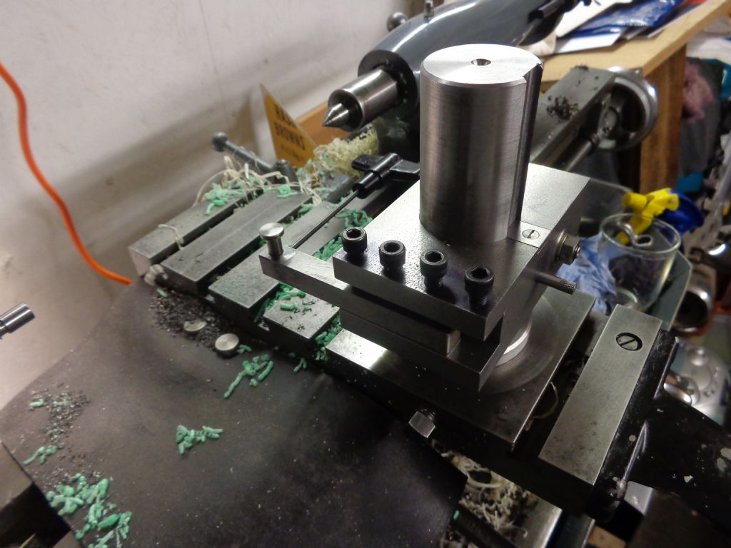

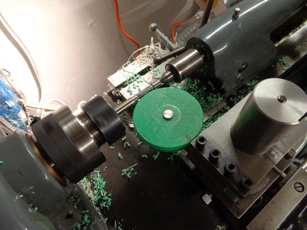

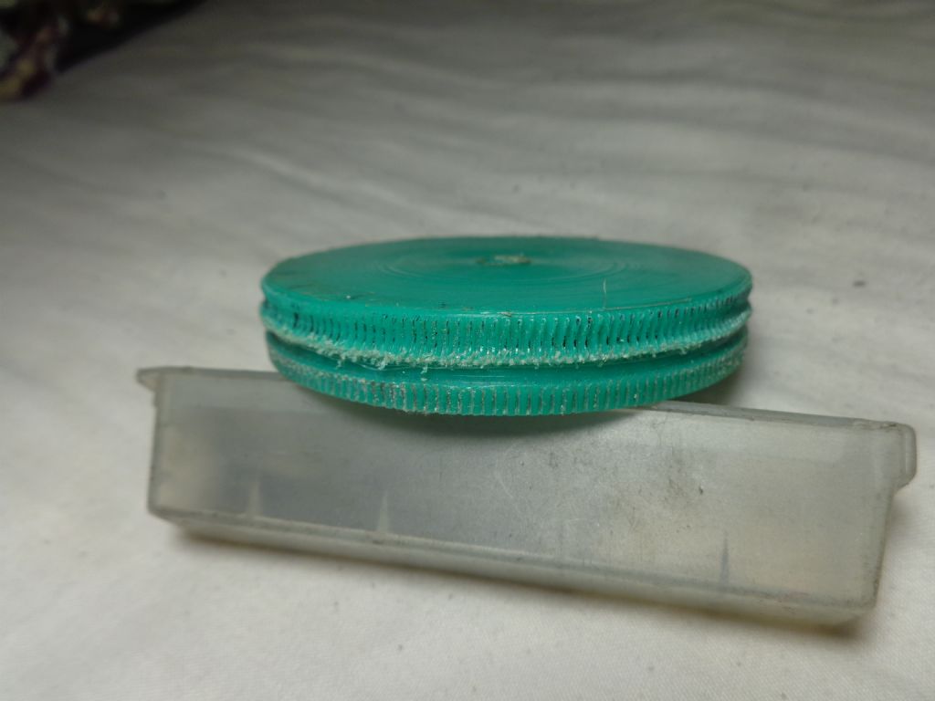

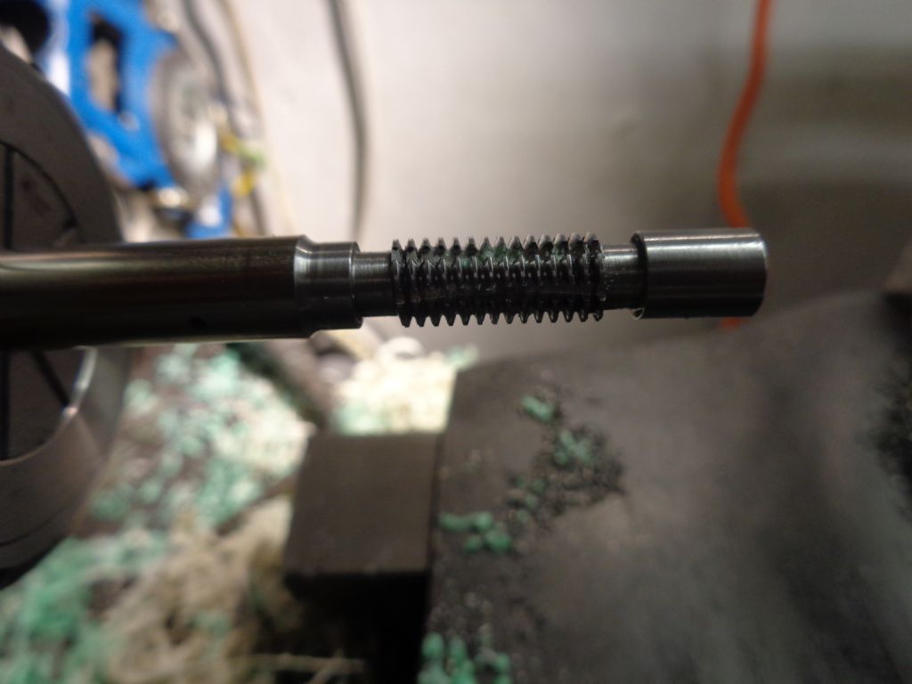

                                              William S
                                                @williams
                                                Evening all

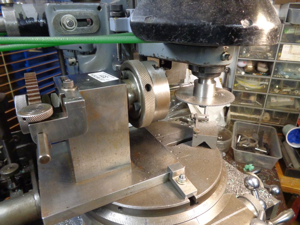

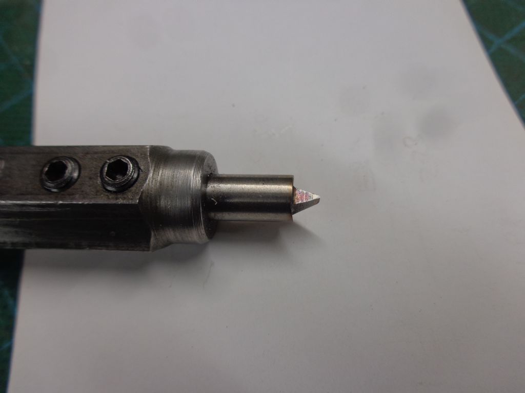

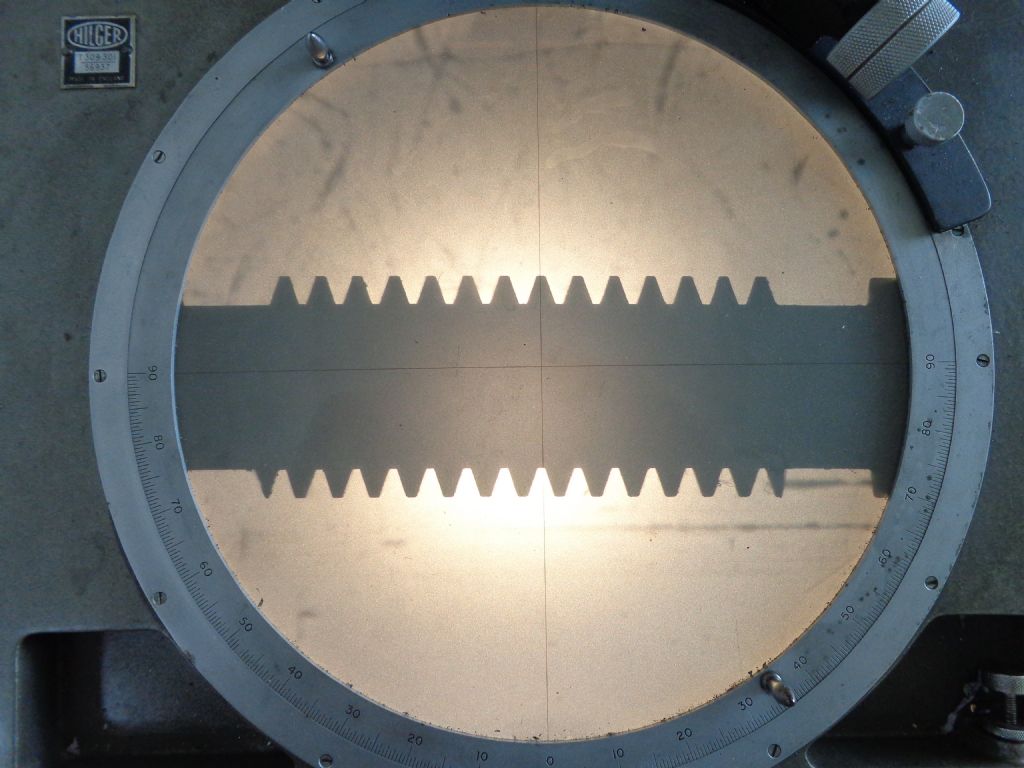

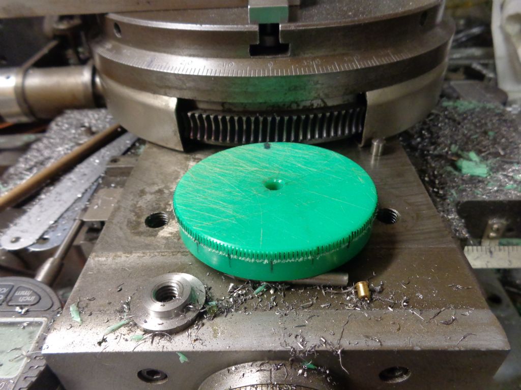

                                                So armed with the above information I have had a go at hobbing a worm wheel.
                                                Began with grinding a 20degree pressure angle single point tool(done on the little d bit grinder takes a bit of faffing about the get the clearence angles!); dsc00156.jpg
                                                Then I set the lathe the cut the hob, 64dp which meant swapping the input gear for a 33t. The hob screwcut, then some cutting edges formed with a slitting saw. Couldn't find a piece of 8mm silver steel so I used a piece of printer rod, I haven't harden it as it was only a test;dsc00152.jpgdsc00146.jpg
                                                On the shadow graph at work just to see what it it looks like, not bad if I say so myself!; dsc00142.jpg
                                                First test went well, an old chopping board was the material only issue was not making it single enveloping and not gashing caused 179 teeth;dsc00155.jpg
                                                Final test achived the magic 180t (gashed with a slitting saw) and a single enveloping wheel;
                                                So all in all not bad, totally doable I reckon, I will now refine the hob in silver steel, harden then have a go in a piece of metal!
                                                I think I will now take the time to do some drawings of the BCA, I might start a thread when I come to do my model for those who are interested.
                                                Many thanks for all the input
                                                William
                                                Edited By William S on 01/07/2020 00:11:15
                                                Edited By William S on 01/07/2020 00:12:13
