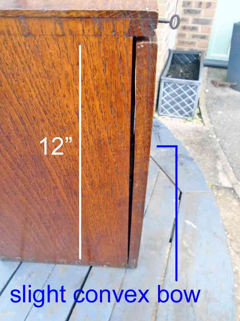

      Hi all,
      We have a very nice small oak watchmakers tool cabinet with a couple of issues to sort out.
      It has a front flap that is hinged at the bottom with a small lock at the top.
      I am making some small bun feet to raise it up a bit as the flap fouls the base when opened.
      The main problem is that the flap has a vertical bow in it and does not shut flat against the case, also giving a problem with locking.
      cabfront 2cabfront 1
      I am wondering how I might go about removing this bow without damaging the flap? Maybe steam and addition of pressure? We have several book presses that can apply pressure but is this the best way?
      Any advice will be most welcome.
      Cheers, Martin

        Is the inside still varnished?
        Has it been kept in a damp place?
        In other words the inside may be drier than the outside so it bends. If not weight and heat will take out a bow. You will have to take it a bit past flat so go in slow steps. If the grain has a curve in it there may have always been a bit of a bow.
        #712349
          What Dave says the outside may have been more subject to any recent change in temp/humidity so first thing I would do is leave it open for a few weeks to see if it flattens back down by itself.
          If that fails pack out the top slightly and apply weight or clamp pressure to the middle to take it to a concave and leave for a while then when pressure is removed it may spring back to flat

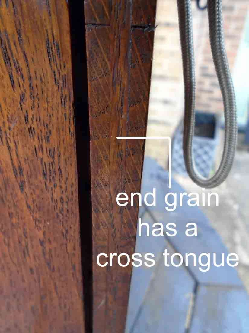

            I agree with Jason and Dave with the add on of removing the tongue, straightening then fitting a new tongue which has been cut on the curve to assist in keeping it straight.
            #712368
            Graham Meek
              @grahammeek88282
              From what I can see from the photograph the front is made up of individual board?
              If this is the case then the tongue is there to stop these boards parting. If I am right then the tongue is the item causing the problem. Removing it and replacing it with some new material should cure the problem.
              Regards
              Gray,
              #712382
                I’d tend to call it a spline rather than a toungue and it is unlikely to be of sufficient cross section to be holding the front boards flat or causing the bow. It would need a substantial “breadboard” edge to have enough stiffness to resist the cupping of the front
                #712383
                Dalboy
                  @dalboy
                  Not being able to see all the end grain properly which would give a better understanding of the construction, for example if each board is orientated in such a way that the end grain is running in the same direction on every board then cupping is going to happen. Each board should have the end grain alternating to counteract the problem, but to sort that out would mean taking the panel apart and starting again.
                  Looking at one board it seams as if that one at least should not cause a problem as it looks to be quarter sawn.
                  #712434
                  Martin King 2
                    @martinking2
                    Hi all,
                    thanks for the feedback.
                    the front appears to be 3 pieces all quarter sawn; inside looks like it only has one thin coat of finish, much more matte than the front.
                    the tongue (spline) is very thin indeed, whole part is under 1/2” thick.
                    i may take it off and apply VERY gentle reverse pressure for some time to see if it helps?
                    cheers, Martin
