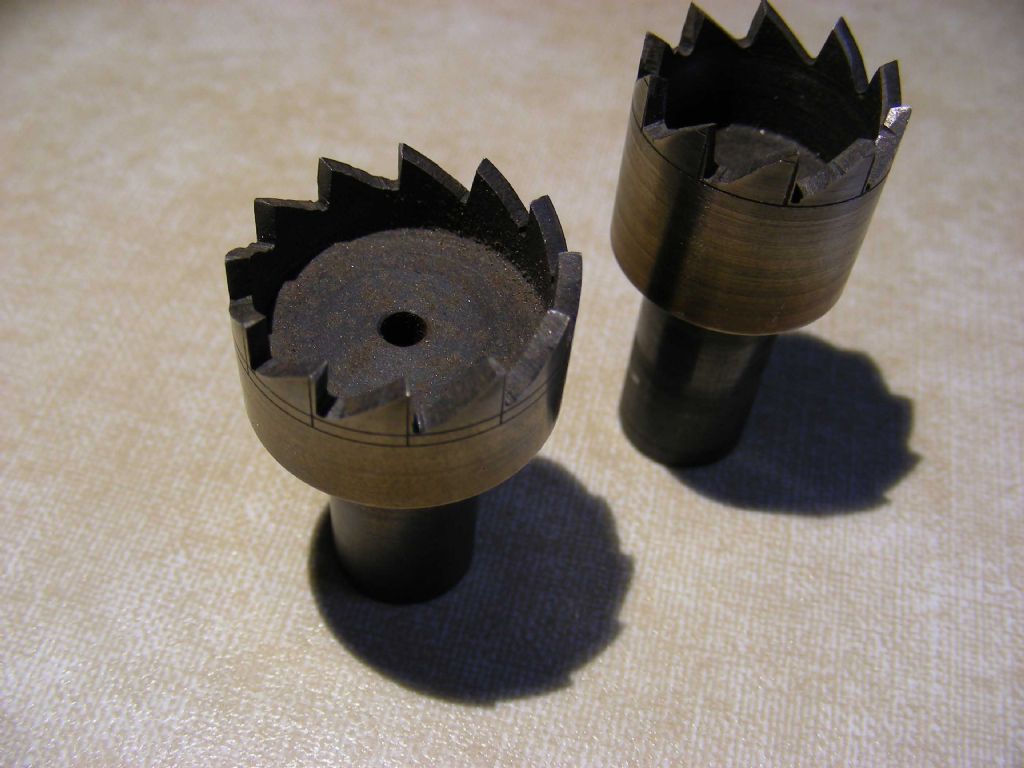

                    Unless the design has been changed this is well covered in the book.
                    I could post a photo of the cutters I made for the job if this would help.

                        Posted by ega on 01/06/2020 16:29:26:
                        I don't have the book, just the drawings!
                        Yes, pics of your cutters would be great.

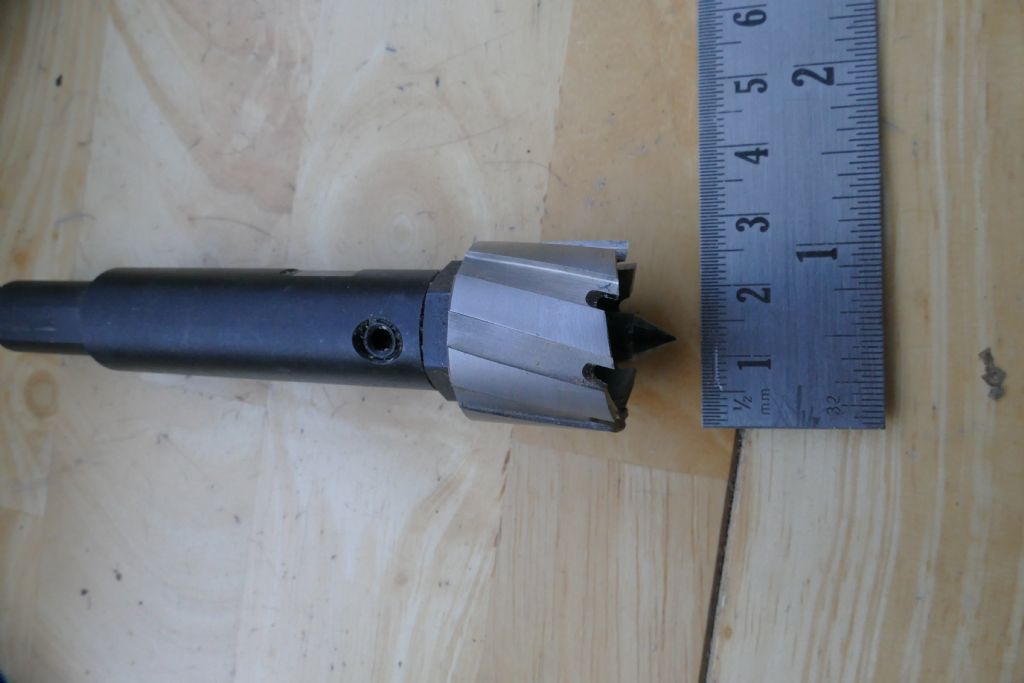

                          25mm Rotabroach mini cutter. 20.5mm internal diameter, depth of cut 6.3mm max. Could be ground to required dimensions if you had one. This is the sort of cutter Jason is suggesting, OD and bore not as Jason suggested wink

                                I see that the MK3 drawings are metric; DHC's design was, of course, imperial and he specified a (double-ended) cutter with one end 0.940" OD x 0.810 ID, the other 0.815" x 0.685"; I opted to make two cutters which seemed easier:
                                IIRC, I marked the teeth out in the lathe and filed them by hand with a neutral front rake. I think the through hole was to facilitate holding the tool for hardening and tempering.
