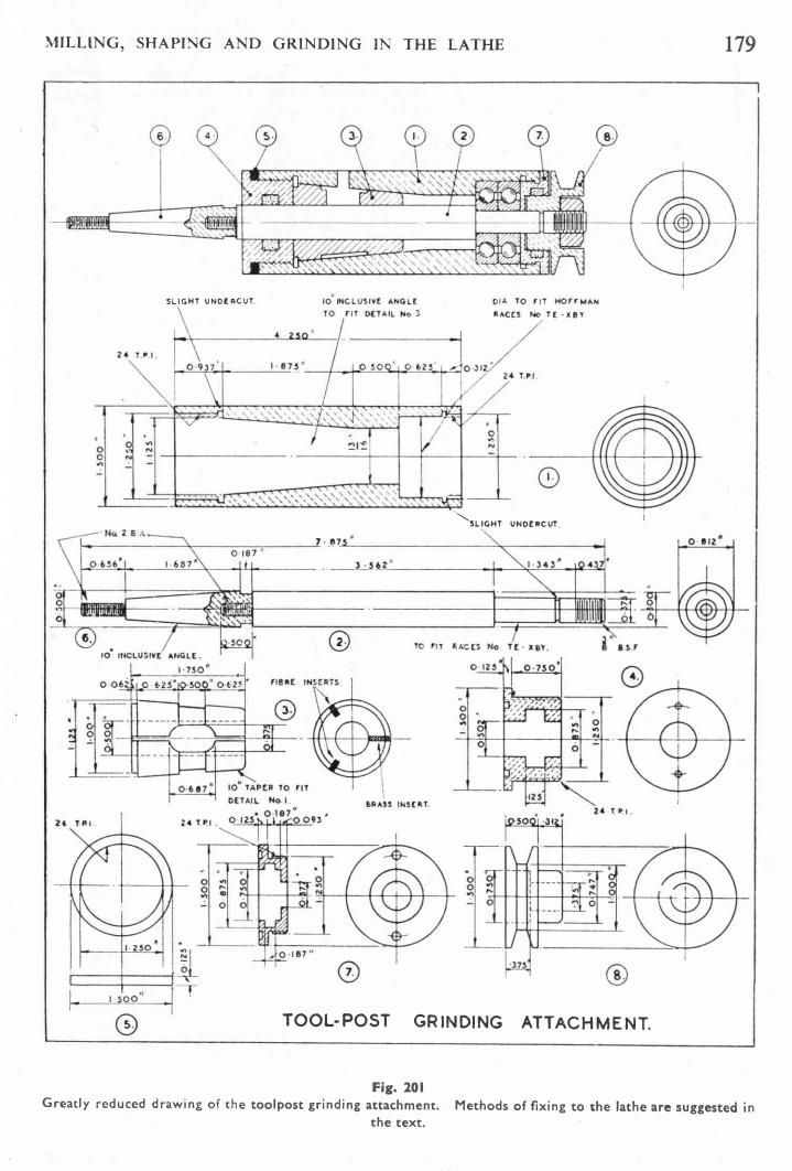

      Unfortunately Sparey's drawings seem to be straight out of the Jones & Shipman drawing office "Small Very High Speed Grinding Spindle". Two deep groove ball bearings at the pulley end to properly support it against long flat belt flap and similar effects despite the relatively large internal clearances needed when running really fast. The grinding wheel end is supported by a taper adjustable plain bearing 1 3/4 inches long with two active bearing surfaces 5/8" long. Similar designs found in old style bench precision lathes and the like. Highly polished glass hard bearing surfaces on both shaft and bearing. If properly set to the appropriate negligible clearances and supplied with the right oil such bearings will run very fast for a very long time working at effectively zero clearance. On a proper grinder asking for sub tenths cuts will get you sub tenths cuts if such bearings re used
      Sparey calls for matching 10° tapers on both bearing and housing. The housing taper is 1 3/4 inches long starting almost an inch in from the end. That inch being needed to fit the end cap part no 4. Creating those matching tapers is going to be very challenging on any typical Home Shop lathe, especially a Drummond or similar pre war breed. Even with the 1024's superb taper turning attachment not a walk in the park. Doing it by offsetting the topside looks to be a nightmare. Especially given that a high finish is needed and that the angles are close to those of self locking tapers. Jam up potential on test fit is very high! Glass hard running surfaces are mandatory on such bearings if clearances are to be appropriately close. If you can't arrange that there is no point in going to such trouble as a carefully made plain bearing will be as good.
      Having arranged the two tapers you still have to get the pulley end bearing bores dead concentric with the assembled taper bearing and shaft. No spiffy tenth thou indicators in the Home Shop then.
      Realistically, as drawn, I reckon it would have to be a "foreigner", "homer" or "government" job for a decent toolroom machinist able to pull in favours from other parts of the factory.

                      Neil has his pdf copy of the original article in Model Mechanic, but as this has aroused such interest I have scanned it again in jpeg format and created an album for it "Sparey Grinding Attachment".
                      This is now in my Albums for all to see.

                        Thanks to Robbo … I think we have the answer to that
                        See the note about Detail No. 8
                        #327005
                          Thanks Robbo,
                          The original text states "the pulley has to be nutted up very tightly as it clamps the whole ball-race assembly together. The bore should be a tight drive fit on to the end of thee shaft as no keyway and key are provided".
                          So the drawing is in error and the end cap must be bored 3/4 full right through.

                                Ah, thanks for the drawing Robbo. now all become clear. The bronze bearing is a bit like a Drummond headstock so not unreasonable for its time except for the cost of a big lump of the metal.
                                The drawing makes the error in the rear cap clear and I'm sure anyone actually trying to make it would quickly realise the problem and adjust the hole and make a spacer. At least it is an easy fix unlike some errors on loco frames that have got through to print.
                                As to boring the taper and fitting the bearing. Is it any more difficult than making a Morse taper?

                                  Posted by Bazyle on 13/11/2017 21:38:32:
                                  Yes lots harder due to the number of things that have to be kept concentric to very close limits if its all to spin freely :- bearing bore, two tapers, ball bearing housings and a taper mandrel for mounting the housing when doing the bearing bores. Try figuring out the job task sequence needed to avoid disturbing a set-up that will be needed later. Its like one of those unhitch the wire puzzles. Probably no taper turning attachment on the lathe and certainly no spiffy indicators at home worker friendly prices then to help. Maybe a Unique at best. Whilst a Unique is a remarkably good performer given its bent bit of tin construction the tenths thou accuracy needed to pick things up again is beyond its pay grade. One thou is different matter. Don't forget that the bearing taper in the housing starts nearly an inch in which really doesn't help.
                                  Detail reading shows that this article really needed a heavy dose of the editorial blue pencil as the design is completely inappropriate to both its target audience and the actual intended use. The second paragraph confirms that its basically a copy of a proper very high speed spindle design intended for up to 30,000 rpm. The complexity and difficulty of the taper adjustable plain bearing is quite unnecessary if, as suggested in the next to last paragraph, only 3,000 or so rpm is likely in practice. At such low speeds might as well use a simple plain parallel bearing scraped or lapped to fit. Scraping that lump of phosphor bronze to properly fit the shaft as suggested is going to be nigh on impossible for any ordinary guy in any home workshop. Frankly a simple shaft in a pair of Lucas magneto bearings run tight with oil feed arrangements would do as well and be much, much easier.
                                  That extension shaft on a 2BA thread doesn't seem a very happy concept. Especially as its suggested that a larger diameter external wheel could be fitted direct on the thread! Um. No mention of the size of wheel that should be used either. Suggesting that left or right hand threads should be chosen depending on which direction the wheel will rotate grates too. A left hand thread 2 BA tap would never have been cheap.
                                  Having had my knuckles rapped a time or six in the past for letting complexity induced by reaching for irrelevant and theoretical advantages I know just how easy it is to get locked into an unsuitable, but superficially elegant design. My experience is that mistake is always compounded by silly pre-schoolboy errors!

                                    So after all this, the answer to the question posed in the original post is – He didn’t.

                                      In his defence, there is a note at the bottom of my 2nd edition
                                      "Greatly reduced drawing of the toolpost grinding attachrnent Methods of fixing to the lathe are suggested in the text"
