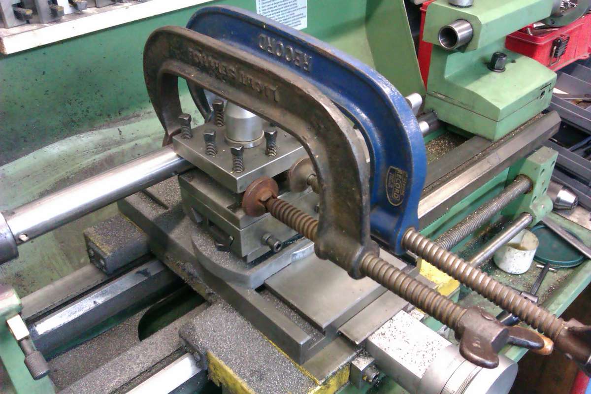

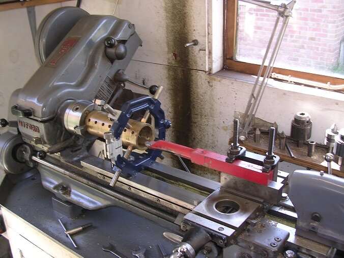

      How big a boring bar can you use on a Myford Super 7? 8mm shank maybe 12mm 1/2″ at a push?
      How about an inch? This one must be at least that if not bigger.
      https://hmvf.co.uk/topic/314-ww1-dennis-truck-find/page/80/
      Fo scale the work piece is a 2 3/16″ bore wheel bearing for a first world war truck.

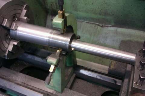

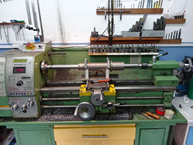

        As good example for Dave as to why someone may want to use larger than 12mm tooling on a small lathe.
        Not having a Myford I can’t answer what is the biggest but on the 280 I have used upto 28mm dia bars, only seem to have the 25mm one in shot.
        IMAG2349
        IMAG2350
        I do have a bigger between ctrs bar @ 35mm

            Dave that is why my first image shows a tool held using a toolpost. I’ve used a similar clamping arrangement with the Dickson QCTP in the past when I did not have a 4-way for the previous lathe.
            You asked why people would want to use larger than 12mm
