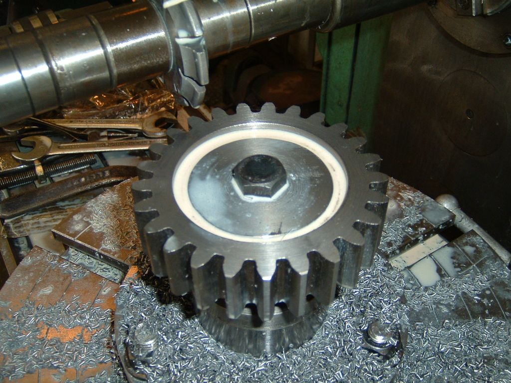

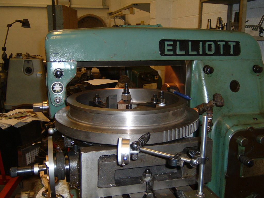

              Here are a few pictures to show you what I'm doing,
              These gears are for a 6" Burrell traction engine, the large one in the pictures is 19"diameter, and fills the capacity of the Elliott U2 mill,
              The largest gear I've got to cut is 21" diameter and weighs at least 200 lbs (100 kg) , and won't fit in the mill,
              I've got a larger TOS FA3A mill that will take 250 kg on the table, but I still need the longer arbor, so the gear blank can fit in the mill without touching the main casting or the outer support bracket.
              Perhaps someone might have another way round my problem ?
              Richard.

                  I think making my own arbor is probably my best option at the moment,
                  The TOS mill has got a 40 INT spindle taper, and I have adaptors to convert this down to 3 and 4 morse, so I could make a new arbor with a morse taper and drawbolt thread in the end, and screwcut the other end for the nut, I could make it as long as required.
