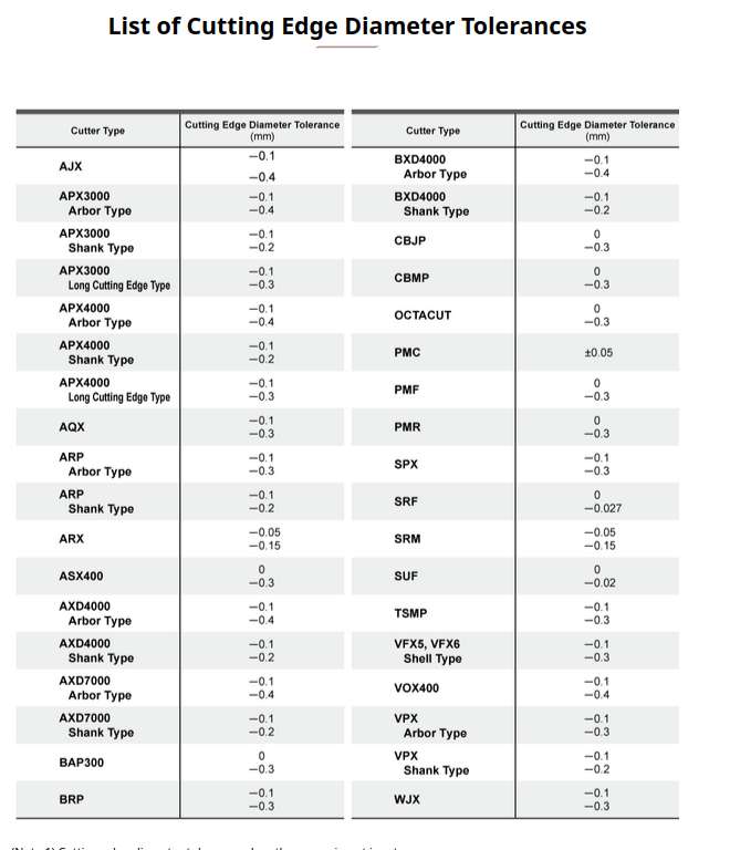

                                                      Had a quick look for manufacturing tolerances on cutters and found this:
                                                      cutterDiameterTolerances
                                                      The numbers suggest milling cutters aren’t precisely made, and could be much worse than Mick’s 0.001″.  I guess because the accuracy of the cut is determined by measuring on the job, not by assuming the cutter and machine are both in perfect condition.   They never are!
                                                      Interestingly, the off-the-shelf tolerances met by most CNC shops are quite poor – about ±0.005″.   CNC can do considerably better, but it costs more.  Same is true of traditional methods – accuracy and precision are expensive.  Therefore professional designers put considerable effort into avoiding the need for high accuracy, and maybe Model Engineers should do the same.   Parts should be no better than they need to be!
