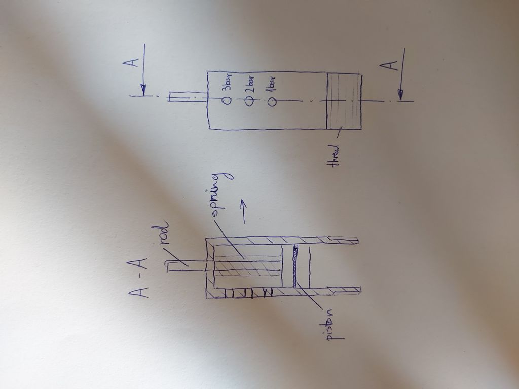

        Hello,
        Im building small steam engine on my lathe and I have come to a point where i need manometer on my boiler.
        Im looking for ideas how to build it.
        My own first idea was making small cilinder with a piston that has piston rod spring loaded. Then i would make vertical dial on cilinder, calculate spring elastic energy and calculate distance for each bar then i drill small hole on proper calculated distance for each bar. (max3). Sorry if my english is bad, Im not from UK,
        Any other ideas appreciated.

                        20230810_135135.jpgI do apologize for misunderstanding, in my country we call pressure gauge manometer. Im attaching my sketch of the idea; also the distance between holes must be correct otherwise becouse of the piston the pressure in boiler will drop, so i will have to pick the right spring.
                        Martin from Slovenia

                          Your idea will work to an extent, but friction in the seal will cause a lot of hysteresis, so when pressure is rising it will read low, and when it's falling it will read high. Because of stick slip you might find it changes in jerks. If you could find a metal bellows it would be better, but a difficult search
                          Edited By duncan webster on 10/08/2023 14:29:13

                                        I'm a bit puzzled by the small holes in the side of the cylinder in the sketch. They make the device look more like a simple pressure-regulator.
                                        I can understand a piston-type gauge working by graduations on the rod protruding from the top though.
                                        However, it is normal practice to give the gauge or sensor some protection from the hot steam by a U-bend in the tube from boiler to gauge. Often called a "syphon" though it is not really a syphon, it becomes partly filled with water so the gauge feels only air at the boiler pressure.

                                          Maybe i should remove O-Ring on piston and put inside cilinder Φ6mm transparent pneumatic tube and this would seal piston from leaking and the piston position on holes would still be clearly seen becouse of transparent pneumatic tube.

                                            You could make a gauge like that, with a scale along the side of the tube, but you'd certainly need protect the tube from the heat of the boiler. Or use boiler gauge-glass tube.

                                              I can make U-tube bend from copper like you said, maybe I should check tables for different types of plasic and their temperature points to see at what temperature range it softens. Also is this gauge-glass tube purchasable, i have never seen it, maybe i could cut glass test tube.

                                                Bear in mind you need know the boiler temperature at working-pressure, and it will be above 100ºC.
                                                Don't use a test-tube. They are very thin-walled and very unlikely to be strong enough to use as you suggest. Gauge-glass tube walls are about 2 thick even in model sizes, and of much smaller diameter than a test-tube..
