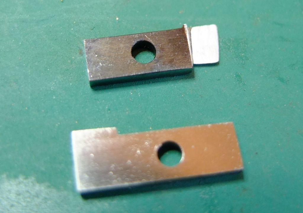

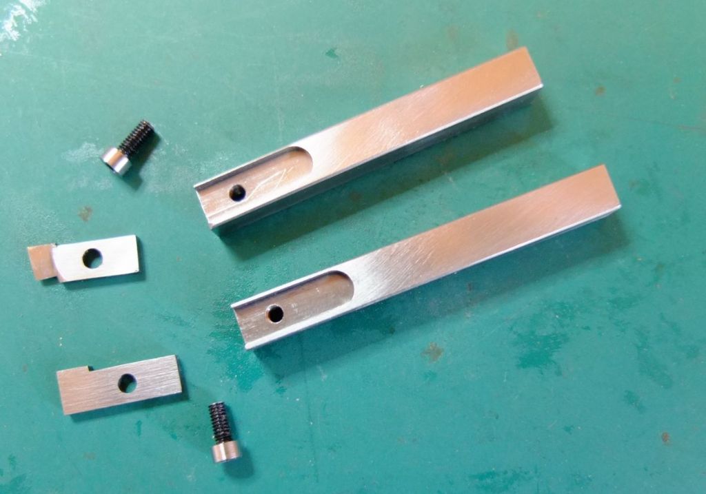

      Now I'm sure that this not a new or original idea but I'd thought I'd share it anyway.
      I need to cut some 0.5mm wide grooves around 2mm deep in 1/2" brass bar. I don't have access to a grinder and the only insert system i can find for that size is the "Mini-Thin" from MSC at around £70 for a holder and £18 each for the inserts.
      I had some small scrap pieces of 1/16" Ground Flat Stock and some mild steel 1/4" square bar so made these-

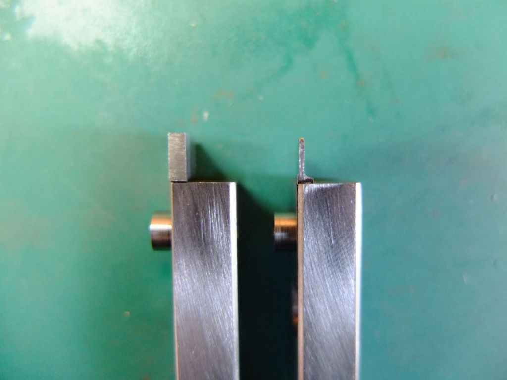

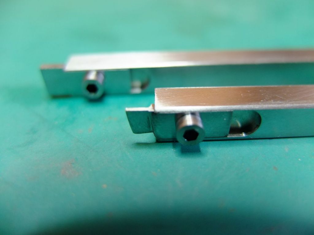

      The pictures are self explanatory. The top "insert" has been filed to shape, hardened, tempered and sharpened with a diamond lap. The bottom insert is a soft blank.

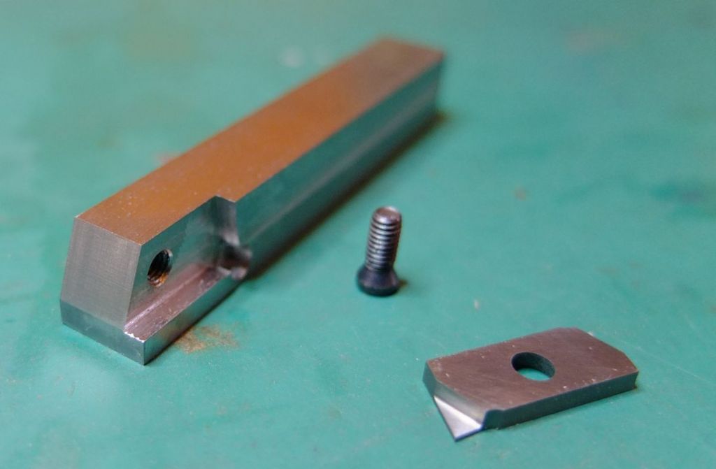

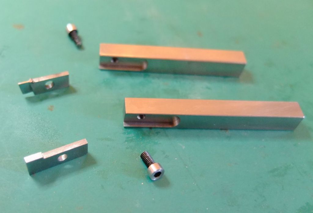

      Some more photos-

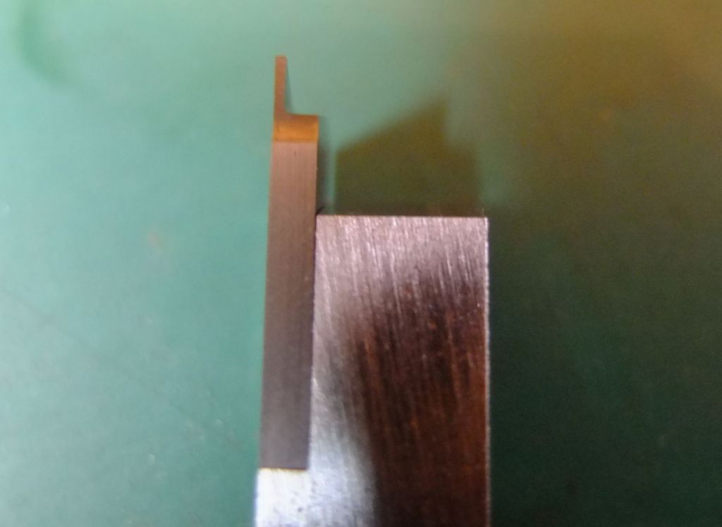

      This hasn't been a success so far. After cutting two good grooves things got a bit noisy and warm. The blade has lost it's temper now and will need rehardening. I will also have to pay a bit more attention when it comes to sharpening.
      I didn't put any rake on this as it was for brass but I've noticed that a lot of parting/grooving systems seem to have a negative rake. Is there a reason for this?
      Any hints, tips or questions are more than welcome.
      Cheers, Steve
      Edited By Steve Crow on 27/08/2019 14:28:47
      Edited By Steve Crow on 27/08/2019 14:29:27
      Edited By Steve Crow on 27/08/2019 14:31:12
      Edited By Steve Crow on 27/08/2019 14:32:42
      Edited By Steve Crow on 27/08/2019 14:33:15
      Edited By Steve Crow on 27/08/2019 14:33:31

            If the ground flat stock is gauge plate, it is the equivalent of silver steel. I would try hardening it, polishing it and then heating it very slowly from the other end until the tip area is light straw, before quenching. After tempering, finish hone with a fine diamond lap. If the dimensions allow, grind the end so that the plan view is biased to the right, yours is to the left, which is not so well supported by the groove in the holder. So far, I haven't needed anything narrower than 1.6mm, the width of my smallest carbide inserts for 26mm blades. I'm not sure of the best profile for brass, it is a matter of trial and error.
            #426204
            Steve Crow
              @stevecrow46066
              I tempered it in a domestic oven to around 190 – 200C then stuck the tip in a potato and re-tempered the shank. This was from Tubal Cains heat treatment book.
              The cutting part is on the right so I can get as close as possible to the chuck – even a couple of mm helps.

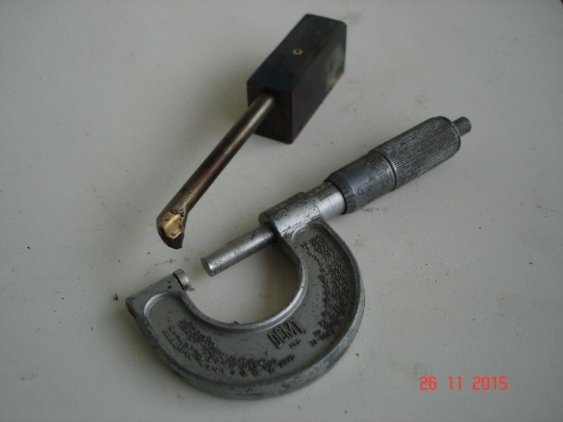

                  Sorry, I don't understand when you say the cutting part is to the right, (picture 5). As for chuck clearance, what about the SHCS sticking out? I also cannot understand why the steel should go blunt so quickly in brass. Have you tried a file on it after tempering, if the steel is low carbon mild steel, it will still be soft after any heat treatment.
                  Edited By old mart on 27/08/2019 17:36:18
                  #426229
                  Steve Crow
                    @stevecrow46066
                    Posted by old mart on 27/08/2019 17:34:40:
                    Sorry, my mistake, I meant the left.
                    The screw on the left was unavoidable without a lot of messing about. Anyway, with my tiny Sherline 3 jaw it actually gives enough clearance. It's fine with collets too.
                    The steel is gauge plate. I've used the same piece to make cutting tools before. I always test with a file.
                    As for the bluntness, my fault. Not sharpened correctly which caused it to rub. I'd forgot to put back the tailstock centre, The work shifted slightly in the chuck, this cause a lot of heat and led to loss of temper.

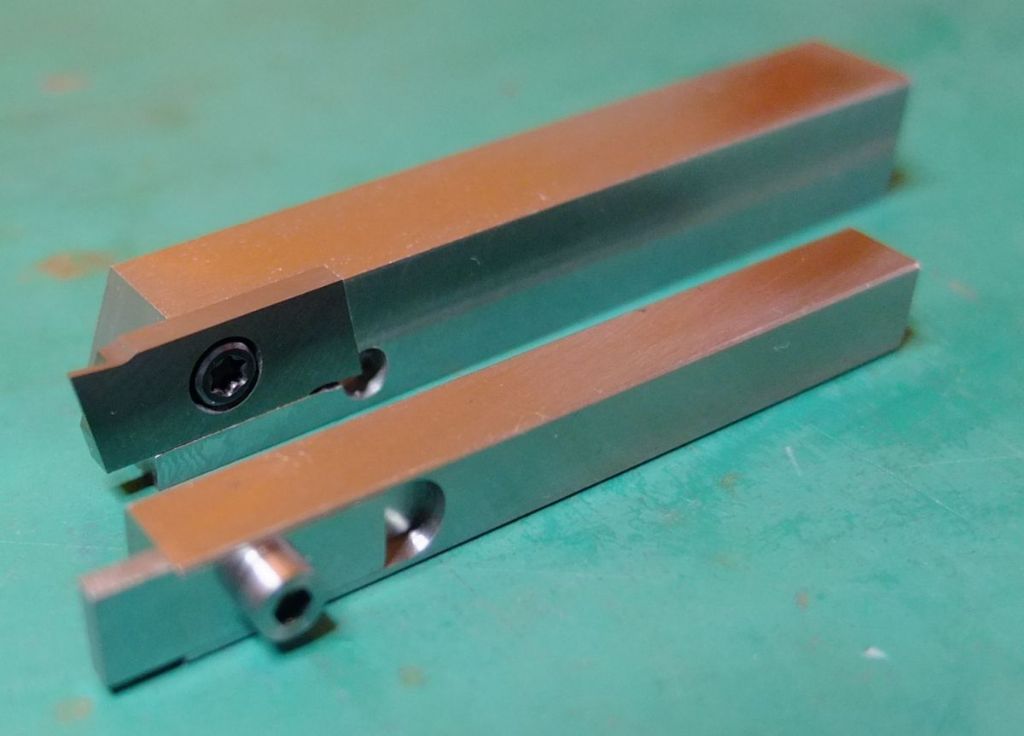

                                  Steve Crow
                                    @stevecrow46066
                                    A quick update.
                                    I didn't have a huge amount of success with my home made inserts and for an ongoing project I need to cut some consistent size grooves in a variety of materials including EN16T and silver steel. Also I wouldn't mind being able to part pivot steel.
                                    I don't like to spend more time sharpening than turning so I cheated and bought a "Mini-Thin" 0.5mm insert and the torx screw in case it was an odd size (it was).
                                    Once I'd recovered from the cost, I knocked up a toolholder from 3/8" square bar.
                                    I've not tried it out yet but if I'm happy with it I might get the threading insert. Should be good for making screws from pivot wire.

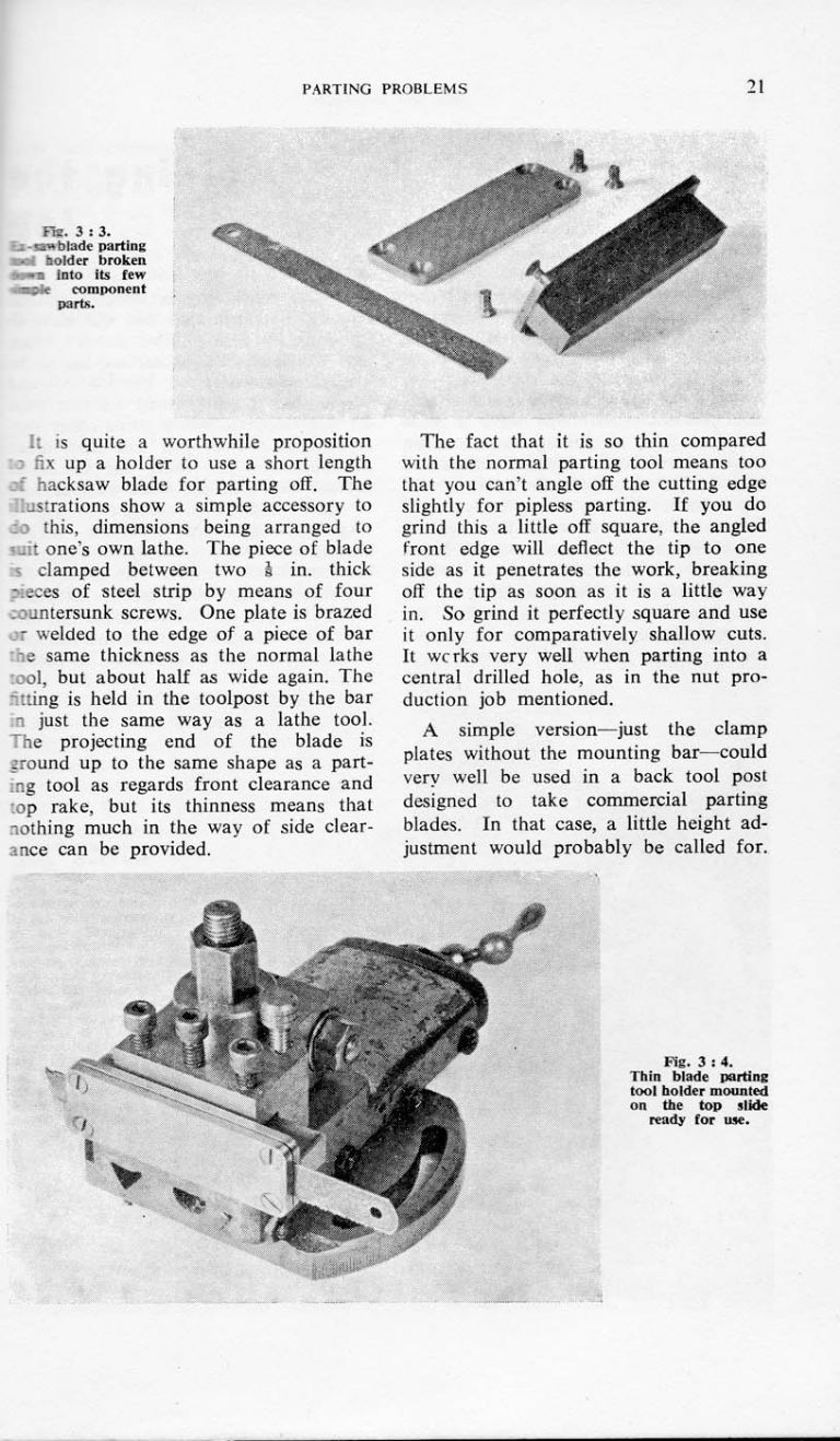

                                        This is Len Mason's take on a small parting and grooving tool in "Using The Small Lathe":
                                        I've just used mine to cut grooves for 3mm E clips
                                        You do need to make sure that the hacksaw blades are solid HSS not Flex Bi-metal.

                                          Ah yes … I remember it well, Rod
                                          Unfortunately a little wide [as is] for Steve's 0.5mm grooves, is it not ?
                                          … Which is more-or-less where we came in.

                                            One point about using hacksaw blades for parting-tools – as I found when I tried it some time ago – there is no relief on the section, so unless you grind the flanks appropriately, they soon start to bind as the cut deepens. They'd be fine for circlip or O-ring grooves or parting thin-walled tube though. One solution might be to leave the teeth on to shave the sides of the kerf by the tooth-set width – though I have not tried this, and it may well also produce a rough finish.
                                            Reading Len Mason's article quoted above, he talks of grinding a parting-tool end at an angle to obviate that usual pip. I'd always done that until only quite recently learning (on this forum??) that doing so is very likely to cause the tool and swarf to jam in the cut, because the chip is now wider than the blade thickness.
                                            If you examine an insert-type parting-tool you see it has a square-across end, and a shallow V-groove that both gives side rake and tends to turn the chips inwards, so presumably slightly narrower than the kerf, and often breaks them up.
                                            #428621

                                                I wonder if the first attempt's problems were as I found when trying to use a piece of old saw-blade?
                                                The original gauge-plate blades, and hack-saw blades, are of rectangular section so the tool does not have to enter the work-piece very far for it to start binding in the groove.
                                                Having a screw-head projecting on the chuck side of the tool-holder may not matter for the particular lathe and use; but it's worth examining a commercial parting-tool holder of this general pattern.
                                                The clamp-screw is basically a short bolt with a shallow head, inserted from the tool side and nutted on the other, open side. The blade is thus held by a flange that is itself located to prevent rotation, by having a small flat acting against the ledge on the holder body.
