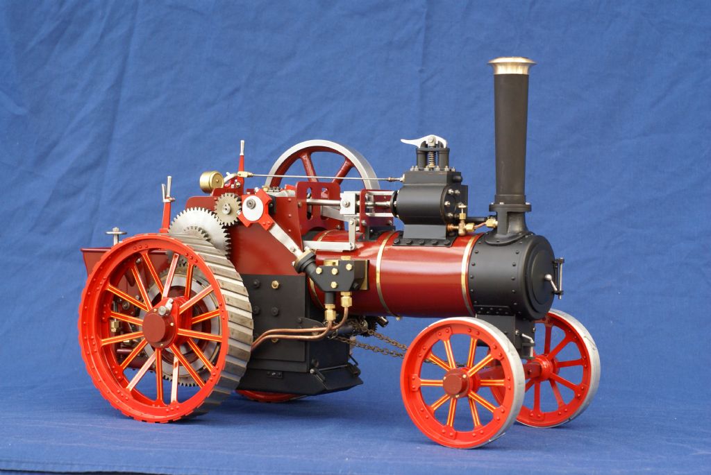

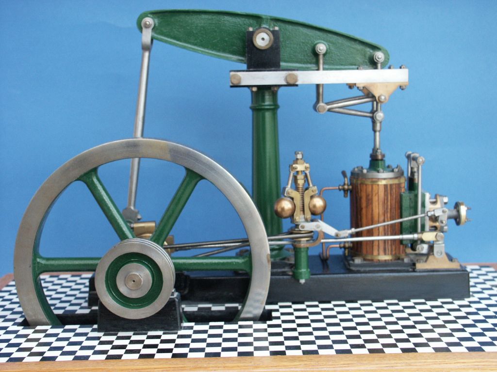

                      Maybe a case of theory over practice, I seemed to manage quite happily in my early days with a drill chuck on the Unimat 3 milling attachment and also the odd cutter in a 3 jaw when I made my first models, these two for example don't look too shabby and I don't recall having cutters move.
                      Stuart Beam
                      1 Minnie
                      Still do it occasionally now as a drill chuck can get me into tighter spaces than my collet chucks can.
                      I would not say it is best practice but with care and knowing what could happen its OK for me.
                      Edited By JasonB on 04/10/2016 20:40:09

                                      A bit unrelated, but very nice checkering on the stuart beam, how did you do that, if you mind me asking Jason?

                                        Floor tiles part way down this page
