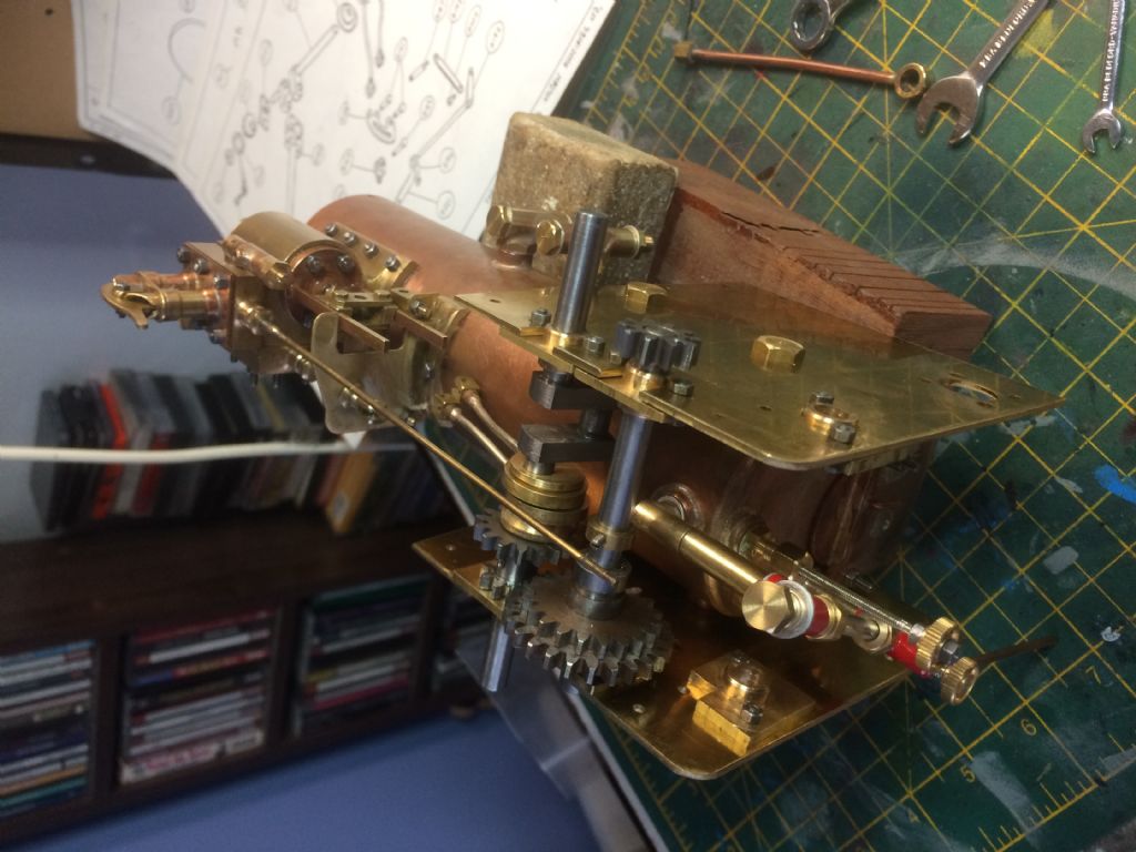

      Hi,
      This 40 yr old kit is coming along nicely…

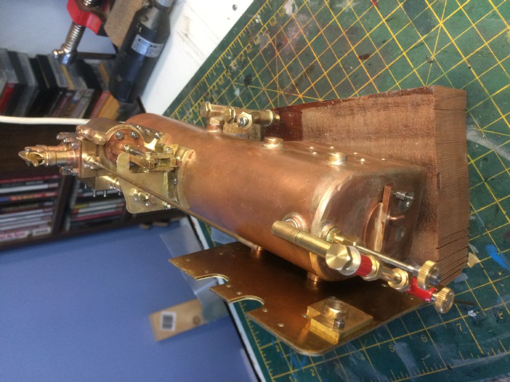

            #515263
            Terry Chapman 2
              @terrychapman2
              Posted by br on 16/12/2020 16:26:33:
              Nice start Slash. Just keep the pics coming.
              br
              Thats me done for xmas!!

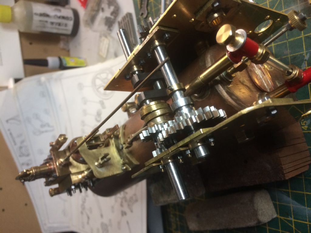

                  horn plates etc fitted but having trouble getting them to turn freely.All until i tighten horn plate mounting bolts then they tighten up.img_0654.jpg

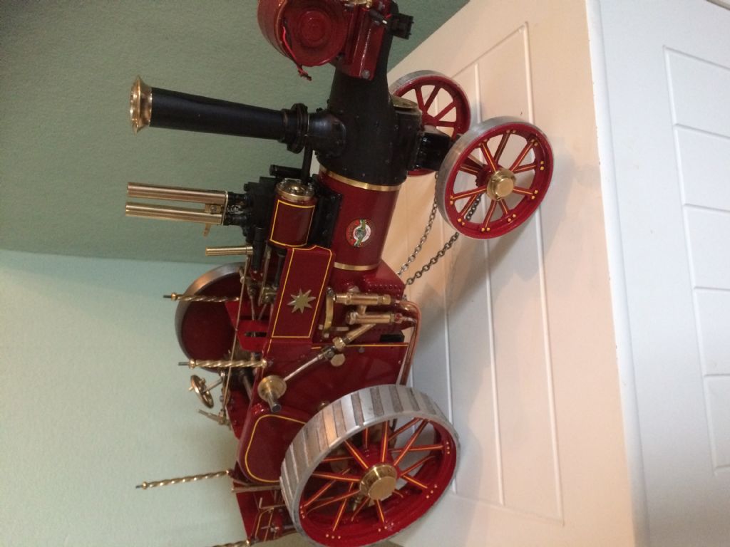

                          #537970
                          Terry Chapman 2
                            @terrychapman2
                            Posted by br on 24/12/2020 14:13:42:
                            Thanks for posting Terry
                            All looking good.
                            Happy Xmas to you
                            br
