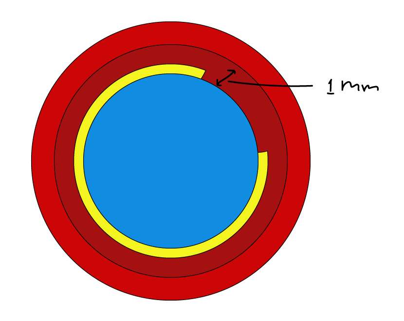

      I picked up a hobbymat 1985 in excellent condition, but I need to get in to the leadscrew’s female drive coupling to work out some gunk that is giving the carriage some sticktion and inconsistent motion.
      There is a spring steel clip deep inside, there is maybe 1mm gap, and it’s a few mm deep. There are no eyelets, not that any c-clip pliers could ever fit in. The only thing I’ve been able to get at it with is a scalpel blade, but it just continues to lift a tiny amount and snap back in to place. It’s impossible to take a picture of it.

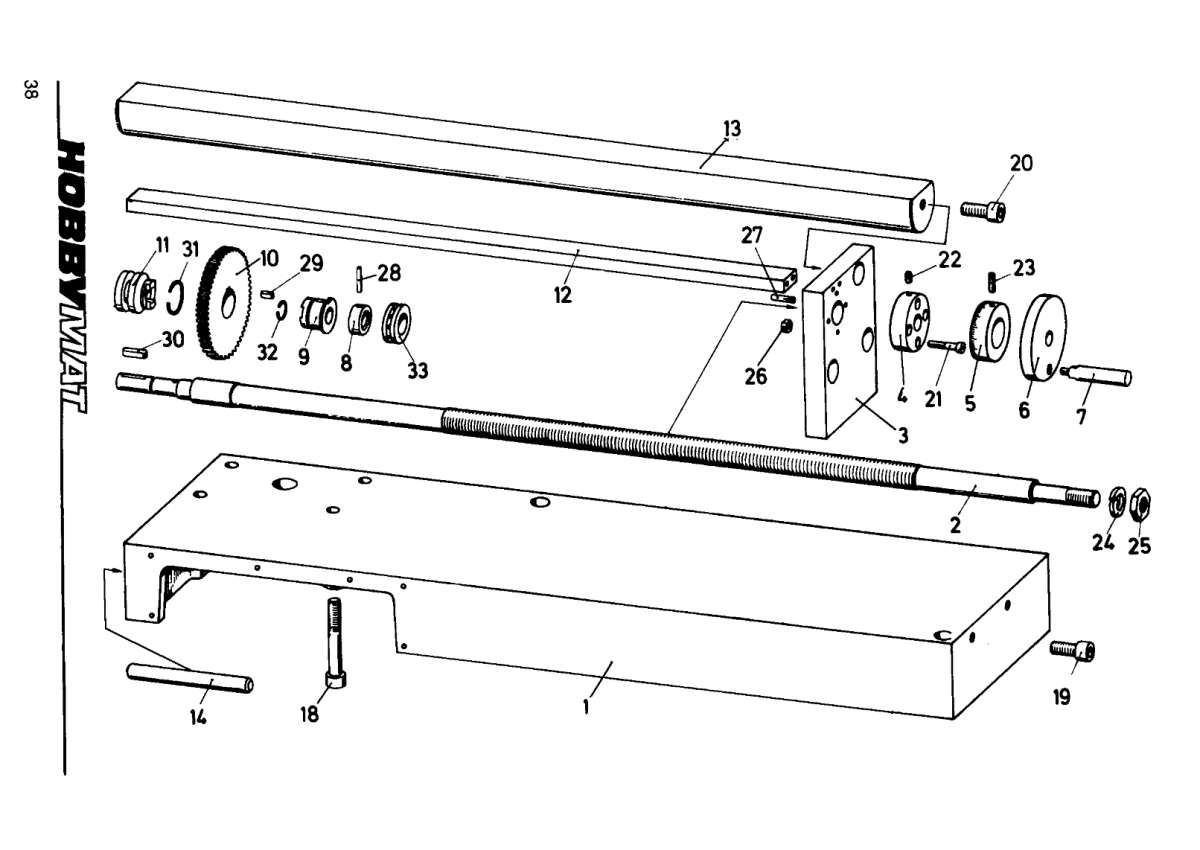

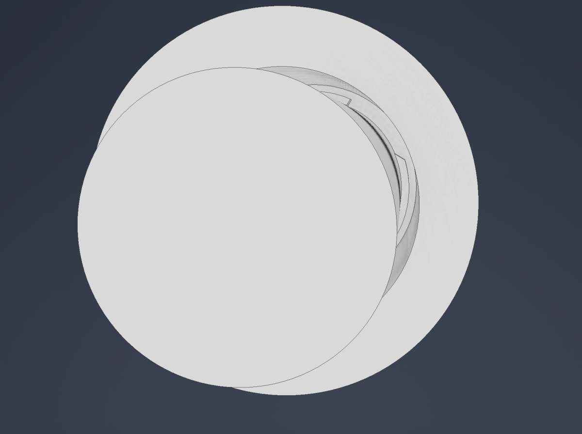

      I’ve given a model, drawing, and manual drawing (the part is 9 on the manual’s illustration).
      2d3dcoupling

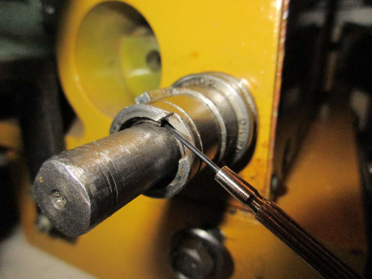

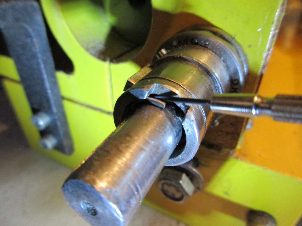

            Hi theelous3, it’s a bit of a fiddley job, but the best way I’ve found is to get the ends of the clip, lined up with one of the dog clutch gaps, and then using a small watchmakers type of screwdriver, lift out one end and then work it out by turning the leadscrew as you go, but you may need two screwdrivers.
            IMG_0004
            IMG_0005 (1024x768)

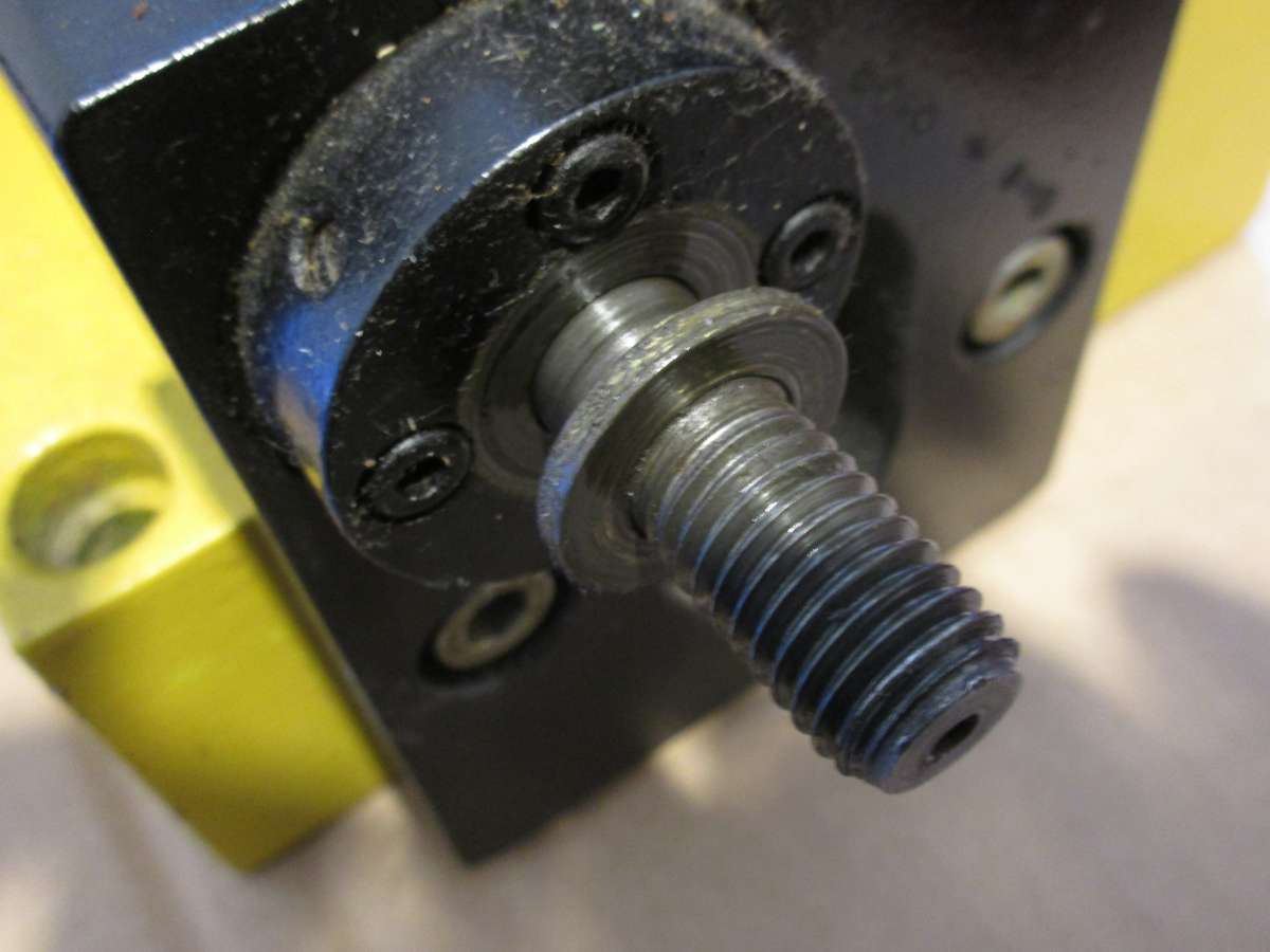

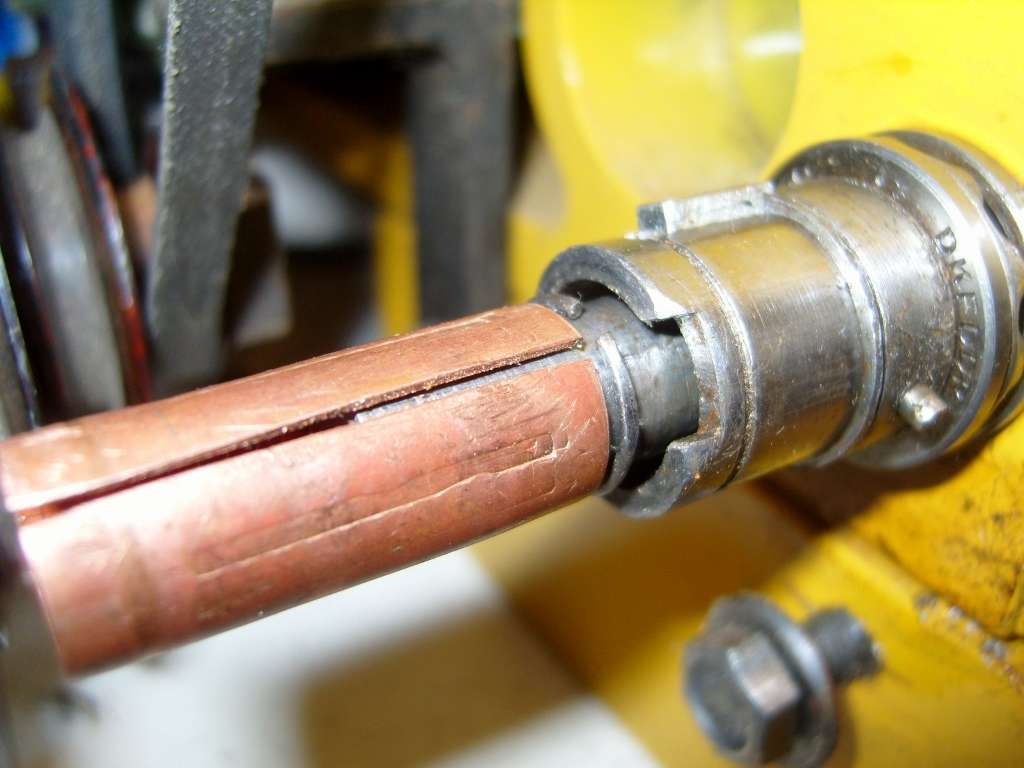

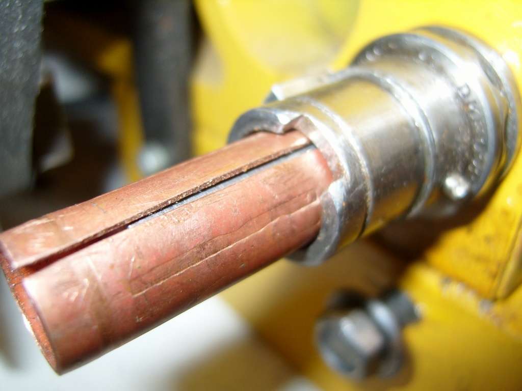

            Getting it back in is easy, using a bit of 15mm copper tube, but the tube will need to have a cut along its length.
            S1030814 (1024x768)
            S1030815 (1024x768)
            Regards Nick.

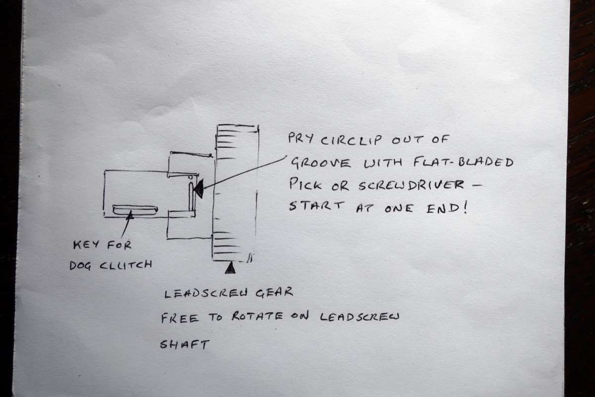

              Yes, that exactly.
              IMG_2452

                @diogenes @nicholasfarr14254 thank you very much. Sometimes knowing something is possible is all that’s required to get it done. I removed the clip with scalpels and an inverted broken key extractor lockpick.
                Strangely however, the coupling remains retained. It slides a small amount, and seems to come against a shoulder, presumably the groove on the leadscrew for the retaining clip ring. I’m wondering if there is a nack, actual method, or I should attempt to force it – perhaps there is a small burr I can shear – but that would be surprising considering someone put it on there in the first place.
                My removal method for prosterity’s sake:
                Scalpel A to lift the end away from the shaft and create a gap through which scalpel B could slide, between the shaft and the clip. Then keeping B in place, removing A and sliding an inverted key extractor pick with as much angle as possible through the dog crenelation under the ring. Remove B. Pulling the ring away as far as possible, reaching and driving the leadscrew as described by nicholas above.

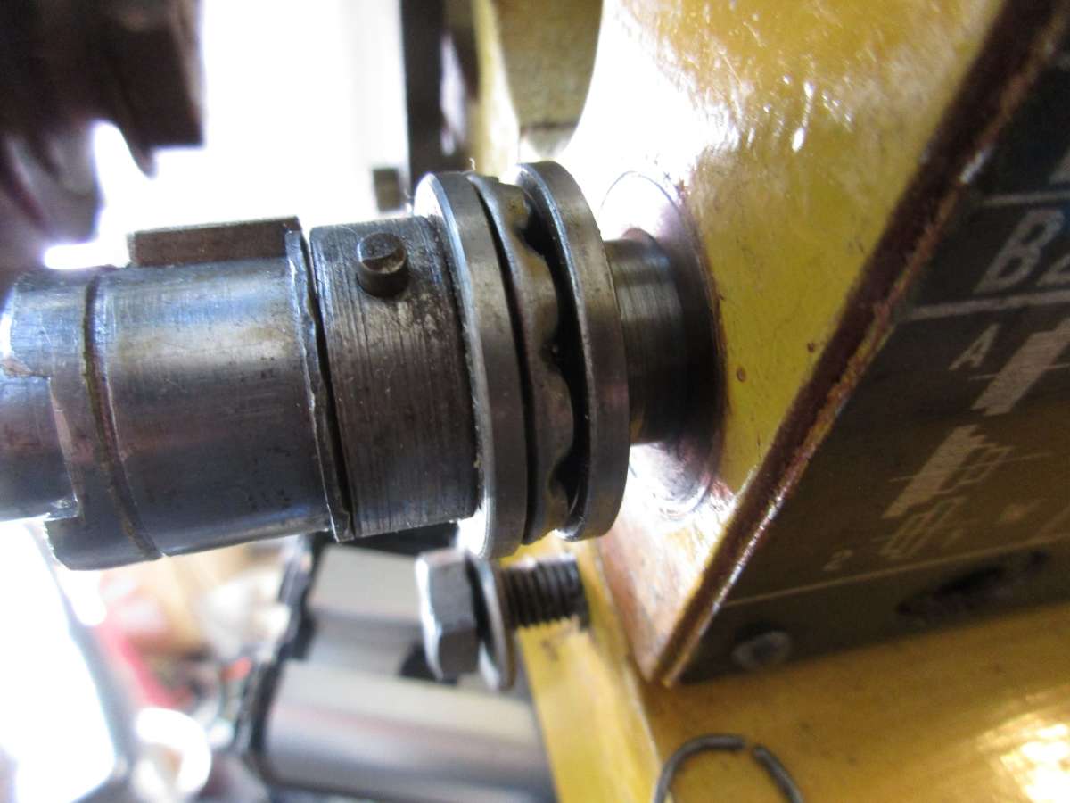

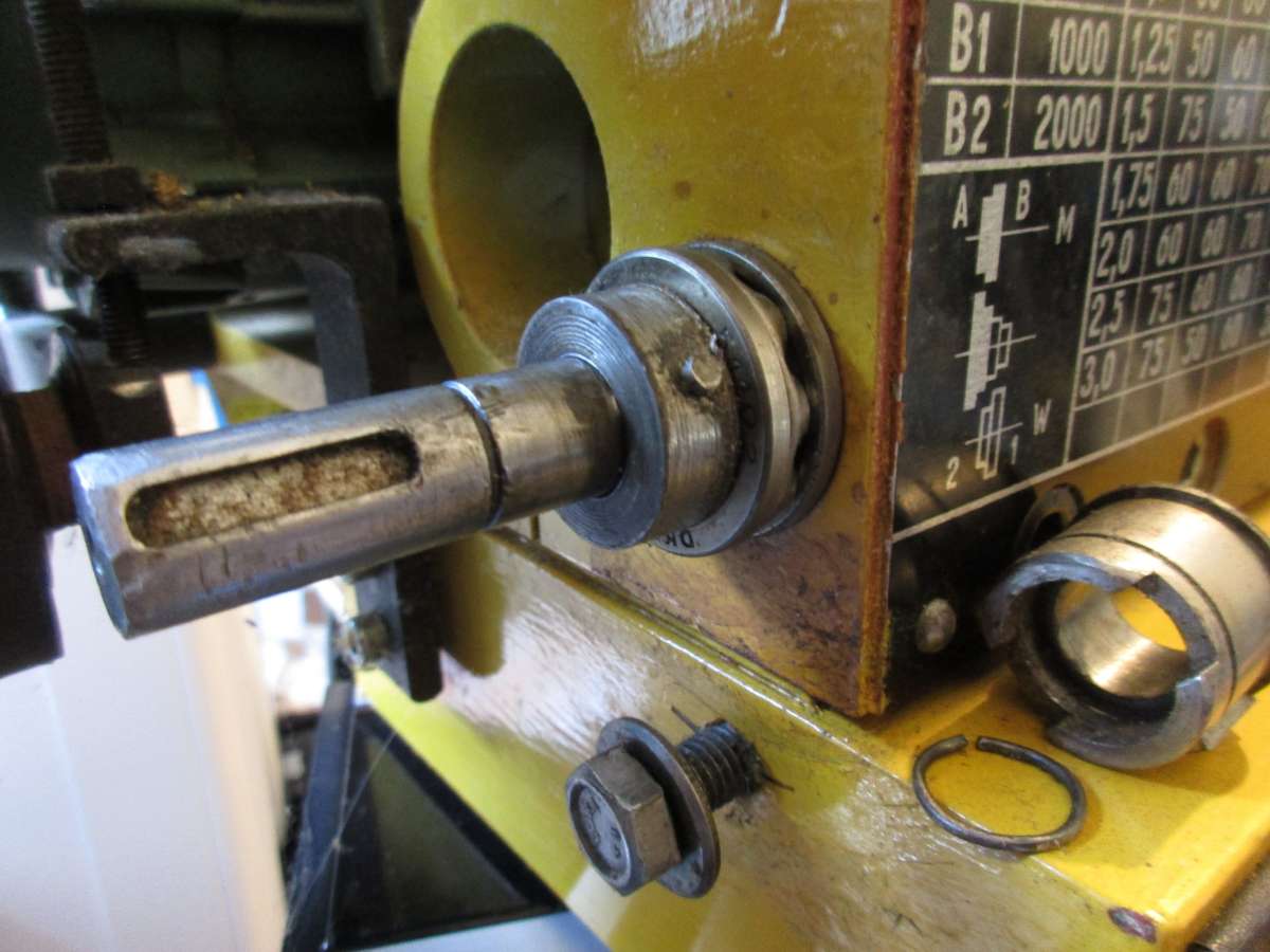

                          Hi theeolus3,the first photo below, shows what it looks like with both parts of the dog clutch are removed.
                          Hobby#1
                          The only thing that controls the leadscrew end float is a washer at the handwheel end, and the one on mine is 2.41mm thick.
                          hobby#2
                          I would think the only reasons your piece won’t come off, is either a burr on the ring groove, or some gulling between that piece and the leadscrew. The leadscrew will only come out of the lathe at the hand wheel end, but with the hand wheel removed, the leadscrew should be able to be pushed the other way, giving a gap of about 5mm between the thrust bearing and the lathe headstock.
                          hobby#3
                          Removing the taper pin through the collar, may let you get a couple of pry bars or a plate for a puller behind the thrust bearing and the headstock.
