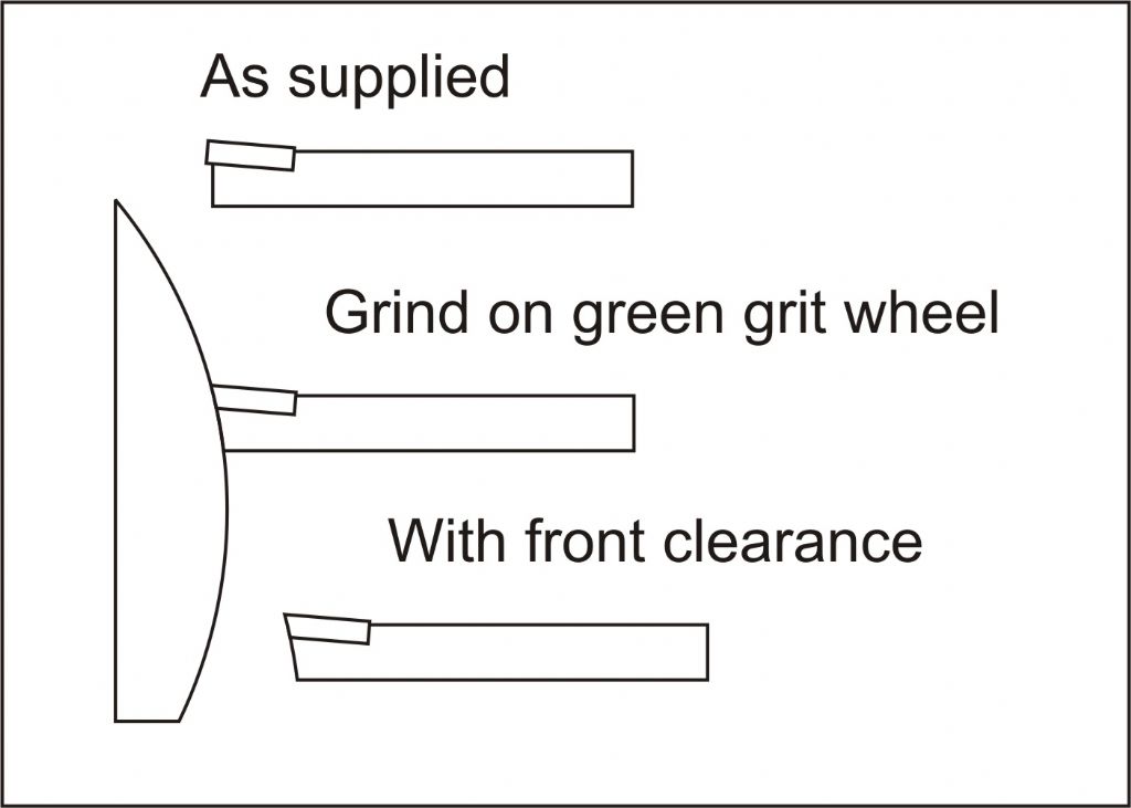

                        With those brazed carbide tools the inserts are often left square at the front, so if they have top rake they won't work until you grind some clearance on the front with a green grit wheel.
                        I'm convinced this is the main reason why beginners struggle with them so much. No-one ever sells them as blanks in need of finish grinding but that's what most of the cheap sets are.
