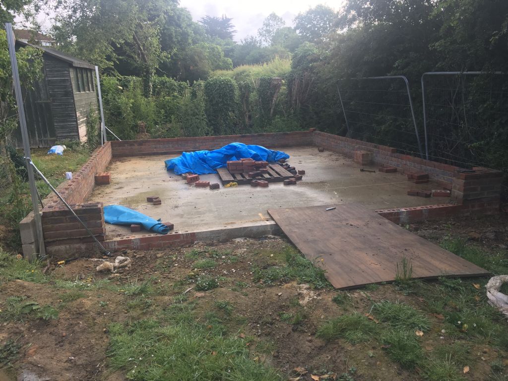

                  I have signed up for Traction Talk, it says that I'm a member and I've clicked on the authentication link in my email. However although it says I'm ;logged in as a member it wont let me view any threads, it says I don't have authorisation to view the posts and that I am in a moderation queue. I've emailed the admin but not had a response yet.
                  I chose the Burrell GMT as although it is a 6" scale it is still only 7' long and 4' high. My workshop will be 6.5m long and 5.5m wide so should be big enough to take al the crud that's in my existing double garage including my two motorbikes.
                  As far as machinery is concerned, having looked at the plans, I need a lathe that has at least a 9" swing and a 16" centre gap, unless I've missed something. The largest item the mill needs to handle is the cylinder block casting. So I have 3 options in this respect:
                  a) buy a second hand mill that is large enough to handle the cylinder block
                  b) take up an evening class for machining and use their equipment for the larger stuff
                  c) get someone else to do the machining on the cylinder block.
                  Picture of the start of the workshop. nothing very exciting really.

                                                  So, as promised. Photos of workshop. The mill is now in place being re-assembled. Putting the head back on is interesting.
