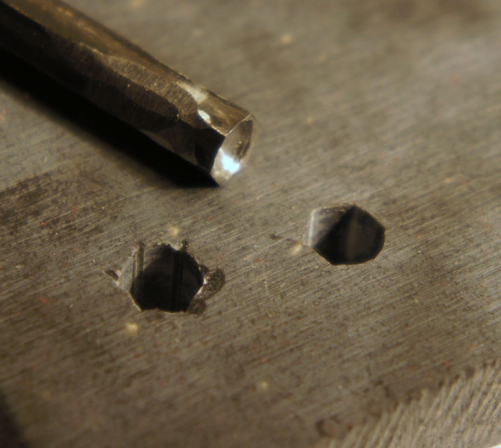

                Another sacrificial allen key later and we have this
                Just hollowed out the end , stoned off the burrs and shoved it through from the other side to give the left hole, some breakout on exit and tight to remove.
                2nd hole was done with some clearance very roughly ground behind the edge a lot easier to drive and remove, was slightly off on the pilot hole so edges nearest are a bit round but others fully cut. Thats a 6mm key into a 6mm hole in Corian which is not unlike the properties of Polyester rod.
                If doing it this way do as I said above but a 3/16" hole will do down the middle. Either hold the rod in a collet or bore a block of metal to hold it so there is no risk of bursting

                Nishka
                  @nishka
                  Thanks Jason, that looks just the job.
                  The bored out block of metal would also serve to centre the hex broach tool, as well as prevent bursting of the rod.
                  Brill, now all I need to do is order the material and start making holes!smiley

                      Could an Allen key shaft not be drilled slightly deeper than shown with something like a carbide centre drill so that the entire hexagonal edge was sharp?

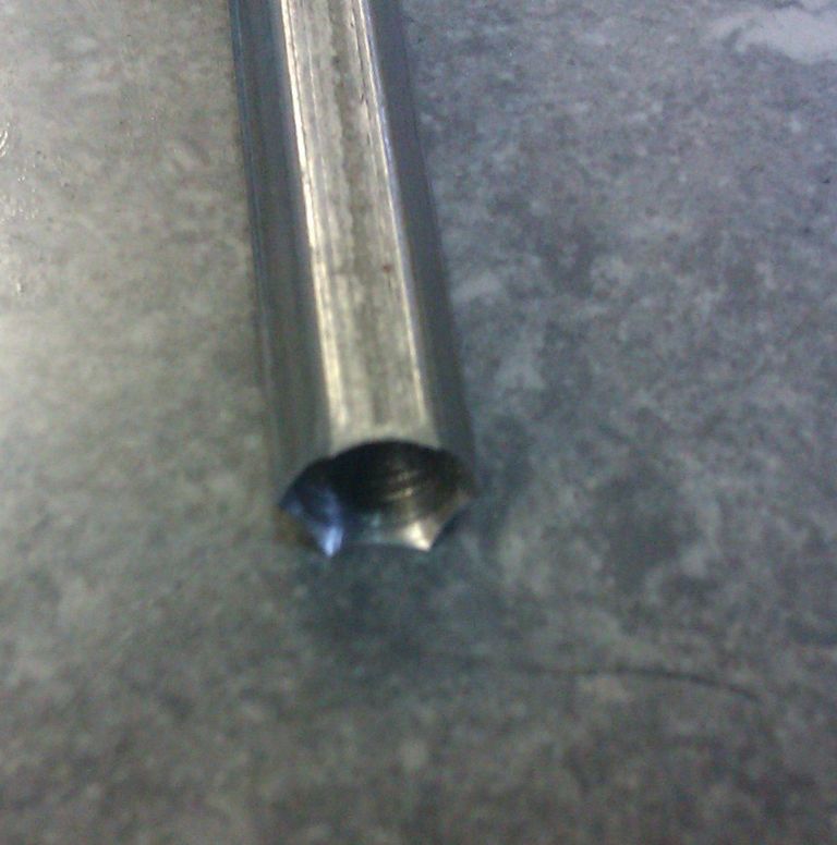

                        That was my intension until the carbide slotting drill snappedcrying only used the key as it was a test, milling some silver steel to a hex would be better as I originally suggested with a deep hole and CSK end like this which I tried in mild steel first but it was too soft
