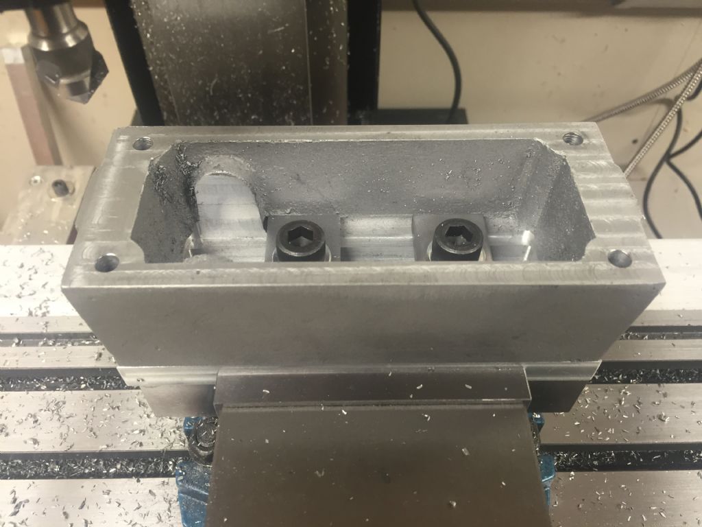

        Hello all,
        I'm new to the forum, but have been watching for quite a while whilst deciding if to take the plunge and tool up for a while.
        What caught my interest was the 'clickspring' series of videos on YouTube, and whilst I'm not really interested in clocks much, I found the making of your own tools fascinating.
        Having decided to have a go, I've bought myself a mill first. One of the reasons is because this is the bit of kit that I've never used (used a lathe at school back in the 80s) the other reason is because I want to get some practice with it, before purchasing a lathe.
        Having purchased the mill, and a DRO kit, the first project was a set of brackets for the DRO. I've done the X and Y axis, but I got held up over Christmas waiting for some m4 X 60 screws for the Z axis.
        As I'd bought the Hemingway kit before Christmas, I thought I would make a start on the milling tasks, starting with the vice.
        A few photos of progress so far:
        I also made up some clamp plates to mount the vice riser to the table, so I could skim off the bottom of the casting:
        Cheers
        Mark

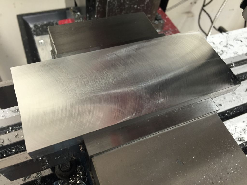

                Here's my first attempt at fly cutting the work holding plate:
                I had to run the mill in reverse for this, as I'd made the stupid mistake of sharpening the wrong edge of the HSS blank and the only grinder I have is at work.
                Cheers
                Mark

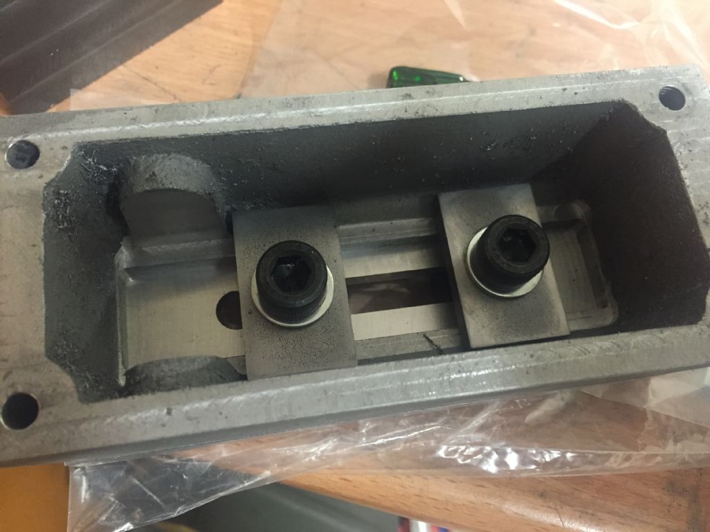

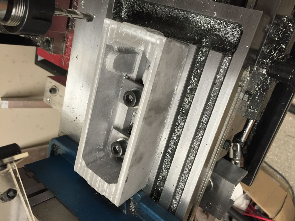

                      I've come up against my first issue with the plan. Neither the bottom or the top of the casting was flat to start with, and that bottom face in the photo above isn't flat. I can only assume that my clamping it to the table pulled the top of the casting flat to the table, but in the process, pulled the bottom out of true and when I released the clamps, the casting sprang back out of square.
                      I'm thinking of continuing with the plate idea and packing up the underside of the casting to the plate, so that I can true up the top, then it can be bolted to the table again and have the bottom machined flat.
                      Fortunately, there is about 4 mm to come off the casting, so there is plenty for me to play with.
                      Cheers
                      Mark

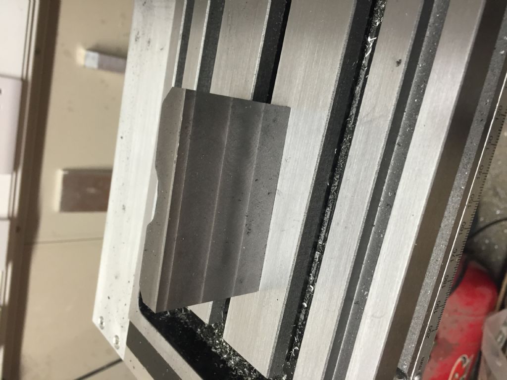

                            Today, I realised the mistake with the fly cutter, I had ground it correctly, I somehow managed to fit it in the arbour 90 degrees out. 😁
                            Every day is a school day at the moment. With a bit of WD40 as lube and the cutter in the right way round, using the speed detailed in the other post that's about at the moment (10000 divided by sweep in MM), this was the result:
                            I'm pretty happy with that. Lots of firsts here, first go at fly cutting, first go a week or two ago at tramming the mill and first go at off hand grinding a cutter.
                            Now I can get on and finish off this holding plate.
                            Cheers
                            Mark

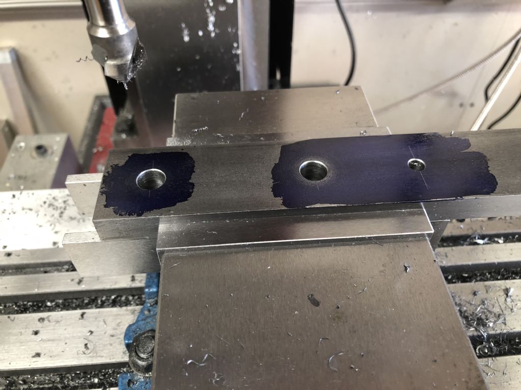

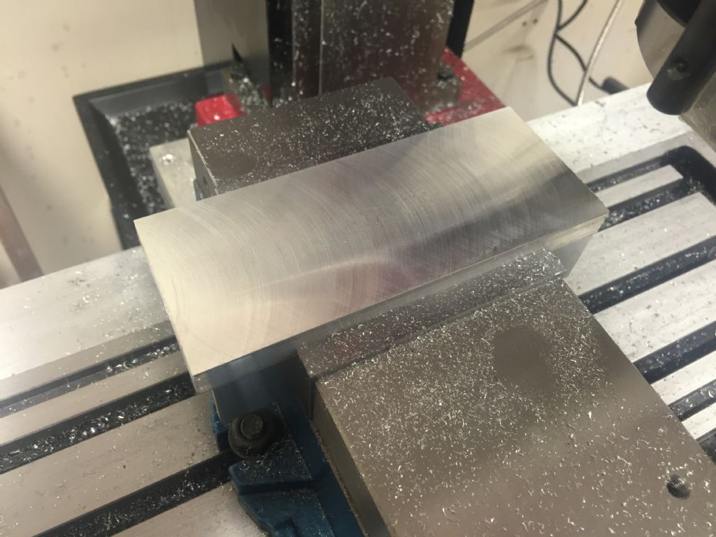

                                Got the plate made up and used transfer punches to mark out the holes. Drilled and tapped M6 and got the riser mounted up so that I can face off the top. As I said before, there is about 4mm to come off the height of this.
                                It's nice and solid in the vice, but I'm still only taking about .25mm off at a time. I also need to extend those countersinks so that I don't end up hitting the cap screws.
                                Cheers
                                Mark

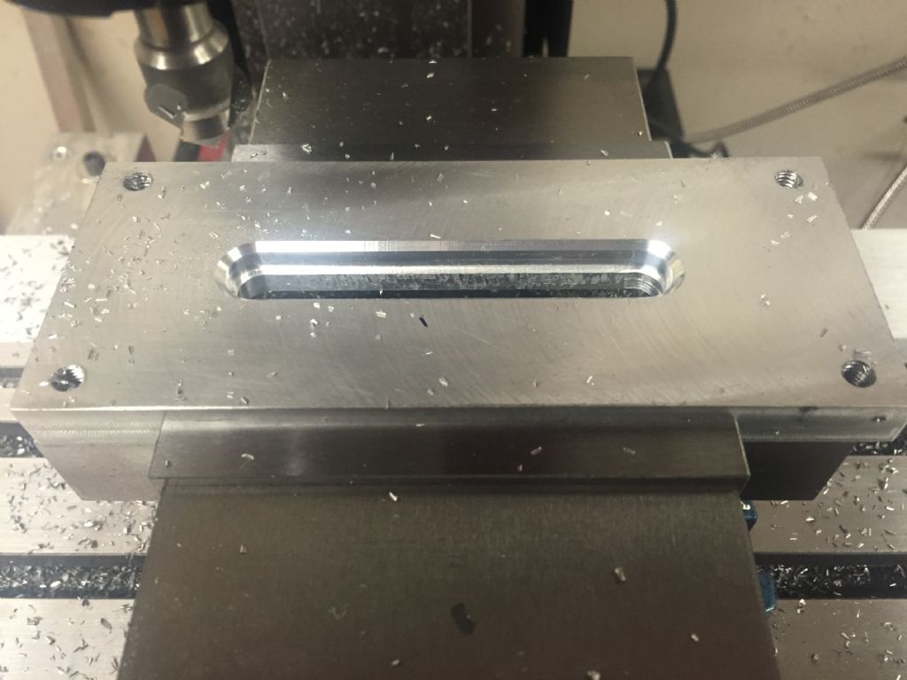

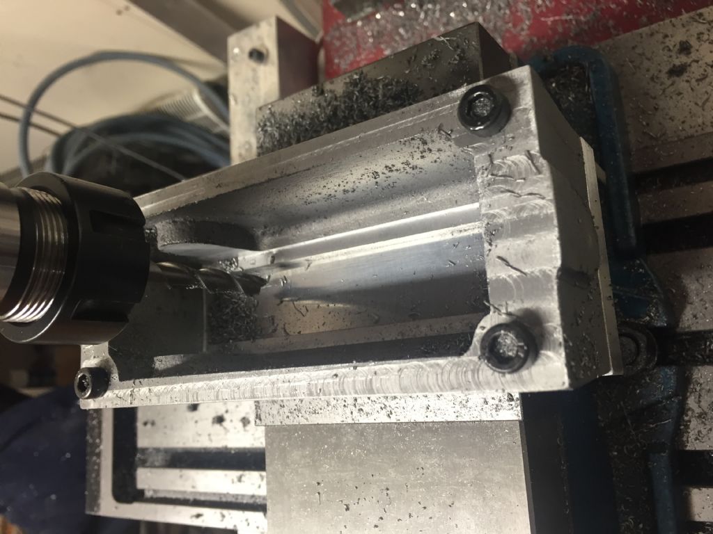

                                  Got a bit of time this afternoon, so I broke out the 4mm cutter and brought the slot to size. One of the things that I'm finding annoying about the drawings is that they are a mish mash of imperial and metric. Anyway, I was aiming for 1"
                                  That looks close enough.

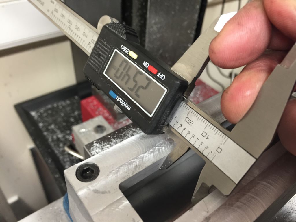

                                      Turned over on the holding plate and the slides machined down to 6.35mm
                                      I still need to take another couple of mm off the bottom to bring it to final dimension, so I'm going to drill and tap the holder M10 to take my clamps shown earlier.
                                      Cheers
                                      Mark

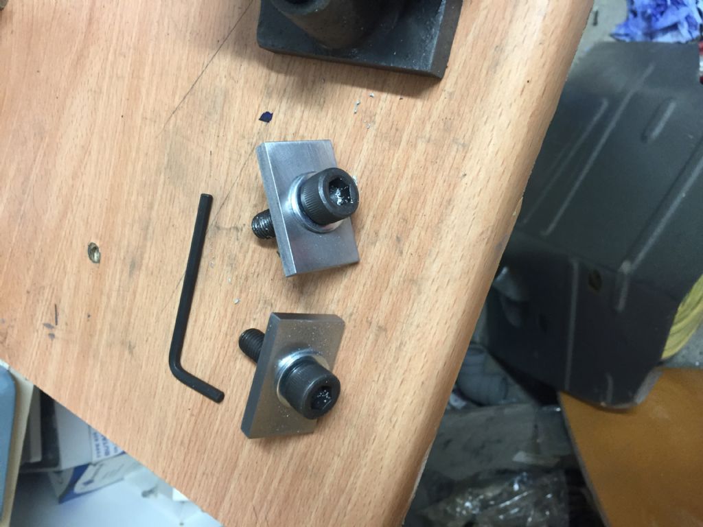

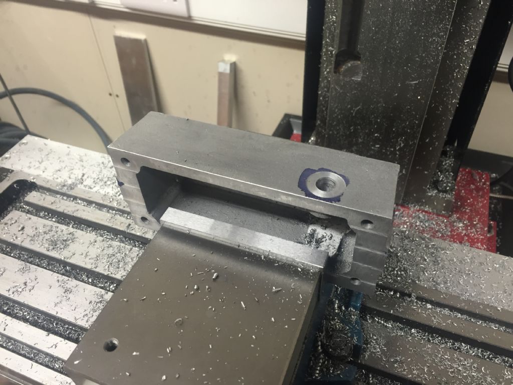

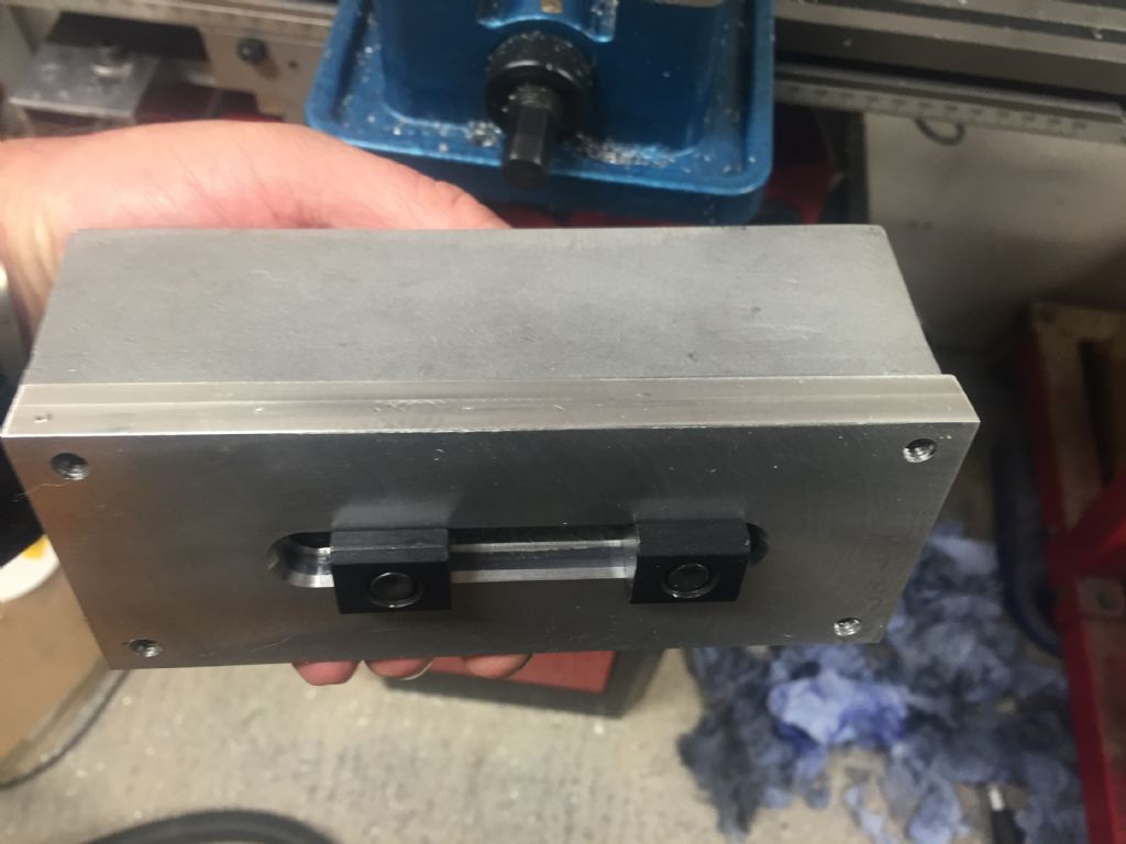

                                        I had a change of plan with the holder, I decided to slot it out to take the T nuts I have plus the clamps I made up.
                                        I can now buzz that down to final dimension and the riser is done.
                                        Cheers
                                        Mark

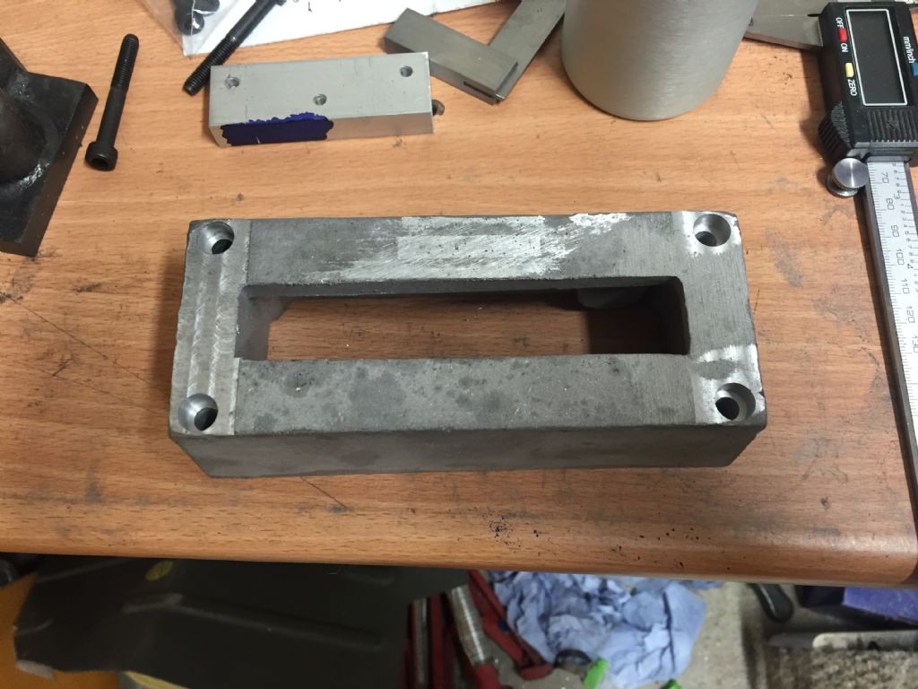

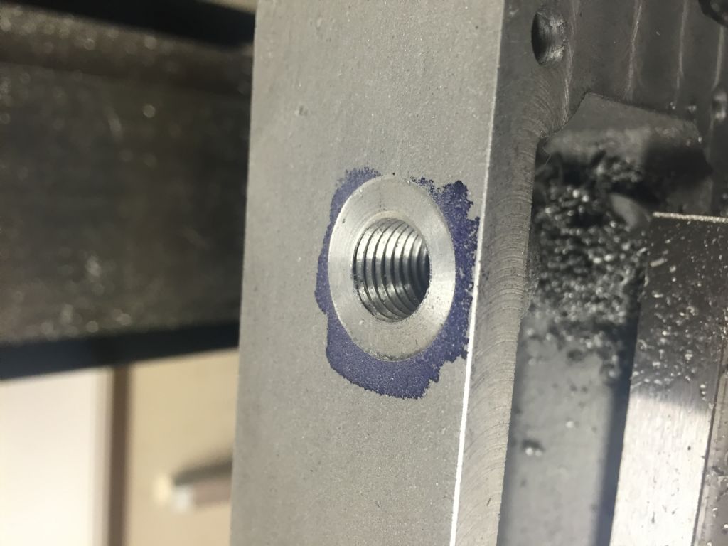

                                          I got a bit ahead of myself with the 'riser is done' statement. I still need to drill and ream out the holes for the vice screw and drill and tap 1/2 BSF for the stop rod. All of the holes need spot facing 3/4 (I much prefer to work in metric, but I'm getting used to swapping between the two now)
                                          Here is the first hole drilled 10mm and spot faced to what should be 19.05mm (I got carried away with the boring bar and it ended up 19.65mm) oops. At least it doesn't really matter as it is just used as a face for the lock nut to seat on.
                                          As I don't have a 11.1mm drill and the taps I ordered at the weekend haven't arrived yet, thats it for a day or two.
                                          Cheers
                                          Mark

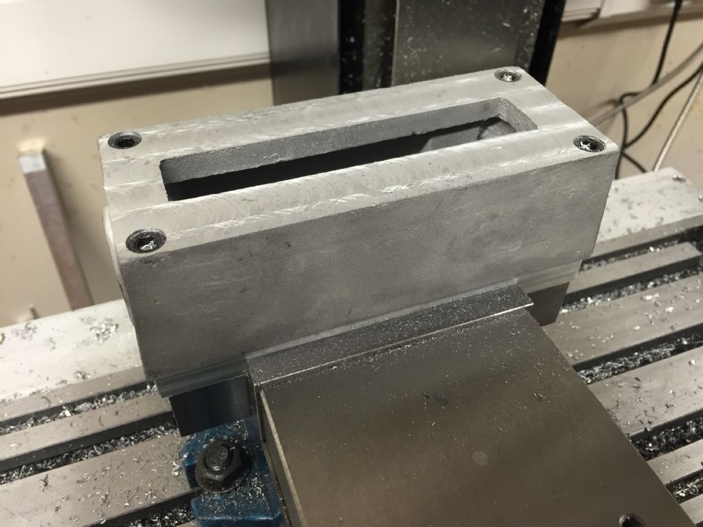

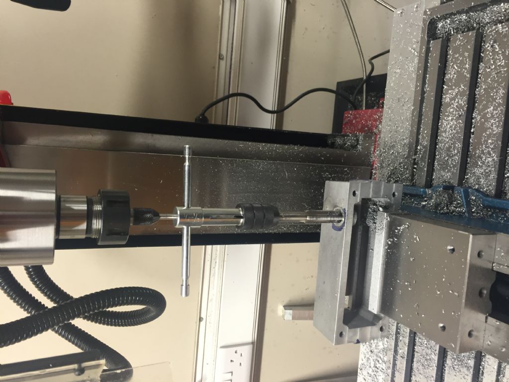

                                            Drills and taps turned up today, so I drilled out the hole to 11.1mm and got to work with the 1/2 BSP tap.
                                            I need to do the same to the other side and then drill and team out the holes for the Vice Screw.
                                            Cheers
                                            Mark

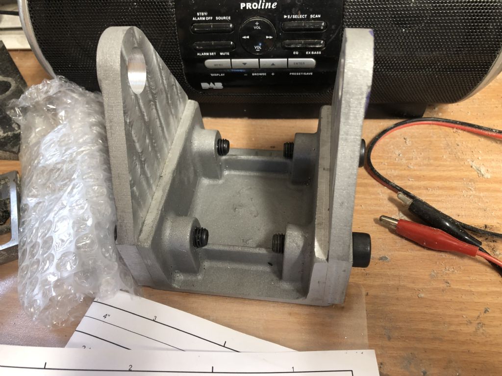

                                              I’m still slowly plodding along with milling jobs on this project. I’ve found it a great learning experience. (Tapping drill for M10 x 1.5 is 8.5 not the 9.5 that I drilled with&#128556
                                              Apart from silly mistakes like above, it’s coming together.

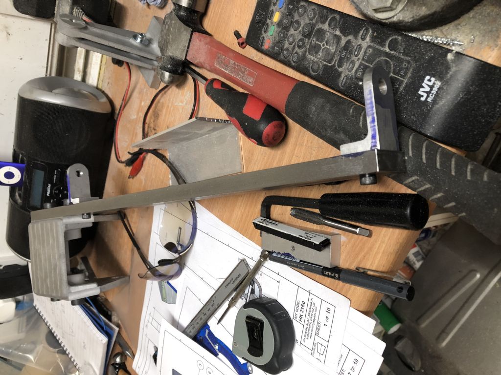

                                                A bit more done. I had to hand file the radius on the L brackets. A rotary table is on my list of ‘nice to have’ tools, I couldn’t justify the spend just for these.
                                                Cheers
                                                Mark

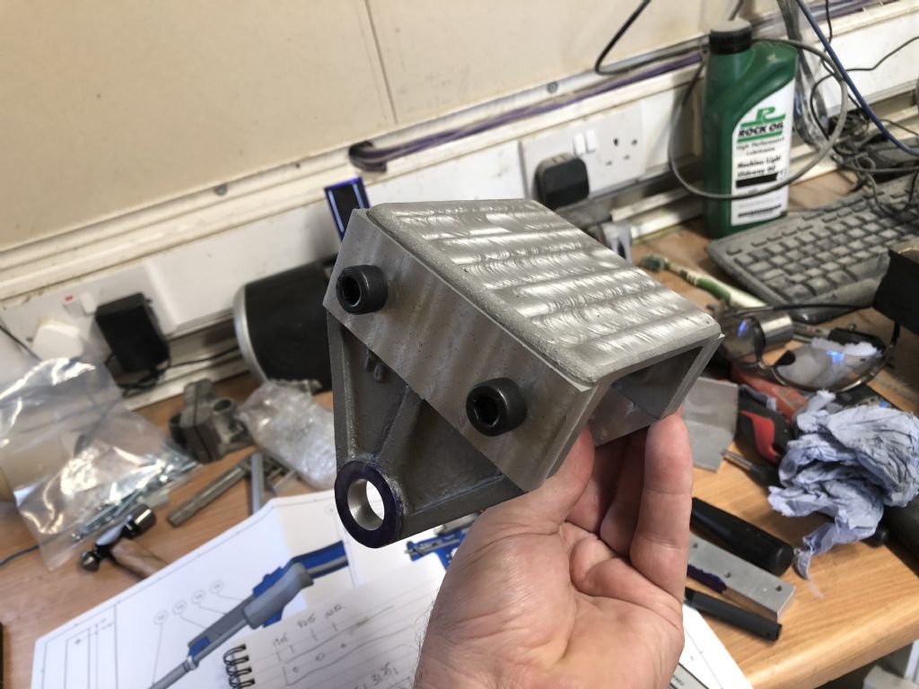

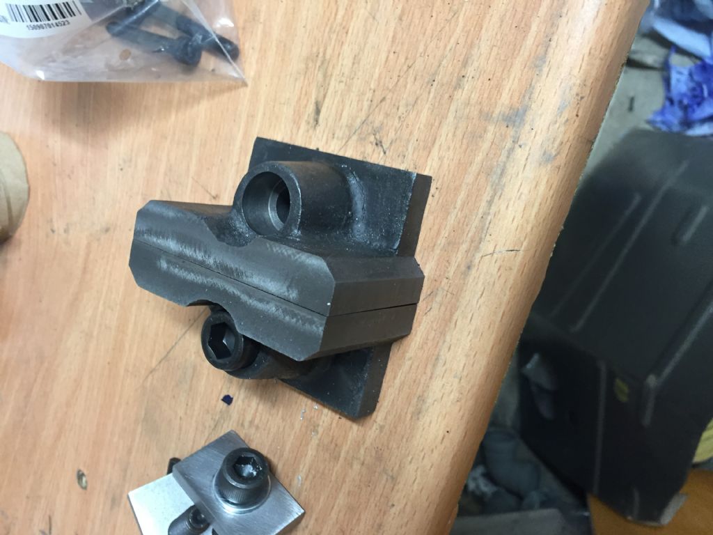

                                                    It was only cast Ali, so it wasn’t too hard, the hardest bit was keeping the file square to the work and not rounding the edges.

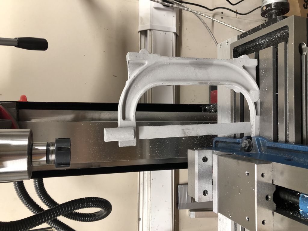

                                                    Next mini project is the bow. I need to drill a 3/8” hole in the boss for the blade tension screw. I think I’m going to set it up on an angle plate, but with the R8 ER25 collet chuck and the mill head right at the top of its travel, there is very little room for the tooling. I’ve ordered a 3/8 R8 collet and a 3/8 end mill, hopefully they should turn up early next week, give me a bit more room and I can get on with this.
                                                    The photo below is it just sat on the table:

                                                      I’m surprised it didn’t slide off!smiley
