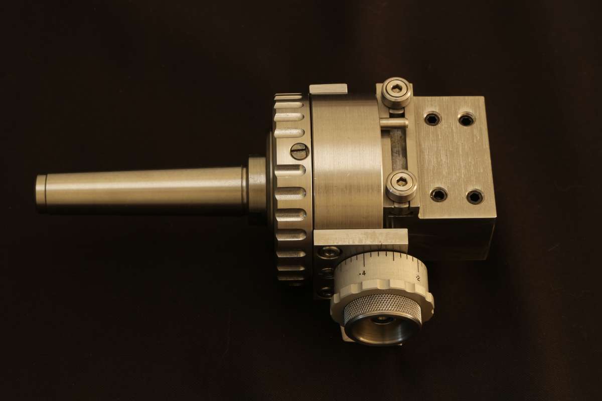

                      My go-to tool for engraving dials is a Unimat sl/db. The lever headstock saves a lot of dial twiddling.Stops are easily arranged. It looks like the same principle as the Hemingway kit.
