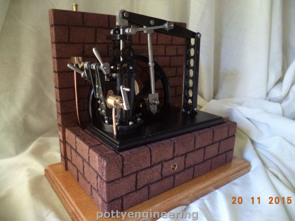

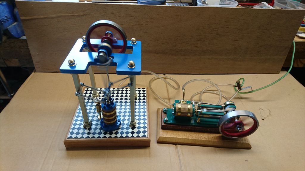

                                                    #311570
                                                    Stewart Hart
                                                      @stewarthart90345
                                                      Hi Chris
                                                      Your getting a nice little collection of engines there, I've recently been in touch with Diane and hopefully the third engine will be published soon.
                                                      Models do tend to run faster than full size its something to do with the scaling effect, the full size one runs very sedately you can see it running at the Northern Mill Engine Society at Bolton I think there's a video here https://www.nmes.org/
                                                      I've also sent you a PM
                                                      Her's a little taster of the last of the trilogy, its a little more detailed than the other three, and I've used a laser cut fly wheel I can give details of where I got it cut for those who are interested I have no connection with the firm just a satisfied customer.
                                                      And her's all three
                                                      Cheers
                                                      Stew
