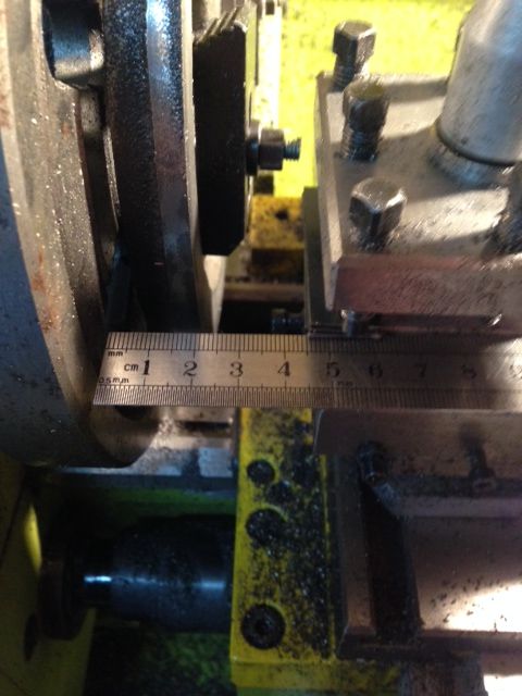

      Hi Chaps, I could do with a wee bit of advice (again!) I'm attempting to machine the rim of my "Wyvern" engine flywheel and using the face plate seemed the best way. bits of Perspex type stuff as stand offs but have a bit of a problem
      as you can see the nearest I can get the carriage to the face plate will leave about 50mm of tool overhanging (this is with the topslide fully extended).
      I think its the concertina type leadscrew cover causing the problem. The only thing I can think of is to make a long back to front boring tool (I suppose I mean a long RH tool) will this work or will it vibrate horribly?
      Thanks in advance for your advise/comments
      Dunc

        its a long way from the toolpost

          If you don't want to make a tool just use a big boring bar mounted upside down and run the spindle backwards, I have done it a few times on my 280

            Excellent ! Thanks Jason I've got a nice beefy boring tool that should do the trick I never though of that.
