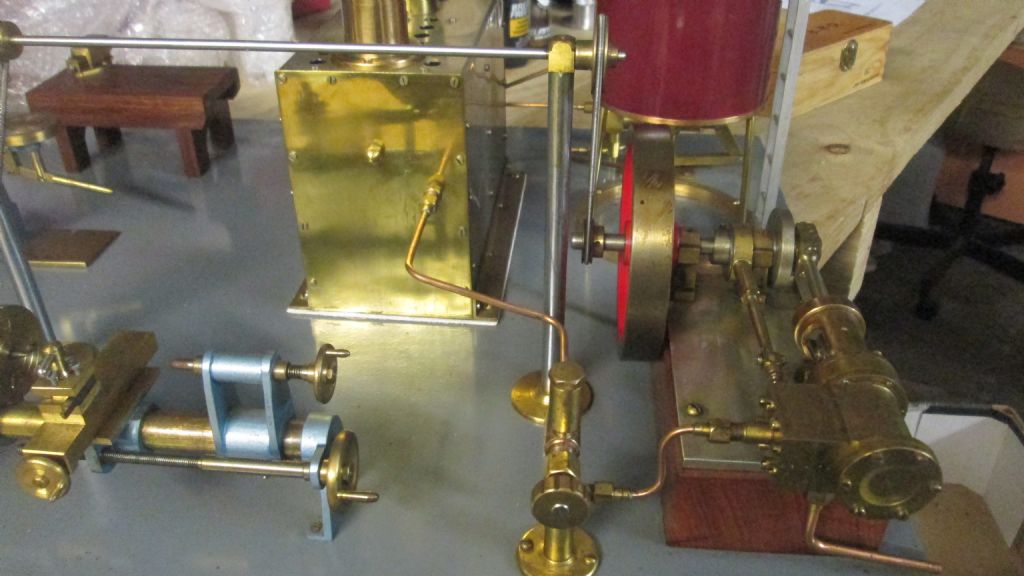

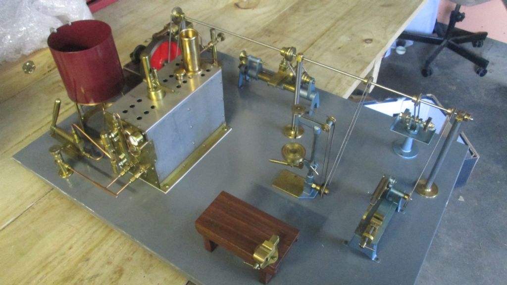

      img_0003.jpgimg_0002.jpgHi Guys,
      For many years I have been in possession of my granddads model workshop, steam boiler and stationary engine.
      This one is designed to work on propane gas. I have talked to my uncle about this and he knows that it was pressure tested, it also had water residue when I blew air through it so I know it had been used at some point. My grandad did several boilers and some were on model steam engines that you could ride. This was probably his smallest boiler.
      I have been researching how to run a steam boiler and I know the importance of maintaining the water level around 2/3 full.
      There are two things I am unsure of. Firstly the optimal pressure. I could guess around 60 to 70 psi but I am not sure. The gauge goes up to 120 psi.

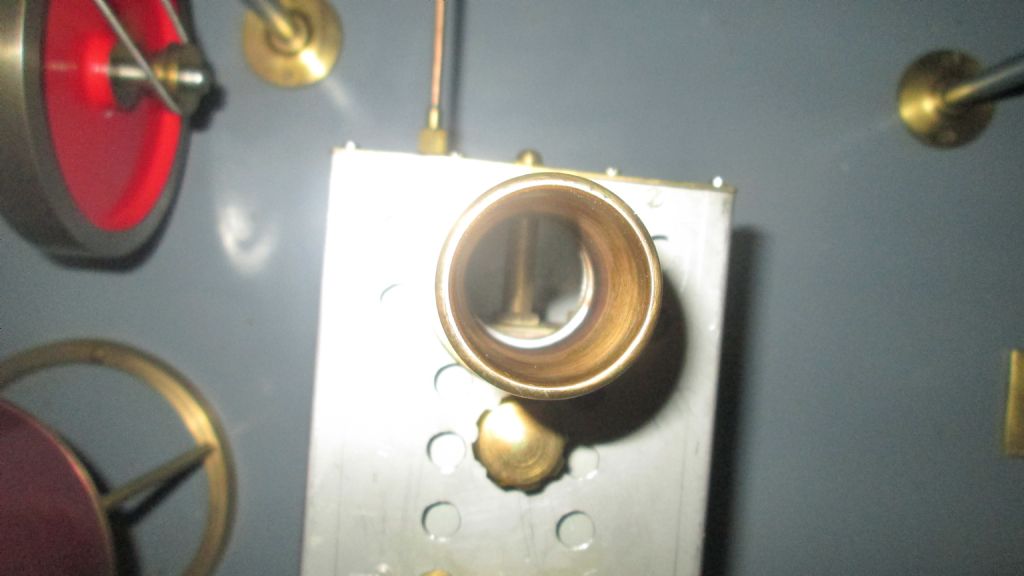

      Secondly – there is a small valve that you can see just in front of the large brass vent on top of the boiler… I have no idea what that does. It seems unusual that it is placed right where the exhaust heat will be coming out. When I first touched that valve I found it was only open a crack.
      Thanks,
      Matt.

          Looking at what the engine is driving I would think a working pressure of no more than 60 lbs will be needed, the valve near the exhaust could be a steam blower to create a draught for the burner gases and will only need to be open a crack you should be able to see a upturned pipe in the exhaust flue if it is a blower.
          Mike.

            I go along with Mike that the little valve may be a blower to help the fire draw but with propane this would seem unusual. If the boiler had been based on a design that used coal then that would be normal. That the pressure gauge max is 120 psi would give a clue that the working pressure is 80psi or less. Running on propane or butane will require the gas pressure to be just right and the air supply also – this may require a certain amount of adjustment to keep the flame on the burner. Yes the water level should be in the glass and 2/3 would be fine.The driven models look like the ones made by the german company Wilesco. Good Luck. Noel.

              Just had another look at the valve near the exhaust it could be a steam feed for the engine or engine exhaust, could do with a picture of that end of boiler for a better look.

                The 'little valve' may be a safety value – above a certain pressure it lifts and blows off steam to avoid damaging the boiler. They can be tested by lifting them – use a rod because the valve will be hot and it might blow steam over your fingers.
                Not much steam pressure will be needed to drive that model workshop. My guess is 10psi or less. The few engines I've built were about that size and I ran them on compressed air. Best made one ran at about 3psi, my rougher engines needed 5 to 8psi.
                Volume of steam or air matters more than pressure.
                For a first run, I'd disconnect all the belts, raise steam gently to about 5 to 10 psi, and then open the throttle. If it doesn't run at 30psi, something is wrong – stop and ask again.
                Looks OK but assume at first that the boiler is a widow maker! It's a pressure vessel full of superheated water. If it fails, perhaps due to internal corrosion, might go bang and fling metal fragments about. More likely to fail by splitting and spraying a brief fountain of steam and boiling water – don't get too close. Safety glasses and a simple shield.
                Worst case by far is injuring someone else – the legal and insurance complications are potentially horrible.

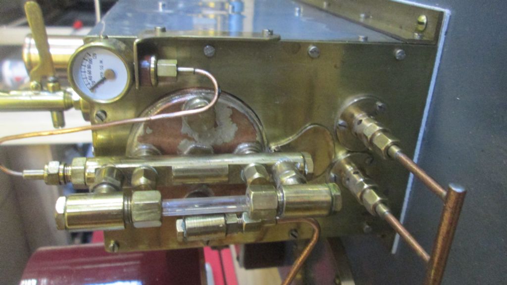

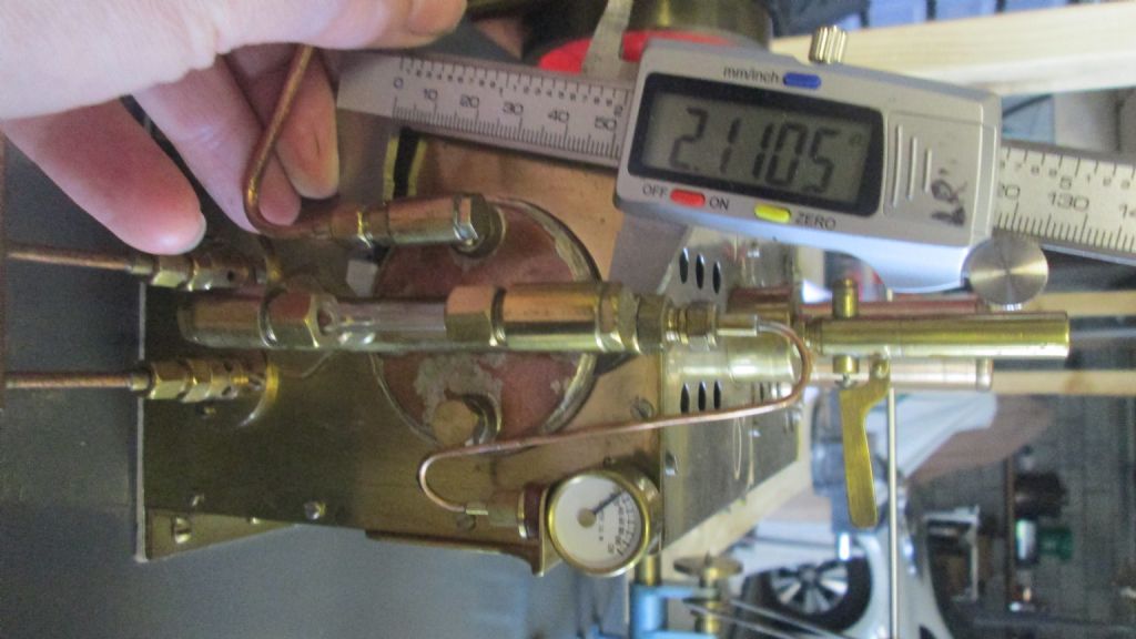

                  img_0007.jpgThanks for all the replies.
                  I have uploaded a couple of extra photos to shed some light onto it.
                  My uncle told me that most of my granddads boilers were designed to be run on either coal or propane. This is an exception obviously but I wonder if this has something to do with the mystery valve.
                  Now as a beginner I found something that did surprise me. All of the simple diagrams I have seen of a small boiler show the flames or heat touching the boiler cylinder itself. However when I opened the small inlet designed to assist lighting the burners I could see four copper tubes that attach to each end of the boiler, there are two above each row of flames from the burners. This will obviously assist heating up quickly but I was wondering how common this is.
                  Noel that tip about Wilesco was invaluable… I had a look at their catalog and I could see at least one other model that looked vaguely familiar. I believe you are correct. Thanks.

                    I am a bit concerned that I cant see a safety valve on the boiler. I am also concerned by the talk of "widow makers".
                    Proposed course of action:
                    Fill boiler & tank with water. Use the handpump to pressurise the boiler. Bleed any air out through the whistle, then pump up to 100 psi on the gauge. If there is a safety valve, you will know from the water coming out when under pressure. Ideally you would then remove the safety valve, put in a blank plug and pressurise to 120 psi, hold it there for 10 mins and check there are no problems.
                    You would then be safe to steam it up at pressure up to 60 psi. If there is no safety valve, do not steam it.
                    Better still, find a friendly club and join it. Let us know where you are and I am sure you will make contact with someone on here.

                        It looks like the safety valve is behind the whistle on the steam dome. I would check that this lifts with a bread knife (just a fraction, if it moves its working). It should have a small groove at the top. If it’s stuck just leave it overnight in a little citric acid-water solution.

                          Matt, Your latest picture solves the valve question, it's the main steam control valve for the engine, the tube on top of the valve body looks like it could be for engine lubricating oil as it seems to have a screw cap for filling.
                          The first picture was a optical elusion that made me think the valve was a blower and fastened to the boiler.

                                  I can confirm the safety valve is right next to the manual pressure blow off lever at the top middle of the boiler.
                                  I like the idea of purging the air and doing a simple hydraulic test. This will check the basic safety as well as confirm that the pressure relief valve is functional. This will be step no 1.
                                  I also like the idea mentioned earlier that this model may run at very low pressure… less than 10 psi. I have oiled the points and the mechanism runs very freely. I don't think it will require much to simply get it running. If I can get it moving under 10 psi I wont go any higher. I don't plan on making it race.
                                  At this point I just need to wait for a 1/16 BSP tap to arrive so I can connect the gas line safety so it will be a couple of weeks before I get going. I am looking forward to running a boiler for the first time.
