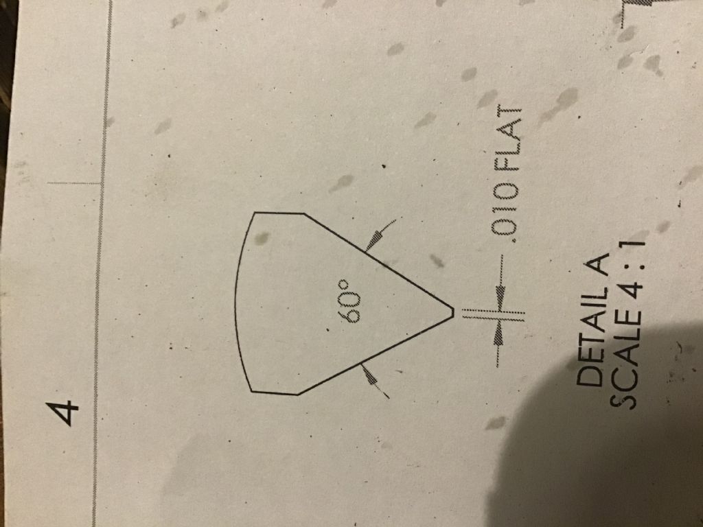

      I'm wanting to get a 60 degree angle on a piece of 1/4” steel like this….
      The steel is 1/4” thick, 6” long, 2” wide. The angle is along the 6” edge.
      I don’t have any angle plates but have a digital inclinometer. I don’t think it’s critical that the angle is precise.
      The vice on my mill will open to a bit more than 4”
      I'm unsure of the best way to clamp plate.
      The head on my mill does tilt, but only to 45 degrees x axis. It will tilt to 60 degrees y axis but the vice won’t open wide enough to take steel that way. I guess I could clamp steel to the bed, but am wondering if there is a better way?

          30 only need to tilt head 30deg for each side. Turn the vice so jaws run front to back. mount work edge up and use Y axis to cut using side of a milling cutter.
          Or clamp to table with work in y axis and use end of tool.

            Your 60 degrees angle is two 30 degree angles so all you have to do is clamp the plate down flat on the table (on stand-offs) and nod the head 30 degrees, do one side then flip the plate over. I like to use scrap 1/2" MDF for this kind of thing, lay the MDF on the bed, plate on top, couple of clamps and you know you can mill away without milling the table.

                      I dont understand the question. Are you making a flat plate identical to the drawing with a 60 degree angle?
                      Or are you making a flat plate with angled long edges? Your post is not clear hence the confusion.
                      If it's the former, rough it out with a saw and finish with files or a belt grinder. There is no need to waste time on a milling machine when it could be done much more quickly as I suggest.

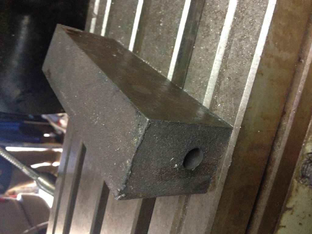

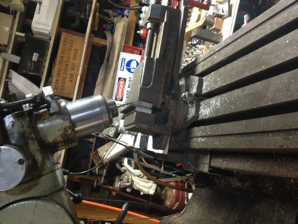

                              Found some time today so set up the steel plate to mill the angle.
                              Sorry – don’t know how to rotate photos!
                              I used the side of a end mill I'd previously destroyed the end of – side was still as new so got a nice finish.
                              I did one side, then rotated work piece and started the other side. Soon discovered the vice was not 100% square – got a ten thou. flat at one end but 25 thou. at the other. Squared the vice and redid both sides and it turned out perfect (a novelty for me).
                              I've got a foot long bar of cast iron which I'll use for the other parts, as I don’t have any steel the correct size. So far I've just cut it into two 6” lengths after face milling the rough side.

                                          Well I finished it off. Just need to trim the punch holder to length.
                                          works well on 1.6mm copper. I guess time will tell if it splits, but I didn’t have to put much pressure on it to fold the sheet, so I’m hoping not

                                            Just an observation Grotto but the endmill you used to cut the angle on the 1/4" steel looks to be no more than a 1/4"/6mm size plus with the work mounted as it was meant the tool was cutting close down towards the tip. I am not criticising and it worked but I think it would be better and safer to go with a larger stiffer tool, say 10mm or the like in that situation.
                                            As I say just an observation.

                                                I gave that endmill (1/4&rdquo a try as the end is really blunt, but sides are really sharp. I was prepared to have it snap, but only took light cuts (0.2 mm) and it performed well.
                                                will use a larger one next time!
